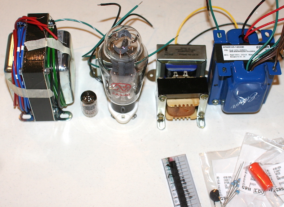

Some judicious proding from Jeff - I’ve dusted off the parts I had bought for this amplifier. It looks like I have the tubes and all the iron in hand.
I need a chassis - something a bit ‘traditional’, like Sun Audio (see post 87 too). A Hammond 12” x 8” - but Aluminium or Steel ?
And what about the layout of parts - do it like the photo ?
Left to right: OPT - tubes - heater trafo / PSU chokes - power trafo. This keeps the OPT away from the rest of the iron.

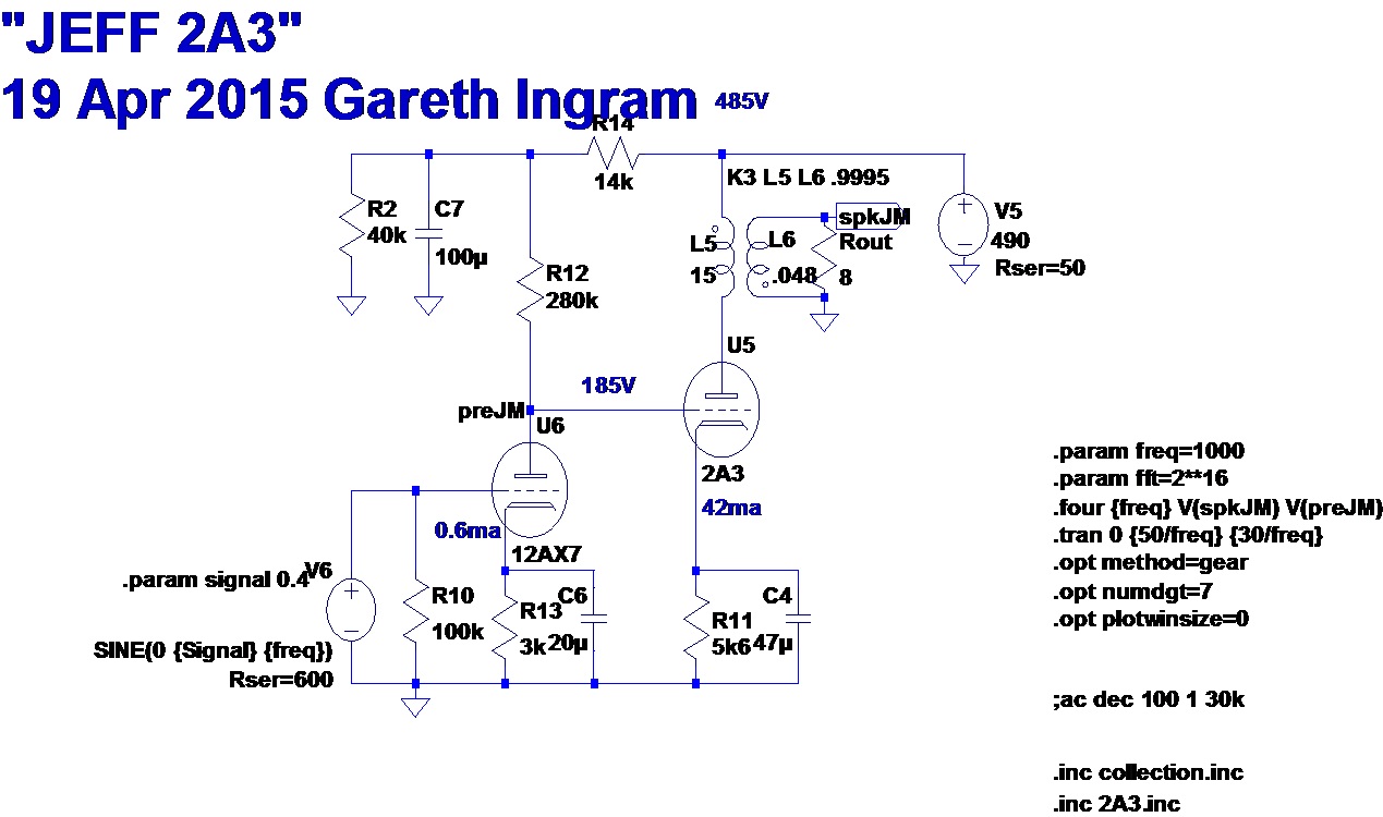

I don't think that October drawing will be the final schematic, but it is very close. I have learned that the RC filter for the input tube is unnecessary with this Loftin-White topology, which would simplify things further.
However, this L-W approach also raises the output impedance of the input tube which is a concern because when this impedance is combined with the input capacitance of the output tube you get a reduction in output at high frequencies (although at my age this is unlikely to be relevant !)
Before I tackle that question I'm going to start off by building the power supply and making sure I have a safe source of 500V and that means some chassis work and other stuff - as you can see, this ain't my fastest project !

I took a bash at converting the spice simulation Goldenbear posted in another thread to match the circuit that Drlowmu had suggested to me. I'm not sure that I've followed his instructions correctly. The results are distortion of 3% at 1W output. I'm not sure I'm happy with that, I'm pretty sure Jeff gets 1% at most from his amplifiers. Perhaps the tube models aren't accurate enough.
That model doesn't seem very practical. With 42mA and a 5.6k cathode resistor, the cathode is at 23V, with 185V on the grid. He must mean 56K at the cathode. That's about 10 Watts over that resistor.
Sheldon
56k with 43mA will drop 2.4kV... no, the 5k6 if fine and this is the 2A3 model that Goldenbear was using. I provided the 12AX7 model (from somewhere else on this forum).

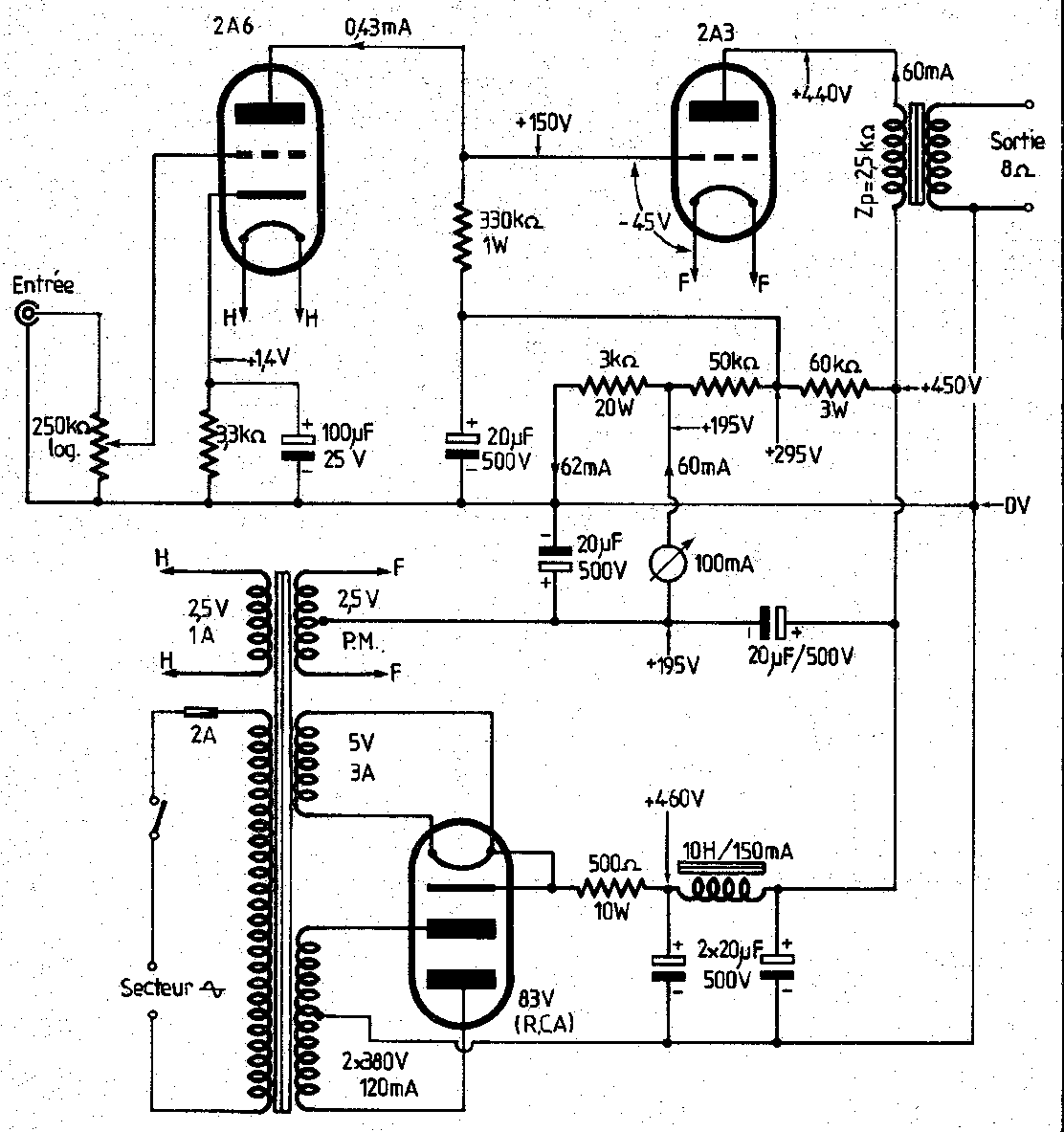

Hi AJT, I have tried it and the distortion drops to 2% at 1W but I am trying to understand better the design choices taken by others before me.
Perhaps you can help again here. Attached is the 2A3 attributed to Isamu Asano, a well regarded design.
Question: like the design Jeff proposed to me, Isamu uses an RC filter to drop the B+ significantly for the front end. This means using a low current through the input tube and a load resistor of 330k. With a less aggressive 'R' in the RC filter (less than the 60k he used) there could have been a larger load resistor for the input triode, or a higher current through the input triode. WHY did Isamu choose this operating point for the input tube - was he looking for some 2nd order cancellation between the two triodes ??
This is a pretty typical Loftin White type amplifier design, with the added disadvantage that there's no hum pot. (So you get to buy 2A3's till you find a pair that happen to be quiet on the filament windings you've been dealt!)
My guess is that the design is very old, and that the priorities were to have adequate gain in a 2 stage amp and a self adjusting grid bias voltage. What is sacrificed with this design is bandwidth (a limitation of the driver working against the Miller capacitance of the 2A3), hum nulling pots for the filaments, output power, and very likely noise floor (power supply issues).
To get the gain with the available tubes, you end up with a high mu triode with high plate resistance. To load this tube properly, you really need that 330K resistor, and to load the tube with the available voltage, and with some adjustment based on 2A3 current draw, you just can't run any more current than that.
