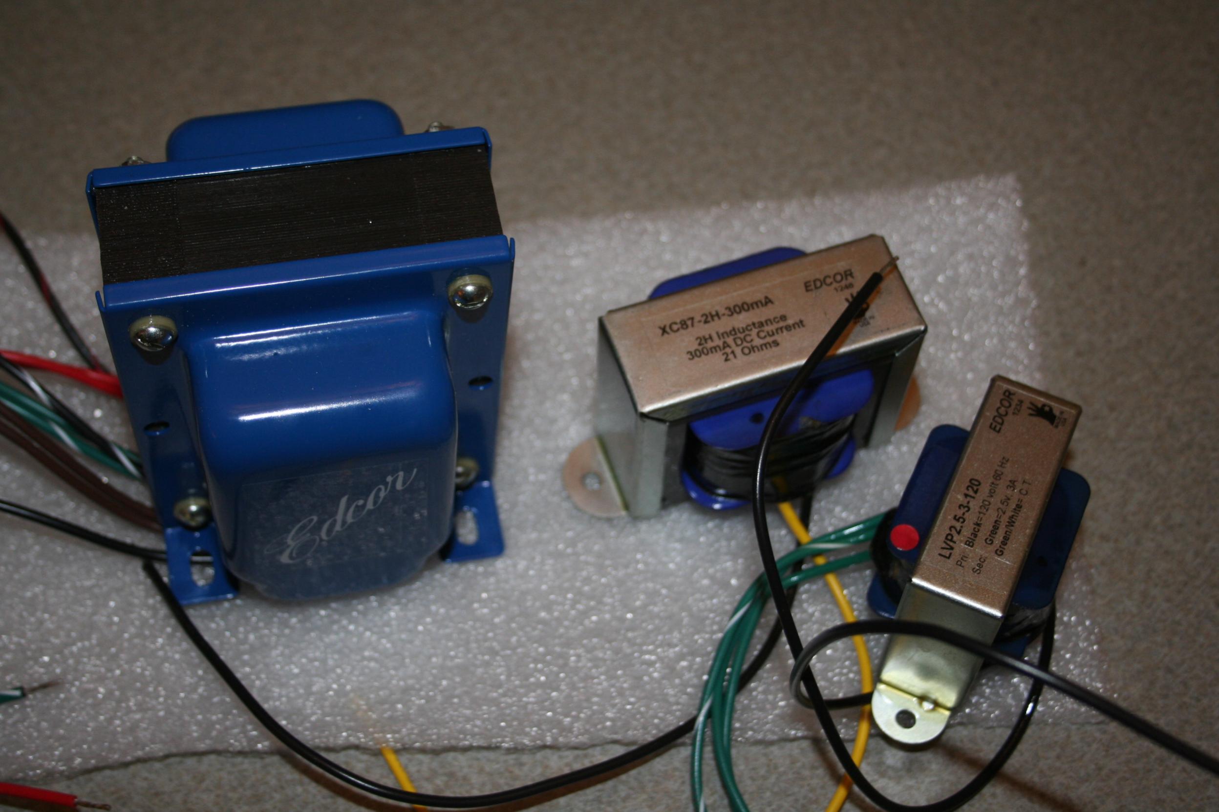

I now have the Output Transformer in my hands 🙂

I agree on the need to build a SET, as it is the only way I will ever answer the questions about SET sound quality for myself. I settled on the 6A3/6B4G/6C4C due to the broader offering of the 6V filament versions. I've collected a pair of 6A3s and a pair of 6B4Gs and have begun playing with them.
I've got a pair of Edcor GXSE10-8-2.5K transformers but feel something better is in line. The CXSE25-8-3.2K looks nice, but I think a 25W transformer is overkill and not optimal. I just can't see it for a 3.5W amp.
With that in mind, a couple of days ago I sent a request to Edcor for two transformer quotes for my amp.
I'm looking at a 10W 3.5K to 8 Ohm transformer with possibly a cathode feedback winding (also 8 Ohm), and UL tap (40%). I figure I might as well get all the bells and whistles in it. If the CF winding does not work out, the next time I'll get the ones without it.
I figure a 10W transformer ought to cover a lot of ground. It is slightly small for a 300B, but not much, and would work well for the 6P41S amp I built as well.
I also requested a quote for a 5K primary version.

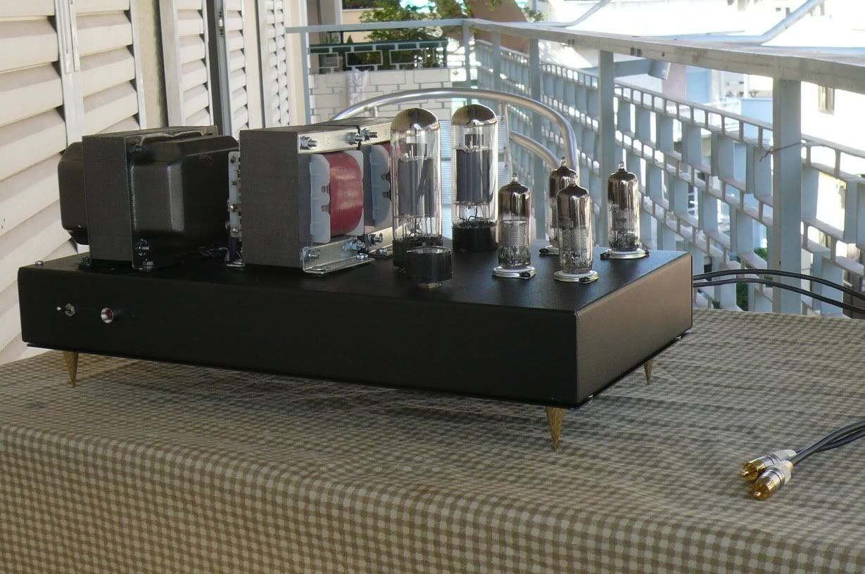

No problems at all. Helps a lot to drive triodes. The bad reputation comes from Fender/Marshall using 12AX7's in this position, not appropriate. Here is mine.
That's a really nice looking build. Yes I would agree that 12AX7 is terrible as CF, you need a tube with high transconductance. Maybe I will try something out on a plank of wood.
OH WOW, So pretty.
When I get a tube amp I might take it outside for a walk too.
Just makes you wonder when efficient artificial lightning that simulates sunlight will ever be invented.
No, I actually consider it ugly, the Hammond box was for another project and it's a little too small. Thanks anyway!
About the light, from what I have seen in studio HMI's I think never. Especially the Attica skylight.
Did I mention how good it sounds?
Im probably going to be building a kt88 amp and i hope the paint finish comes out like yours has because that is what i am going for, this has nice lighting that makes everything sparkle but it also has beautiful contrast levels that let you see the black paint finish but also let you see the tubes shine, not too bright, not like what you would get here in australia.
this picture would be impossible to do here unless you use a filter and a reflector.
that sort of metallic black colour of the primary trafo bellhousings looks even better, whats the trafo and finish model number/colour?

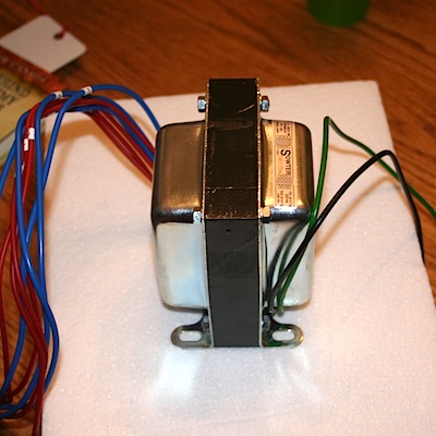

I don't know. Using 9.75# transformers for a 3W amp just seems wrong.
The UBT-3 looks nice at 5.6#, and the Transcendars are only 4#.
The UBT-3 has a multitap secondary and could be used for cathode feedback.
Any of them would be fine, and I'd like to compare with the GXSE15-8-3.5K.
More inductance, lower coupling capacitance and leakage inductance due to different construction technique.
My hunch is that there is more interleave in the larger better transformers. In addition there are more turns in the primary due to more winding window as a result of the larger core. This gives the inductance. The interleave gives the lower capacitance and leakage inductance.
