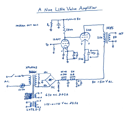

A nice little valve amplifier
Have you spun out that power supply yet?
Inductance is quite low so you'll have to use large capacitance to end below 15mV.
Maybe a third filter step, a RC right after the rectifier?
Shoog, did you experiment with ultra low ESR caps on the multiplier?

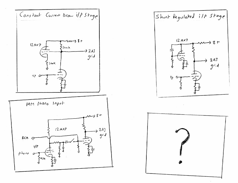

Hang on a minute - why can't I bypass the input tube cathode resistor AND apply a L-W topology.
You can do that, by partial bypass. You only need enough unbypassed resistance in the input cathode to apply some noise cancellation. I'd try about 1/4 of the total resistance.
Or, you can use Darius's clever bootstrapped follower, if you are worried about input drive.
The noise cancellation is very effective. This is my headphone amp: http://www.diyaudio.com/forums/tubes-valves/125488-loftin-white-801-amp.html#post1551490 With this supply, more capacitance made no difference. Any residual noise I can barely see on the scope, I suspect is due to the filament heater (it's not Tentlabs low noise version). BTW, I would use DC on the filaments and Rod Coleman has an excellent version.
I used chokes that I had. Bigun can add some if needed. I'm not sure the low R supply will have the same effect as in conventional circuits. No harm in trying.

Disco - The power supply is unusual I'll grant that, but it's been used before by others (there's more chat over on Audio Asylum than here) and as you say, anything can be changed if it needs further work. Interestingly I also found other adherents to the idea - Sound Practices (issue 10) Diego Nardi of Audio Note "The HT supply for a Class A power amp, and especially for it's output stage, has to deal with a circuit modulating a large percentage of supply voltage and current if the amp is single ended. Therefore it is necessary to design a fast and nimble supply with short recover times, rather than one that stores a lot of energy. "
Sheldon - I don't think I need to leave any cathode resistance unbypassed at the input for the L-W noise cancellation to work.I am proposing a capacitive divider and with low impedances the frequency response of the divider is fine. The downside is the ability to fine tune - did you find that the noise cancellation was stable once dialled in, or did you have to reset it periodically ? and did you find that the null is very narrow or was there some range over which it was effective ?
The "triode characteristic factor" - just means sufficient anode load for gain and linearity - which for high mu tubes is always a challenge. With a bypassed cathode, 200V plate, -1.75V grid, a 12AX7 rp is 68k (reading off the graph in the data sheet from Sylvania), so applying x5 = 340k. I'm pretty close to that.
Bootstrapped follower - this is a nice trick, reminds me of my SS amps which all had the VAS load bootstrapped from the output. I could use the other half of a tube for that and still take the output from the anode of the first triode. I don't think we need it. Not only might the cathode follower add it's own flavour to the sound but I remember in the SS example that the quality of the bootstrap cap is important for the sound - we have in a roundabout way introduced a cap into the signal path that the L-W topology eliminates. Asano and Shishido didn't need it either.

What other choices do we have to make use of the 'other half' of that 12AX7 anyhow ?

When I saw the impact of not bypassing the input tube cathode resistor I decided that I would not implement the Darius scheme. However, after reviewing the comments from Broskie and realizing I could combine his idea with that from Darius I am now in favour of applying the L-W noise cancellation. I will build the circuit without it, but allow for the inclusion of it. Then I will include it and see what level of improvement it provides, along with any perceived tradeoffs. So, L-W is back on the table.
Sheldon - I see what you mean regarding the bootstrap cap - we don't need a large electrolytic in this case because impedances are much higher than in the SS example. It's certainly an easy experiment to try - I will have a narrow range of voltages to which I must elevate the heater on the 12AX7 so that both halves are within their heater-anode and heater-cathode ratings though.
That's the tricky part with these, yeah it's tight but doable. If you set the grid of the 2A3 at about 110V (2A3 cathode about 160, B+ about 410), you can float the heater to about 80V and be covered for the full swing.
Or, separate heaters and envelopes for the input and follower. Or, if you don't mind an appropriate use of sand, a DN250 for the follower.
One thing to consider: You will push the tubes near their limits, and for a short time past them with your SS bridge. I use an indirectly heated (6x7 or 6CA4) hybrid bridge, so that everything comes up together.

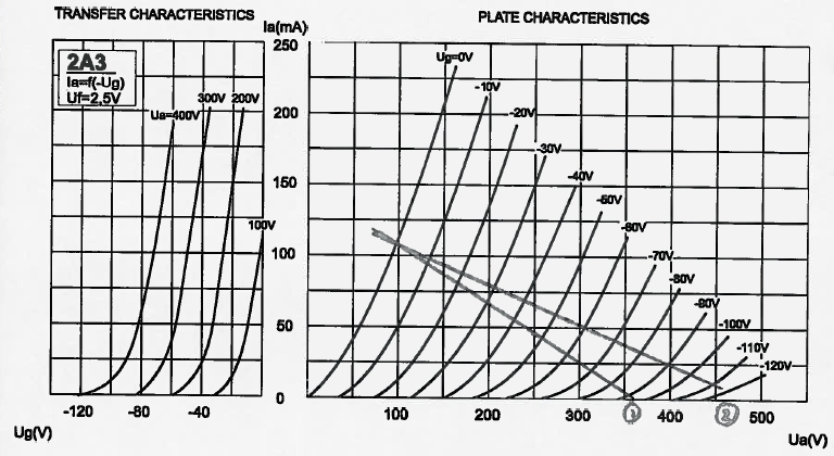

You might want to check your load line on the 2A3. Your earlier schematic showed 45ma of current in the output stage. With a 5.6K cathode resistor, you'll measure about 252 volts. With a plate supply of 510, and a loss of ~4 volts in the OPT primary, 510-(252+4)= 254 volts cathode-plate. That's not a very good load line.
No judgement here, but that's not far from a pretty typical load line for the 2A3. A little more current would probably be better. http://www.mif.pg.gda.pl/homepages/frank/sheets/049/2/2A3.pdf

No judgement taken. I guess it depends on your definition of far. The classic book spec is for 250V, 2.5K load at 60ma of current. The far in this case is 25% lower on idle current, or in reverse, the book spec calls for 33% higher idle current, that's pretty far in my view.
My preference (for the 2A3) is a 3.5K load, 300V at 55-58ma of current. It's more linear in it's load line, less distortion (measured) and better power with 4+ watts.
Regards, KM
I agree, when you look at the text book, it calls for a 2.5k load line as a the best compromise between power & distortion, along with Vp=250V and Ip=60mA. The reason I've shown a lower current is primarily to provide a good level of power derating for longer tube life.

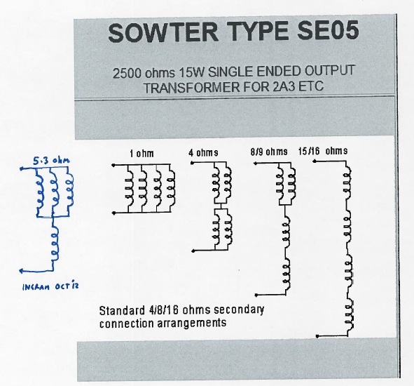

Now, I know there are compromises in doing this, but I can alter the reflected impedance of an 8 Ohm speaker at the primary by changing how I wire up the OPT secondary. The OPT secondary is an interesting design. Sowter recommend independent windings, no taps, for better h.f. performance. These windings are combined to suit the load impedance. They show connections for common loads. SE05 SINGLE ENDED OUTPUT TRANSFORMER
In the attached drawin I've added an additional wiring option which I believe provides for a 5.3 ohm speaker load. An 8 ohm speaker connected here would reflect back a primary impedance of 3.7k.
I've also attached the plate curves for the 2A3 and shown option 1) my current proposal, and option 2) a higher Vp, higher Ip and higher Zload. This last option would be feasible if using a JJ-2A3-40 with it's much higher power rating than NOS 2A3's.
Did I get these calculations *roughly* right ?

Yes, I'm quite familiar with the 2A3 plate curves. My main point is that running a lighter current (hence lower plate dissipation) will prolong tube life, but if you lower the idle current, it's better to increase to load impedance to improve the linearity (lower distortion) and get some additional power (better efficiency).
I have a stock of 60+ 2A3 tubes; RCA, Sylvania, Philco, Zenith, Ken-Rad, Tung-Sol, some original single-plate, typical twin with single plate and some true dual triode configurations (collected over 4+ decades... I'm pretty old). After exhaustive testing in multiple circuit topologies, I'm convinced that 3.5K is more optimum overall but you'll get the best overall performance by pushing them to ~16W of plate dissipation. I'm using older Tek, HP and Fluke test gear for all measurements.
You can also decrease the cathode resistor value and increase the current easily. And as you pointed out, you can re-wire the secondaries to change the impedance a bit. I'm also in the camp where my view on the input/driver is on the weak side. I built a pair of 45 SET amps years ago which use a similar topology to the Fi45 amp and uses the 6FS5. Nice sounding (MQ OPTs) overall, but they're just nice, not special.
