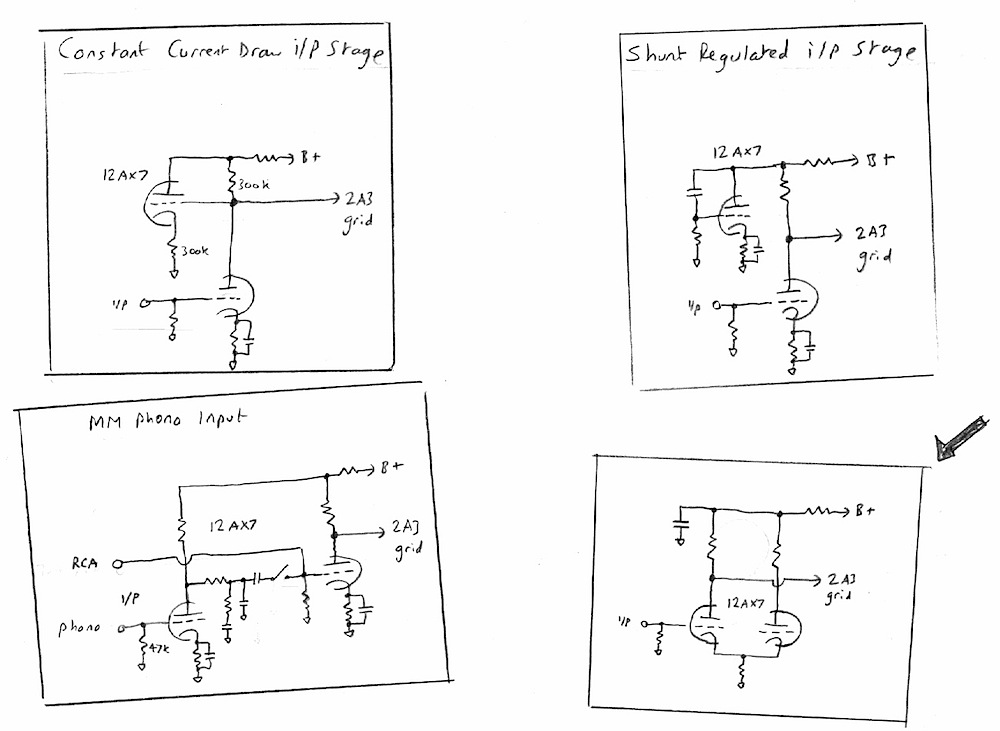

Talking of Sound Practices, another article that caught my attention was J. C. Morrison's 'siren song' pre-amp. I found it interesting because of the use of a cathode coupled amplifier at the input which allowed the designer to avoid the use of a cathode bypass capacitor. Such a capacitor is something that is currently part of the design proposed in this thread and being at the cathode of a high-mu input tube it must necessarily have a strong influence on the sonics of the amplifier. A quote from J.C. M's article "A differential amplifier can be imagined as a single-ended stage with its cathode decoupled by the low internal resistance of the cathode of a second tube, rather than by the low impedance of a capacitor."
So if I reach back to post 48 and update my options to include a differential i/p - which also has the benefit of reducing the current variations through the B+ supply.

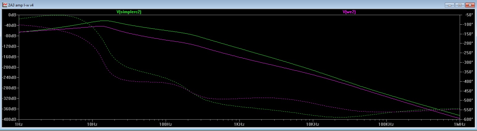

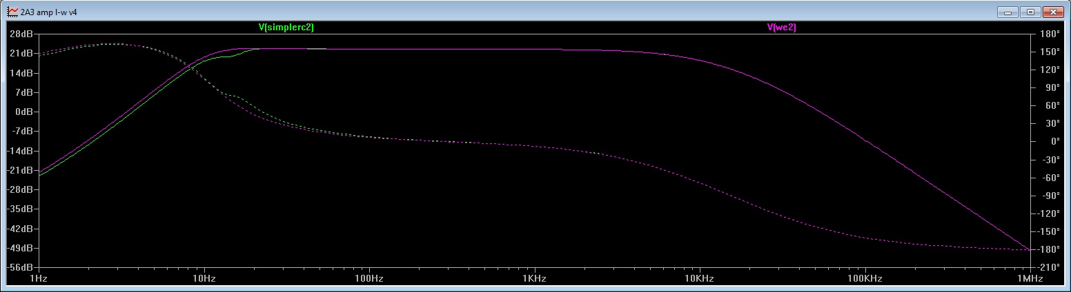

Well I decided to fiddle around with LTspice on a rainy day to see how the Western Electric version of power supply noise cancellation would work. I like it because it's relatively simple although less convenient to adjust than the L-W version.
The attached shows my results. First image is the circuit schematic I used. I'm not 100% confident that the tube models are perfect but the idea was to get a sense of things rather than a perfectly accurate simulation. You can see the WE noise cancellation cap from the output tube cathode to the B+ (I think it's C17 on this drawing).
The 2nd image shows the PSRR, where the lower line (purple) is the result for the WE version. Removing the WE 'ultra-path cap' C17 gets me the upper line (green). It's fairly clear that the WE approach provides an improvement in PSRR of a fairly substantial amount - depending on how well the value of the cap is adjusted to 'null out' the noise.
The 3rd image shows the Frequency Response of the amplifier. I wouldn't read too much into the high freq. roll off as it appears to be dependent on the OPT coupling coefficient more than anything else. The interesting thing is the low freq. 'bump' from the non-WE version, which as has been pointed out in an earlier post, arrises from a L.F. resonance in the power supply (low DCR = low damping) and which is not present with ultra-path WE capacitor.

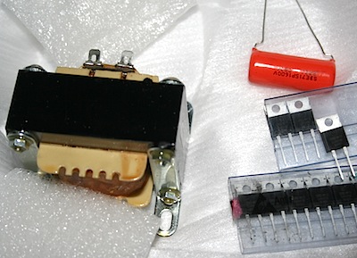

Well I got a few more parts today - the Triad choke (35mH), orange drop that will be in the snubber across the secondary of the power trafo, some Cree SiC diodes and a few other bits.
