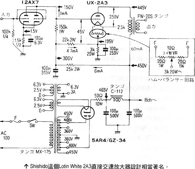

And here we have the Nobukazu Shishido 2A3 with a very similar topology. Once again we see the operating point for the input tube. Yes the two halves are paralleled, but each tube is at only 0.5mA, similar to Asano. And the ratio of Rp/Ra is 150k/40k = 3.7.
Both Are very similar so perhaps the Shishido design was simply based on Asano with a modern input tube instead of the 2A6.
Again, there is a pair of resistors designed to drop the B+ voltage to the front end. Whereas Asano used a 60k + 50k divider Shishido uses lower values of 25k and 22k which has the benefit of flowing more current. A larger cap is used (100uF vs 20uF) to ensure the RC filter is still as effective.
the designers have decided that the effective B+ for the front end should be only 295V - 300V to achieve a particular operating point.
yes, having a fairly large plate voltage for the input tube is a plus...
considering that the 2A3 grid is biased at -45 volts, having 150 volts at the 12ax7 plates
means there is a lot more swing available to push the 2A3 grids around..
i suppose you can run 12ax7 with more plate current though but i am not sure what it will bring....

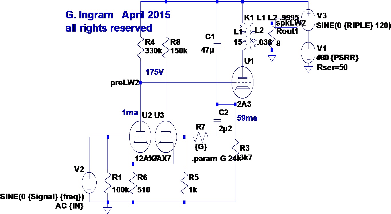

Looking at a Loftin-White noise cancelling option
The 12AX7 doesn't do well without a bypassed Rk, gain falls, plate impedance rises and h.f. roll-off starts way too early.
One option is to reduce Rk so that the plate impedance is kept reasonable. I think this can be achieved if the other half of the 12AX7 is used as a buffer to driver the hum cancelling signal into the cathode of the input tube. I alluded to this approach earlier in the thread.
The attached schematic explains the idea. Simulations show that it preserves the gain and drive capability of the input triode. It avoids use of a Ck and achieves the L-W noise cancellation. It also retains the same triode loading factor as Isamu and Shishido with Rp/Ra about 3.7

That is correct. Yawn. So, instead of trying to eliminate the bypassed Rk, why not spend some time and money thinking of how to execute it properly, and as best as possible ??
A properly executed Rk bypass takes lotsa $$$ to do well, as only the best quality caps will work well, but it brings something to the table that you can't get any other way !!
What does it bring ?? The ability to linearize the circuit by ear, at the speaker voice coil. How?? Different value caps tend to play different parts of the music, and, by combining the Rk Bypass caps artistically, we can gain more in music's nuances, layering, and subtle clues, that make listening more realistic to our ears, and to our minds and emotions.
I think there are only one or two people in tube audio world who have optimized the art of Rk bypassing. Its time others self-taught themselves how to do so.
With an ideally bypassed Rk, one half of a 12AX7, running under 1 mA. becomes the best possible tube candidate to run the 2A3 grid in a direct coupled two stage amp. How is that for a statement, conventional dudes ?? !!!
Of course, average tube enthusiast people look to conventional theory, so.... NO ONE can figure out how it gets done. The Serious Stereo DC 2A3 amp made in Montana by Dennis Fraker exists ( since 1989 ) and fulfills ALL the criteria, and is living proof of what I espouse. Think some, about HOW to best bypass an Rk, and we on our way !!

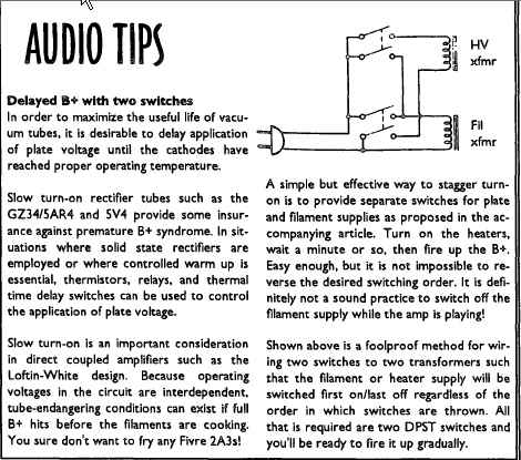

If I press forward with the parts on hand I will end up with a SS rectifier and this is going to result in a current surge through the 2A3 when it's filament comes up to boil and has to charge up it's associated cathode capacitor. Before running back to tube rectifiers I want to give some thought about an elegant solution to this.
Double ON OFF switching with Filaments having Priority, and, about a 10 uF main film cap, PLUS its critically chosen multiple film bypasses for the 2A3 Rk. Not the single large uF capacitor you show. With one film Rk cap, the music will "tune" to its value - which should be avoided.

i favor separate plate and filament power traffos, i am making a set of traffos for
a Tabor clone that my friend is building...it will have just two traffos, two OPT's and two chokes....
delayed B+ is good for transmitting tubes running B+ in the kV range..
for home use amps, who cares? not me....
