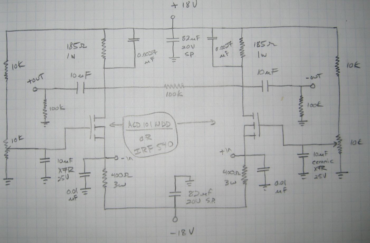

Hi Guys,
Looks like a few people are getting restless here, so I figured I had better pop in. Sorry for the long time away, I've shelved this project as I await the arrival of the Buffalo II DAC I purchased. It won't be in until March 15th, and I'm hoping to have boards done shortly thereafter.
As for development status, I've attached what I consider to be the final product in its best possible form. It's what I'm using now, and It's good enough that I'm done playing with it.
You can feel free to build it with almost any mosfet you choose, and it will work very well, but I suggest larger, higher current fets as that was the only trend which consistently measured better. IRF540's work perfectly, so do FQA46N15's. My personal favorite, and the best measuring device is the lateral ACD101NDD if you can get your hands on it. I rolled ten different matched sets of fets in and out of this stage, and most measured so closely that the difference wasn't worth worrying about.
I've foregone the entire B1 buffer section, so you now have only one gain stage/device. The output impedance is about 185 ohms which is better than the B1 anyhow. Fewer parts, better performance, better sound, lower cost. This circuit is really only for balanced use, if you want SE, use an op-amp as a diff to SE converter, or a transformer.
You can toss this together on a piece of veroboard in an hour, and give it a listen. No need to wait for a PCB, although one is coming.
I really enjoy it, it's one of my favorite little circuits. Please excuse the hand drawn schematic...

Hi Owen, great work and thanks for posting your finding and esp. your circuit.
Sorry if I had some questions, I had thought that the drain resistor (185R) determines the I/V gain and source resistor (400R) set the bias current (guess I am wrong). So how to calculate the output voltage to be 2Vrms for this?
I have a dac with only 1.2ma current and just follow original D1 circuit but use 2K for drain resistor to have reasonable output.
Thanks.

Without the dac attached, I adjusted the trimpots to read 0V, measured between the input and ground. Is this correct or should I adjust to 1.65V between input and ground?

great job. I am curious, you originally had a different FET shown. Did you make your final selection based on the sound quality or just electrical performance? Was it just coincidence that the best measuring was also the best sounding?
I am building a very similar I/V, but was planning to use the original IRF610. Now I may try a few of the other devices.
Do you think the sonic differences between FETs is worth experimenting with? or in your experience do they all sound about the same?

ChuckT: This circuit won't give you the gain you'll need with such low current output from the DAC. I can run a simulation later tonight and let you know what the best values would be. If i were you, I'd settle on less gain to get maybe 1 VRMS since you probably have more gain than you need later on. I'll get back to you.
Yunick: I did mine by adjusting to 1.65V with no dac, then attaching the DAC and re-adjusting to make sure. This reference depends on the DAC of course, so consult the datasheet for the correct value. Some of the TI DACs want to see 2.5V there.
qusp: That's the spirit... it's so simple that you might as well give it a shot. If you want to simplify it further, you can omit the 0.01 and 0.0027 caps for initial testing. I would suggest using them in the final version however.
Jmertz: I ditched the original fets mostly because nobody seemed to like using the odd pinout/footprint. They also ran very hot because they were so small. As for sound quality, we're treading into dangerous waters. The measured differences are somewhere in the range of -102dB and -107dB THD+N. I personally don't believe that anyone could reliably identify one fet from another, but I'm sure others would argue that. I think the perceived difference had to do with the better temp stability of the larger parts, and I was probably biased by whet I knew was the best measuring devices.
