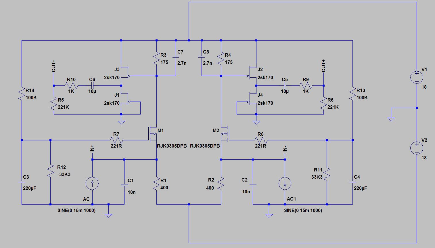

Hi Regal,
Sorry for the late response. I've attached a schematic that will work well with DAC's requiring 2.5V at the output.
Ignore the 33k3 value for R11 and R12, what you need there is a 50k pot. Start about midway (25K) and adjust to obtain 2.5VDC at the source of the fet. When that is set, you should see very close to 9VDC at the drain.
I'm not sure how much gain you need, but if you tell me what DAC and what configuration you plan to run, then I can dial in R1, R2, R3 and R4 to get you whatever you want voltage-wise at the output.

Hi Guys,
I'm about to take a second run at the layout, and I have a general question about what people prefer as far as SMD and PTH components go.
I've been building with SMD parts for a while now, and I definitely prefer them, but I have noticed that people seem to prefer building with though-hole parts.
What is the general consensus on parts for a project like this? I've got some preferences of my own, and maybe people would like to comment:
Refer to the schematic attached above for designators.
R1, R2, R3, R4 - Panasonic 3W metal oxide or Caddock MP930 or 4x 1W thick film SMD (2512)
R5, R6, R7, R8, R9, R10, R13, R14 - Standard 1/4W PTH (300 spacing) or 0805 SMD
C3, C4 - 5mm spacing 10mm diameter solid polymer Nichicon - PTH
C1, C2, C7, C8 - 0805 SMD C0G/NP0 5% or PTH C0G/NP0 5% or PTH film
R11, R12 - Pots - standard 3-pin through-hole?
C5, C6 - Space for large film caps
J1, J2, J3, J4 - dual LSK170 SMD SOT123 or single LSK389 SMD SOIC
I could probably provide the boards with SMD parts pre-soldered for those who are afraid, but overall, it's easier than PTH to work with.
Any comments would be great!
Owen

Hi Guys,
I've combined the excellent transconductance of a power mosfet, with the low distortion of a JFET buffer to get to the circuit below. It's basically a low impedance D1, with a different mosfet, and a B1 buffer in place of the old mosfet based buffer. You could probably call it a D1B1.
Owen
Hi Pidesd,
I suppose both congrats and condolences are in order. Could you draw up exactly the circuit you were using, and what the voltages were at each of the fet nodes with respect to ground?
I've only tried the one mosfet so far, but I took the time to simulate several of them, and there wasn't much difference between them other than the voltage required at the gate to adjust the circuit.
I should be clear about power dissipation and requirements:
- R3 and R4 dissipate just under 1/2 watt each. Use at least 1W resistors.
- R1 and R2 dissipate just under 1 watt each, use at least 2W but 3W is better.
- Each mosfet dissipates a little over 1/3 of a watt, so it will be toasty.
- All other parts can be anything you want.
If you're uncomfortable running the fet that hot, then either add a little heatsink (the small tab mount TO-220 should do the trick) or use SMD parts and add some copper area to the PCB.
I'm glad you took the time to build it, and if you post your schematic, I'm sure we can figure it out!

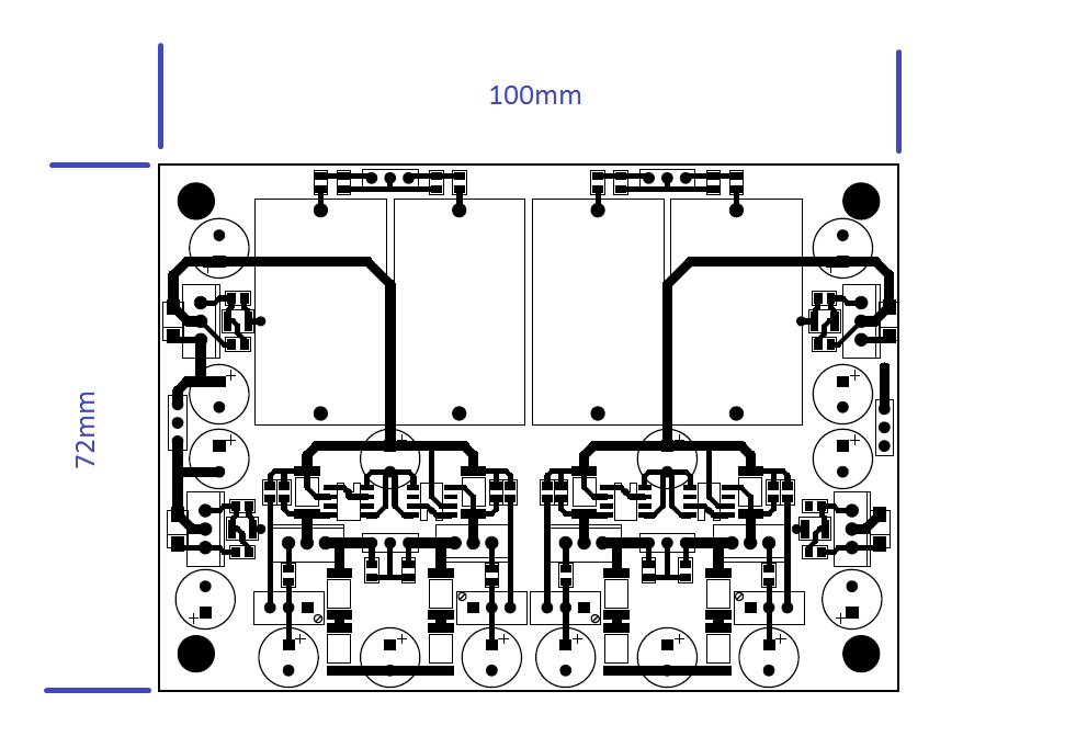

Thankyou, probably would be the TI PCM 1794, 7.8 ma p-p
I forgot to give the update on the layout... everything is pretty much done, and I'm about to send it off to Acko to check against his PCB. There are some differences, but I'm going to see where he can give a little, and where I can.
As you can see, it's not a lot of space (100mm x 72mm), but everything seems to fit. I've crammed the +/- 18V regulators on the board, but it's a very tight fit, and I'm not sure if people would rather have the regs off-board. Any opinions are welcome at this point. I personally would rather have them on the board, and I can provide tie-points for bypassing them if you want to use your own off-board regs.
I still need to talk to Acko about running the board wider than his DAC, which I don't think will be a problem. If that's a go, then I can layout the regs in a more optimal manner.
The board is two layer, ground plane on the bottom, signal and power on the top. I'll be splitting the ground plane in the middle of the board, so each channel has it's own plane. I'll provide multiple tie points for grounds, giving the user the option of tying the grounds at the DAC, at the PSU, or on this board itself.
The only other issue is output coupling caps. I've left space for 27.5mm spaced radial caps, that are 18mm wide and 31mm long. I'll be using 8.2uF Epcos polypropylenes (B32674D3825K) but others may want to use their favorite caps. As you can see, I've already given up over half the board area to caps, and I can't afford any more. I can provide pads for smaller caps, as well as electrolytics if people would like, but you're not going to be able to put monster sized films in those spots unless you mount them off-board and wire them over with flying leads.
Check it out and let me know if there are any comments!
Owen
