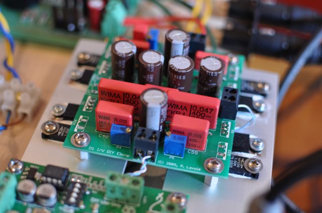

As it turns out, I have been using a D1 I/V stage with an original buffalo DAC for about a year now. Sound is laid back, with layers and layers of detail. It compares favorably to anything I have heard.
As Owen pointed out, new DACs like the ESS swing more current than the PCM63. Referring to the original schematic, I made the following changes to increase bias threefold:
- R26, R33 decreased from 3.3 K to 1 K
- R27, R34 decreased from 1.5 K to 470 ohms
To keep the same cutoff frequencies (RC) for the low pass filters, the following capacitors were adjusted accordingly:
- C40, C45 increased from .01 to .033 uF
- C15, C16 increased from .0027 to .0086 uF
I could not trim the output voltage to 1.65 V without reducing R24, R31 from 100 K to 68 K. The rest of the D1 I/V circuit is stock. Never had the imagination of trying it without the buffer stage. Now I'm curious...

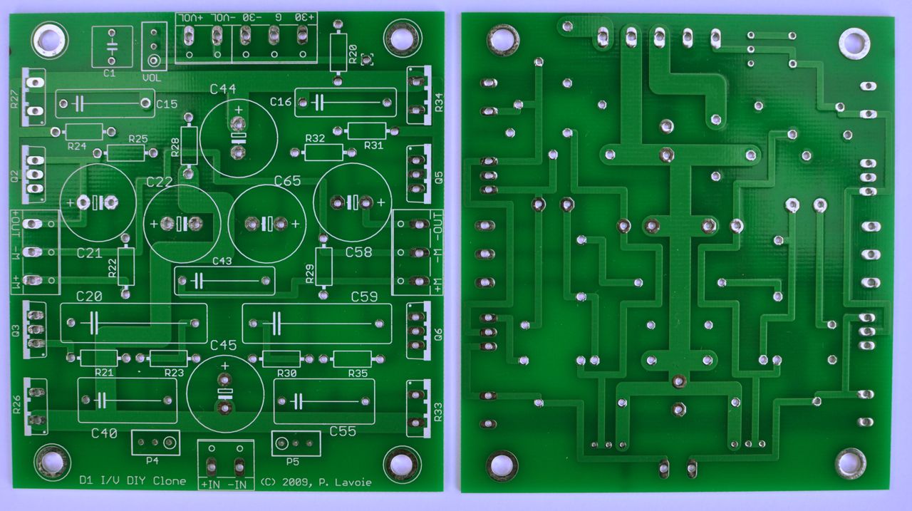

Here's a picture of a naked pcb. Nothing fancy: connect ESS Sabre to input (+IN, -IN), provide power (+30, G, -30), and hook outputs (+M, -M) to XLR connector. You may connect an external volume control (+VOL, -VOL), trim volume with a pot, or skip that portion of this circuit if you prefer. Part numbers match the D1 schematic.
I have a few pcbs left, available on a first come first served basis.
Pierre

Some have asked about using one balanced board for stereo (e.g. using +in and +M for left channel and -in and -M for right channel). At quick glance, it appears to simply require replacing the differential volume pot and output cap C43 by two pots to ground, and two caps to ground. It looks straightforward (no physical changes to the pcb) and I would expect the circuit and board to work this way.
However, you need a single ended output DAC to go that route. Now note that the ES9008 has differential outputs, and that some well regarded commercial products use single ended output DACs in differential mode. There must be a reason - and I would guess that it helps noise rejection.
