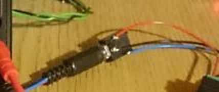

More dramatic developments: There is most certainly an issue with connection quality, most probably grounding. I am using 3.5mm TRS jacks and the corresponding sockets to transfer dual DC power (which is a bad, bad and dangerous thing to do kids, and don't try this at home).
851387d1591741394-mysterious-power-transformer-connection-jpg
By rotating the jack inside the socket, noise levels can change dramatically. So this is a very serious aspect to take into consideration and all further experimentation will be done with as little jacks/sockets as possible, in other words using soldering and screw tightening over leads only.
- Yes, it is bad both for sound wires and for power too, for various reasons (a large and unstable contact resistance etc). I use either screw connectors (DG301 etc) or wire-board-type NX25/NX2500 (NXW-03 etc)
Not to mention the huge risk for shorting if you insert or accidentally pull while power is on. The tip will short the socket's tip and ring, definitely not a good thing. I 've had this happen momentarily with my SMPS, it escaped getting fried with a brief buzz and a slight smell. I have to admit it smelled good to me though. 🙂

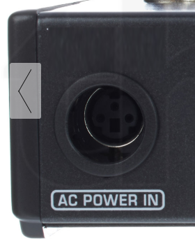

A further note along these lines, do you guys/gals recognize this kind of 3-pin socket? I am interested in buying some of these sockets and also hopefully the corresponding connectors. This is the back of a small mixing console btw, it has an external dual AC power supply. Please let me know if you have used it or know the type!
attachment.php
To kind of answer my own false alarm question, I think it's safe to say that the AC POWER IN displayed is a 3 pin mini DIN socket.

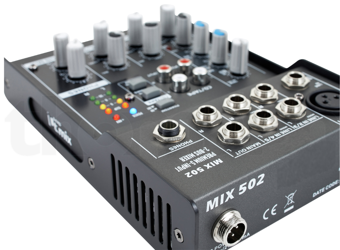

The socket I really meant to ask about is show in the following picture, again it's a small mixer with an external power adapter. This is the best angle I could find of the 3-pin socket. I included the full device for size reference. If anyone recognizes this I 'd be grateful if they let me know which type it is. I find both the 3-pin mini DIN and this unknown one very appealing for dual voltage power supply.
