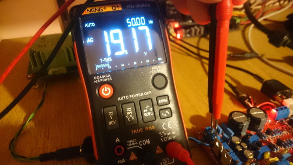

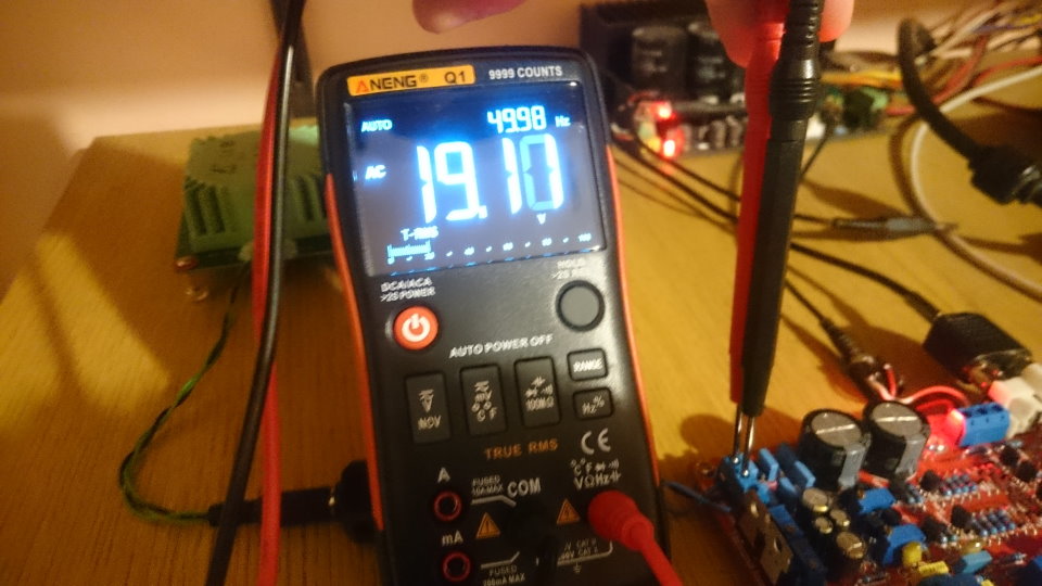

As my earlier post shows, I was completely oblivious to these facts. But I also now fully understood the points in your post, so thank you.
Before reading your post I had found the courage (from the spec sheet) to connect the transformer to my preamp (preamp spec: max dual 15VAC). I expected to see 15VAC (after all the transformer is "under load"). I didn't get what I expected:
attachment.php
attachment.php
So, from 19.425VAC average, voltage drops to 19.140VAC average. A very slight drop and very far from 15VAC. A reminder from an earlier post in this thread:
Using the dual AC output, I ended up setting the regulator to 20.63VDC for the SPS input. In contrast, I needed about 23VDC when using the DC output. AC used more power, the regulator reports a power draw of 5.29W vs just 2.46W when using the DC output.
These power indications came from the voltage regulator I was using. I am assuming that the preamp draws only something like 3-4VA, therefore the distance from 15VAC.

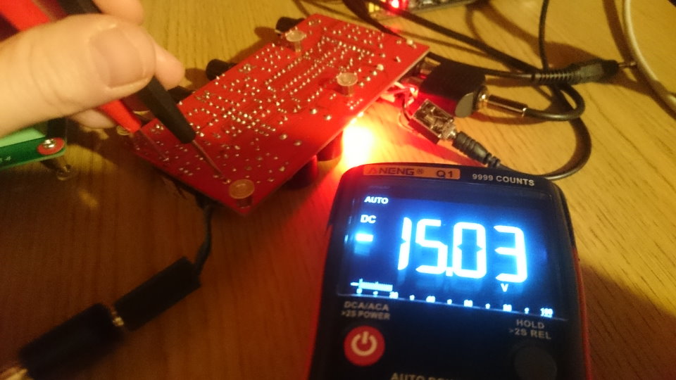

Another interesting measurement I made was DC voltage on the board after the LM317/LM337 regulators, with the 19.140VAC input:

The post bridge voltage prediction was quite accurate. It is in fact +-24.6VDC. The capacitors are rated at 25V.

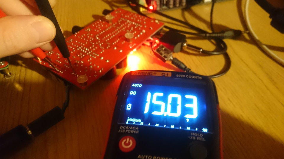

I am glad to hear that +-15VDC post regulation is fine. Like I mentioned, regulator input is +-24.6VDC and the board has 25V stabilizing capacitors. The regulators do feel hot but not much hotter than what was my previous setup (+-16.4VDC input that ultimately translated to +-14VDC post regulation). I 'm assuming they will be just fine.

To kind of answer my own question and measure how things would work out if I added an additional device in parallel (L-R crossover), I just did it. Some numbers:
Code:
preamp alone
input:
+-19.08VAC
capacitors:
+-24.56VDC
post-regulation:
+-15.03VDC
preamp and L-R x-over
input:
+-18.34VAC
capacitors:
+-22.75VDC
post-regulation:
+-15.03VDC
I was totally NOT expecting the post-regulation voltage to stay the same, as I was used to seeing it go up and down according to the dual DC voltage I fed the preamp (I had left it at +-14VDC, best my SMPS could do without frying). Then I had this ->
Profound Epiphany: Regulators are there to provide a stable, specific voltage, provided you offer them enough power.
It is clear that the good people at the factory have set the trim pots near the regulators to +-15VDC. That's what the board wants and that's what I 'll have to provide should I want to somehow bypass the rectification or even regulation stages.

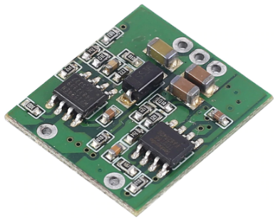

Global 24VDC Dogma or, to put it another way, "My Lord, I have a cunning plan."
Greetings all, I hope everyone is doing well in these somewhat crazy times. A special hello to Rick after more than two months since his last response.
Allow me to present you with this:
attachment.php
attachment.php

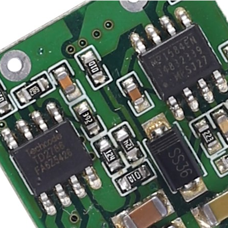

It is a DC to dual DC step down regulator. This particular board is set up for +-15VDC output and an input voltage up to 28VDC.
The ICs on this tiny (20mm x 23mm) board are denoted Techcode TD2786 and MPS MP1584EN:
http://www.techcodesemi.com/datasheet/TD2786.pdf
MP1584EN datasheet(1/17 Pages) MPS | 3A, 1.5MHz, 28V Step-Down Converter
I find it peculiar that they are using different step down converter ICs due to the output voltage symmetry, but I'm sure there's reasons.
So, as you might have guessed, the "cunning plan" is to use the tiny board's output to power the preamplifier board. After all, the preamp's regulators are precisely set to an output ("rail" voltage) of +-15VDC given enough juice. Doing this would change my power chain from:
LED power supply (24VDC) -> Voltage regulator -> SMPS -> preamp
to:
LED power supply (24VDC) -> tiny board -> preamp
So, it's pretty appealing.
As you might have guessed I took the liberty of connecting the tiny board's outputs directly to the preamp +-15VDC "rails" completely bypassing the rectification bridge, capacitors, and LM317/LM337 regulators. The question is, will it work?
The short answer is, urm, no. The board was operational, could reproduce sound, but the big problem was: noise. The type of noise I would describe as old analog TV or FM radio static. Oddly enough, as I managed to fry one of the two boards I got by touching it as it was operational, the second board produced a slightly different noise, but still pretty loud. So with this setup I had precisely +-15VDC on the pre's "rails" but very poor function.
Then it dawned on me, perhaps feeding the LM317/LM337 inputs with the tiny board's output would improve things. I tried it, and the noise went away for the most part - but - on the right channel only. A small note here, when I feed the board "normally" with +-15VAC there is hum, very slight on the right channel, but much louder on the left channel. So I witnessed the same thing with using +15VDC at LM317/LM337 regulator inputs, and to be honest, this could indicate poor construction or damage from my part. For the record, regulator output ("rail" voltage) was +-13.45VDC. Some drop, but expected given how the LM components work. Acceptable voltage levels but still no fireworks. (Urm, I think that was an unsuitable expression to use in this context.)
My final move was to connect the tiny board normally, pre rectification. Short story is, I get +-12.7VDC post LM regulation, the board works, and there's zero noise. Or at least, no more noise than when I powered it using other means. So it works and I should be a happy camper.
But still, something bugs me. Could I somehow have my available +-15VDC work? The preamp board is polite enough to work (normally?) at +-12.7VDC but what would I do if it didn't and my only power source was this nice +-15VDC step down regulator? In short, I am wondering if I could somehow eliminate the noise that shows up when connecting the tiny board outputs before or (even better) after the LM regulators. If you guessed I am generally thinking about various capacitors, you guessed right.
So, any ideas? And, for curiosity's sake, what's the cause of this static like noise? I really didn't expect that but silent operation instead.
I hope this was not too verbose, and thanks for reading till the end.
Yanni

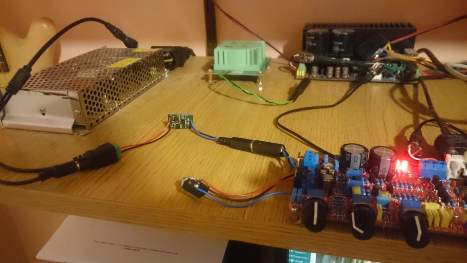

It works! Apparently, as the LEDs are not as bright as they could be, sadly. 🙂
At the bottom there's the "naughty" connection to the LM regulators. In the background, my +-15VAC transformer (unused atm) and my LM3886 power amp which I love.

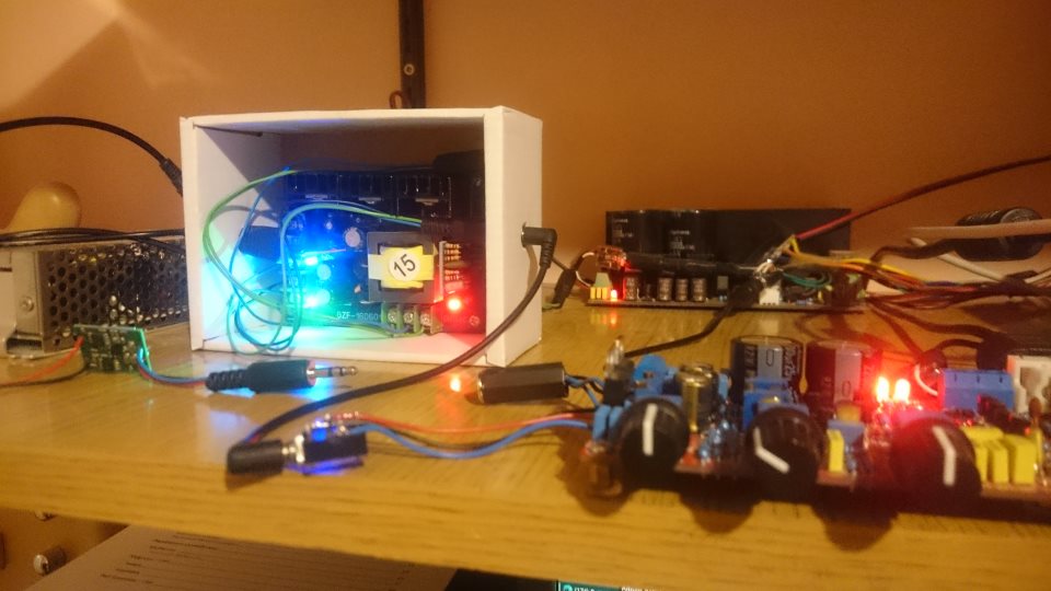

Thanks Rick for your response.
So I did the unthinkable:
attachment.php
The unthinkable being, connect the output of my SMPS (the device I opened this thread for) directly to the preamp's +-15V rails, post regulation. What I wanted to check is if I would have the same problem with noise that I had by connecting the tiny +-15VDC regulator board the same way.
The result was, zero noise. So I think it's clear the problem with the tiny regulator board is the way I am coupling it to the device. The bigger SMPS produces its output from hfAC so there's more than a couple of components before its dual output. Rick's recommendation about RC filtering sounds like the way to go.

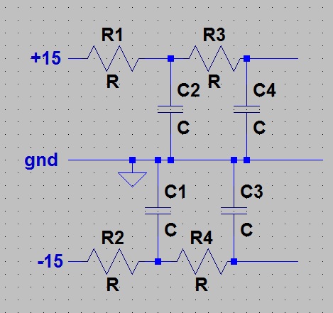

The filtering can be pretty simple, but you'll probably have to be willing to give up a few tens of millivolts. Do we know how much current the preamp board needs?
Another option would be to turn down the set-points of the LM317/337's. The preamp will surely work great with +/-12V rails -- maybe a decibel or two loss in headroom. But it isn't headroom you can use, unless you were to pad the output down 12 dB or more.
Once we know the preamp's current needs we can choose values for the filter resistors.

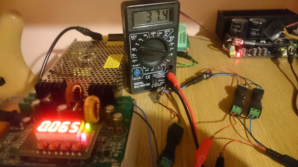

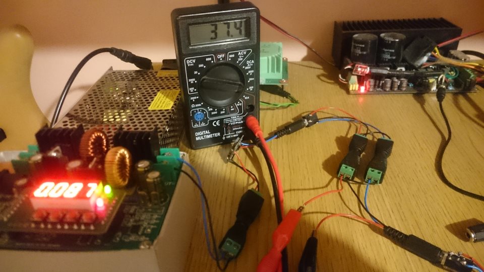

And sooo... some measurements. 🙂
attachment.php
attachment.php
When fed 24V, the regulator module (right in front of the multimeter) draws 65mA to maintain its output voltage of +-15VDC. Just for fun I dropped input voltage to 18V, and it drew 87mA to do the same job. So in both cases it consumed about 1.560W of power. Flexibility is so very nice. 🙂 The important figure I was after, rail current, was 37.5mA in both cases. Assuming the other rail draws the same current, Power consumed by the preamp was 15.02 x 2 x 37.5, about 1.125W.
PS. Amazingly, I just noticed that noise levels depend on regulator module input voltage. When well over 20VDC, say 24VDC, there is definitely noise but not too severe. As voltage drops below 20VDC noise gradually increases until the regulator collapses (can't maintain its output) at about 16VDC input.

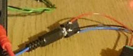

More dramatic developments: There is most certainly an issue with connection quality, most probably grounding. I am using 3.5mm TRS jacks and the corresponding sockets to transfer dual DC power (which is a bad, bad and dangerous thing to do kids, and don't try this at home).
attachment.php
By rotating the jack inside the socket, noise levels can change dramatically. So this is a very serious aspect to take into consideration and all further experimentation will be done with as little jacks/sockets as possible, in other words using soldering and screw tightening over leads only.
Unfortunately, at their best, the noise levels are still unacceptable. So I would like to explore the RC filter option and also check what Rick mentioned earlier about this kind of component's notorious reputation for producing EMI (although the IC manufacturers claim the opposite, low EMI).
I will be recording the preamp's noise throughout the whole process. It will be lots of fun for me, especially the measuring noise power part and also if I manage to reduce noise to practically inaudible at near +-15VDC. 🙂

I'm gonna guess you don't want to 'sacrifice' more than about 100 mV from each +/-15V supply. That limits you to 2.67 ohms total between each pair of series resistors. Depending on the capacitors (both capacitance and other qualities -- ESR, dielectric absorption, possibly others I know nothing about) and the layout, that may not give enough attenuation. While I'd never want to discourage someone from working through the math, it may fall short of the desired payoff. At series resistance values this low, a few 10's of milliohms of capacitor ESR (or such a difference between spec sheet and 'real' values), for example, can corrupt the calculations by many decibels. Then there's the problem that we don't really know very much specific about the racket we want to filter.
I guess I'm suggesting 'trial and error' as a more expedient approach. If the attenuation still isn't enough, maybe try to source a couple of ferrite beads locally and see if that helps. An amateur radio store should be able to help, if you have one nearby.
Still, this is going great!
Cheers
I somehow sensed it would require some trial and error. I imagined you would suggest values for R and C and then I would ask you for a set of alternative values to try out too. So could you do this? Using your electronics intuition, recomnend 2 sets of RC values? If anyone else would like to chime in, by all means go ahead. I'd be happy to sacrifice say, 100-200mV and why not 500mV if it turns out it's necessary. I won't be doing the math to actually figure out some good values for R and C, it's just an exercise to freshen up my memory on signals and systems theory I did in uni long ago. 🙂
