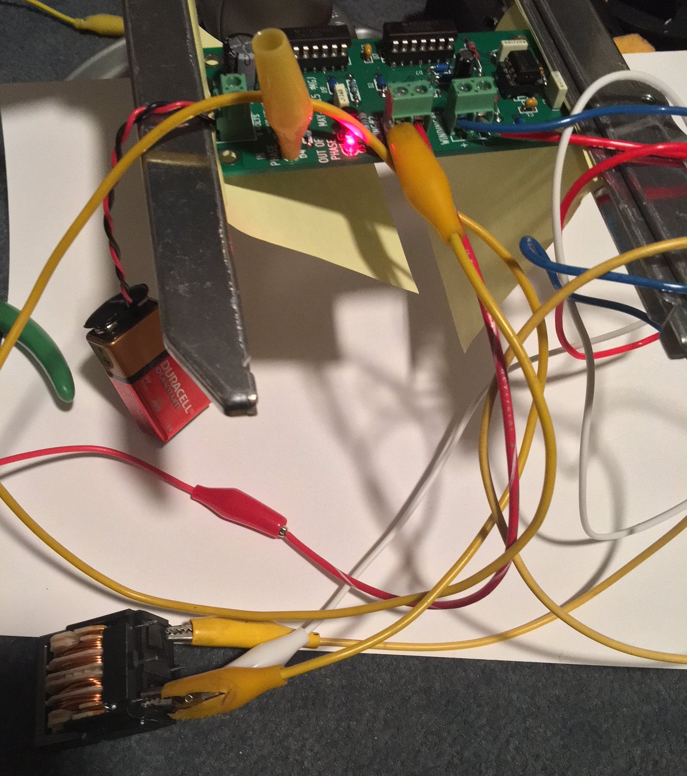

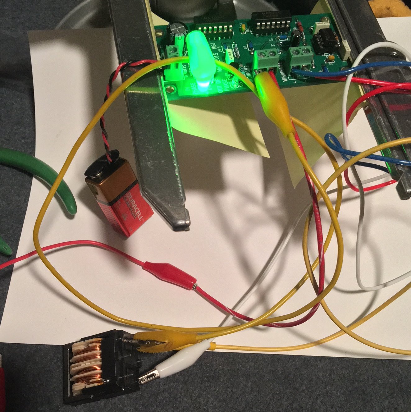

A nice little kit was delivered by the post person today. I look forward to assembling and using Marks little kit.
And the Phasedot tester works. I've noticed that you can do it with three wires.
two on the primary and it will find evaluate the the polarity of the secondary. In this case a choke. yellows are positive.
