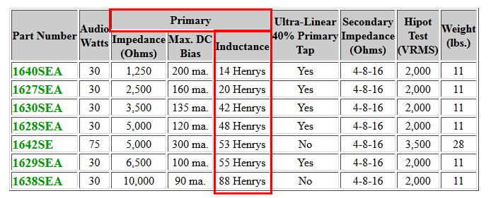

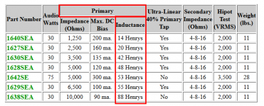

The short answer is: I don't know because I haven't tried this. And I'm surprised to hear that output transformers have multiple primaries or multiple secondaries, so that it's important to get the phase dots correct.will the tester work with output transformers ? (tube amps)
The long answer is: it depends on the impedance of the primary at the test frequency (150 Hz). Referring to the schematic, which is Fig2 of post#1 in this thread, a series circuit is formed. The oscillator chip's output at pin 3, drives (R6 in series with R7) in series with the impedance of the transformer primary. If the transformer primary's impedance at 150 Hz is very low compared to 136 ohms, then the signal across the primary (node W1) is very small. Because it's a step-down transformer, the signal across the secondary (node W2) will be even smaller. It might be too small for the phase detector to detect ... and the tester's output will be unreliable.
Also, if the primary impedance at 150 Hz is very low, the series network to ground will conduct lots of current. In the worst case, 9V/(68R+68R) = 66 milliamps. The resistors are dissipating 0.6 watts (!!) and will get very warm.
There are a few options available to you:
- Forget about the PhaseDots tester and just use a scope and a signal generator instead.
- If the cost of a PhaseDots tester is so low that you wouldn't be upset if it doesn't work with your transformers, then buy it and try it.
- Unlike 50 Hz mains transformers, output transformers are designed to work well at 8 kilohertz. So modify a PhaseDots tester's oscillator to run at 8kHz (i.e. decrease capacitor C9). The primary's impedance will be 53X higher at 8kHz than at 150Hz, and the probability of getting good results from PhaseDots will increase by a factor of 53X.
- Look up the datasheets of a few output transformers, which you consider to be representative of the sorts of transformers you might want to connect to PhaseDots some day in the future. What's the impedance of the primary at 150Hz? If it's higher than, oh let's just say, 120 ohms, this gives you confidence that PhaseDots should operate correctly with these.

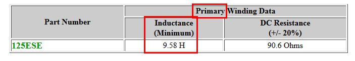

I took my own advice and looked up a few datasheets. Beware! I am not a tube guy so I looked up tube output transformers whose name I have heard: Hammond. I don't have any idea whether these are well-loved, or vituperatively despised, by diyAudio Tube aficionados. Nor do I have a clue whether they are comparatively cheap or wildly overpriced. Hammond is the only name I knew, so that is the transformer website I visited just now.Hi Mark will the tester work with output transformers ? (tube amps)
And what I found there was very good news! The impedance of the primary of these Hammond output transformers, is nice and high! Plenty high enough for the PhaseDots tester to drive (and sense!) big signals whose phase is easy to detect. Good news. To calculate the impedance at "f" Hertz, we recall that Z = (2 * PI * f) * inductance. For the Hammond output transformers shown in the attachments,
- 1638SEA (L = 88H) primary impedance Z = 83 Kohms
- 1640SEA (L = 14H) primary impedance Z = 13 Kohms
- 125ESE (L = 9.5H) primary impedance Z = 9 Kohms
All of these have a primary impedance at 150 Hz much much greater than 120 ohms, so PhaseDots will test them just fine.

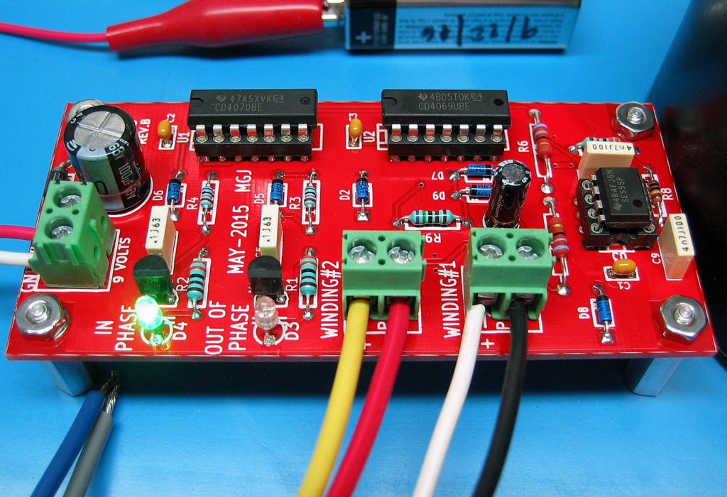

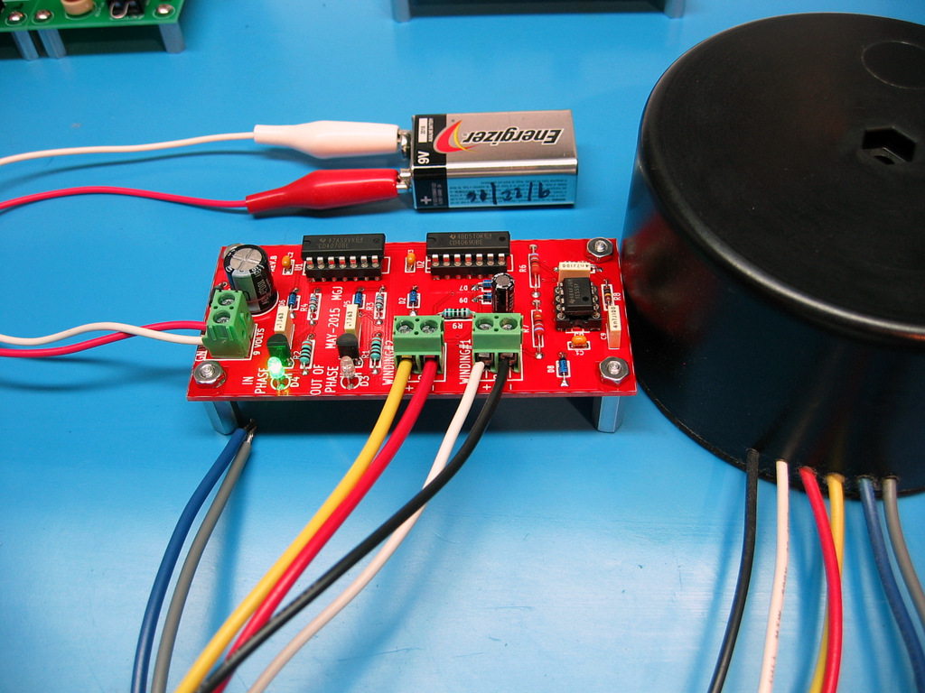

Received it, assembled it, used it. Had to try it over and over because it was so much fun. Works like a charm!!! No "magic blue smoke / possible death" cold sweats. I absolutely love this! I don't know why anyone would build the fancy power supply when a 9v battery works great. Now I've got to find some more mystery transformers!!! If y'all have mystery transformers, stick $13 dollars in an envelope and mail it. With croc clip leads hooked to it, it is so easy. Thank you so much!!! A Quasimodo that had leds that lit up when you minimized ringing would be cool.🙄

I have been using mine to get some old output transformers marked for correct phasing.
After they sit for 30-50 years in an amp or organ all the wires become the same dull grey color. Now I need to put this in a box to protect it from my carelessness.

I often use masking tape + Sharpie marker to label the wires after determining the PhaseDots. Then I don't have to remember which is which, or remember where I wrote down which is which.
Sometimes I'll also use a ziptie or a piece of cotton string, to gather together the wires of "Winding #N" into a bundle. It's helpful if you do your PhaseDots testing in June but don't actually assemble the PSU until September. Another countermeasure against unreliable human memory. The ziptie / string can be cut away and discarded during assembly, probably right at the moment you're twisting the wires together.
