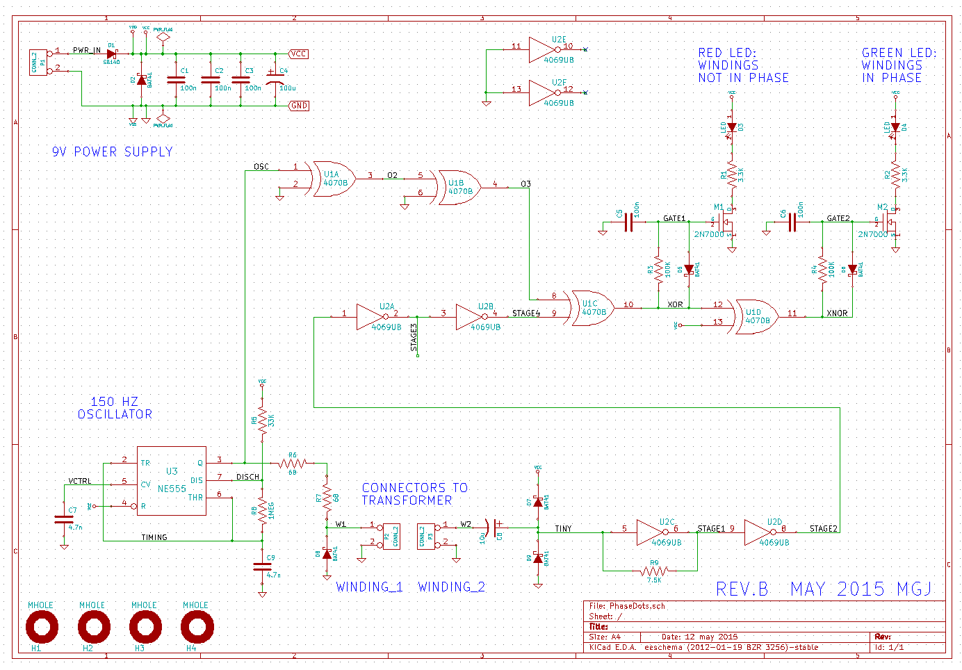

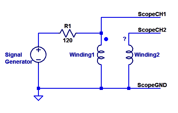

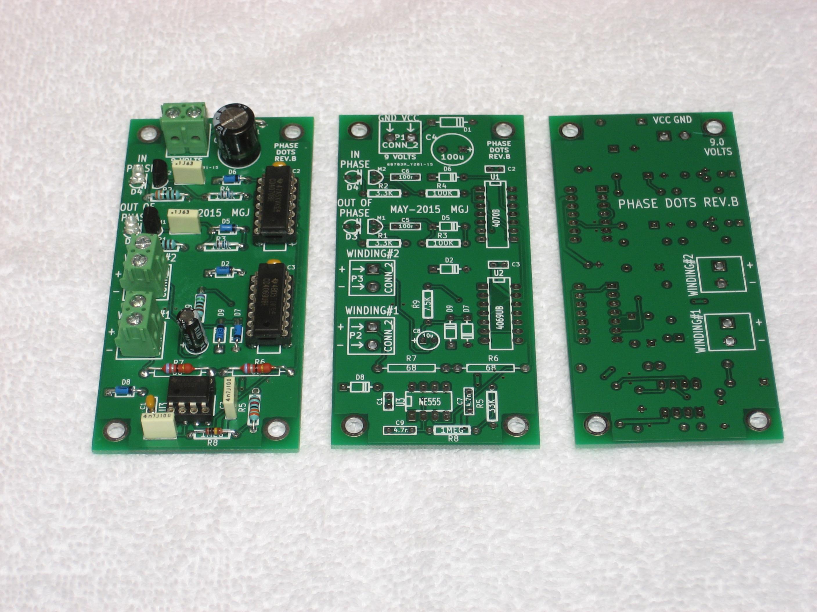

Transformer schematics include "Phase Dots" that indicate which ends of the windings are in phase. Unfortunately, many transformers in used equipment are not marked with phase dots, and quite a few new transformers are not marked either.
If you have a signal generator and an oscilloscope, it's easy to determine the phase dots: see the first picture. If scope channel2 is "right side up" compared to channel1 then winding2 is in phase with winding1, and "?" becomes a dot. And vice versa. However, some DIYers don't have a signal generator and a scope, so this little tester board called "PhaseDots" might help.
It operates on the same principle, but instead of a scope and human eyeballs, the circuit uses a phase detector (XOR gate) to decide whether the windings are in phase or out of phase. This lights up either a Green LED (in phase) or a Red LED (out of phase). Simple and unambiguous. The circuit schematic is picture#2.
A 555 timer/oscillator drives a square wave into transformer winding#1. The resulting waveform on winding#2 is amplified in a series of CMOS logic inverters (gain > 5x per stage) and compared in XOR gate U1C. If they're in phase, D4 lights up. If not, D3 lights up. RC pulse shapers with slow risetime and fast falltime, drive the LEDs.
In practice the tester board is simple to use. Connect one of the transformer's primary windings to connector P2 (labeled WINDING_1) and leave it connected. Then, one by one, connect all the other windings to connector P3 (labeled WINDING_2) and observe their dots. Write these on a schematic as you go. After the last winding: Boom, you're done!
It is important that the PhaseDots tester should always drive a transformer primary winding. (I.e. always connect a primary winding to WINDING_1). Why? Because transformer primary windings have sufficiently high self-inductance to ensure a long (L/R) timeconstant. This prevents the winding from behaving as a differentiator, ruining the input waveform and lighting up the wrong LED (or both LEDs).

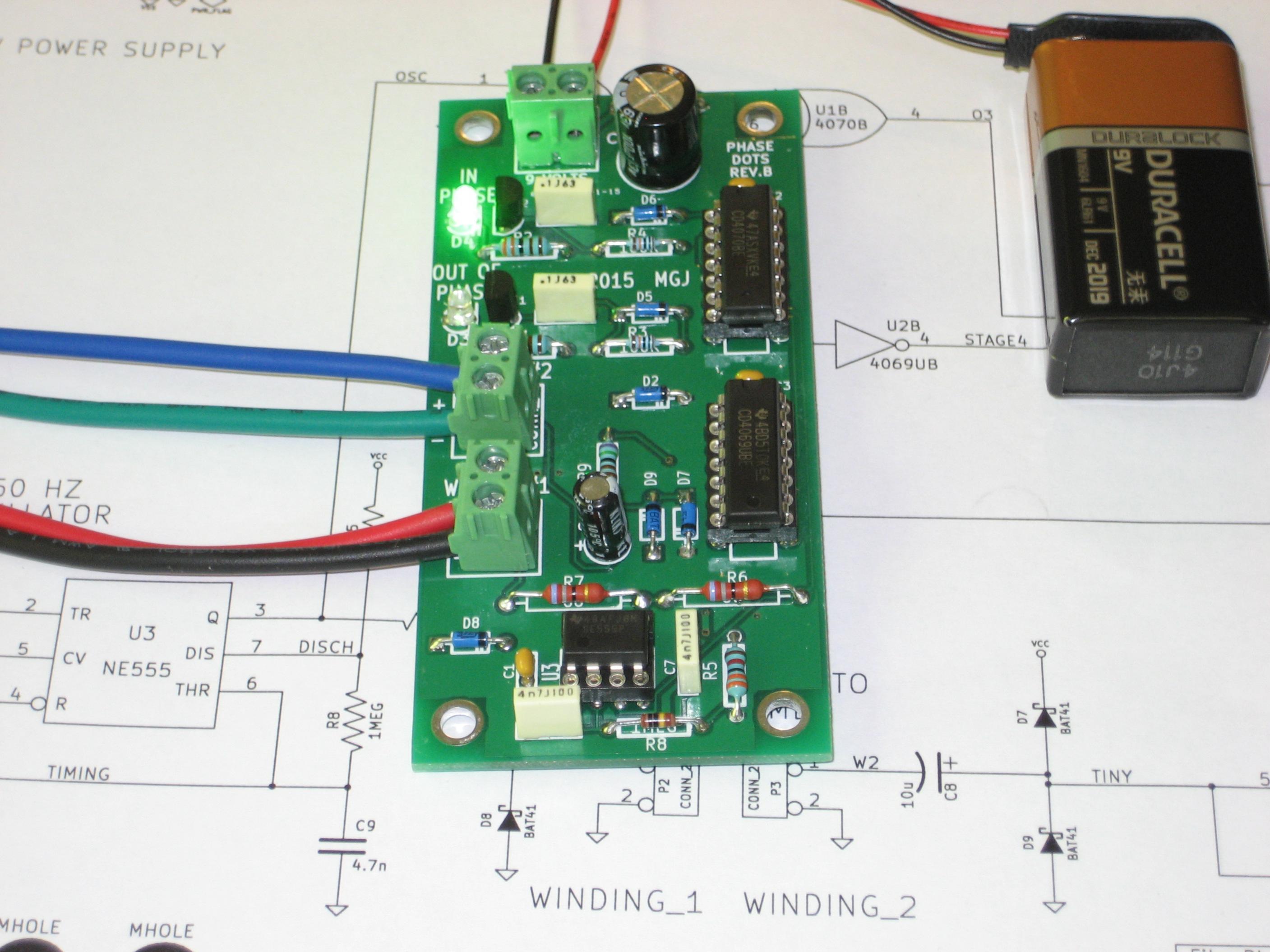

Picture 3 attached, shows the PhaseDots tester connected to an Antek AS-2222 toroidal transformer. Red and black are a primary winding, blue and green are a secondary winding. The illuminated green LED tells us that if red has a Phase Dot, then so does blue.

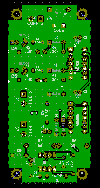

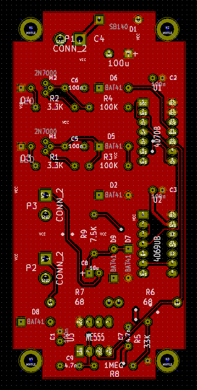

A few other pictures are attached, showing the PCB that I laid out. There's also a set of Gerber files that anyone can send to a PCB fab (I recommend PCBshopper.com to help you choose a fab) and have their own boards made. The Gerber files are included in a zip archive, along with a Bill Of Materials and other ancillary stuff.

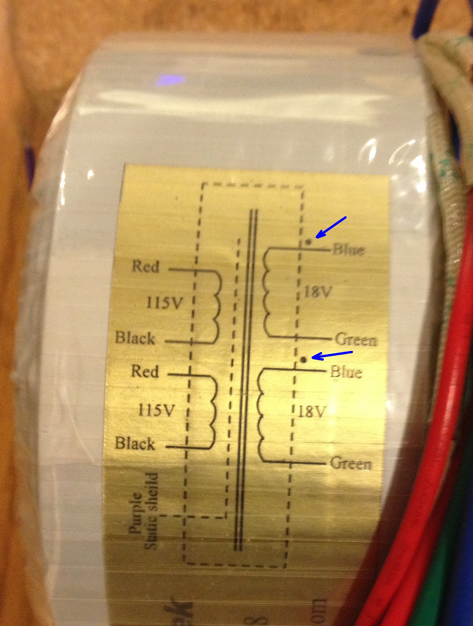

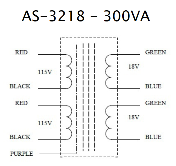

I don't think I have ever seen a transformer marked with "phase dots".
Let me introduce to the Antek AS-3218. Here is a color photo of the actual transformer itself, and a snip from the (black and white) datasheet on the manufacturer's website. Look for the blue arrows that I drew upon the photo.

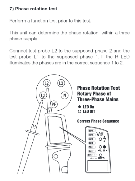

Step back all of you, a real electrician came in the village.
The all conversation is about a simple phase rotation verification.
Get this tool and enjoy.
UT15C Voltstick by UNI-T, product pictures by Kiriakos - ITTSB

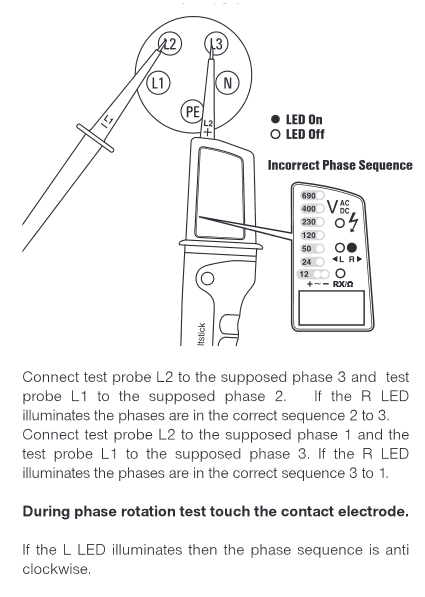

The user manual for the VoltStick is online. I screen-captured the pages that discuss its Phase Rotation Test feature. When you connect VoltStick to a three phase power distribution cable (AC mains), VoltStick tells you whether Phase1, Phase2, and Phase3 are labelled correctly.

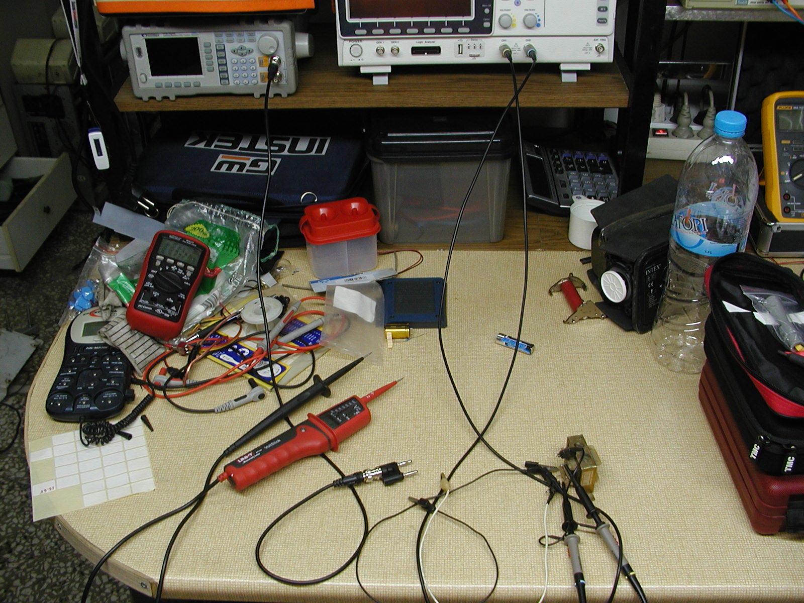

Well, boys in electronics use breadboard to play with components I did my own experiment with regular transformer by feeding it with signal generator and by using my oscilloscope too.
The Oscilloscope was used with both channels mostly for voltage confirmation.
UT-15C when used between L1 and neutral works as single phase detector.
I can tell neutral from live.
In my experiment I did feed 2V at the side of 12V transformer and from the 220V side I got about 80V as output.
By having active the test bed, I did connected UT-15C at the input of signal generator (positive) side.
By touching the other end of this tester at the output of the transformer the Green arrows was changing direction according to polarity change.
I did read and find info of your circuitry that is about measuring phase shift, at no powered transformer.
Well in my experiment I used the power it self so to show me the way.
Now my opinion is that this PhaseDots / phase shift detection, does no seems crucial.
Especially when the output gets converted to DC.
Personally I can not imagine anything using plain AC other than tubes so to warm up.
Additionally any reverse placement of the power cord, it will destroy the perfect balance (if there is such a thing).
Bellow is a picture from the crime scene.

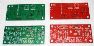

It turns out that I will have a few unused PCBs made from red laminate. While supplies last you can choose either red or green, whichever you prefer. When I run out of one or the other color, I'll post a message here and I'll stop accepting orders for that color.
The PCB shopper dot com website lets you specify the color of the boards when you ask for a price quote, and when you order boards. Red, white, green, blue, black, yellow, and purple are available from PCB fabs.

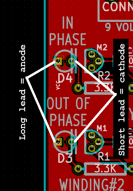

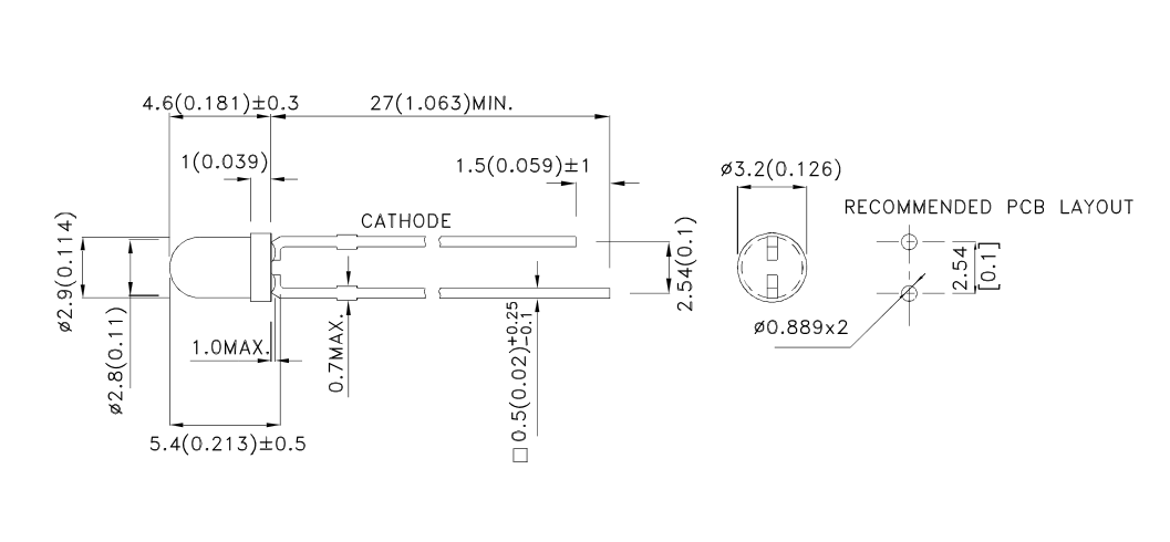

I've heard from early kit builders that the orientation of the LEDs might be a little confusing, so here is some additional information to help clarify the situation.
First of all, I apologize. The Kingbright LEDs I bought and shipped in the kits, really are confusing. Their datasheet mechanical drawing is attached below; notice that there isn't any "notch" or "flat spot" or mechanical key to help you visually determine which terminal is the anode and which terminal is the cathode (!!) The only difference you can see with the naked eye is: the cathode lead is shorter.
Fortunately we are resourceful people here at diyAudio, and so we realize that "visually" is not the only way to examine an LED. We've also got digital multimeters! If you get confused, or if you just want the extra reassurance of a double-confirmation, you can use the Diode Test feature of your DMM to tell you which end of an LED is the cathode and which end is the anode. Here are some internet resources to guide you
_

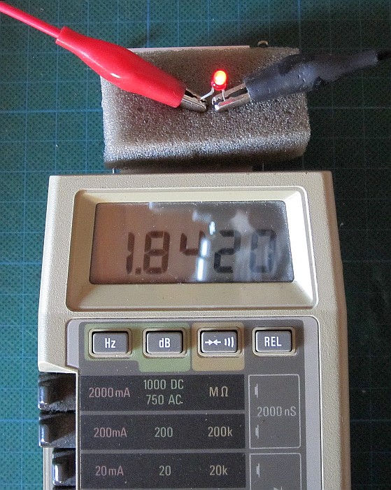

Well, there is another way if the LED is clear or semi-clear. There's a cup-like structure inside the LED. I guess it's what holds the junction as the light is emitted from it.
With normal LEDs, I have always seen that this structure is connected to the kathode and it clearly takes up more space inside the LED than the anode.
Why you are searching for a tree and lose the forest?
Just use your digital multimeter at diode function and done. See the attached pic.
