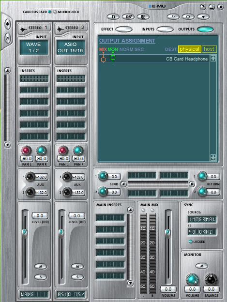

I'm trying out a secondhand Emu 1616M Carbus soundcard now. It seems like the Cardbus works alright, but I can't get any contact with the Microdock. I've attached a picture from PatchMix. Is there some kind of trick to make the connection to the Microdock?
