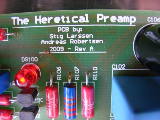

Hi SY, I don't know your test circuit, but if you get additional 'non integrated' gain, you'll get some trouble i.e. 'more interaction'.
BTW I think you know my topology.
http://www.diyaudio.com/forums/attachment.php?postid=1713343&stamp=1232013864

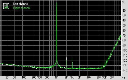

Rich, the load was the 10k input of my sound card. I measured at a sufficient voltage to clip any power amp I have in house (2.5V, if memory serves, haven't read the article in a while).

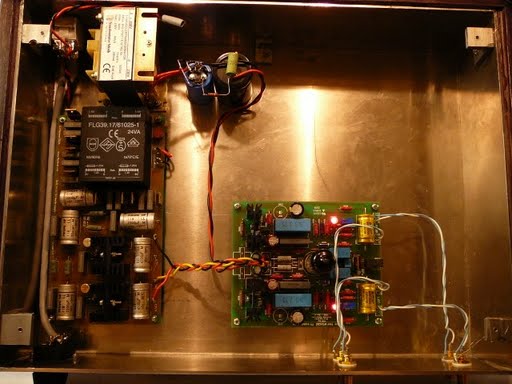

TVC on the input.
Sounds great. Compared to TVC alone just no question. Everything is better.
Compared to f.eks a TVC-6j5-trafoe outout pre its far more linear and a lot more "rich". Low frequency improved, and a much more comfotable listening to. Best we have heard - maybe. Still need to do more testing.
