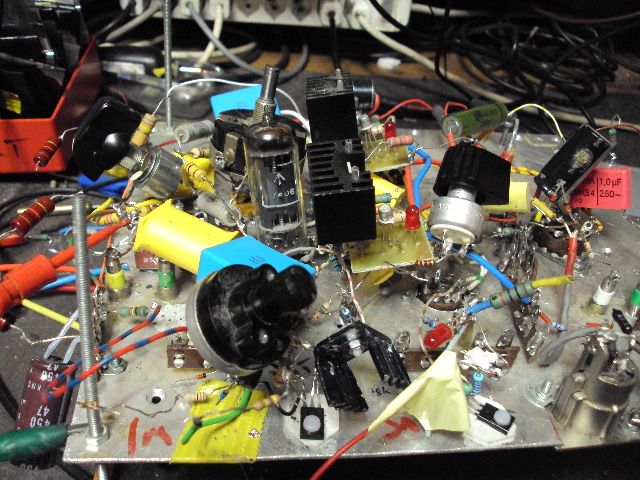

I have used current sources and LM317s on tube cathodes and they are nasty.
I'd agree that the 317 as a cathode CCS is not a great choice. That's why I used a high performance discrete cascode. As rdf correctly points out, at AC, the CCS just gets out of the way- the interconnect and power amp input impedance are the actual load.

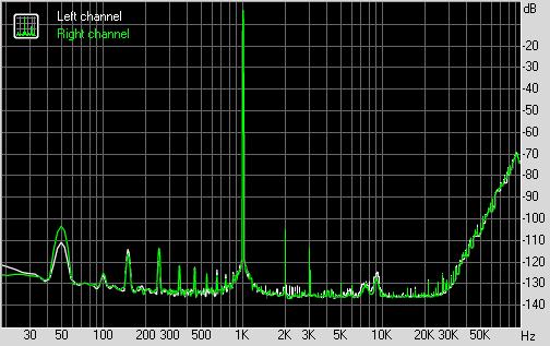

Nelson Pass has a nice article up about feedback and distortion. The takeaway point being,
Cathode/Source followers are generally described as having 100% feedback. Does feedback=feedback here? That is, assuming that the Pass article is correct, would one expect this sort of harmonic spectrum from a cathode or source follower, or is there something different going on? I'll note that the F4 for instance is said to have 0 feedback, yet it looks more or less like a follower to me.
while negative feedback reduces distortion, it creates additional higher order harmonics in the process.
That's a somewhat tricky one. The original Baxandall article in WW considered a device that had a pure second order transfer characteristic. Indeed, with the application of feedback, higher order harmonics are produced.
Here's the rub: no such device actually exists. If you apply small amounts of feedback to a real device, although THD may go down, higher order components may rise. Once feedback reaches a certain point, the spectrum is still more skewed to higher order products, but their amplitudes are lower. With LOTS of feedback, they can be made vanishingly small. No feeedback seems to be OK, lots of feedback seems to be OK, it's the small amounts of feedback where the trouble comes in, mainly reduction of second harmonic at the expense of increased higher order distortion.
For an ECC88 cathode follower, the maximum (100%) feedback is equivalent to about 31dB, a fairly healthy amount. As a result of this and the starting point (a very linear device), the distortion spectrum is ridiculously clean. The main issue with feedback is what happens at overload, but that's just not an issue here.

Although in a sense, that's a semantic argument, I would disagree that a cathode follower is any different than any other sort of negative feedback amplifier. The distortion reduction equation is the same and so are the results. And like any other feedback amplifier, careful attention must be paid to controlling the rolloffs and avoiding oscillation. There's an intuitive discomfort that many people have about loop feedback in multistage amplifiers, and some deep misunderstandings about causality. Nonetheless, in both multistage loop feedback and local degeneration, the distortion and noise are decreased in proportion to the gain reduction, and the bandwidth is likewise increased.
It's a distinction without a difference.
Allen uses CFs, he just bootstraps the plate. There are theoretical advantages to that, and he claims sonic ones, too. Having experimented with bootstrapping and not being impressed with the differences, I opt for a simpler circuit.

I know: Lesh is right but missing the word "HF phase irregularities in harmonics with rising frequency" ..That hurts. .. I'm working on a simple tube version using EF184 as triode and ECC88 as final CF. It may take a long time with the correct components.
