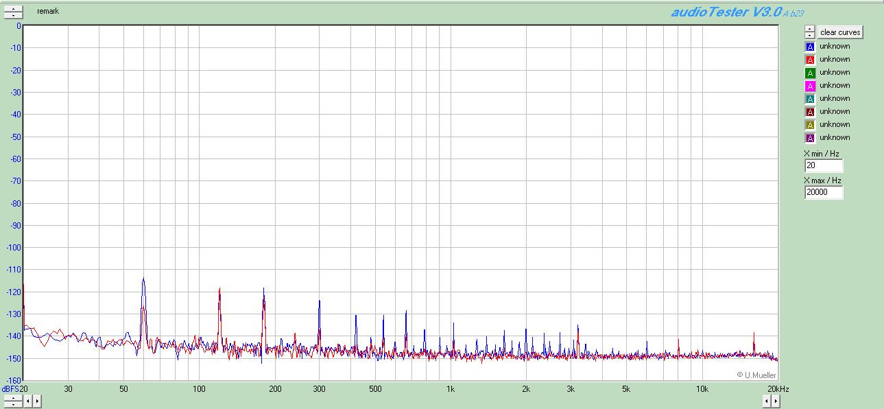

I am curious about the measured noise performance of this preamp. Unfortunately the plots seem to be no longer available but if it is the normal spectrum type graph you get with RMAA and the noise in rumbling along the bottom below -100dB then that does NOT mean the noise is below -100dB. That plot shows the noise per root unit bandwidth so you get the actual output noise level you need to integrate it over the 20KHz audio bandwidth which effectively means adding about 43dB to the measured figure. So if the plot shows noise at -120dB then the rms noise is only -77dB which is nowhere near the spec.

You're right, that doesn't, but a wide range AC voltage measurement (I used an HP3581A) does, as does RMAA in one of its reporting functions. Using a more recent soundcard/software combo, a build with the power transformers and raw supply in the same case as the signal circuits, no particular shielding, gave a noise floor in the -140 to -150dBV range, with the spray of noise pickup from the transformers reaching -120dBV. I could probably eliminate that with some effort, but the payoff is too small to prioritize that. The channel with the lower 60Hz was located on a card about 5" further from the transformers.
What does the HP3581A show as total noise? The measurement was in mV, I suppose? (My HP works that way)
This is strange because my HP3581A does nothing of the sort. Its essentially a spectrum analyser and does not measure wideband noise - or is there some function on it I am not aware of?
It has a frequency control knob and digital readout, where you can set the center frequency and get the noise for that band, then increase the frequency to the next band to get the noise voltage there, and so on. If you divide the noise voltage by the bandwidth (selectable by another knob), that gives you the voltage noise density for that frequency band. You can easily make a plot of en vs. f, and at very high resolution if you have the patience. Perhaps some time reading the manual may help; it's an incredibly versatile instrument and the use of it to measure noise is explained in there. I think the BAMA site has the manual for download if you don't have it.
The correlation between noise measured with the HP and the noise from RMAA is quite good.
edit: You can also do this with the sweep function, but since I don't have a pen plotter, I haven't done it that way.
