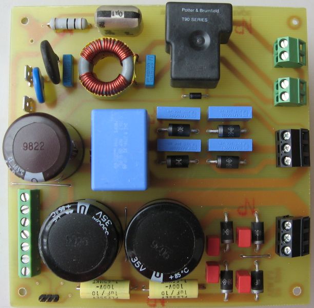

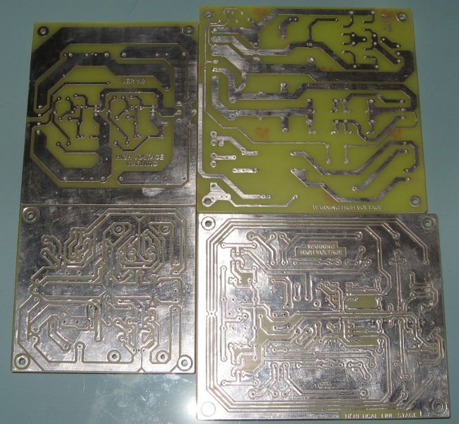

Take note that these PCB's were designed to allow for a lot of options, choice of caps casing, use of transformer surge reducer TH1, HV relays or not, etc...
So make sure to read the Parts List and look at the schematics before assembling the PCB's. You may need to install jumpers at some places, if you don't use some optional parts.
I'll try to write a small document listing all the options but it is not done yet.
GROUNDING CONNECTIONS:
This preamp use a very specific Grounding scheme. There is a lot a separate GND (HV, HTR, Signal, Power, etc...) that need to be correctly connected for optimum performance. You need to correct all the PCB correctly. I'll put together a schematic for the connection but it is not done yet either...

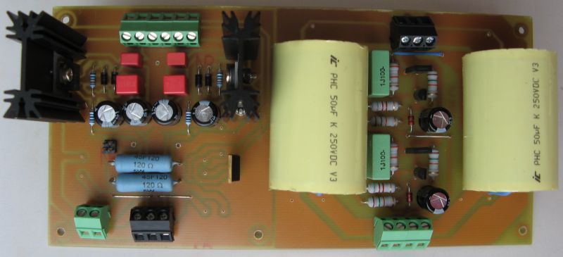

And the Regulators PCB completed as well. Just a few parts are missing until I select the correct leds resistors and timing capacitors.
I'll start testing them in a few days.
The big film caps are held in place using silicone to reduce microphony effect.
I also found the cap's leg connected to the outer film layer and connected this leg to ground for best noise immunity.

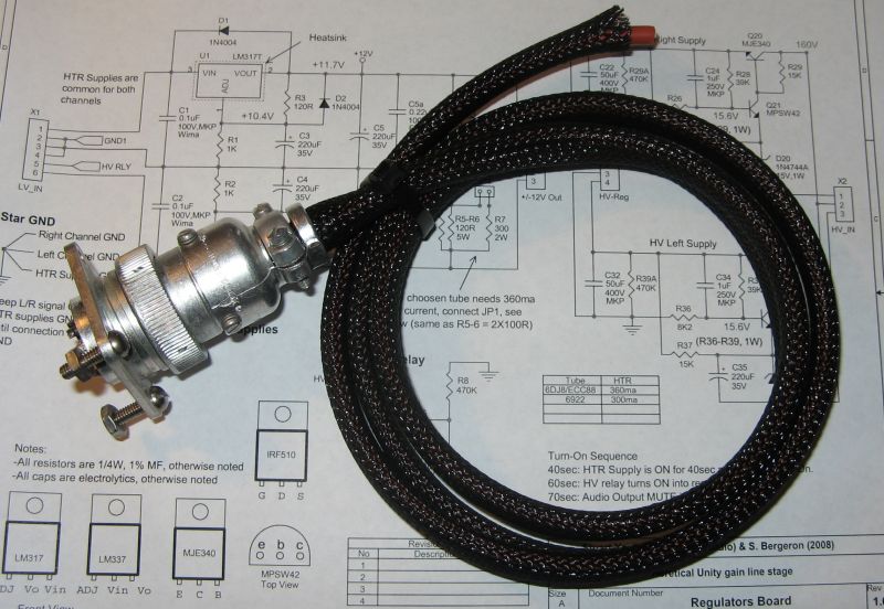

Still working on assembling the power supply. Here the umbilical cable. It is made of two cables (4 wires each + shield, Belden 83396 silicone rubber cable), each separately shielded. HV and control wire in one, LV in the other. With some nice expandable Sleeving.
