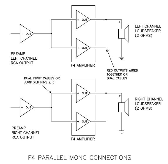

Hey I'm feeling like a Dodo! I can't figure out how to make an F4 into a mono amp.
I like mine so much I think I need a second...make a pair of mono's...but I don't know how to change the circuit/wiring/boards...
I was waiting for someone else to ask because don't remember it in the F4 threads.
Something simplified to hook this wire to here, replace this with that. Intent here is to build them as mono blocks, run them in parallel for a year, then move wires over for blanched use when I have a balanced preamp built. Have all the parts ready and under assembly - minus one transformer if is done using the exact same parts as stereo amps.
I see the reply about using XLR, and realize the factory amps came with both inputs with explanations on what to jumper but F4 build guides haven't covered it. So don't know about others building or testing F4 mono blocks, but I'm making the risky assumption they are starting without a balanced preamp.
In the F4 manual Pass states they connections are labeled on factory amps. Obviously not for home builders.
In that case the ground is done at the amp, where the pictures from the manual show the negative terminal being brought to earth ground, and I were to follow that as a newbie I would assume it means bring a wire back to ... where. Running a cable back to the amps would be split to two chassis grounds?
Sticking to parallel for the time being...
Dodo question, but don't want to make a major Dodo mistake.

If you use an input transformer to convery your Single ended source (RCA) to balanced (XLR) your amp will be in bridge mode and be 100WPC instead of 50WPC
Which raises a question, does your preamp have balanced out?
The input transformer + goes to L channel +.
The input transformer - goes to R channel +.
The CT is ground to both RCA's.
This is essentially the XLR balanced scheme but you use an input transformer to give the negative output.
Then 100W into 8R is possible from a single RCA source.

Well ZM, I never quite caught the distinction. From the pictures parallel seems to be what "balanced" means. It looks like (im such a child with this stuff) one side of the amp increases the part or the signal above ground while the other side increases the part below ground. The speaker reacts to the ongoing summed difference.
I have no idea how a transformer could create this kind of signal from one that is all above ground (single ended?)
Bridged mono seems like a team of oxen, both pulling at the same time, to the same extent at the same que. Bridged seems trickier...somehow. but this is essentially why we must match mosfets, they pull in concert to the extent they are identical in their thirst for current, yes?
Big question which works better?

Refrencing the CT as ground will create a positive sine wave when you measure from top to CT and a negative wave from bottom to CT.
The key is, from a single rca source the secondary CT will cut the signal in half like a "phase splitter" that is why you need something like a 1:2 transformer to get each half refrenced from the CT to be equal in amplitude to the input signal.
That way the L channel amplifies the positive sine and the R channel amplifies the negative sine.
Then at the output you get a parallel output that has double the amplitude.
Same as XLR, Pos,Gnd,Neg.......+,CT,-......it's just a different way to skin the pig��.

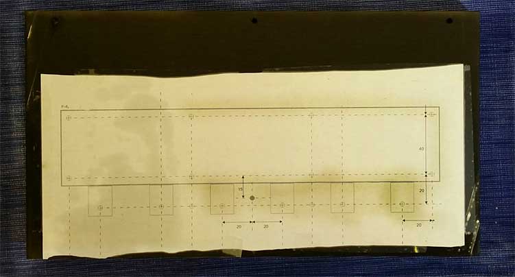

How about something else entirely. Tomorrow I center punch the holes for where I'm going to mount the F4 board and MOSFET's to the heatsink. It's 300mm x 165mm, same dimensions as the ones sold by the DIY store. I'm wondering where to place the MOSFET's specifically and took this as a guess. Yes, the paper was a little dirty, but I made it look much worse in photoshop by burning in what didn't show up due to poor lighting and a cell phone camera.
The amps will be a few inches above the ground, heatsinks oriented the usual manner, fins running up and down to allow for some convection.
The board is not centered, but a little lower without getting to what i would have guessed to be too low. Just a guess, figure there must be someone else here who has done a few builds and wished they had done something a little different.

You guess is a pretty good one. Folks chip in .02$ at 1/3 up from the bottom for center of mosfets.
I'd be more concerned with wire paths and other proximities...
Jeffs -- That looks pretty good, and will work really well. A little higher wouldn't hurt, I.E., the mosfet about 1/3 up from bottom of heatsink as jdg says.
