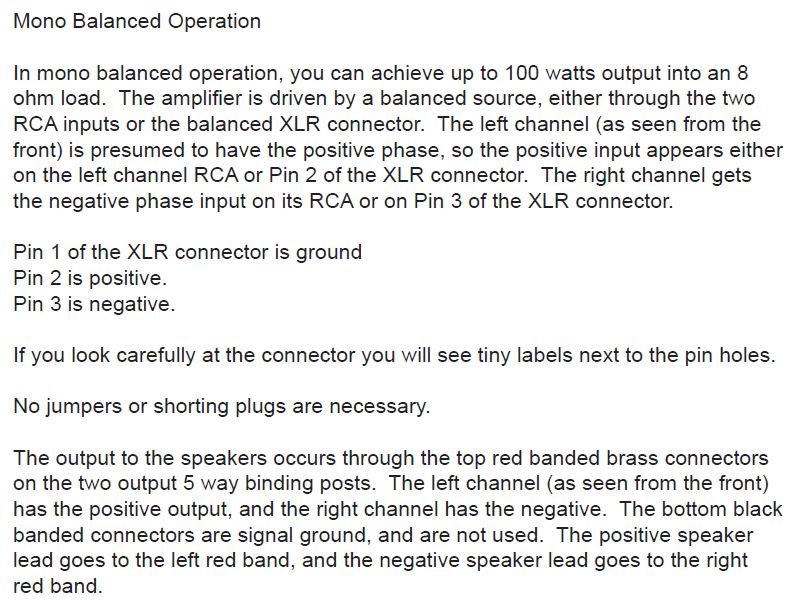

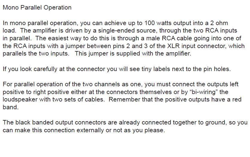

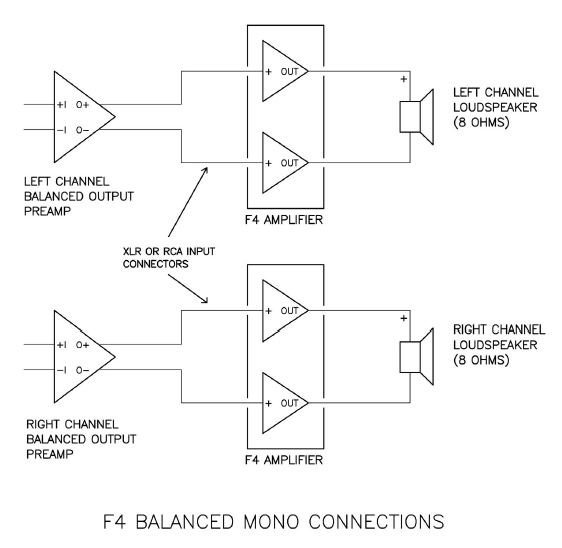

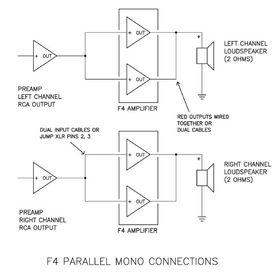

Hey I'm feeling like a Dodo! I can't figure out how to make an F4 into a mono amp.
I like mine so much I think I need a second...make a pair of mono's...but I don't know how to change the circuit/wiring/boards...
