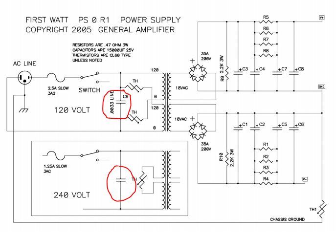

Hello guys,
I am gathering the materials to build the F4, I will be using this power supply (the one from diyAudio Store used for the build in this thread) and I have a doubt about the line input capacitor that is shown in this picture:
It is the small blue cap across the power input lines. I am not sure about it's value, is it 0.0033uF 120v? or something different? Any help will be appreciated.
Thank you.
P.
Thank you.
P.
It's a .0033uf (3300pF) cap that must be x1 (or x2) rated for across the line use.

Aweseome, 6L6. You truly excel as a diyAudio community member. It's really appreciated.
