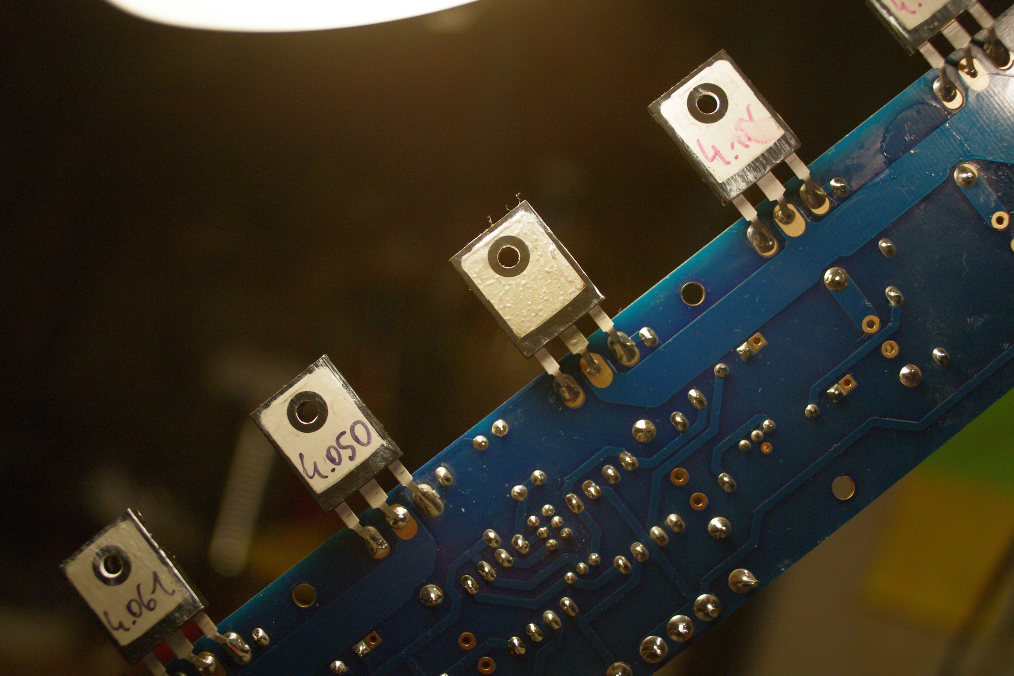

Beer and pictures
Well the beers did help...and hush my mouth, there may be a picture that helps.
Center MOSFET with the melty surface and writing burned off...
Must have just been a bad apple?
I can find no error in the build or wiring that would explain the readings and smoke 😡
either bad apple , or apple not squeezed enough ........ or apple squeezed at burr protruding mica
If Keratherm insulators are used, machining swarf can easily penetrate. That being said, keratherm is fantastic.
I used mica and thermal grease, whiped down my mounting surface and applied the grease with my fingers to both sides of the mica to insure coverage and to look for impurities/metal. I don't think there was any contact between the MOSFET and the heat sink.
But it sure is what it looks like!
I'll inspect everything with a magnifier and report any findings.

did you tighten them all properly ?
however - check rest of them and replace Dodo
take care of matching - if you don't have close one , replace that trio
Yes, I exercised great caution in tightening them, reading the spec sheet for torque, experiencing what inch - pounds feel like by putting a screwdriver into a torque wrench, and tightening them a little at a time across all MOSFETs until they matched.
I have contacted h_a about a replacement ((numbers are still on the remaining MOSFETs) but understand I may have to buy a new trio.
I only have skills for checking MOSFETs with a diode checker; can you point me to an article for gaining more skills in this?
It took me 5 months to build so I am being patient. I can spend a little more time, no problem. 😱
