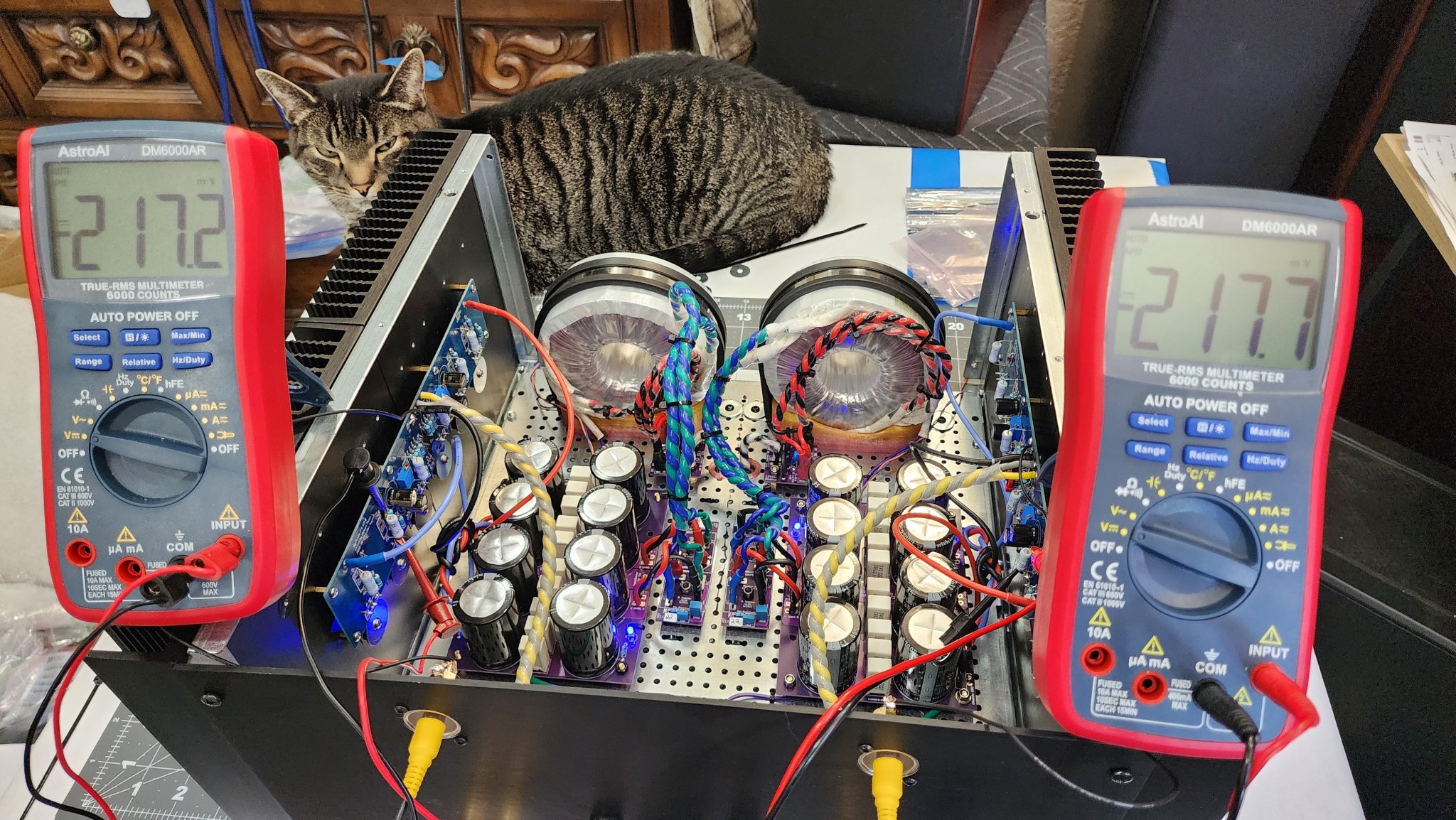

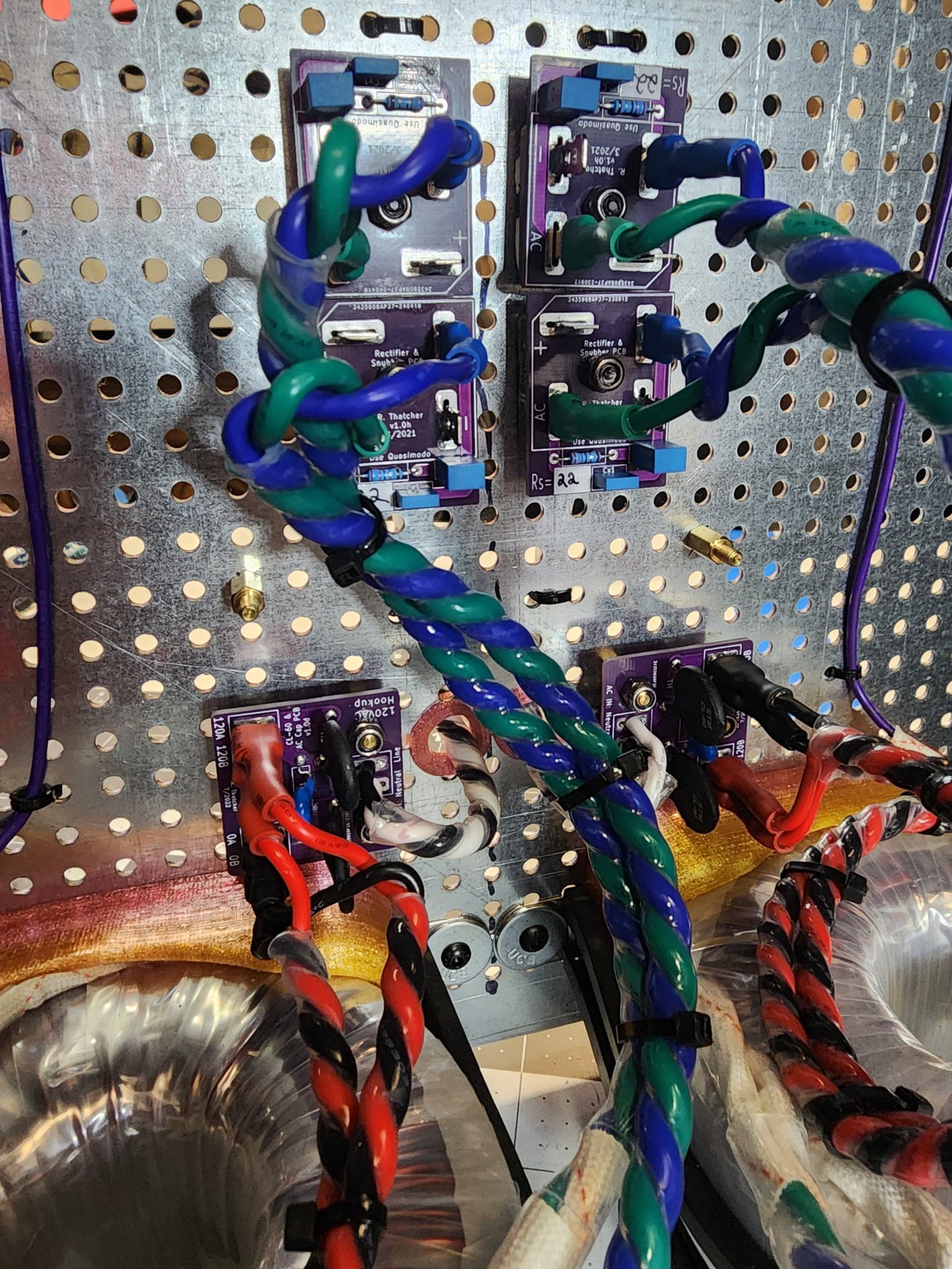

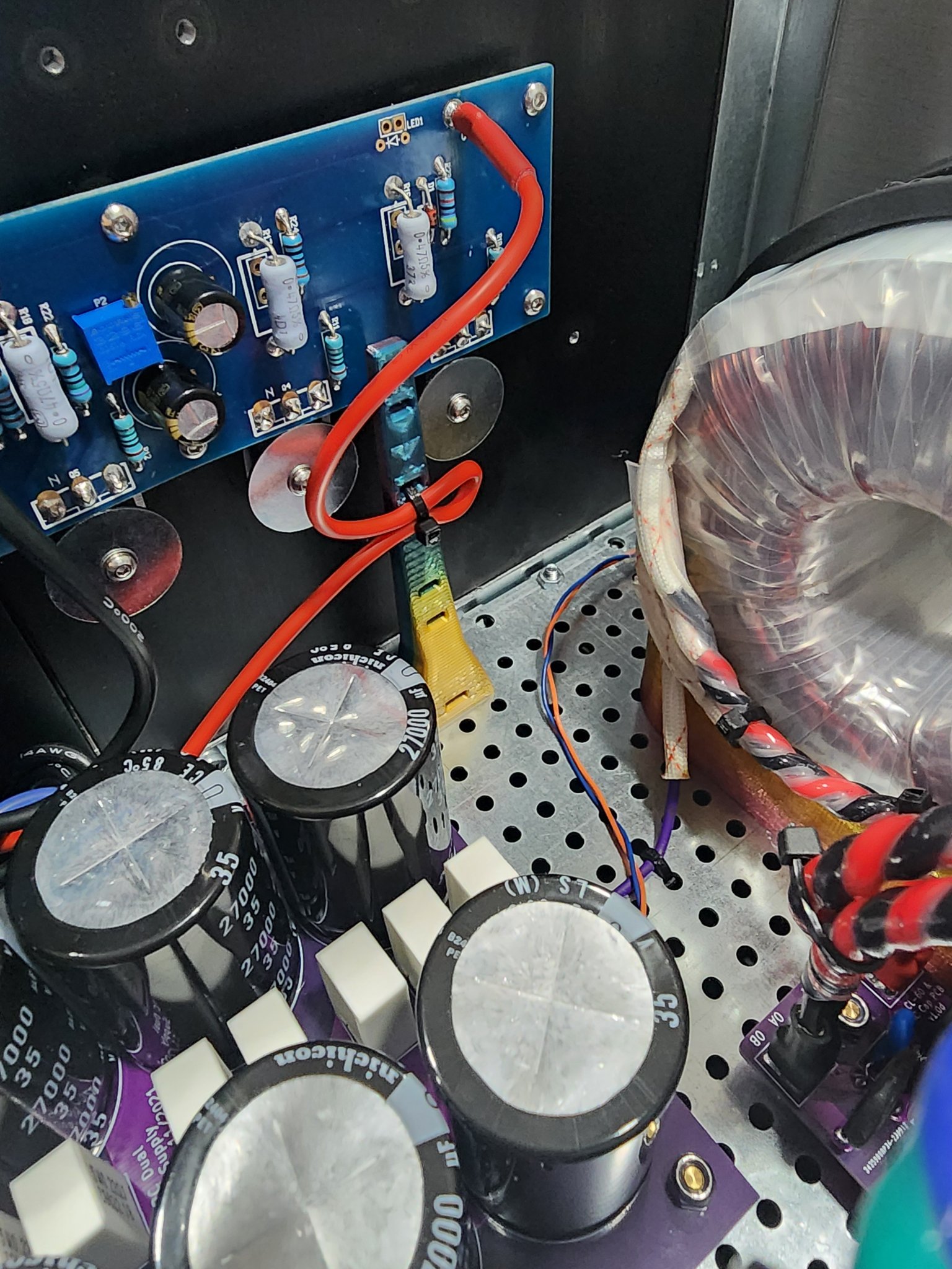

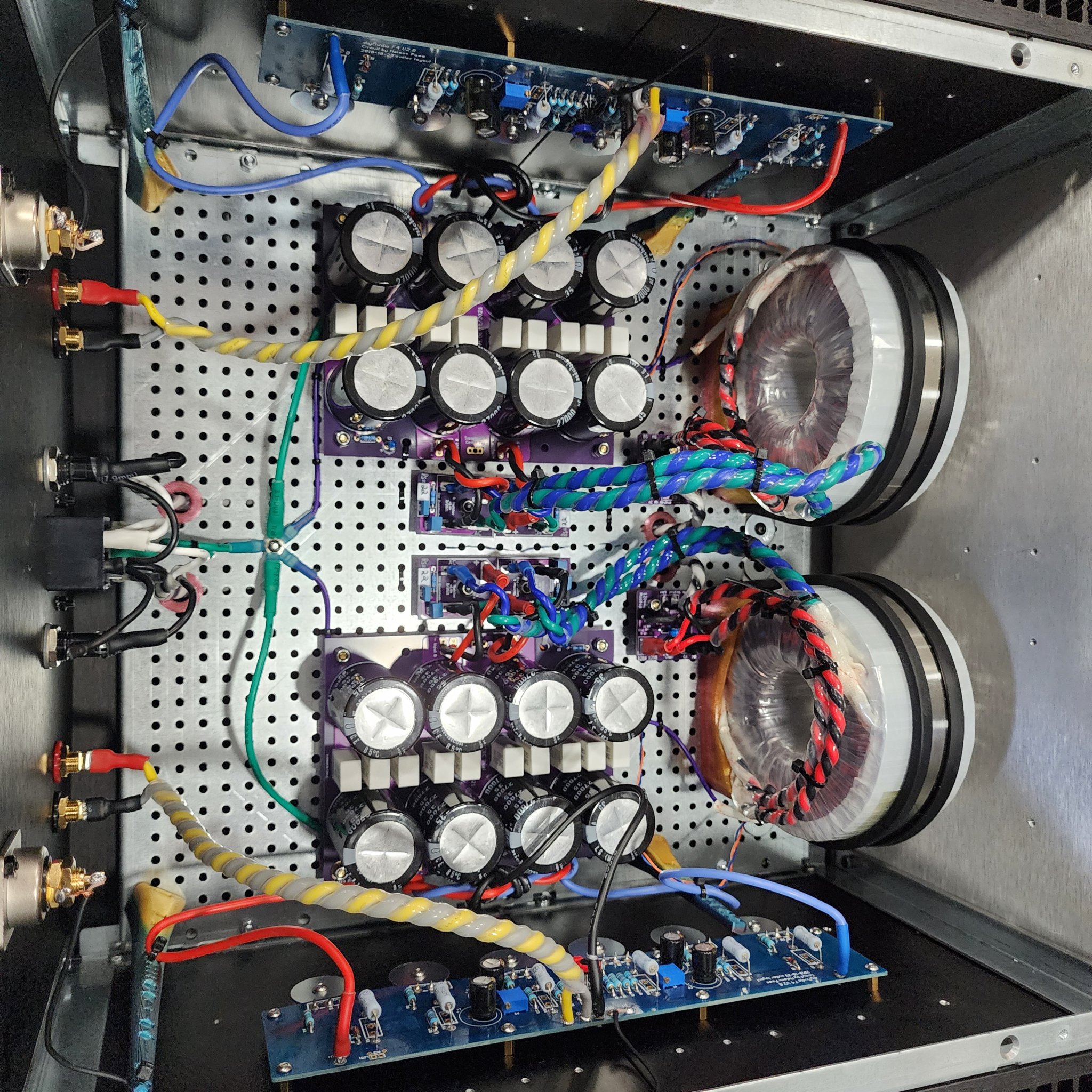

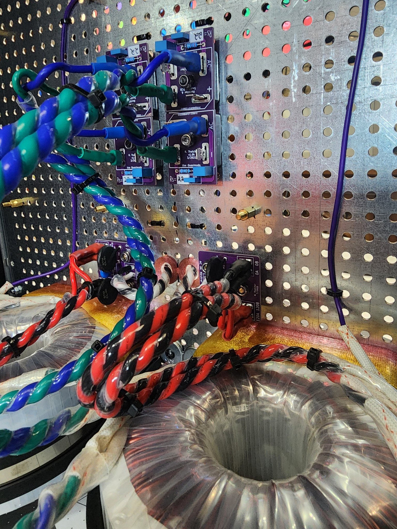

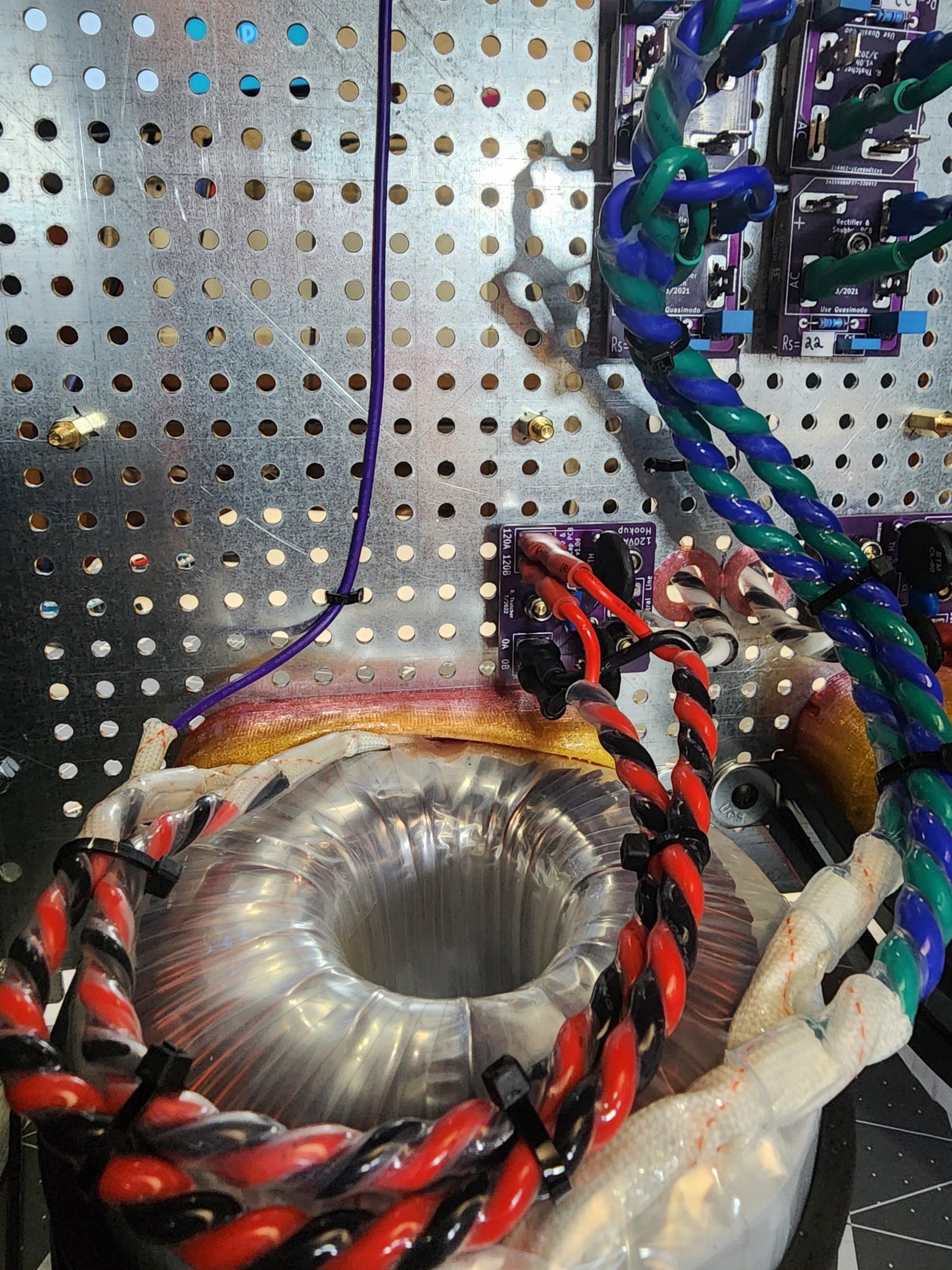

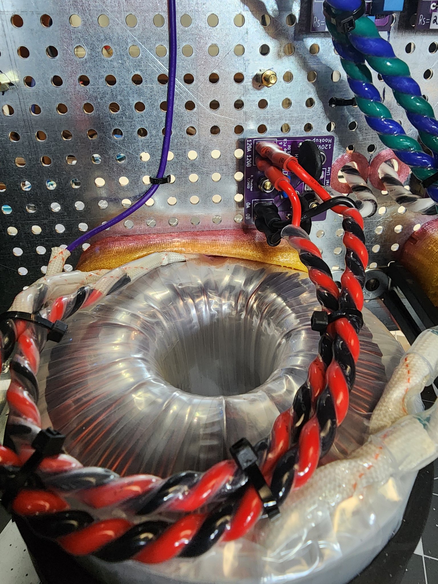

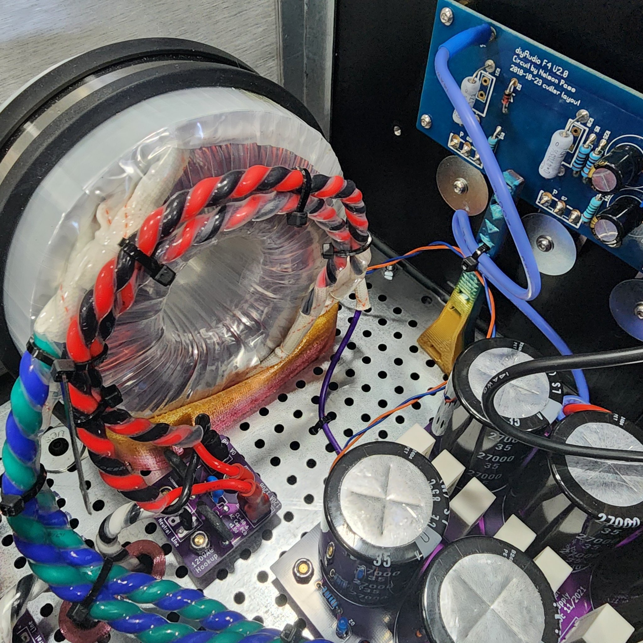

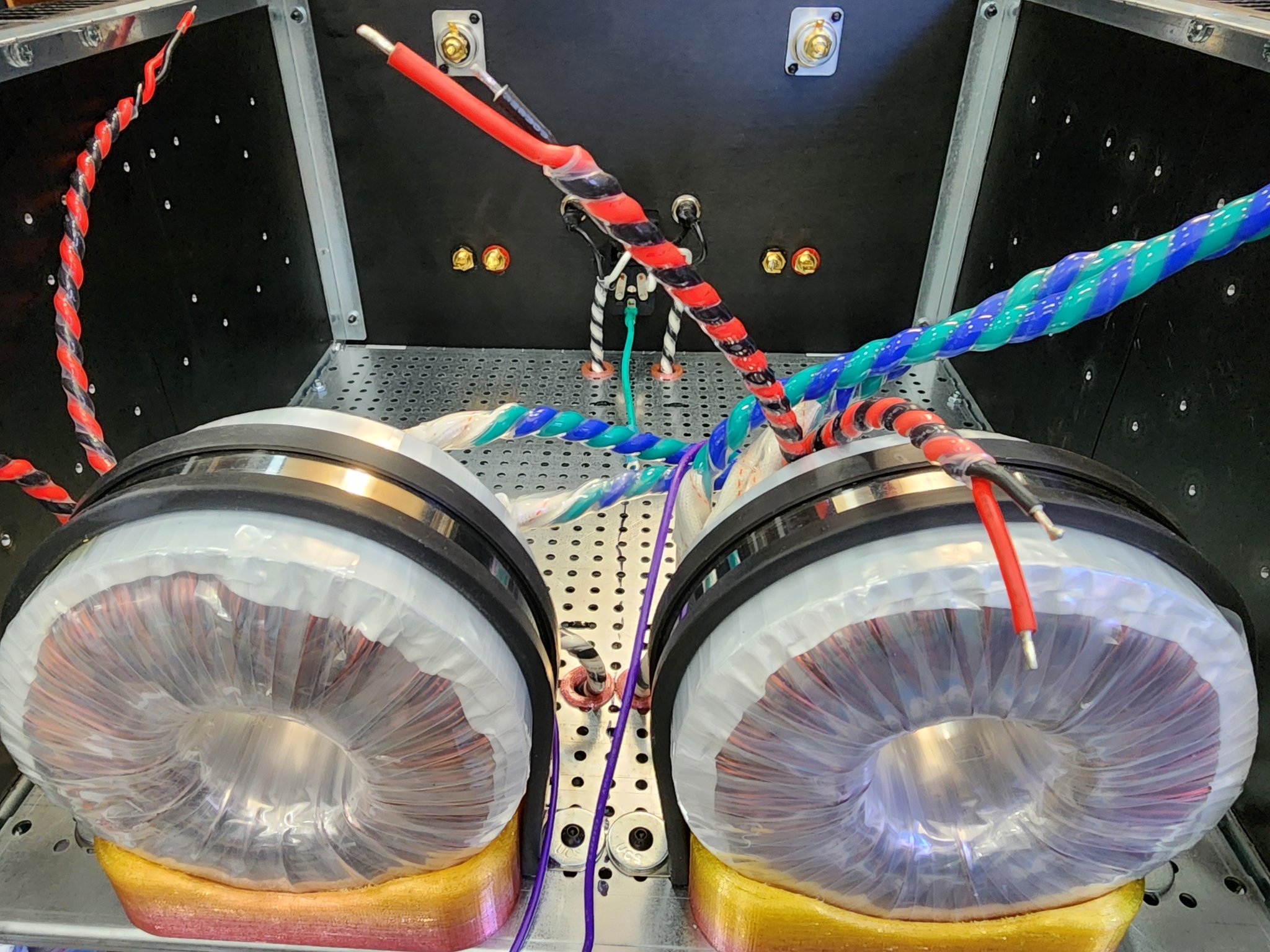

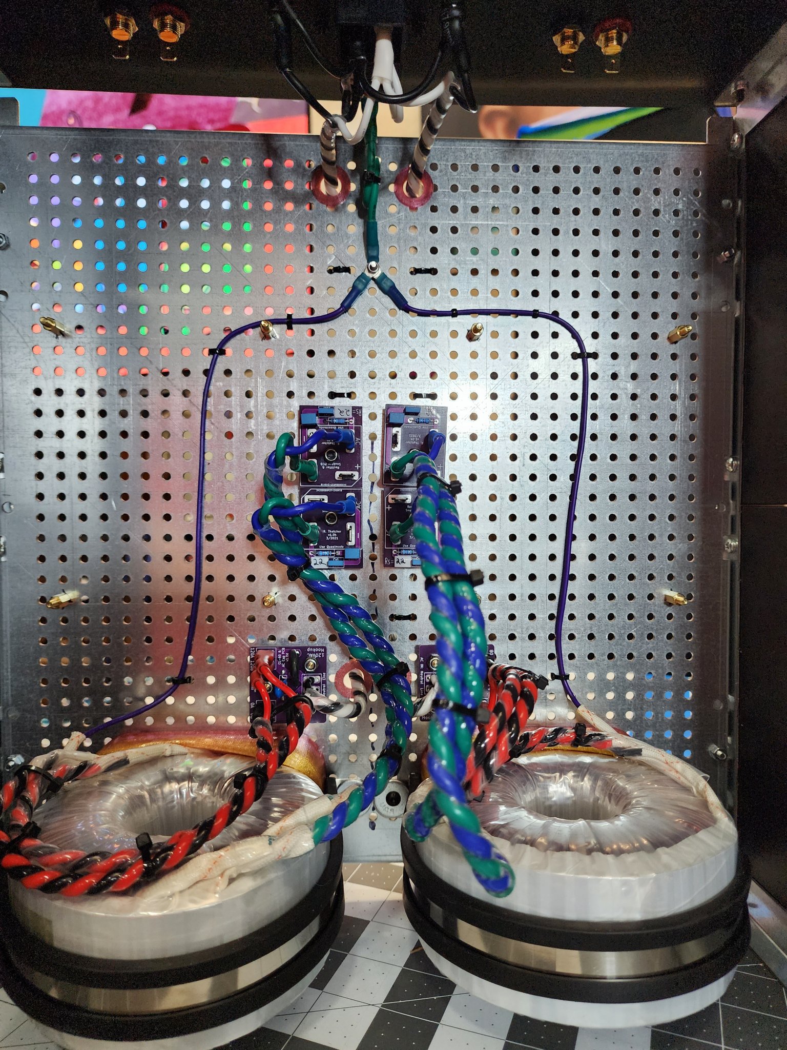

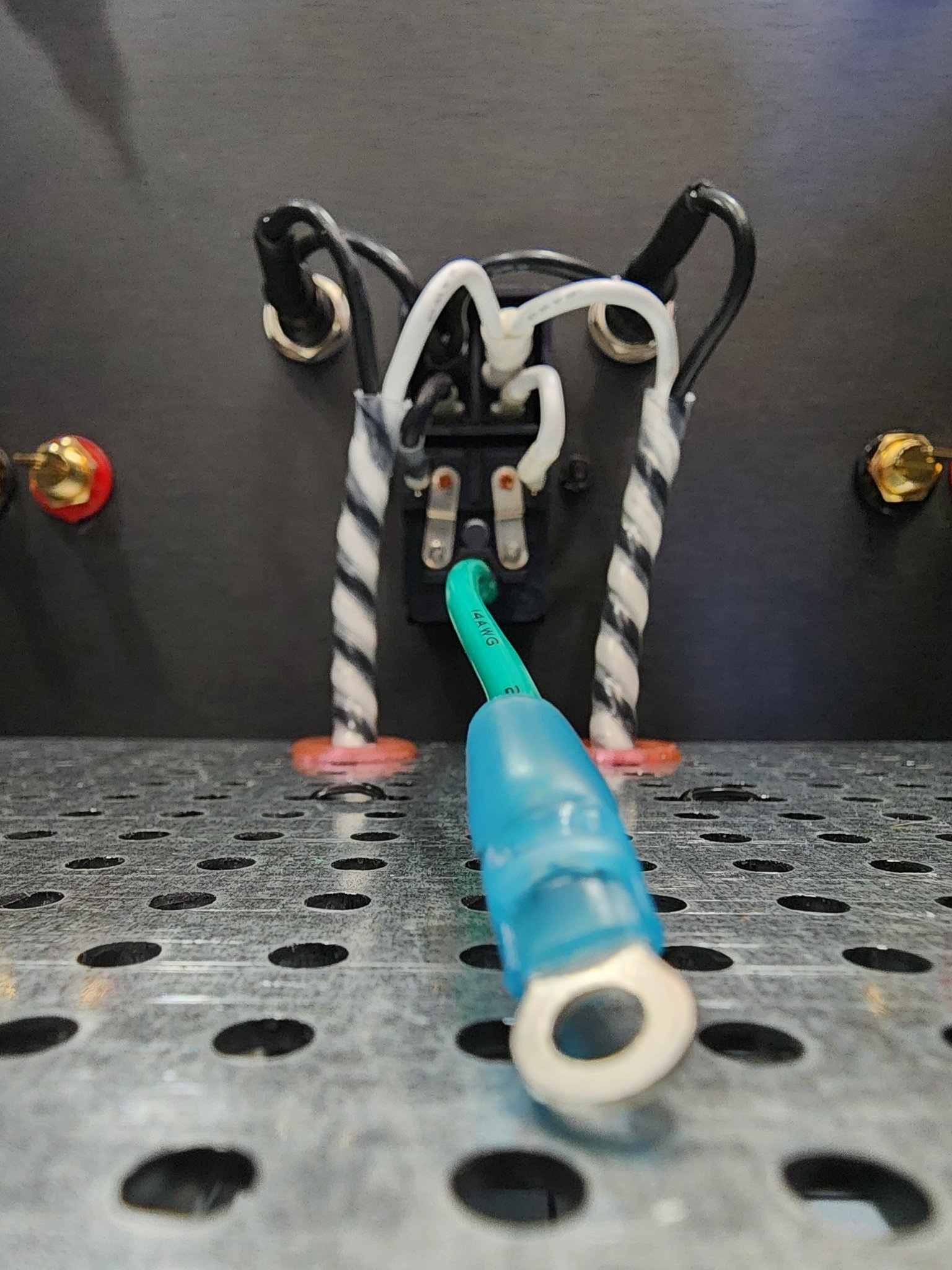

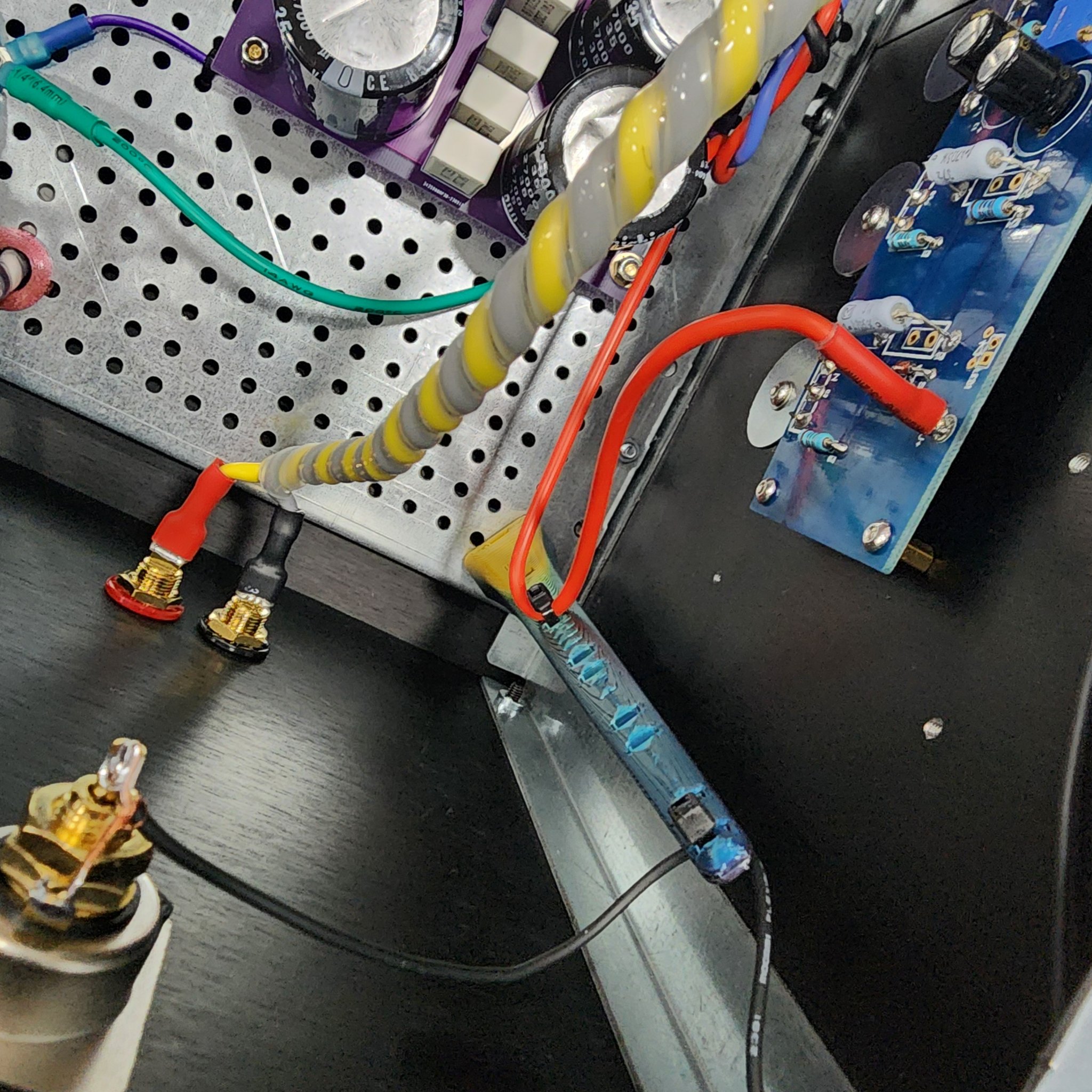

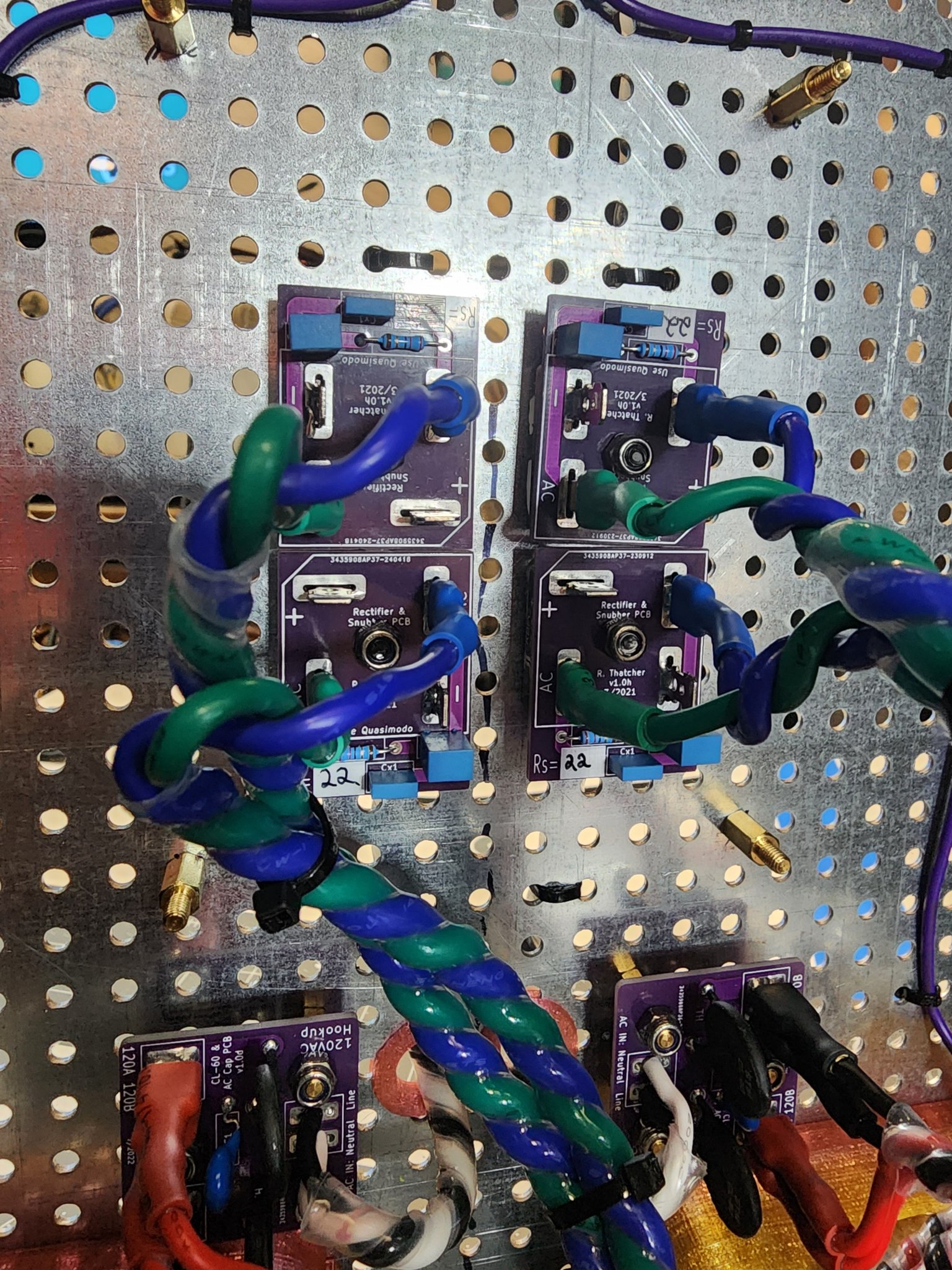

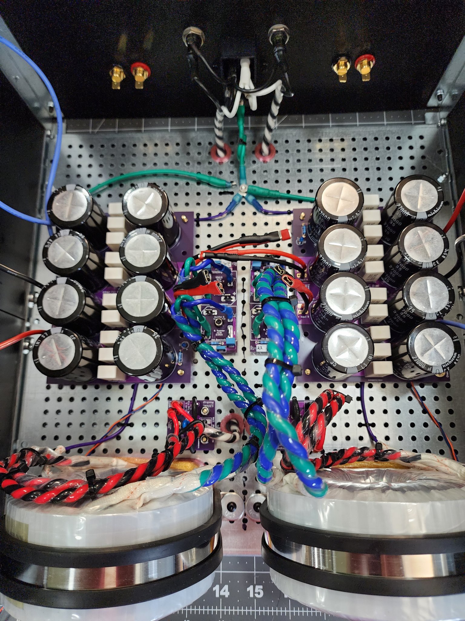

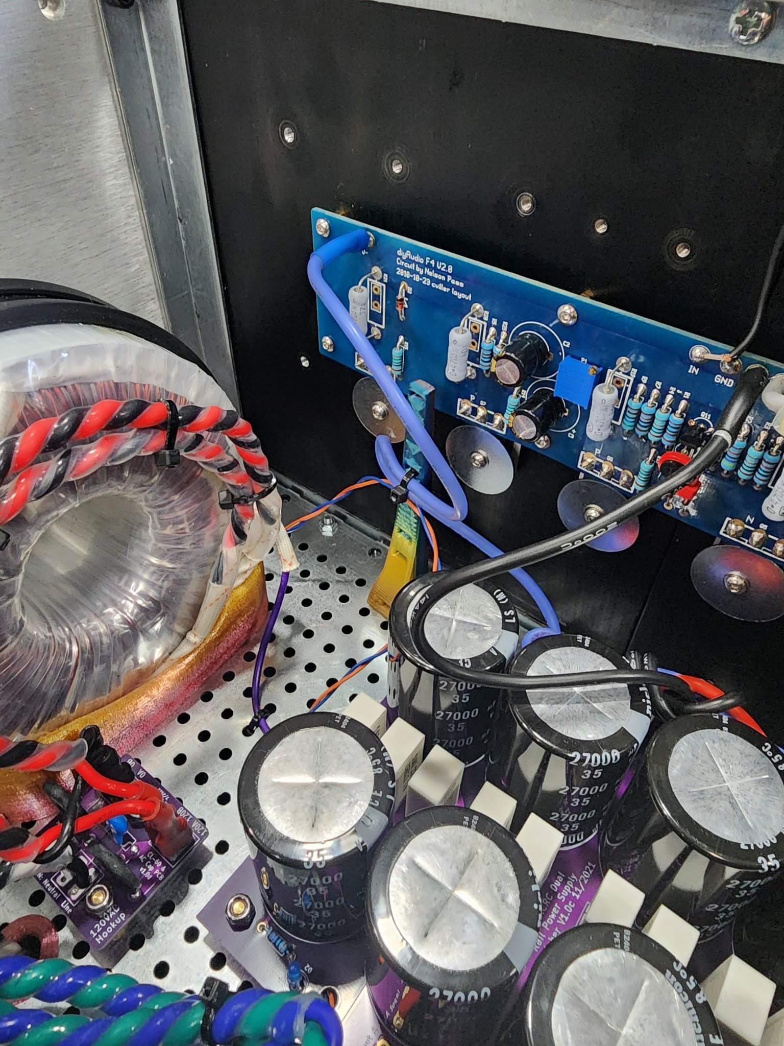

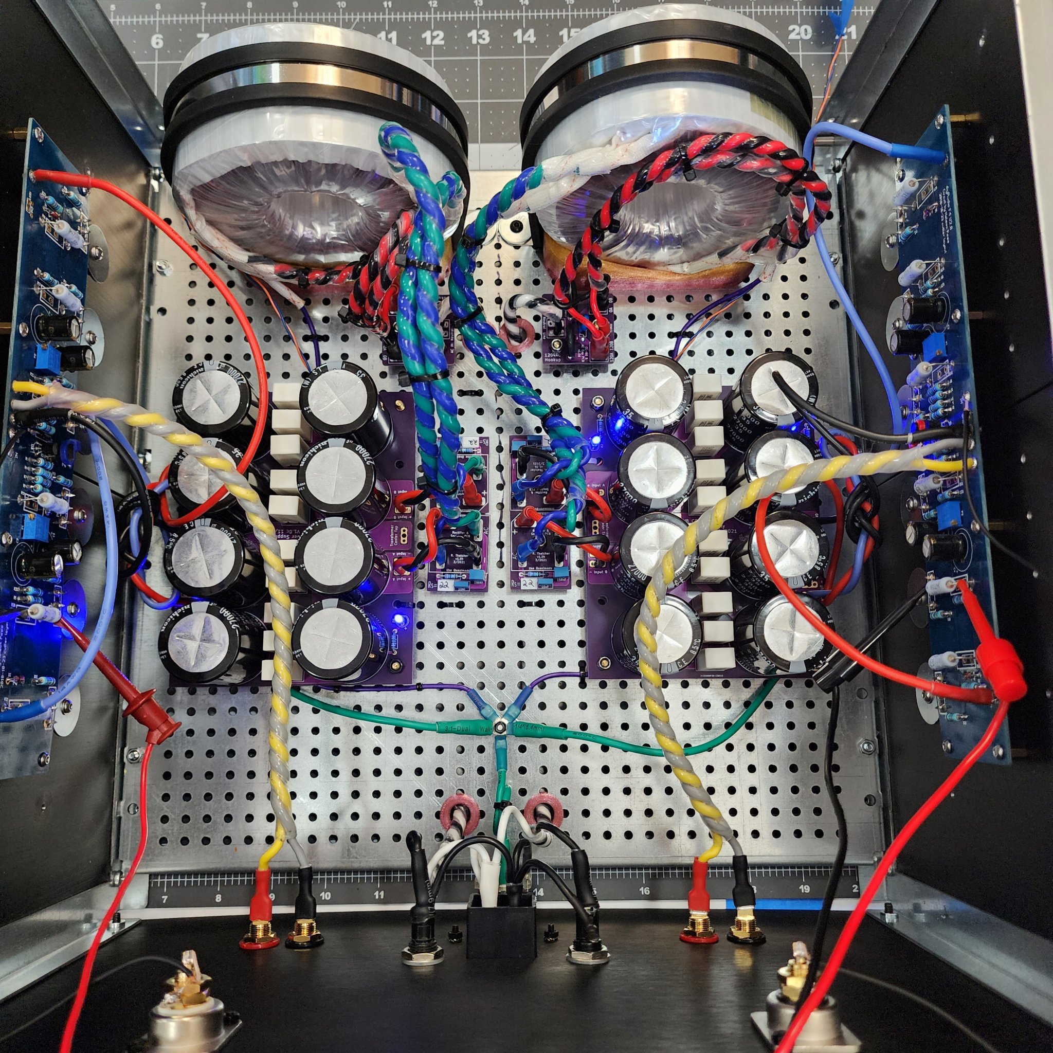

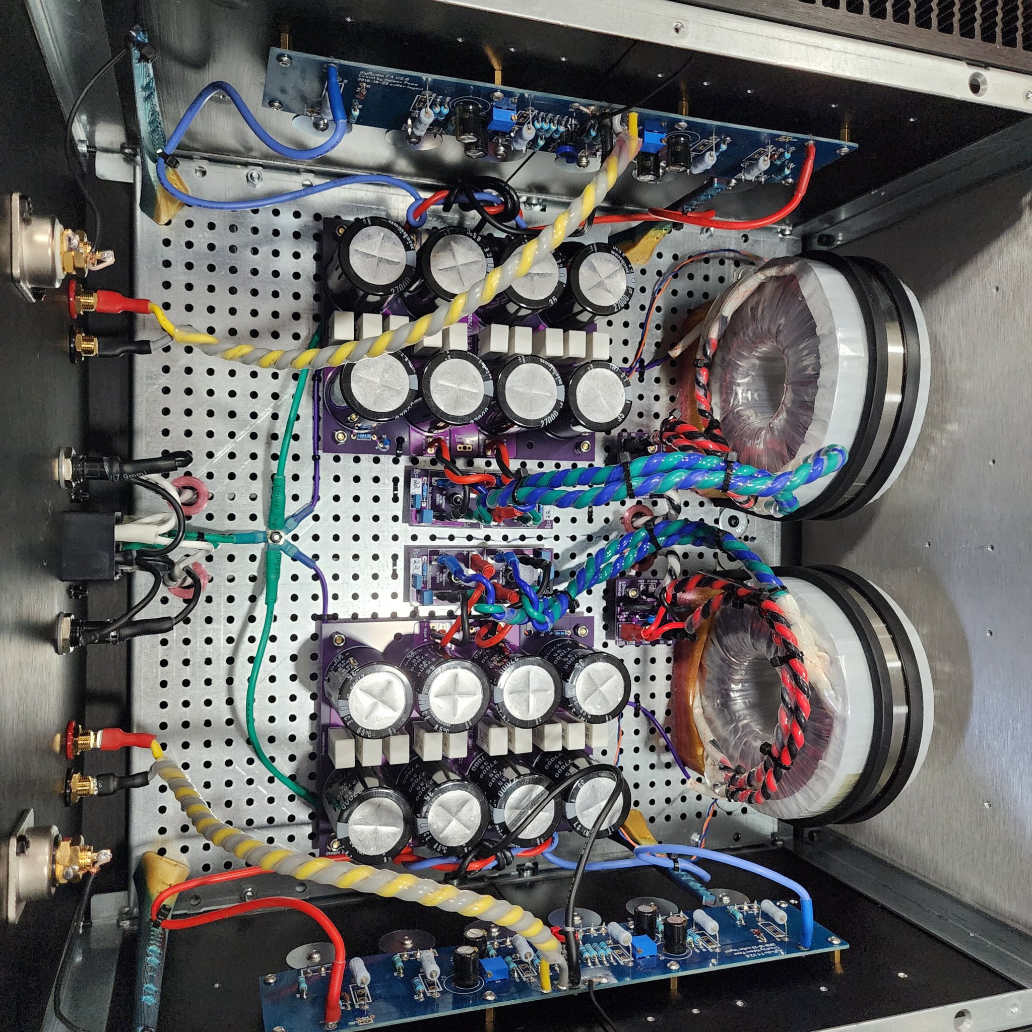

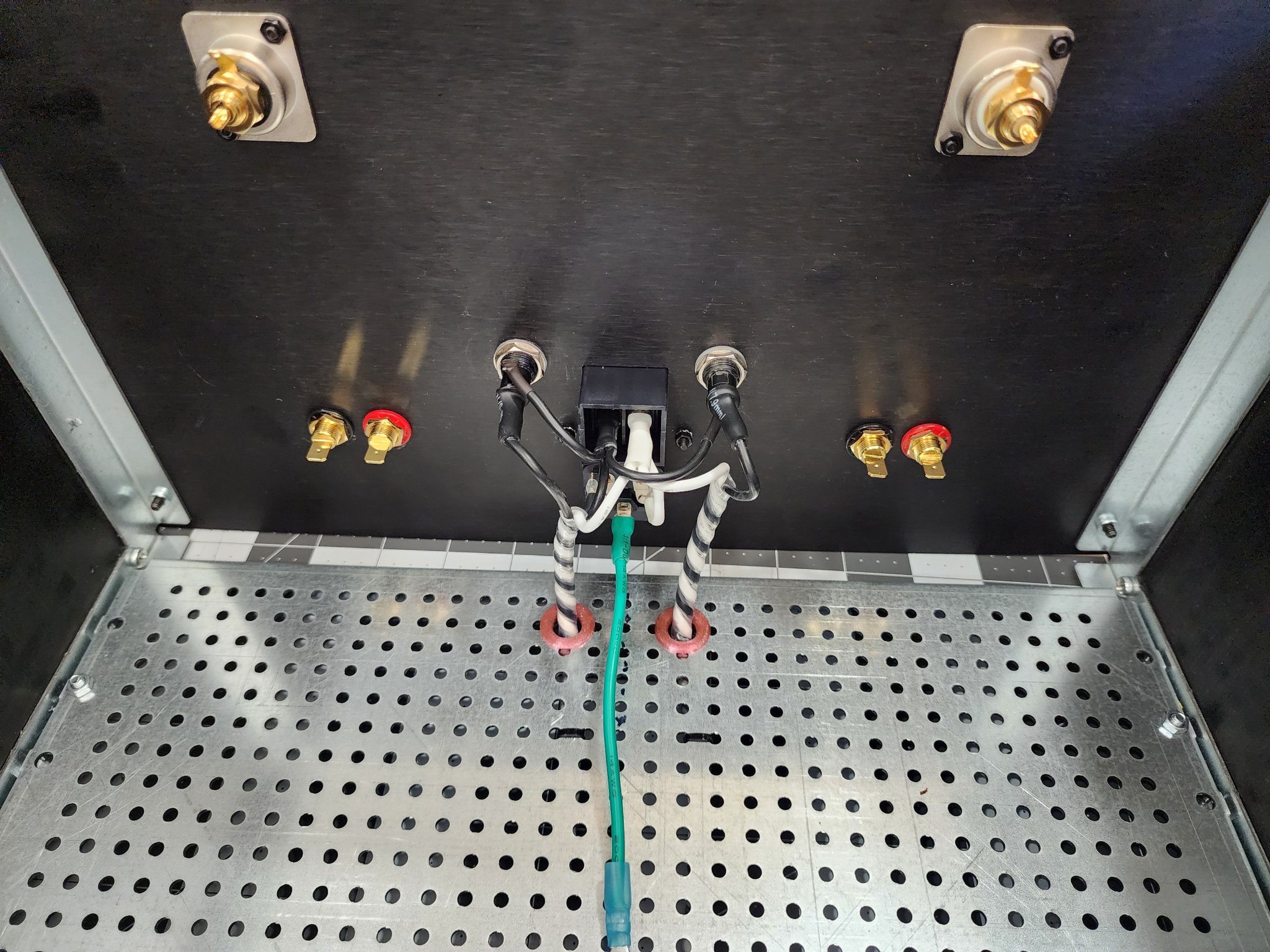

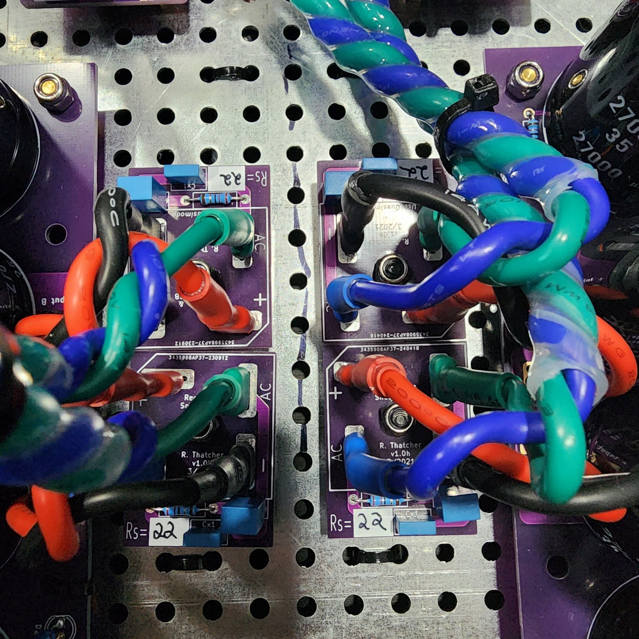

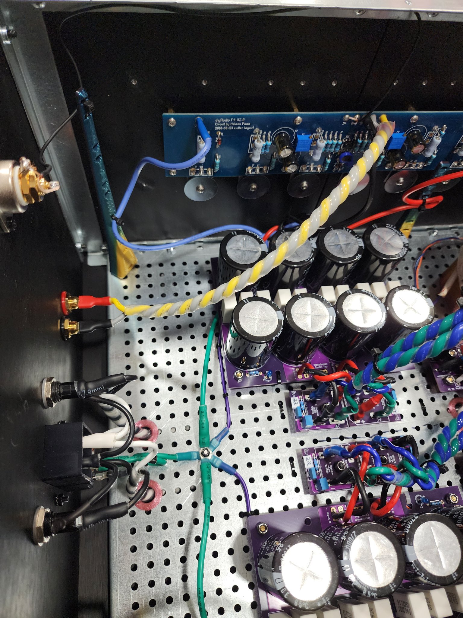

Built my dual mono F4 back in July but headed out on a work trip before I got around to posting the results. It's a dual mono PSU using Antek AS-3220, @rhthatcher V8 boards (27kuF caps) w/rectifier & AC inrush boards, and the rest is standard "plain-jane" stuff (back panel kit, Mogami W2381 input wire, 14Ga BNTechGo DC wire, 16Ga BNTechGo AC wire, 14ga BNTechGo chassis ground, XFH 3/8" heat shrink for twisted wires, 3D print transformer seats, 3D printed wire management/separation posts, Modushop 5U/400 Deluxe chassis). Biased per the guidance in this thread and wires are soldered direct to most boards per Zen Mods guidance.
This was my first dual mono. I've barely had a chance to listen to it yet as I need to shuffle stuff around to hook it up in my listening setup, so just posting pictures here to help others visualize what I did to pull it all together. Thanks to everyone who's posted support in this thread and others, @6L6 for making a great build thread, and of course Papa for the enormous generosity to this community!

That looks absolutely fantastic! Very nicely done!!
I like the printed vertical wire tower thingamabobbers.
birdbox,
I echo the sentiments of 6L6 and e_fortier on your DIY F4 amplifier - kudos on your well executed dual-mono build in a single chassis!
I also spot your "transformer seat" and strap on band method in action. 🙂
Enjoy!
Enjoy!

Very nice build, Birdbox! The planning and forethought are evident! Dual mono builds get heavy quickly. I was shocked when I was done with my SissySIT and saw that it was near 65lbs. As I turn old and decrepit in the coming years, there may come a point that I'm not able to lift it and work on it anymore 😉.
One detail that I can't see well in your images: if you have any trouble with hum (excellent work on keeping AC wires tightly bundled), you might be able to solve it with a CL-60 (or similar) between channel ground at the board level and AC mains ground at power entry.
