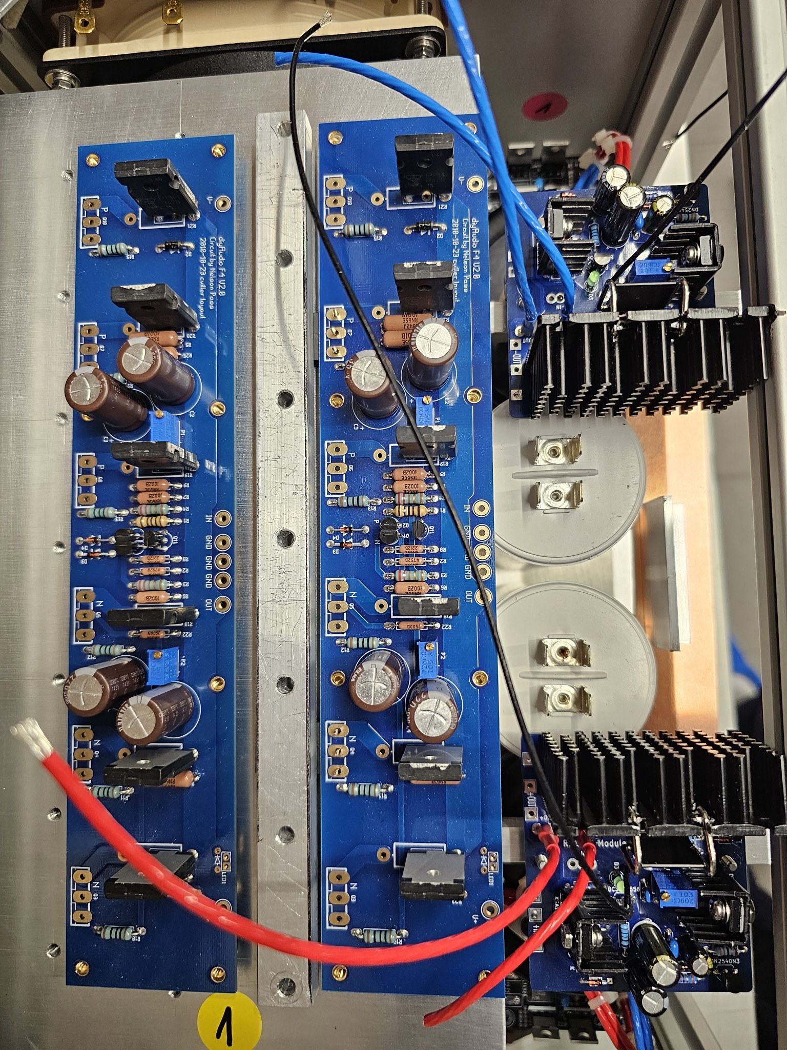

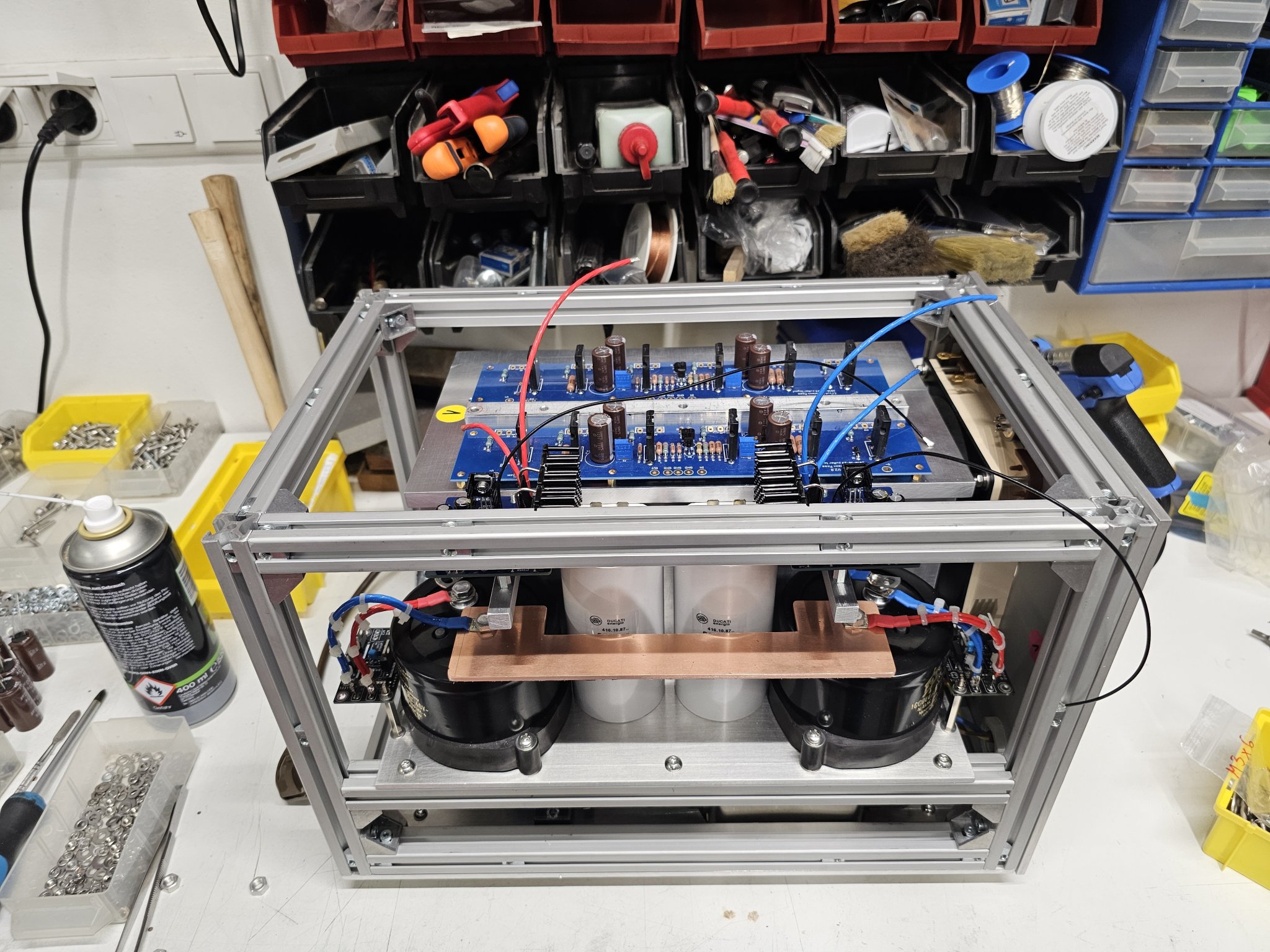

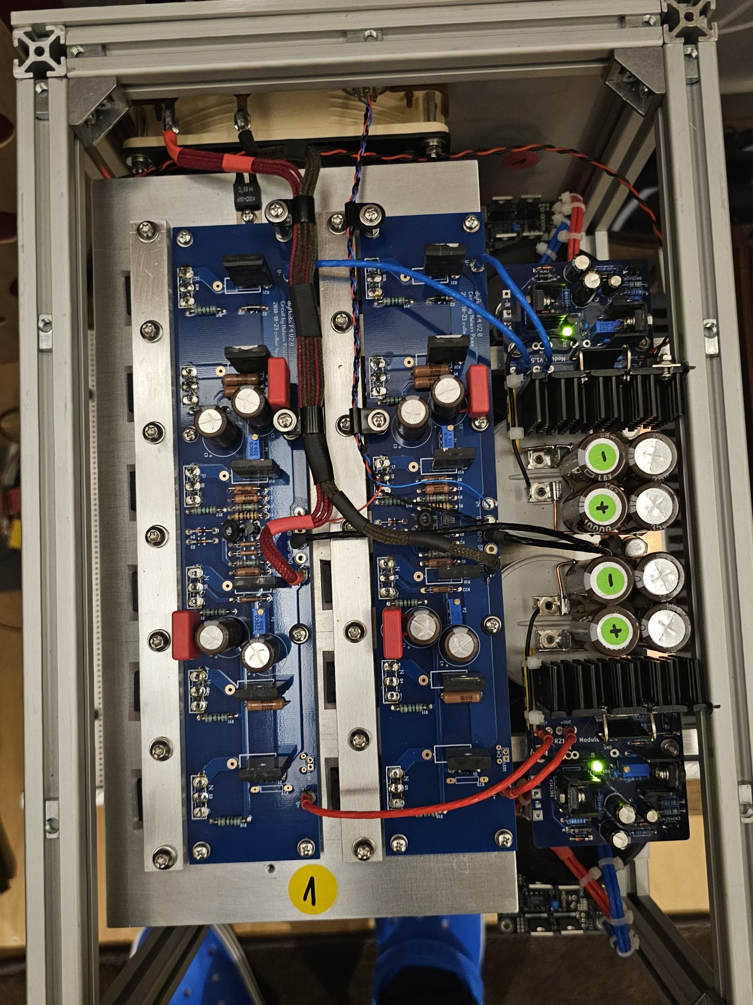

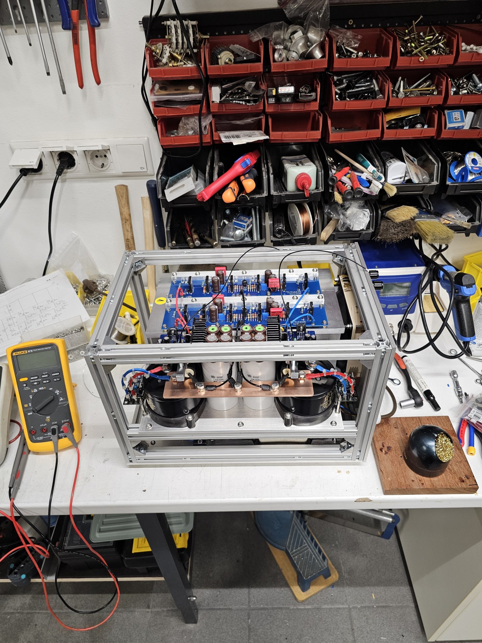

Dear Diyaudio Community.

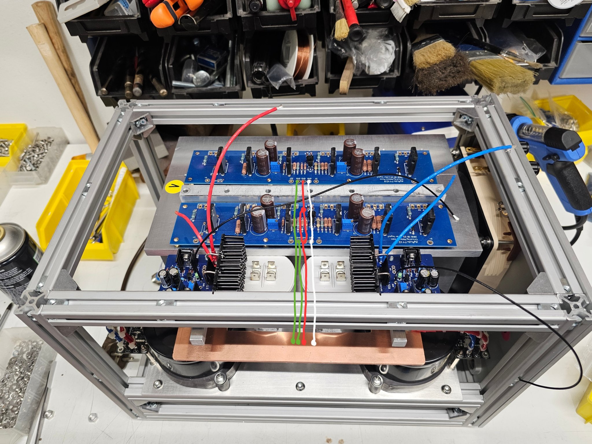

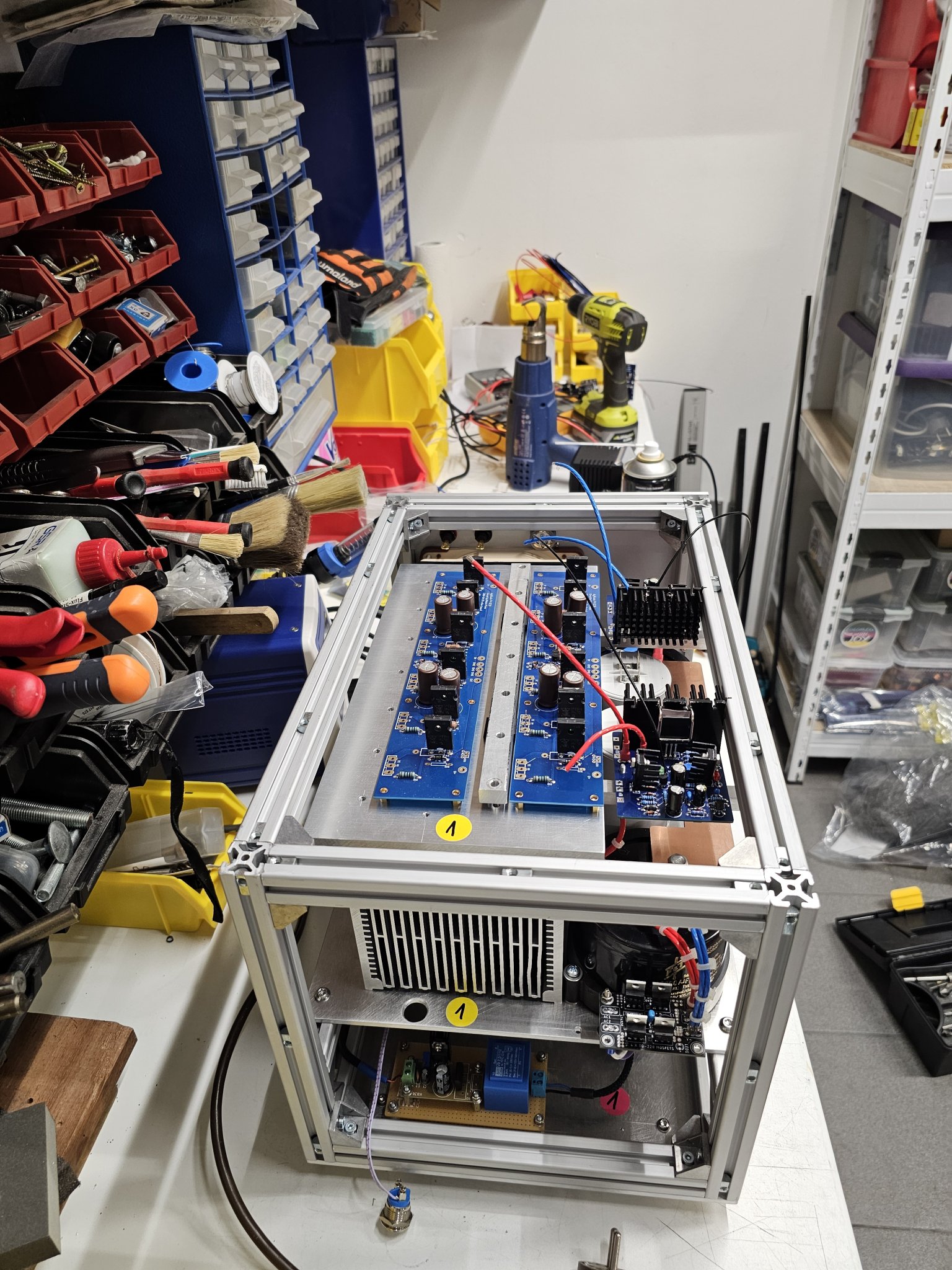

This is my Pass F4 balanced mono block Projekt.
Image shows one channel mono block
I need your help with constructing my F4 in balanced configuration.

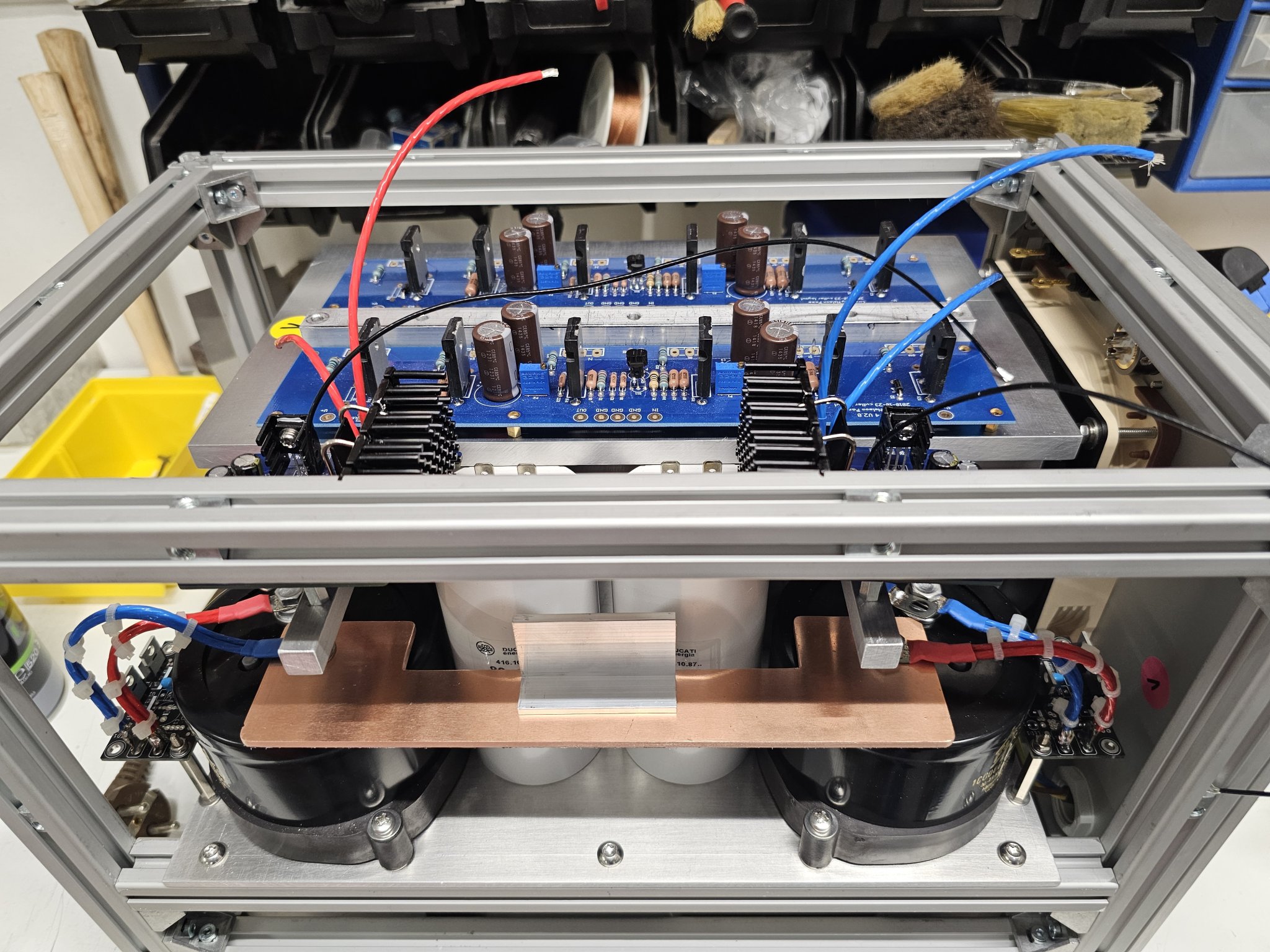

What will be the best way to connect the ground of the amplfier boards to the PSU ground?
1. Green: each board with his own thick wire to PSU ground?
2. Red: shorts wire between boards and one wire from the middle of the connection to PSU ground?
3. White: shorts wire from one to the other board and then one wire to PSU ground?
Should I 'lift' the 'clean' audio ground with an alu bracket a little bit from the 'dirty' PSU ground on the Chopper plate?
Or should I simply connect it direct to the copper plate?
Thank you very much in advance for your help!

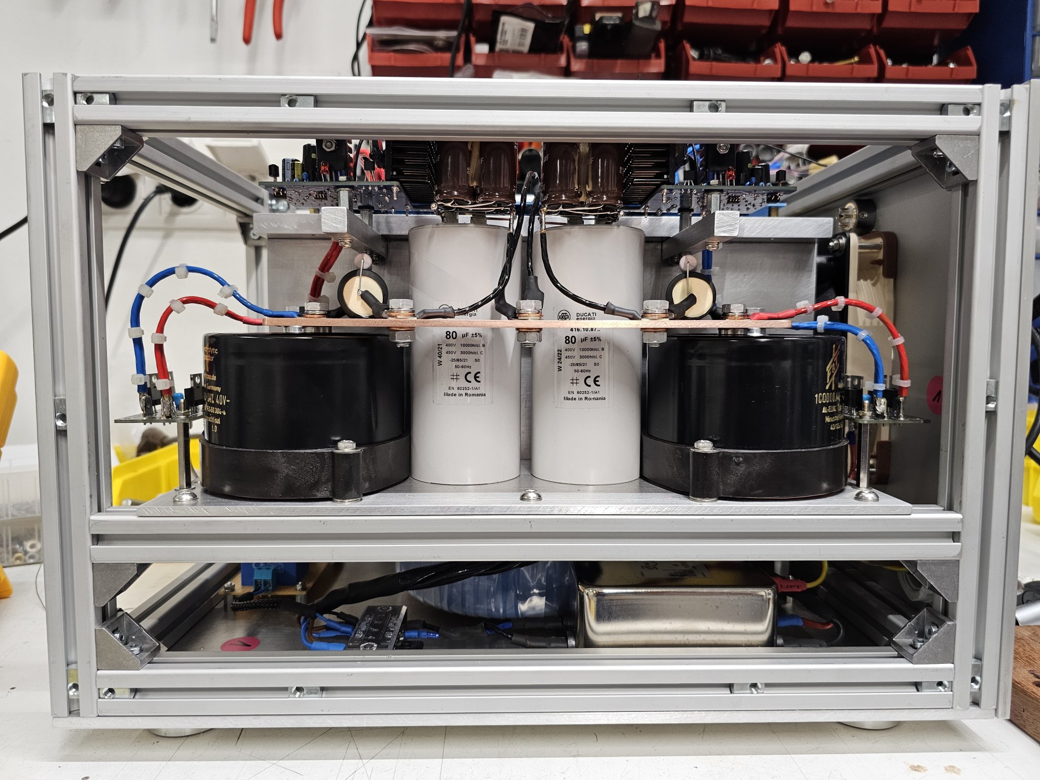

judging by pictures, you have wires to each cap to transfer pumping currents, while copper bridge is free of same currentsOr should I simply connect it direct to the copper plate?
so, exact middle of copper bridge is pretty clean, regarding pulsating currents

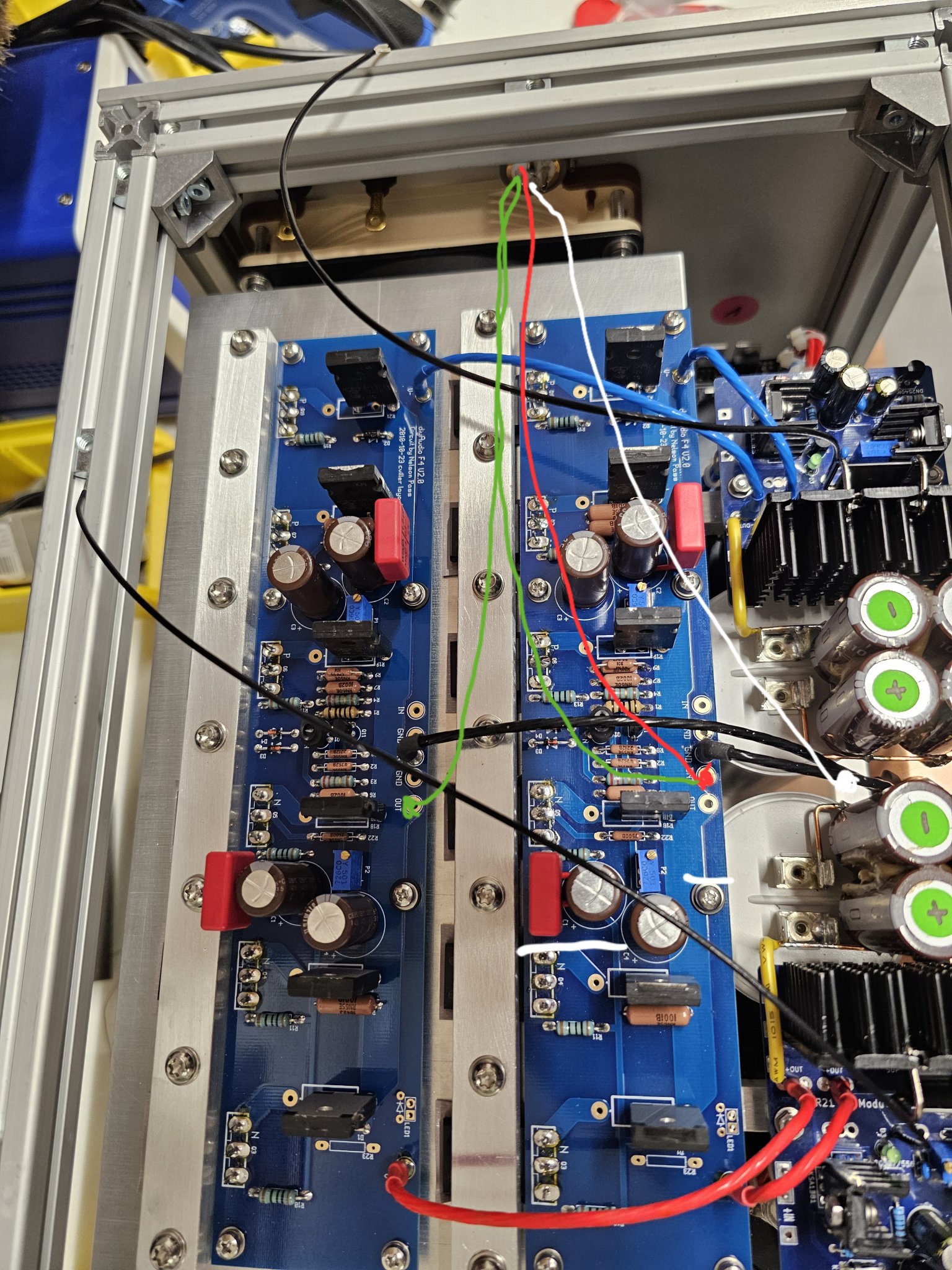

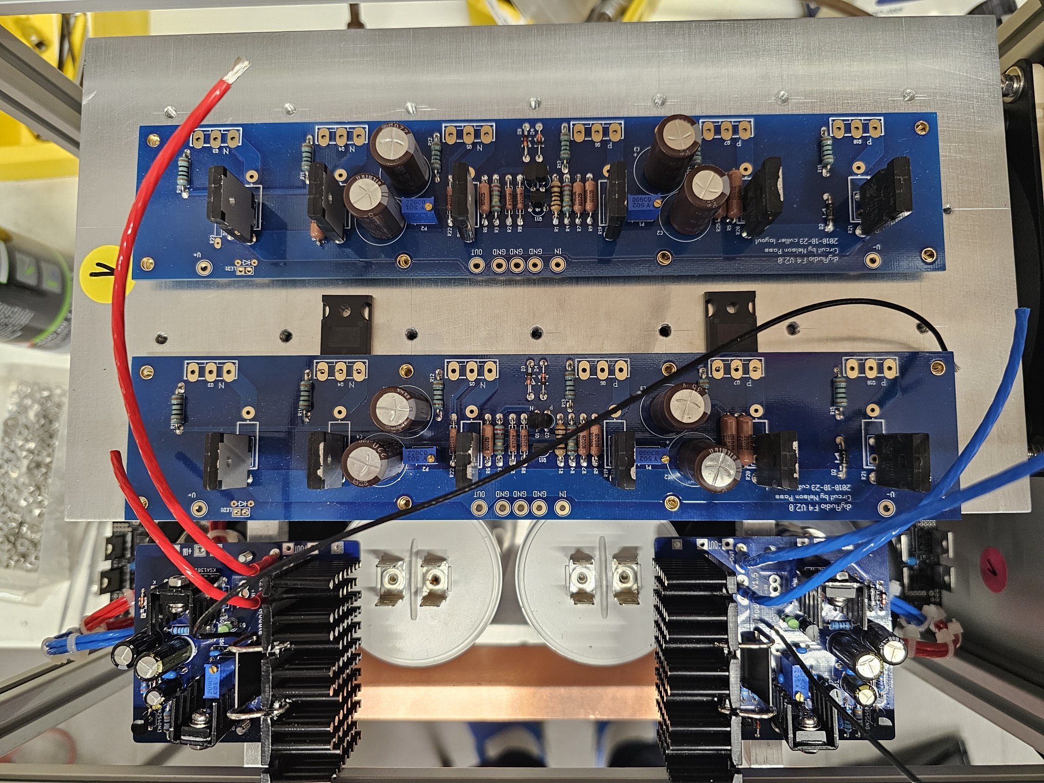

Hello, dear Diyaudio community.

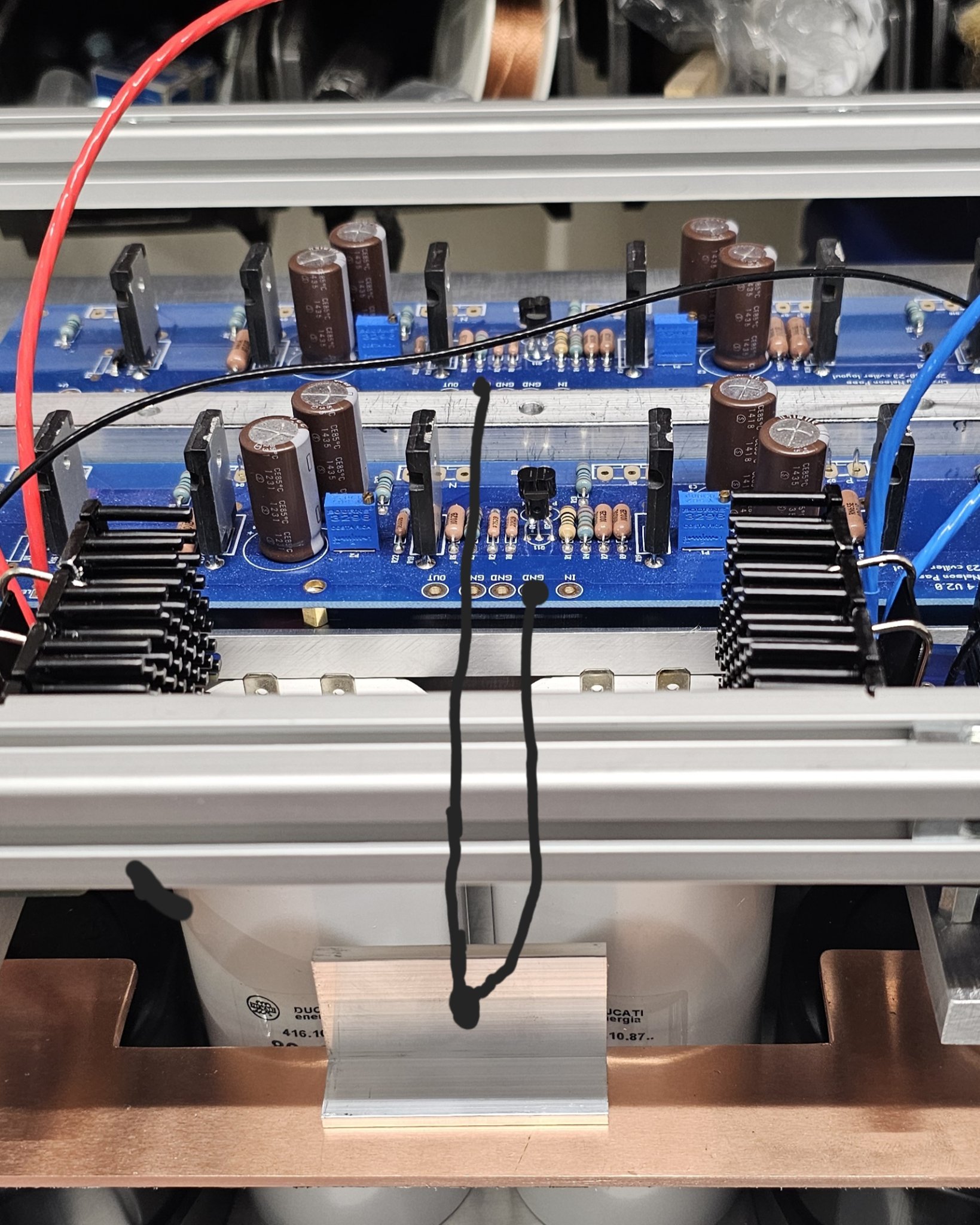

I have another question about the ground connection. This time it's about the signal input.
But first I would like to give a few more details about my design.

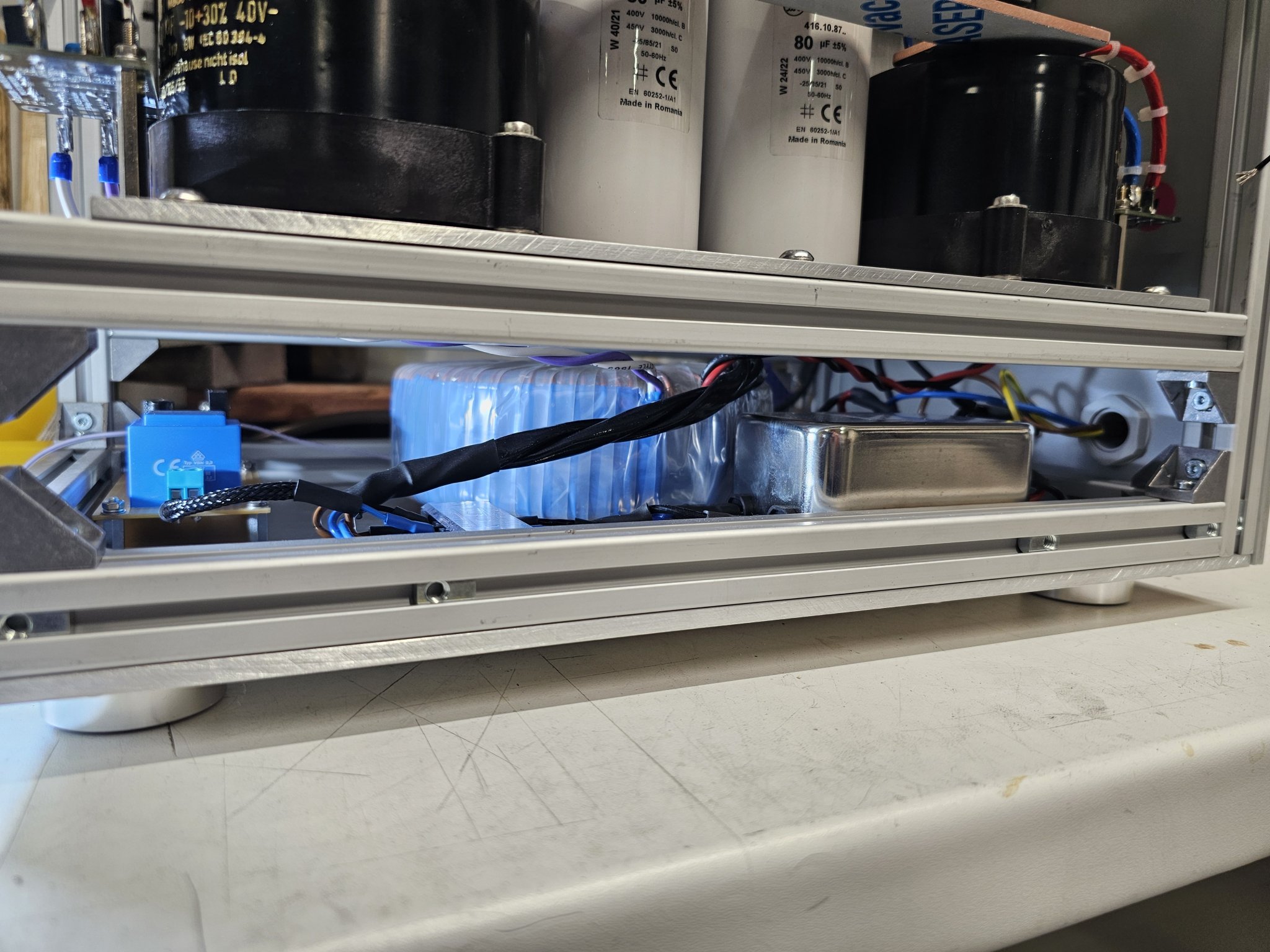

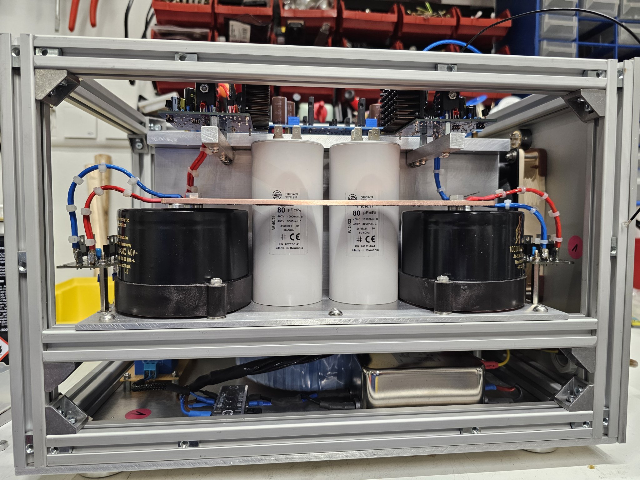

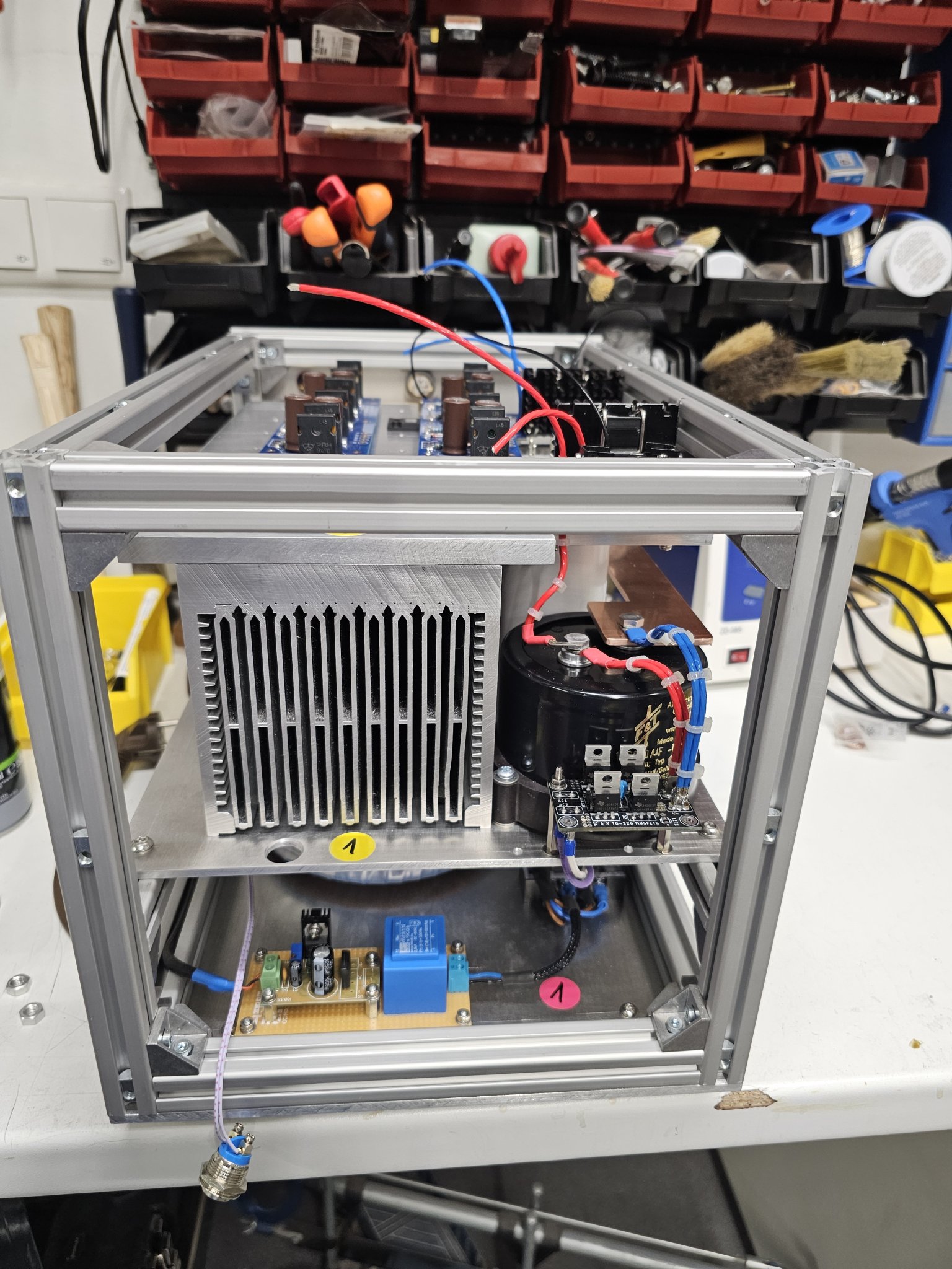

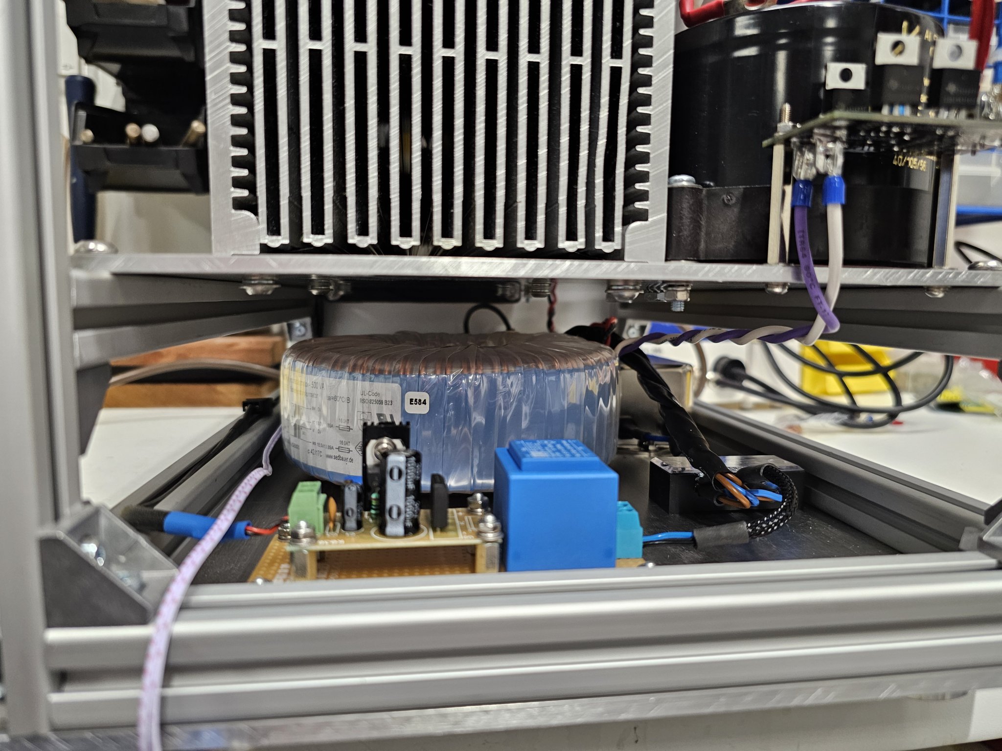

The AC department is housed in the basement.
After the 230V input there is first an inrush current limiter, then a line filter from Schurter, then distribution to the toroidal transformers (500VA, 2x18 V from Sedlbauer) and an adjustable power supply (LM 317 based) for the heat sink fan.
The heat sink and the DC part of the power supply are on the middle level.
First LT 4320 based active rectifiers from @prasi, then a 100,000 uf electrolytic capacitor from F&T with film capacitor and bleeder resistor. Then a voltage regulator R21 from @tombo56 and then another 40,000 uf of elkos and an 80 uf motor run capacitor.
The amplifier boards are on the upper floor.
I use an XLR socket from Viborg for the signal input, and low mass copper binding posts from EIZZ for the output.
The amplifier boards are equipped with a few boutique parts - Shinko tantalum and Takmann Rey metal film resistors in the signal path, Isabellenhütte Manganin resistors as source resistors, WIMA MKC to bridge the electrolytic capacitors in the signal path.
The start-up procedure ran without any problems, the voltage regulation of the PSU works perfectly, I have so far adjusted the quiescent current to 250mV voltage drop across the source resistors - this gives me a heatsink temperature of just 40°C with 2/3 fan speed and 25°C room temperature.
These heatsinks really work great! I found them from a local manufacturer (Alutronic, model PK 717/300).
What is the best way to connect the ground connection of the input signal?
1. One connection to each amplifier board (green)?
2. A common connection to an amplifier board (red)?
3. A common connection to the copper plate of the power supply (white)?
4. Or something else?

Wired mine to handle both RCA SE operation as well as balanced monoblock I connected:
a. each RCA grnd to grnd on board for respective channels
b. XLR grnd to grnd of only one of the boards. (flipped a coin)
If I remember correctly, I tested continuity between signal board grnds and found them connected (assumed via the PSU grnd on the boards). Easy to test.
I went with as few grnd connections as possible to avoid loops. Not sure it is the most correct way but I haven't had any hum issues.
