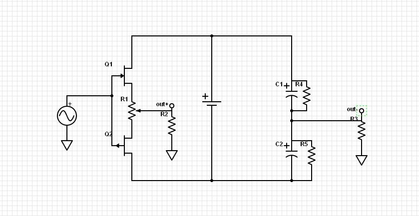

einric,
i'm using the attached. Transfos cost too much for my taste...

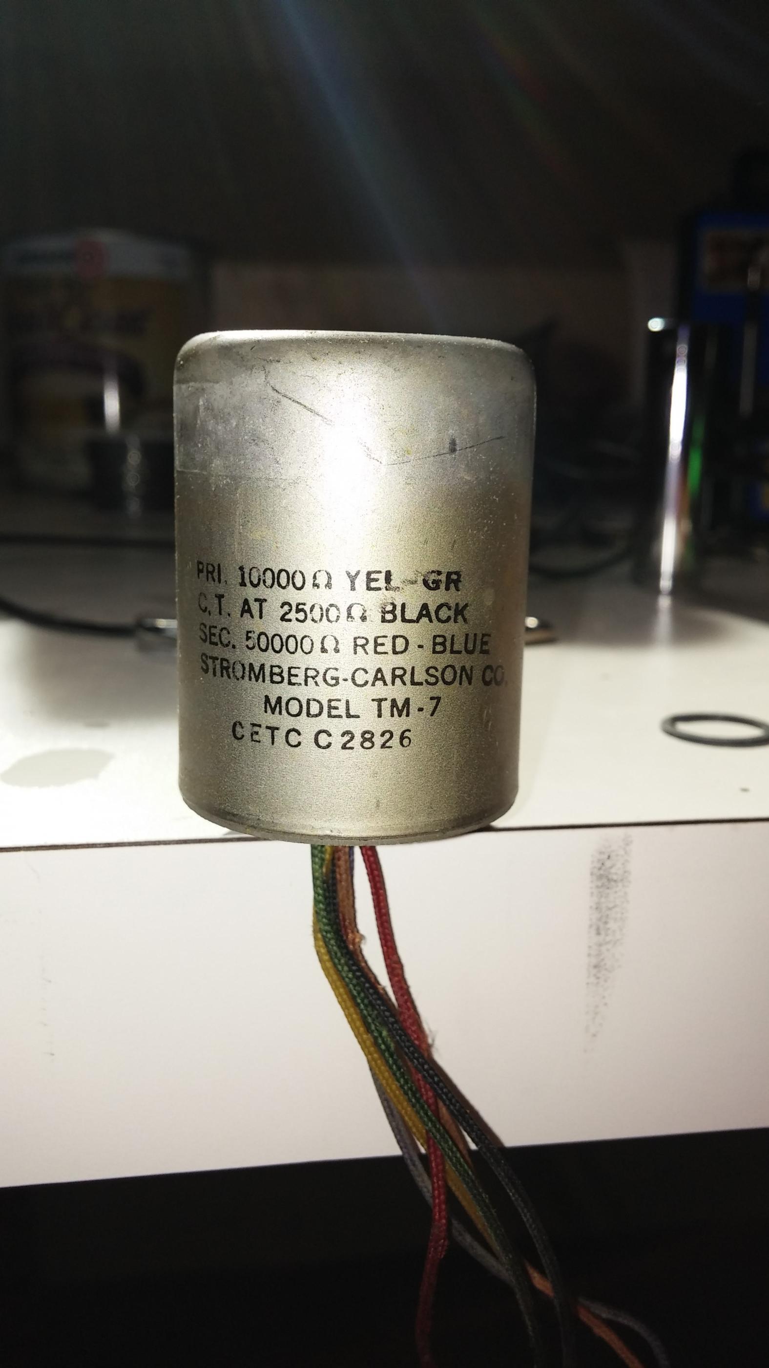

I'm using old transformers from some tube monoblocks that would have cost at least a grand to rebuild.
They are 10k:50k with a CT that isn't shown on the can but it is there on the application schematic and there is a wire for it.
I checked inductance values and it is a CT.
