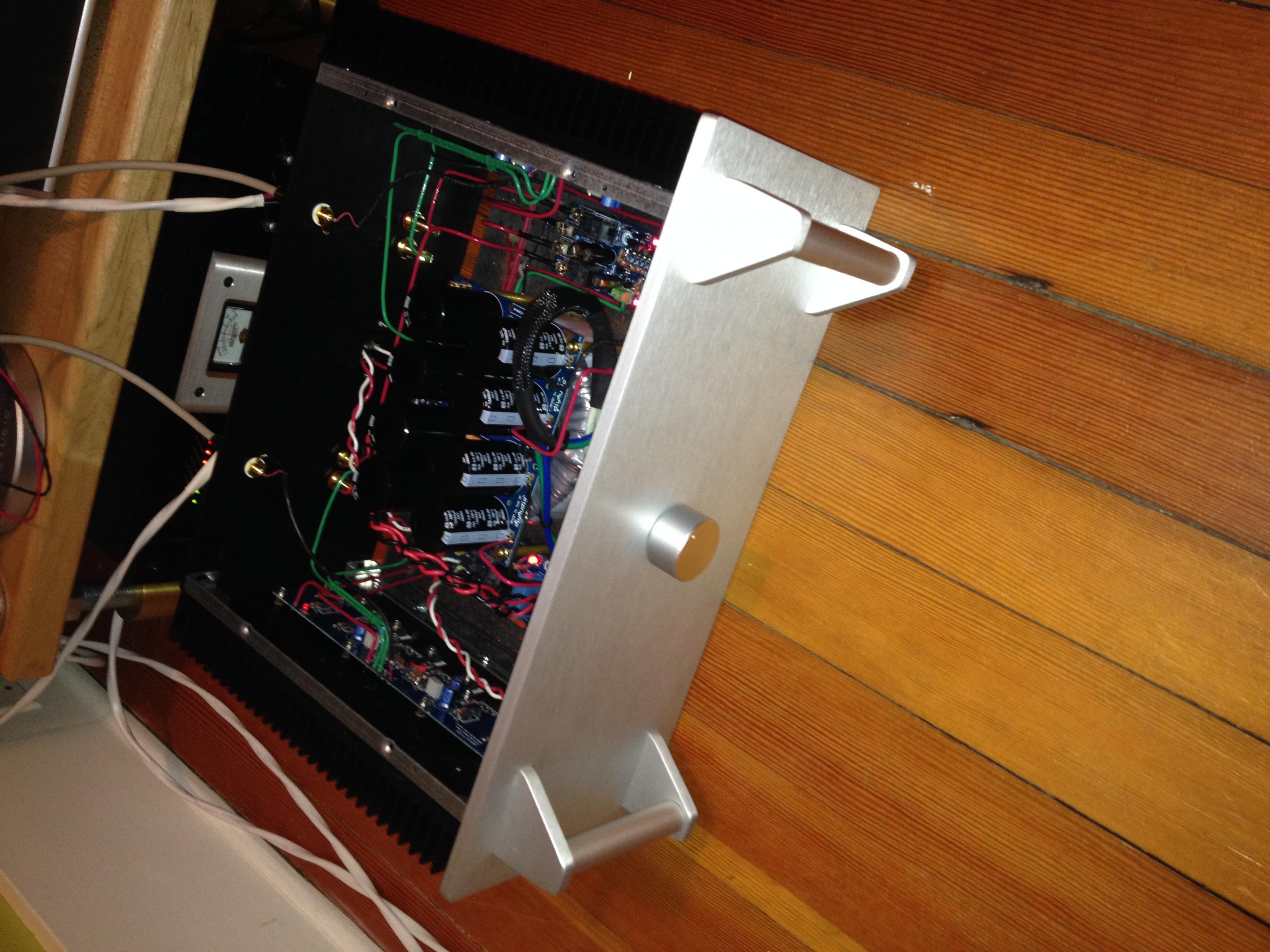

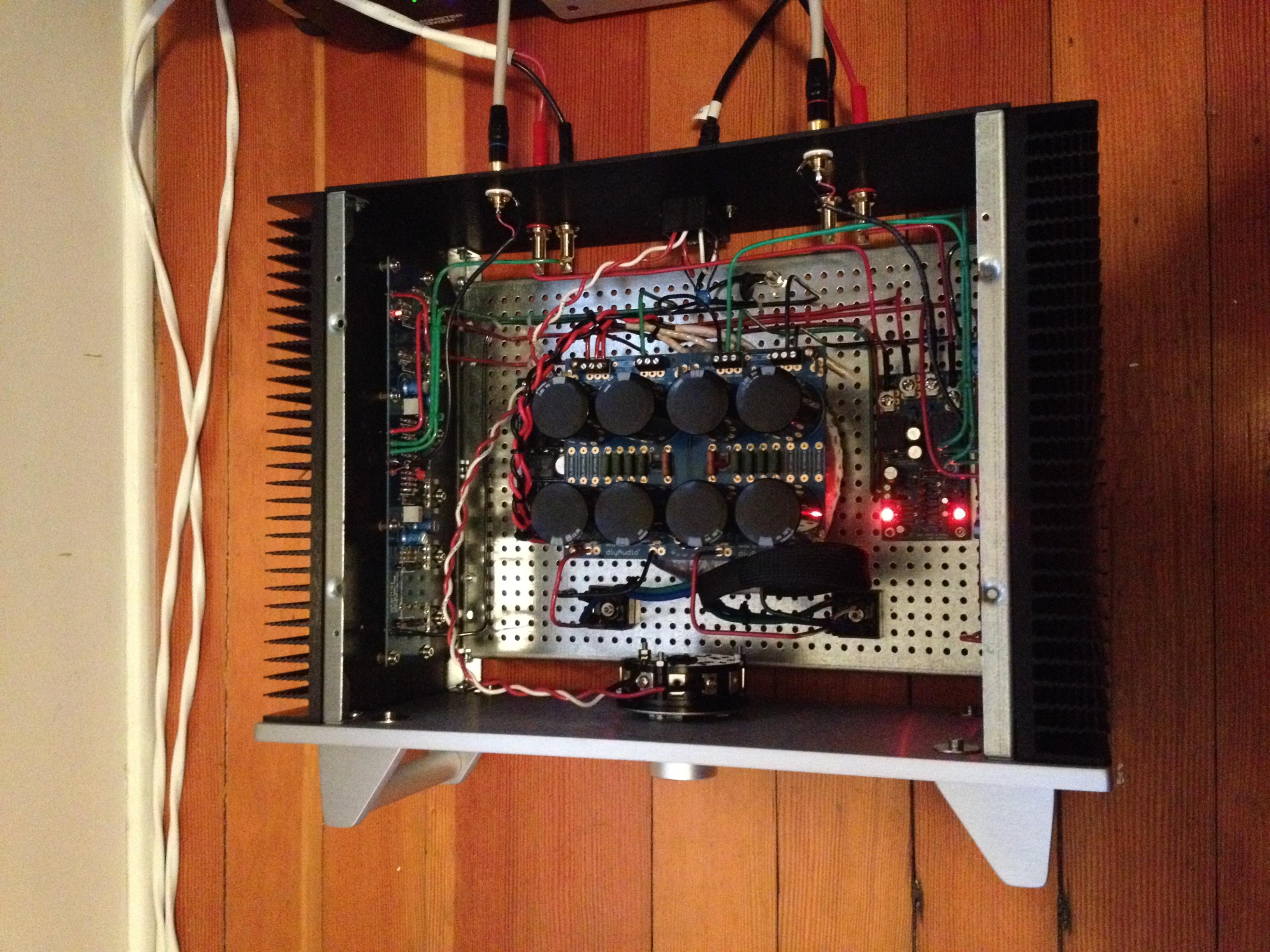

Finished my F4... Thanks to those who offered their assistance along the way. Is using Antek 500VA transformer, soft start, and speaker protection boards. So far so good running behind my 300B SET monoblocks. Surprised at how long this thing takes to warm up 🙂
not much listening time in yet, but what I can say is that nothing struck meas being markedly different...until I turned things up... then yeah... there was a difference there 🙂

Yep, that's the F4 - invisible. It sounds like the device driving it. So if you ever wanted to find out what a 300B amp would sound like with 50WPC/4ohm and an output impedance pf 0.02ohm, now you know. 😀 😀 😀
Love the power switch BTW, complete overkill is always awesome. I bet it has a great solid klank when engaged.
