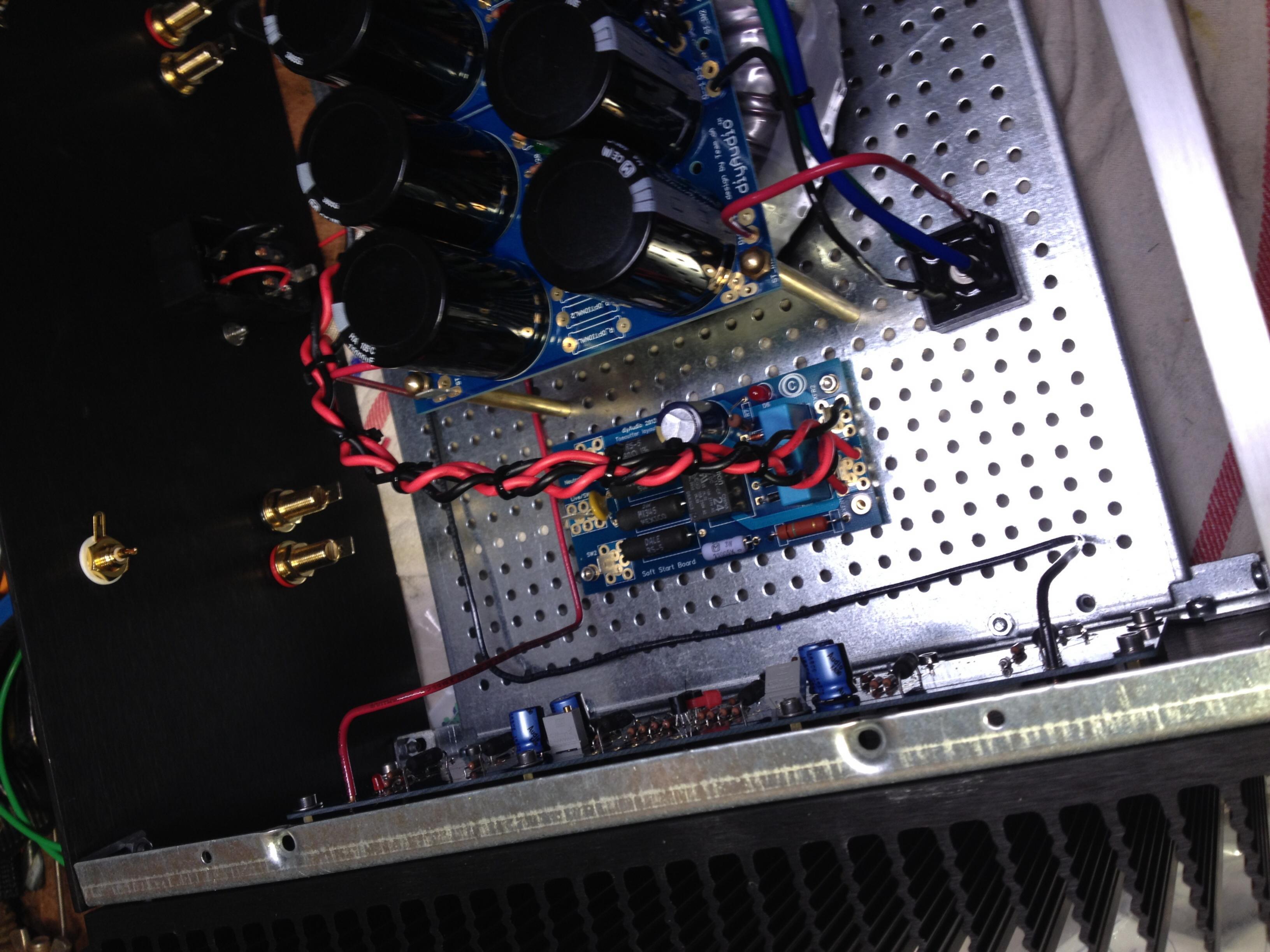

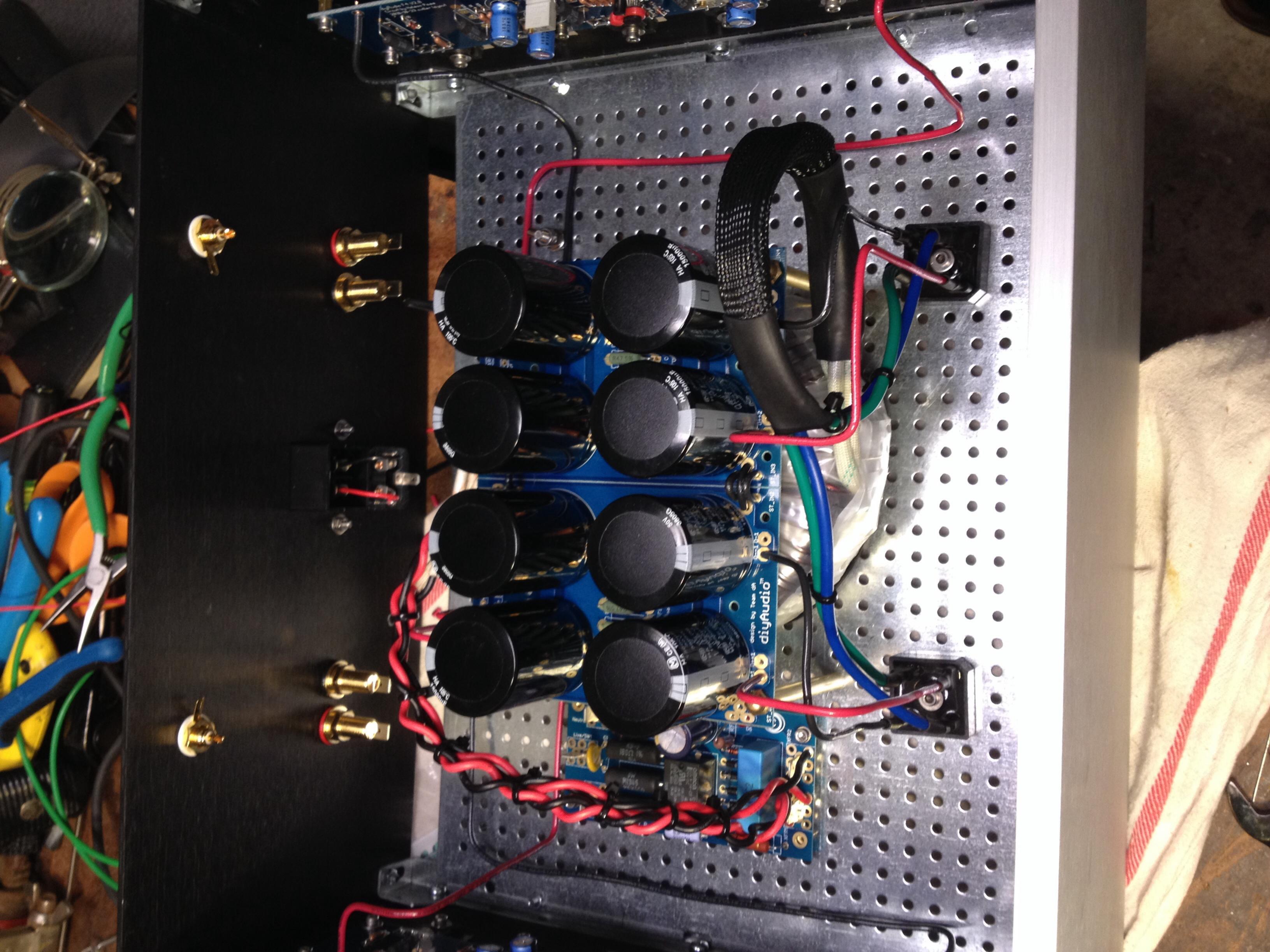

My F4 is slowly coming together... PSU up on makeshift risers over 500VA transformer in 4U chassis, soft start and amp boards in place... Dry fitting wires before final dressing... More work to do. 🙂

Fantastically clean build! Congratulations!
300VA is fine -- the factory FirstWatt amps use 300VA.
If you are going to add caps at the end of the wires, make them big, not little, as you are making another RC filter, and the amp will look to the closest caps for power if a big transient demands it. Adding some polys at the PSU board can't hurt, if you want to play with it.
Thank you for the informative answer 6L6. What do you suggest as 'big' I added 4x 4u7 polys one on each rail, is that ok?
