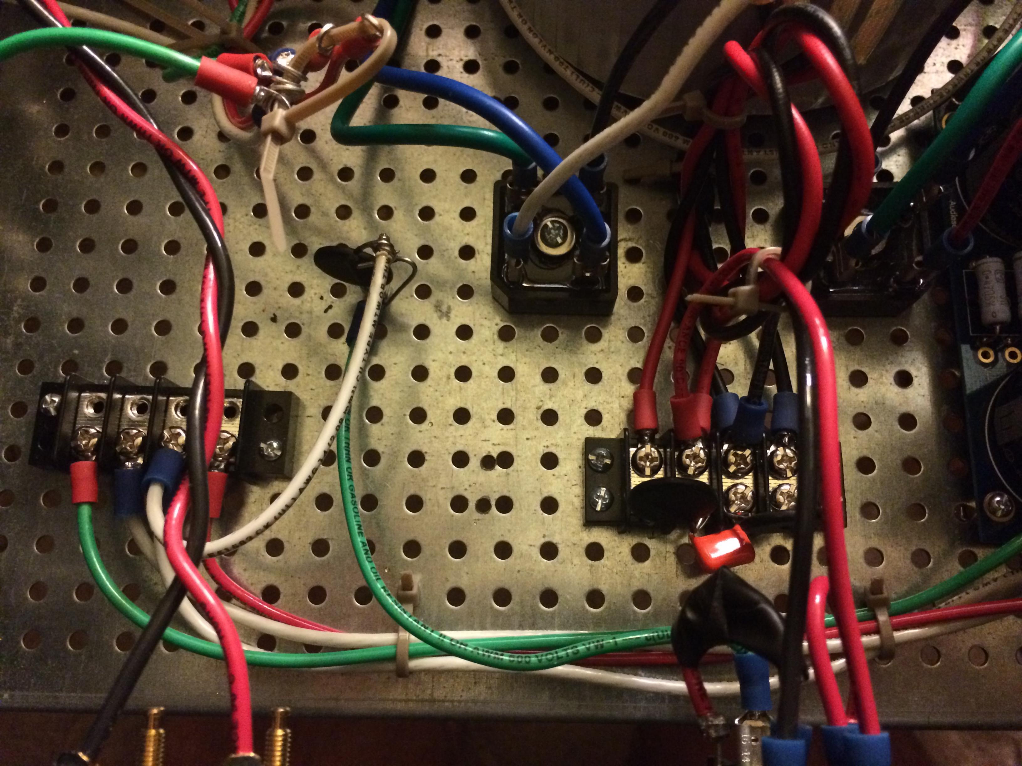

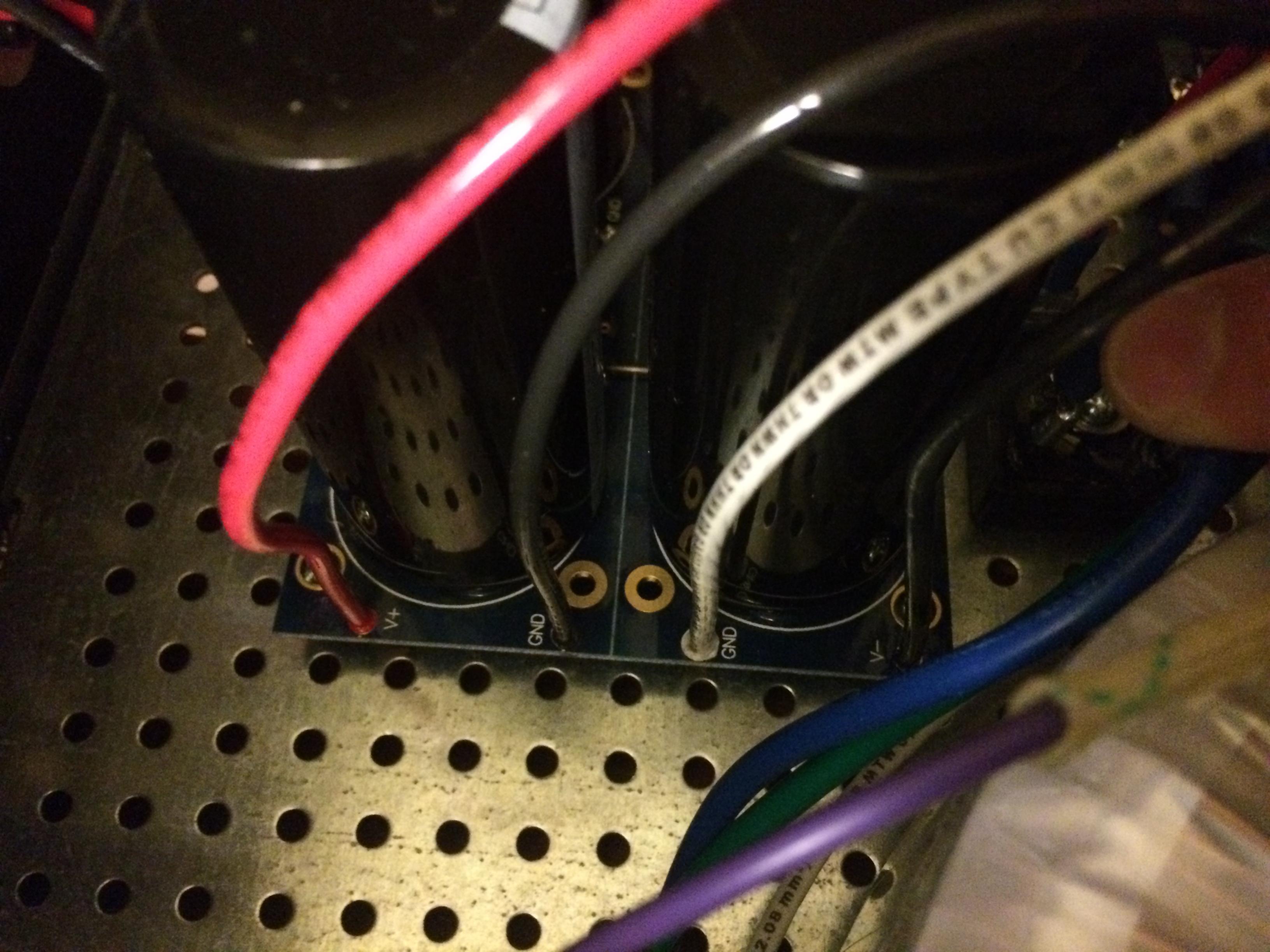

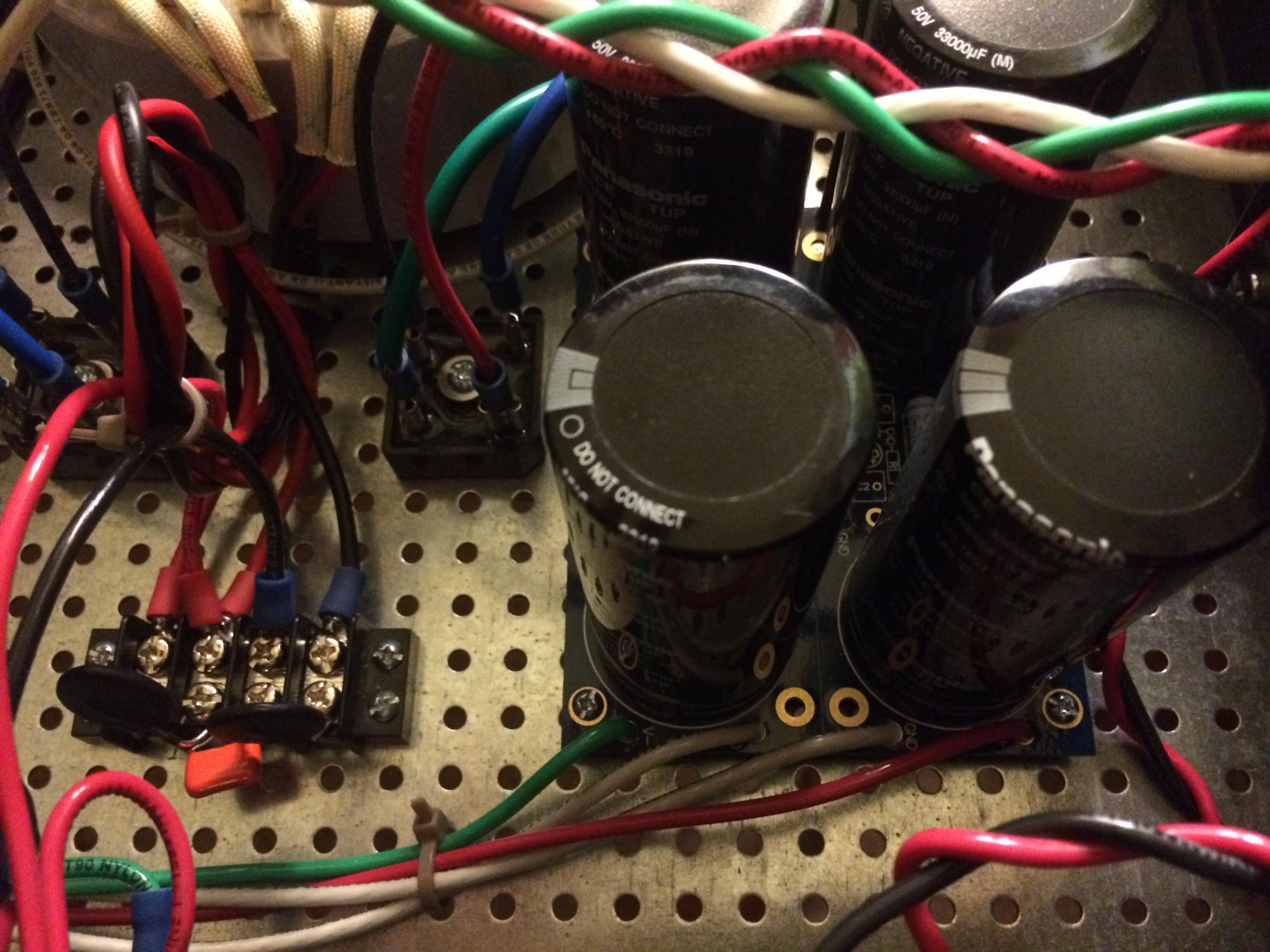

Ready to power on
Have my light bulb tester ready to go. Have everything in the amp ready to go, but the amp boards themselves disconnected to I can test the power supply first.

The voltage is high because there is no load. It will get lower in normal operation.
I'm 95% confident that the bias pot should react the the "normal" way, clockwise should turn things up, counter-clockwise down. (It's been awhile since this amp was in the chassis...)
In keeping with the past few safety minded posts, the charged caps can be very dangerous. For instance, not waiting for the caps to discharge and using a screwdriver across their terminals, will screw up the screwdriver, make a bang like you probably havent heard in your house before, blind you, and cause you to jump back and hit something. Maybe other unwanted things also. ;)
