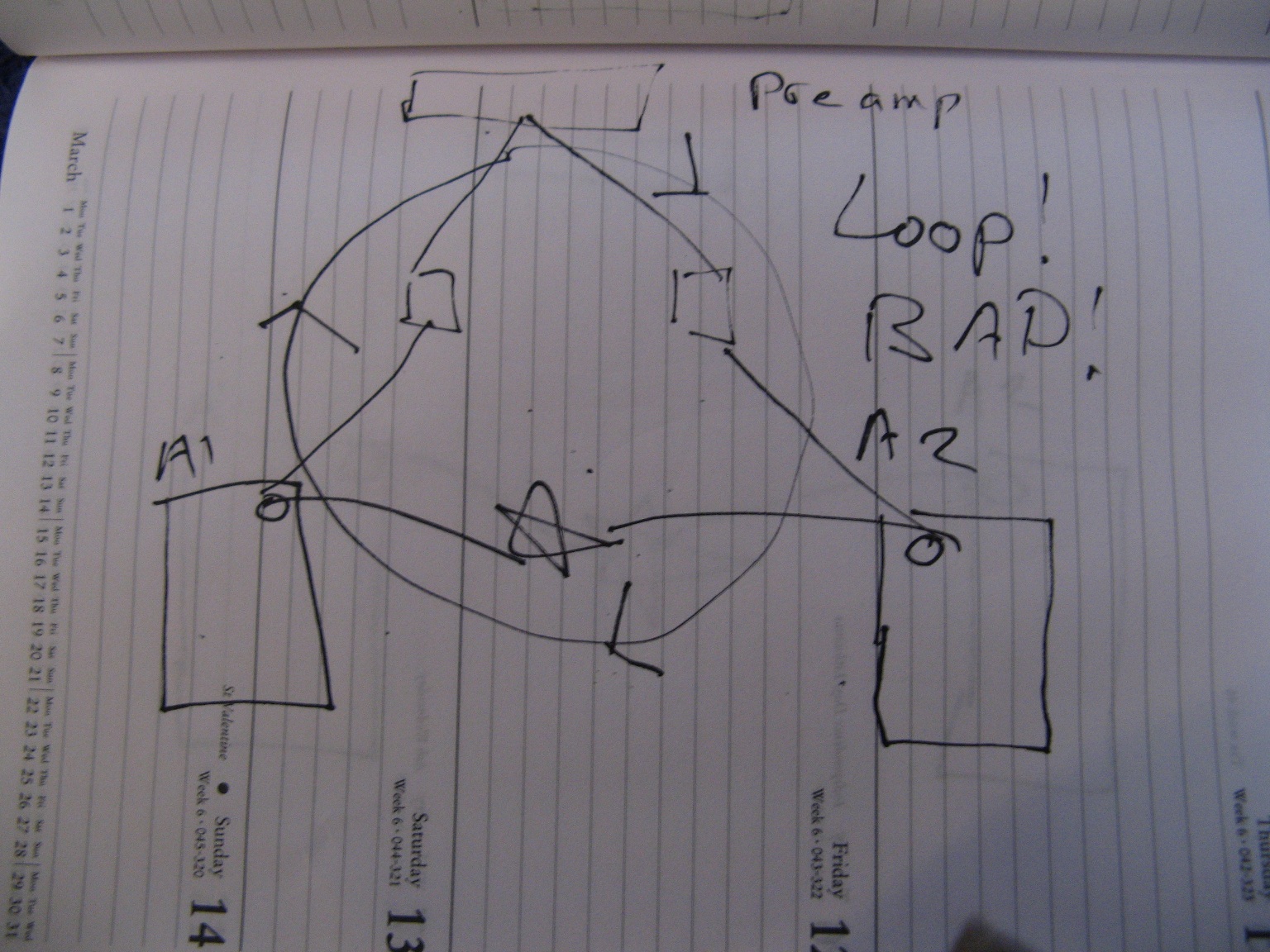

If we're talking about a standard earth breaker resistor, such as would be implemented between the star ground and the mains earth, then it doesn't matter quite so much what the value is.
The point of the earth disconnect resistor is to control where the ground currents are choosing to flow. Say you've got two devices connected via shielded interconnects and those two devices are also connected to the mains earth via the earthing pin in the IEC connector. You've instantly created a loop.
From the first device into the second device via the interconnects, from the second device to the mains earth via it's IEC connector, then from the mains earth into the first device via it's IEC mains connector. Due to the slight difference in ground potential between the two devices a current will flow through the interconnect shield, this is where you get your induced hum from. If you place a ground breaking resistor in one device the current will no longer flow as you've 'disconnected' one device from the mains earth and in doing so, broken the loop, thus the hum stops. This is why double insulated devices are common in hifi for pre amps and CD players etc. You can't get a ground loop between devices if there is no connection to mains safety earth to begin with!
This illustrates the point of a 'breaking/lifting' resistor, it creates a path of relatively high impedance somewhere in the grounding organisation and as a result stops a current flowing in an area you don't want it to flow.
Inside a piece of equipment, you can add as many of these as you want, if necessary, to control the direction of the ground currents. You have to do this with caution however as you absolutely must not break a circuits return path to the star point. The breaker resistor is merely used to prevent unwanted ground interaction between independently functional blocks.

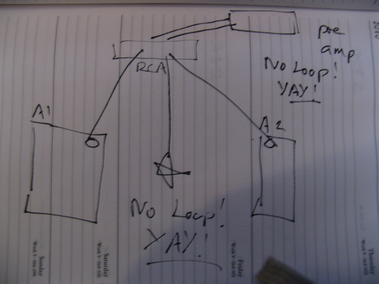

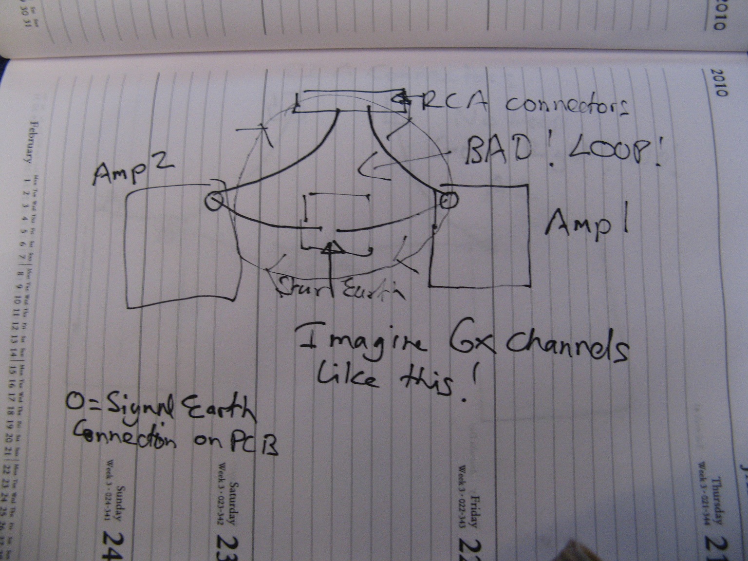

The one area where it is so very easy to create a loop is such as the situation you are facing with your active crossover + amplifier in a single chassis.
Naturally the amplifier has a power return, a signal return and a return from the load.
The power return is from the decoupling capacitors and has been dealt with by taking it separately back to a point so very slightly downstream of the audio signal return.
The load return goes back to the main star point as does the signal return. BUT, and here's the main but, the signal ground also connects to the input RCA connectors. If the chassis is connected to the star point you've just created a loop right there inside the amplifier BAD! This is why John and I don't have the RCA connectors electrically connected to the chassis.
In my 6 channel amp the RCA connectors are all connected together on that common aluminium plate and the signal ground from the RCA connectors goes directly to the signal ground on the amplifier PCBs. So far so good, but the amplifier signal ground (as this includes the feedback networks shunt resistor) also has to be connected to the star ground inside the case.

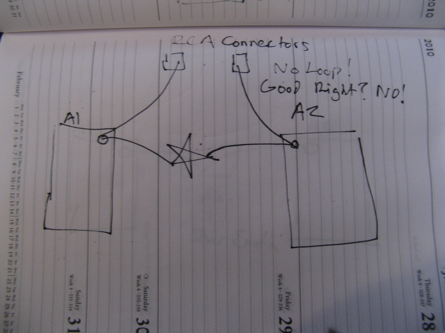

If I connect the signal ground from each amplifier channel back individually to the star point, you'd think, okay fine, job done! That's what I thought, but no! It didn't work. Why? Because connecting each amplifiers PCB signal return trace back to the star ground created a loop and not just one loop LOTS of loops. (P.S you can take pictures of a drawing with a digital camera, you don't need a scanner!)
Here's that scenario;
Well okay I thought, this is bad, lets separate the RCA connectors right?
WRONG!
Okay so now what? Lets join the RCA connectors back together again, only this time...
Yay finally solved it.

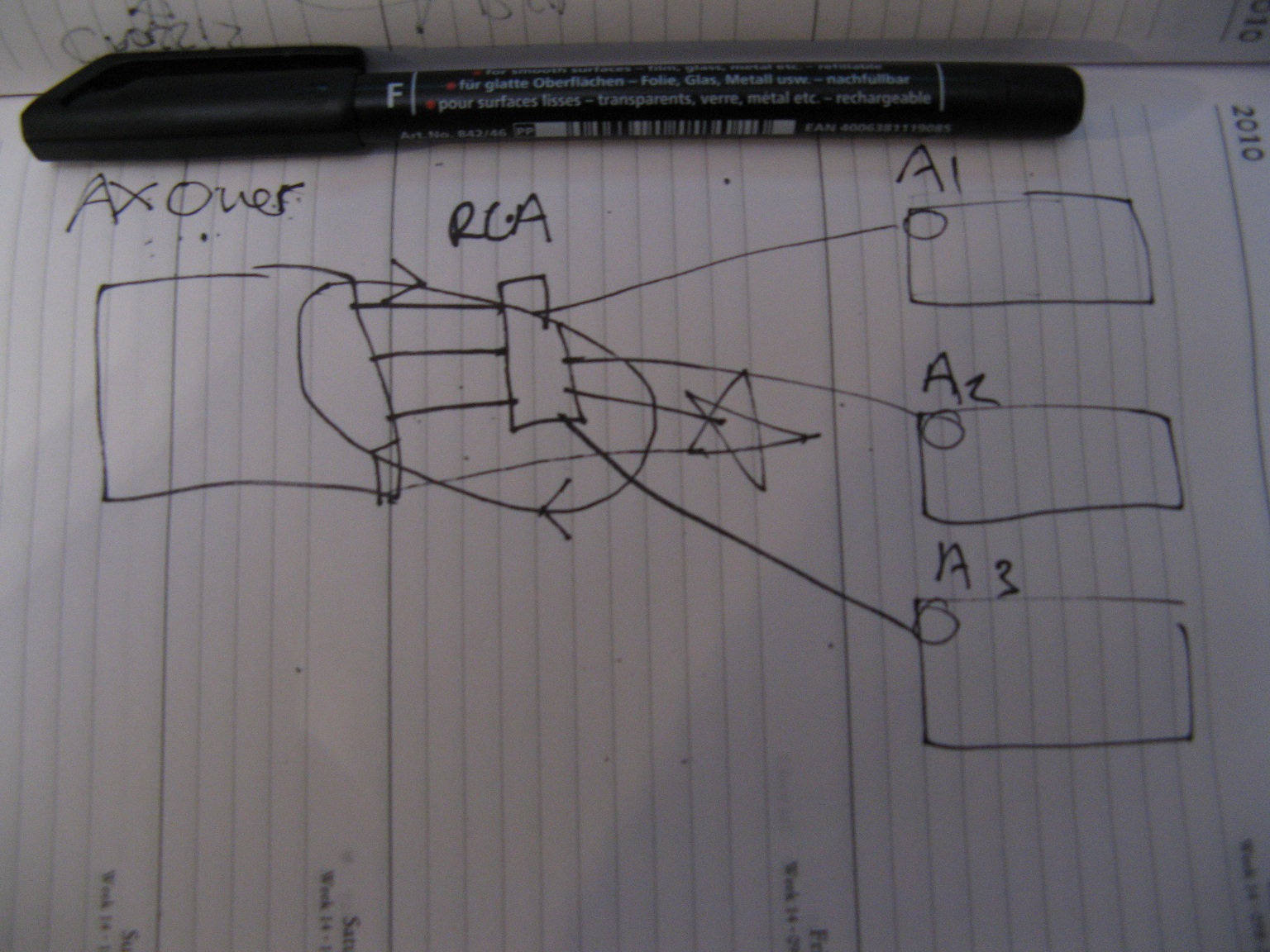

The first task you should accomplish is connecting all three amplifier channels together with zero internal loops. And zero internal loops when the amplifier RCA connectors are plugged into another device.
As Andrew has mentioned you start with one channel, then work your way up. If you're lucky the technique used to connect two channels up successfully can be repeated for as many channels as you have.
Only once you've connected up the amplifier do you start with the active crossovers.
This is where trouble can ensue though and judicious use of disconnect resistors is highly recommended.
So say you've got your amplifiers configured as I solved my issue and then you go adding in the active xover module in this way.
In this situation the active xover has it's ground connection made directly back to the star ground. You have also got the signal return from the RCA connectors from the amp connected back to the ground connection on the active xover PCB.
This creates a loop and you get hum. What does it remind you of?
That's right the ground loop occurring between two different components as described at the start of this post that is corrected by the insertion of a ground lifting resistor. Only instead of the loop being created by the safety earth, it is now being created by common star ground.

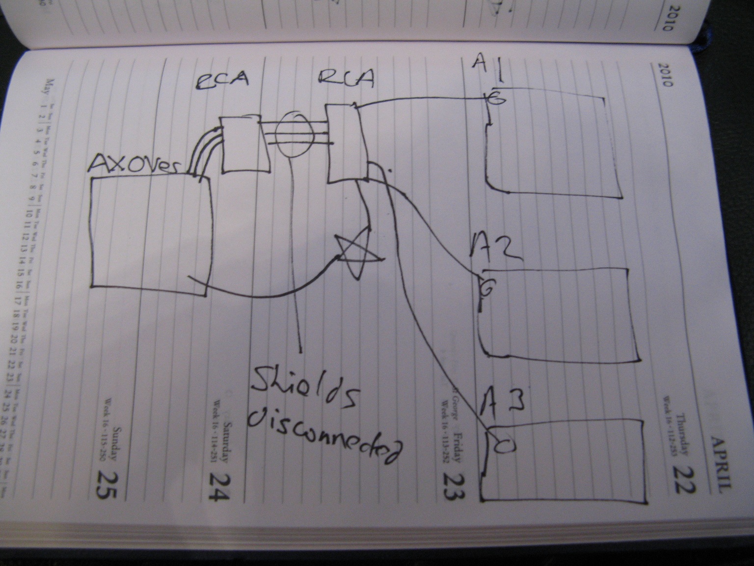

Can we safely remove the earth connection from the xover module to the star ground? Yes, IF we keep the ground connection to the xover module through the RCA connectors there at all times. Is this a good idea? NO! Why? Because if you want to disconnect the active xover from the power amps what happens to its ground return, it goes poof and then so might the active xover. Also any return current from the active that is NOT signal related will be forced to flow through the RCA shield. This is bad!
Remember this?
This created a horrendous degradation in the amplifier performance. Because of the loop, some of the return current from the load went into the loop, not a lot mind you, but some did! That was all it took and the distortion performance went from like 0.0003% to 0.02%. This is an exaggeration of your situation as the return currents for the active xover are likely to be very small. Still the only current that should be flowing from the amplifier and back into the active xover board, should be the return current for the signal sent through the RCA connector.
So what about the alternative?

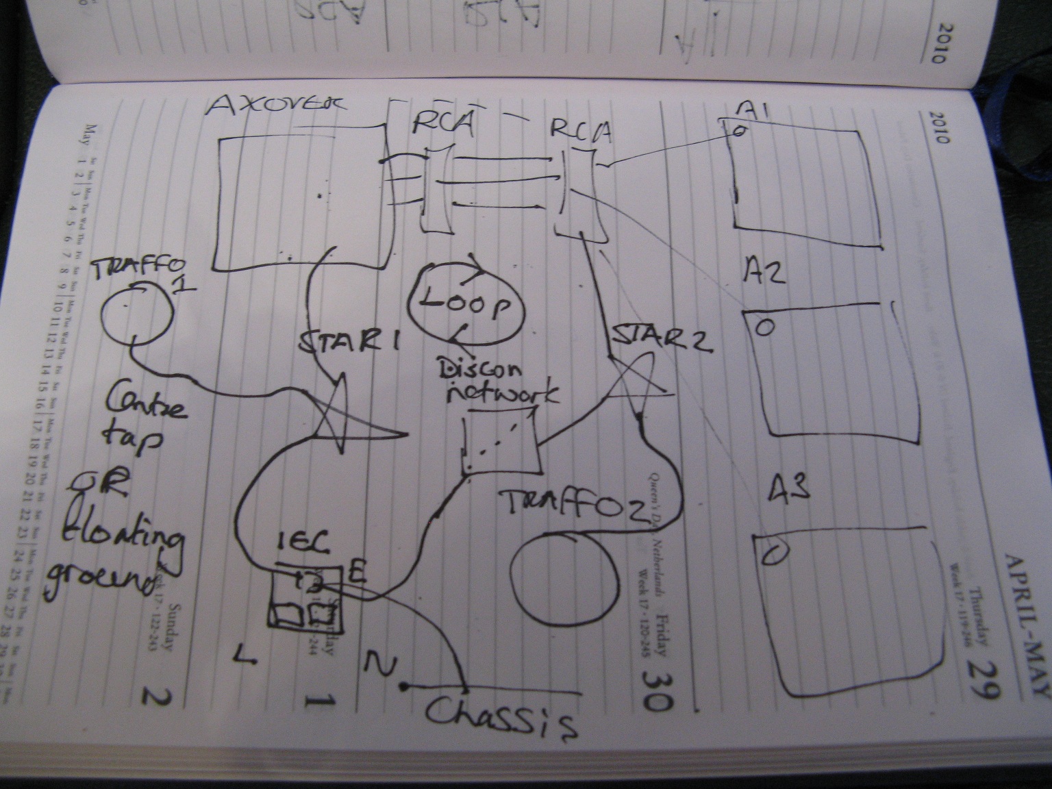

The alternative is to disconnect the ground connection from the active xover board that goes into the shielded wire that connects to the RCA connector. This will break the loop and force any return current to go through the star return point and back down the wire that connects the active xover board to the star point. Is this bad? Not really. What's the down side? Of course there had to be a down side right? Yup!
Lets say you want to connect the output from one of the active xover cards to another amplifier somewhere else? Now the signal the active xover card puts out can flow down the wire to the other amplifier, but where does the return current flow? Urrg hmm? The RCA ground connection to the active xover board isn't there so er... Okay right, your other amplifier is double insulated and has no ground connection at all, so err... it CANNOT RETURN ANYWHERE! through the ether! yes! Lets break the laws of physics!
This isn't ideal either what can be done?
Here we have a second set of three RCA connectors mounted on their own piece of metal, with a return back to the active xover PCB. Now you can connect the active xover to another amplifier without any trouble.
This isn't ideal either why? Because ideally you'd like to be able to connect the power amplifier to the active xover card with a shielded internal cable. Okay, well how do we do that? This sounds vaguely familiar right? Sure does, when you've got a completely separate box that does active xover and a completely separate power amplifier.
Like..
Only the active xover resides in the same case as the power amplifiers instead. How do we do this? Easy!
Treat the active xover card and its power supply as if it were an independent unit.
As you can see this closely resembles two individual boxes, say a preamp and a power amp. With two individual boxes and two IEC connectors back to safety earth, we have two different possible potentials for the units to be at and hence a ground loop forms, a current flows and we get hum. If both units are in the same case this isn't going to be an issue, the IEC connector is common to them both, but we still need a disconnect module otherwise the internal loop shown will form.
It should be noted that if your source (CD player etc) isn't double insulted you might need another disconnect network from Star 1 back to the safety earth pin.
I hope I haven't goofed something up with all of that
and I hope it helps!

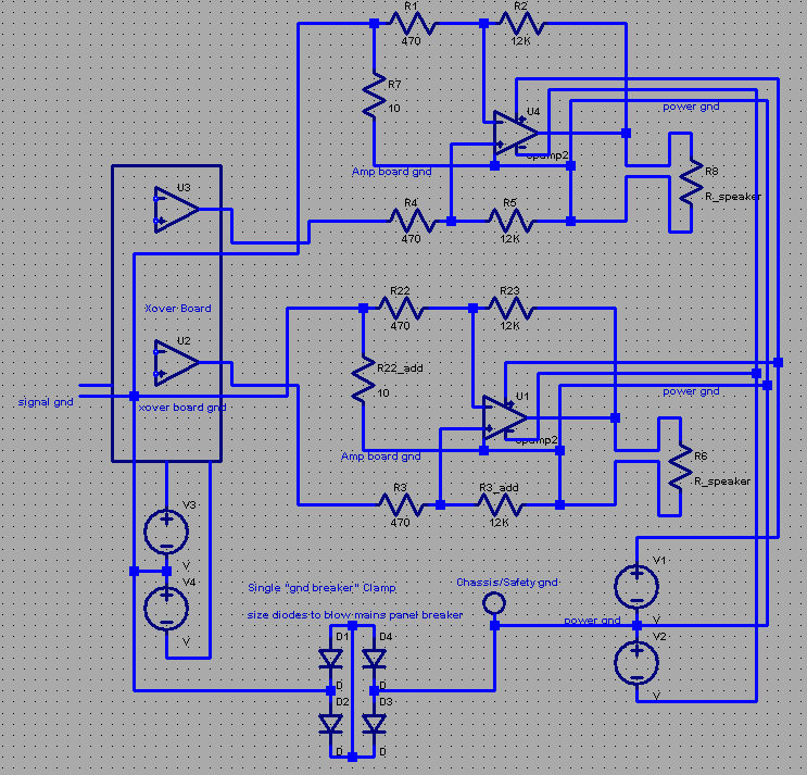

in my differential reciever mod the added "gnd break" resistor is just there for amp stability when nothng is connected, not knowing how much margin the amp internal compensation has I would keep the value down to ~< 50 Ohms which only decreases loop gain by ~10%
the higher the value the better from a "gnd loop current breaking" perspective
lower value R turn any differences between amp channel gnds, chassis and exteranl source signal gnd into bigger loop current - higher value causes less current - some of which flows on gnded coax shields
just reposting same pic - no changes
Great 5th! Now I can finally see alll the images, will read through again and xompare with my own set up.. which is now exactly according to the schematic posted by JCX! 🙂
And thanks for the Info JCX! Since I am not certain (to say the least) about the margin(s) of my amp design, I guess I'm best of to leave it as it is wit the resistor at 10 Ohms. Seems this mod did the job well and what ever hum/ noise I have left must be dealt with by adressing other parts of my design/ layout.
Thank you very much for looking in to this and for providing schematics and explanations allowing me to implement this, greatly appreciated!!! 🙂
5th,
I've read through your post again looking at the (now visible) schematics, and your explanations seems both consistent and in line with what I've ended up with doing.
Following the accepted logic, If I had disconnected the grounds between the x-over output and amp inputs and connected the ground of the X-over to the star-point, all ground references should be maintained and no loops formed.
I tried this, and that left a lot of noise on the outputs.. strange..
The only explanation I can find is that this left the 0V reference on the amplifier inputs and on the x-over card with different potentials (as in "different" noise and ripple") due to the "roundabout" routing of 0V connections that could be suceptible to hum induction and amplifier power-return influence etc..
But now, with the "differential receiver" mod as described by JCX, I can connect the x-over card to the star-point with no deterioration, in fact, it doesn't mattet if it is connected or not.
So perhaps the ground-breaker, or more correctly, "differential receiver" mod was really not such a last resort after all??
Perhaps It would have been if I had proper separate power and signal returns from my amp cards, but that I have not..
Tomorrow I'll buy some thinner and more flexible wire for the PSU-to amp wiring, and do some properly twisted PSU wiring. Will be interresting to see if that Improves matters further, that and some revised component values in the X-over card for the sub LP filter section.
With a class AB amplifier, as I am sure you have read, the supply rails have half wave sine pulses injected into them, if the amplifier is passing a sine wave.
Just as with high frequency EM radiation, twisting the power cables together helps to reduce this and in doing so helps to reduce the chance of induction based distortion - Self's distortion number 6.
Having an incorrect grounding scheme on the amplifier cards is unlikely to be a cause of noise like you described here.
The splitting of the signal ground and power ground on the amplifier PCB should not have anything to do with ground loops or the creation of noise. It would only present itself as a linearity issue as the power ground injects hash into the signal ground when the amplifier is under load.
If the noise you are hearing is anything other then a humming or buzzing sound created from the mains frequency and it's harmonics, then something else is at fault. Like lots of hiss for example.
