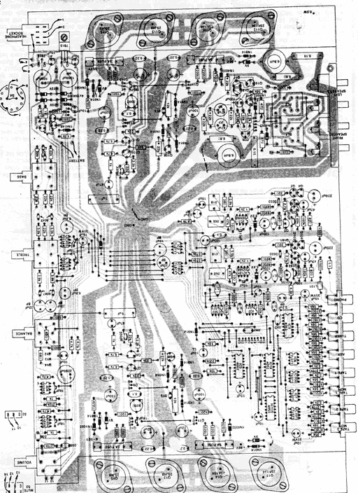

First of all, I must say that the source of your 3rd harmonic problem was quite surprising! It must have been great to finaly identify and solve that, well done! (niot that I understand half of the other things that were investigated and tried...)
I found that a great surprise too. Somewhere in the back of my mind I knew that resistors had voltage ratings, but I always thought this was of a magnitude many times greater then anything I would ever (willingly) encounter. It was certainly a good moment when I figured it out though!
The first thing I notice, is that you have separate star-point returns for the rail decoupling capacitors, signal ground and loudspeaker returns.
My amplifier cards only have one return for all three, which is not according to what is defined as best practice according to some..
Well it's not just according to it's actually proven theory and proven practise. The decouplers inject all sorts of nasties into the ground that they feed into, if this enters and contaminates the sensitive input circuitry you can badly degrade the performance of an otherwise perfectly good amplifier. Now Douglas Self goes out of his way to exaggerate and show the worst case scenario for most of the distortion mechanisms he describes. In the real world you may not exactly degrade your performance by as much as he describes, but as it's often very easy to take the correct precautionary measures if you simply know about them in the first place.
I have allso read that a separate rail decoupling cap return should not be returend to the main starpoint, but to a point "upstream" of this, but it seems to work for you, especially considering the distortion figures you were finally able to obtain!
The rail decoupling should be returned to a point downstream of the signal ground return point. If it is placed up stream, it will 'flow' over the return point for the signal ground and risk contaminating it. At least that's how I've viewed it.
This is more important on a PCB with a ground plane, where the return path from the PCB to the star point is a wire located at one end of the PCB. At the far end of the PCB you've got a digital signal processing power house with all sorts of high frequency switching going on. At the end close to where the ground wire joins the PCB you've got a microphone pre amplifier. In this situation the dirty current returning from the DSP flows through the ground plane and over the mic preamp circuitry and as a result degrades the preamps performance. If the mic preamp had been placed at the far end of the PCB, and the DSP chip downstream of it, then the dirty current returning from the DSP would not flow over the mic preamp circuitry and all would be well.
Technically speaking you should be able to arrange the three returns (signal/load/decouplers) on a PCB so that they will have minimal interaction. Also none of this really has anything to do with ground loops that cause hum. You could simply measure the distortion performance of an amplifier card and see if it's within spec.
If I had signal ground disconnected from "power" ground. i.e. loudspeaker and decoupling cap return on my cards, and provided signal ground to the input and feedback shunt resistor ground points through the x-over board connection wire screens, and having the x-over board ground connected to the star point, I should in theory have the same grounding layout as you have?
This is of course assuming that you have the feedback shunt resistor and input ground connected directly to your signal ground with no "ground breaker resistors" etc..
I'll have to go over more of the thread and see exactly how you've got yours currently arranged as I need to go to bed!
The input ground on my amplifier PCBs has for all intents and purposes, the feedback shunt resistor and the resistor that sets the input impedance connected to it. I found that connecting the return for the constant current source didn't do anything to degrade the performance either, so that could be connected too if you want.

Very interresting your point about PCB layout Vs. ground returns.
To the degree I'm able to judge, it seems the designer of the Crescendo ME cards has had this in mind. Allso looking at the distortion measurements in the magazine article, they must have gotten something right! :
Good to hear that you allso run a groundbreaker resistor in your amplifier design.
Considering that both you and John use that and have working multi-channel amps, I think it is very obvious what I need to be doing over the next days! 🙂
Connecting the currnt source ground to the audio ground will be a bit more involved with my cards, so I wont pursue that.
But I'll connect all the grounds in the input network/filter to the Audio ground. By doing this, I can get away with cutting one PCB trace, jumper a 10 Ohm resistor across it, and then tack on that 18K input impedance adjustment resistor.
I'll do this on a card that is "easy" to get to today and see what it does for me, or, the amp rather.. 🙂

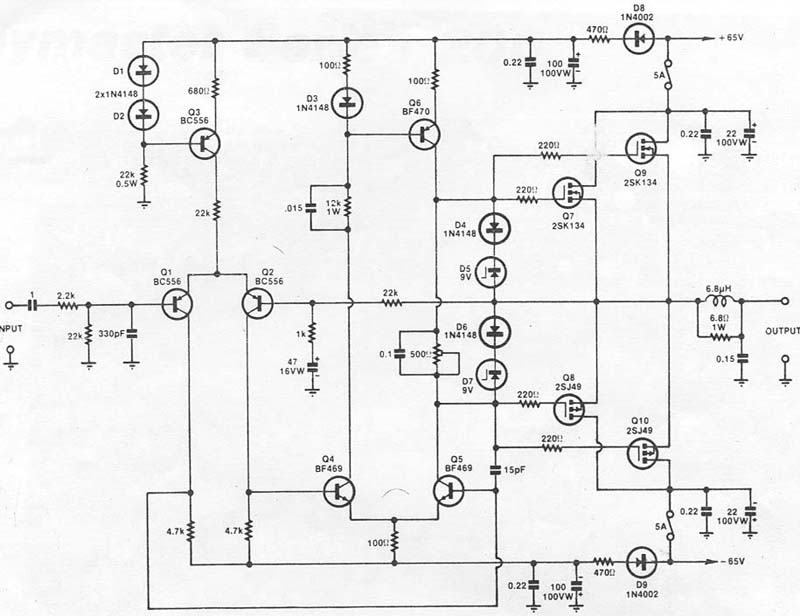

Hmm.. just a question regarding the modification here.. JCX recommended that the 18K (12K) resistor that goes from R3 to signal ground, be connected to signal ground at the same point as the 10 Ohm resistor.
Looking at the PCB layout, there are two ways I can go about this.
If I want to connect the 18K resistor from the same point as the 10 Ohm resistor AND connect it exactly AT R3, I would need to add a bit of wire in order to reach across the board (about 3 cm perhaps)
My other alternative, is to still connect the 18k resistor at the same signal ground point as R3 and connect the other end somewhere along the trace leading from R3 to the base of T1 and T3 in dhe double differential input.
The first approach has the least impact with regards to the signal paths originally intended on the PCB, but carries the penalty of introducing that extra jumper-wire.
The second approach has the benefit of elliminating the need for additional jumper-wire, but introduces a component connection along a PCB trace where there was originally no connection.
Is either consideration of any practical relevance?

Annyway, just did the groundbreaker mod on one of the amplifier cards now.. and it looked good.. ripple could barely be distingusihed from noise on the scope, and when I hooked up the speaker there was no audible hum in the tweeter any longer. (this was the tweeter channel card)
Wow.. it would allmoust start to look like a solution has been found..😱
This has anyway given me agood feeling and confidence to go ahead with the other cards, this will be very interresting in deed..

Hmmm.. or rather, fsssss..
Seems like the mod did a good job of removing hum from that one amplifier card I've implemented it on so far, but when connected to the x-over card, there's quite a bit of noise to be measured on the output. The scope shows a noise "curtain" of arround 1,5-2mV. This is audible 10-20 cm from the tweeter.
Again, it looks like this is something comming from the X-over card. But could there be something with the ground-breaker resistor mod that causes the card to generate noise? e.g the value of the resistors??
When I short the input to the amplifier card, the noise disappears and there is only a very weak ripple left (probably induced from the PSU or wiring)
Any comments or viewpoints on this would be welcome before I set about modifying the other amplifier cards! 🙂

But over to your amplifier.. do you know if it has any sort of ground-breaker resistor arrangement for the signal input ground??
Not as far as I can tell! Here is the schematic (I'm assuming you are talking about my playmaster which has the one completely quiet channel and one with hum)
It's actually an integrated amp (though I am now bypassing the preamp and using it as a pure power amp). the board layout is below:
The chipamp is P2P wired and local stars for each channel connect back to the main star point which is on the powersupply board.

Yes I was thinking about your playmaster amp.
For the power-amp schematic, there doesn't seem to bee anything resembling any ground-breaker circuitry assocoated with the signal input or feedback loop..
Perhaps a modification to consider??
I have just noticed via a PM that the images I attached in my above post are not coming through. I will sort this out quickly.
Elbert there should not be a ground breaker, nor should there need to be one on the amplifier PCBs, between the input ground and the feedback shunt.
