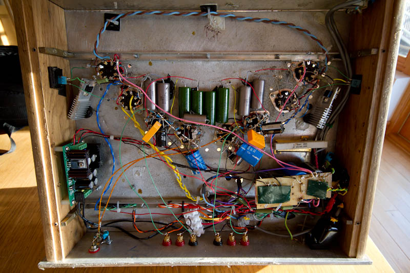

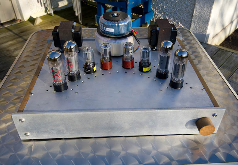

A few pics:
Didn't I say it was like a bag'o'snakes in there?!?!🙂

OK,
I did rewire the heaters and that reduced the bit of hum I had - there is still a little there on one channel only, and I can't chase it down. I can only hear it when I'm within a foot or 2 of the speaker. Amp sounds wonderful - very happy indeed with it.
Well worth making....
Fran
The 6SN7 heaters are floated pretty much exactly as per the schematic, except I used a spare twisted pear DC supply for the 6SN7s and AC with a humbucker for the EL34s. The rewiring I did though was to lay a separate run of heater wiring to each EL34 heater. I read it was recommended somewhere (lost the reference). Apparently daisy chaing one heater on to the next is not a great idea and running a separate run to each valve reduces the scope for hum. I had noticed that the buzz/hum I was hearing got a little worse as the amp heated up over an hour or so. It helped in this case at least, maybe it wouldn't make a difference elsewhere.
Its a little strange that the slight buzzy hum I'm left with is in one channel only and at this point I can only think that its down to physical placement of transformers or something. The reality is that while the challenge of making is quieter is attractive, the level is so low as to not be audible and it doesn't bother me. At some point I'll try chasing it down a little more....

Amazed at how good this continues to sound. Big clean sound, acres of power and silent. Very happy with it. I'd find it hard to take a apart to reuse the bits - in fact I must tidy up the chassis, I used toroidals for the b+ and heaters and they need to be covered in.
As an aside, I have tried EL34s, KT66 and KT88 in this amp. All sound good with I think the KT88s beng the most neutral. They are of course under biased ( I didn't want to run more current as the OPT might not take it).
But here's something I found out in my trials. The KT88s have a metal ring that is connected to one of the grids in the tube. In this amp, that means that this exposed metal ring is at full b+ voltage. One to watch out for!!
