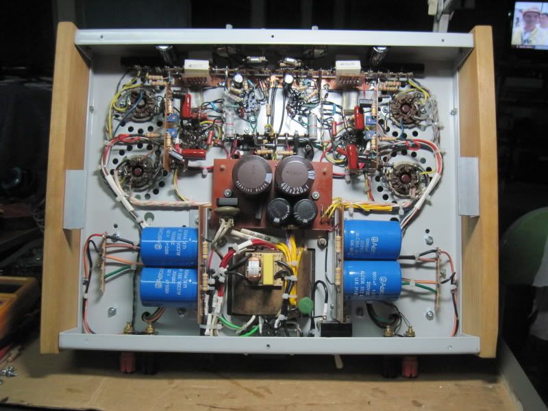

hi,
this is my EL34 pp amp, ultra-linear output, based on the Mullard 5-20 and HK Citation V amps....sounds fantastic, bass is tight and controlled which is a revelation.....
input tubes are Russian 6J9 pentode, Hitachi 6CG7 LTp drivers....
SS rectification, using a common mode choke and generous filtering, fast rectifiers isolate the 2 channels with its own filter caps.....B+ at OPT center lead is 445 volts, tubes are biased at 33mA each.....so that they are idling at about 15 watts each.....

Thats a very nice build Tony. Very neat inside. Mine is like a bag of snakes by comparison!! Its quiet though, so I'm happy enough! Will take a pic tomorrow....

thanks, pin3 leads should be clear of nearby pin2, i suffered a spark over because of the very close proximity of the opt leads to pins, fixed that and everything is fine.......
the Russian 6J9 is likewise a revelation......very quiet and clear sounding.....
i've used Aerovox 1000ufd/250 volt caps is series per channel, 2 x 1100uf/300volt caps in series after the common mode choke, the negative of 0volts is taken from this cap, then 2 x 220uf/400volt caps also in series before the common mode choke...no film type bypass were used in any of these caps....and all of these caps were harvested from discarded computer psu's.......
