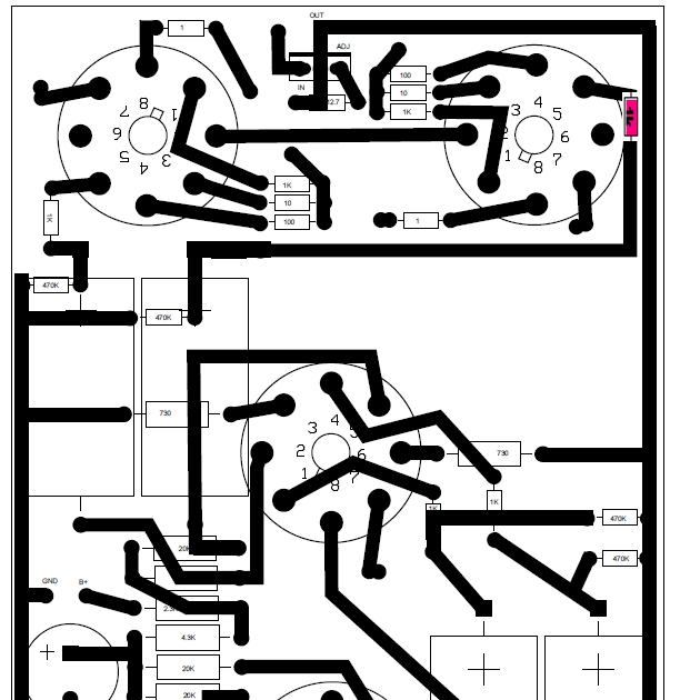

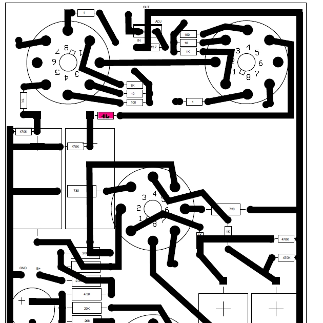

1K resistor
I mean this one.

Here is an up to date layout of the schematic that I etched...
The only thing I did before etching is make the ground traces a little wider with a sharpie.
I still had to bend the octal socket leads around a little to get them to fit nicely for soldering.
Oh, and I did not adjust the grid stopper as advised in the above post yet either....
You may also want to draw a little more "meat" for the B+ inlet - I went from PSU to board 1 then from board 1 ran a wire to board 2...did this for ground also...
I also since moved the initial power resistors from the bottom of the board to the topside - may want to consider 3W or maybe 5W...I used 2W panasonics...
