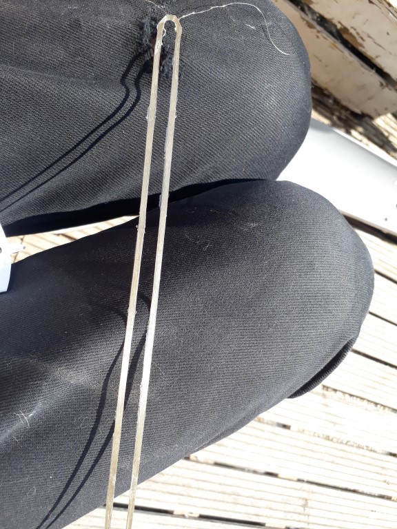

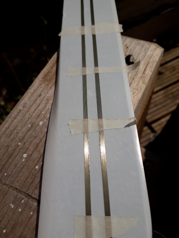

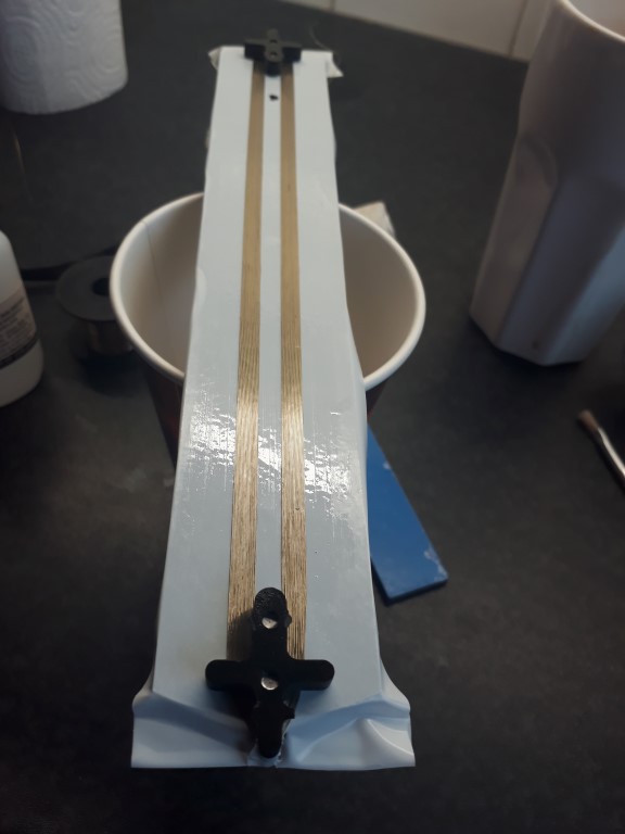

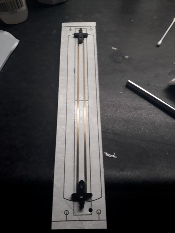

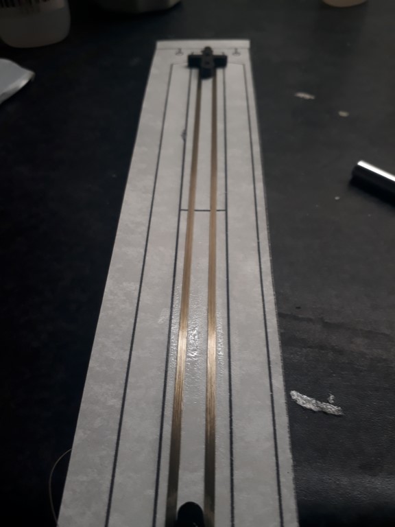

So, some time spend with ruba's again 🙂 i try to leave the 20Khz extension as is, and not hunt it for ever. im just gone focus on the other stuff that i want to do better 🙂
So first thing the coil. i etched and printed and even plotted some coils. but i think wire is the way to go in terms of amount of coil you can stick in there. the more winding the more efficient , maybe even possible to balance high and low end by using dual coils ? so i started wounding again.
First coils and jigs i made ended in the bin 🙂 this is the first one that gives me rather ok results. also i changed some stuff so i could wind and glue the coil to the coil former (nomex) in one go 🙂 although i do need an accelerator for the super glue since the very thin one does not dry quick if you use enough to soak the coil
here some pics

i Am using alumnium wire to keep weight down. first pic is a 12 turn coil the middle picture is a 24 turn or twice 12 dual coil actually 🙂
