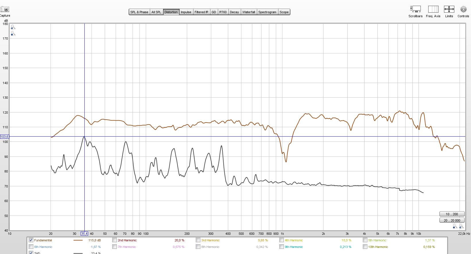

Hi Oleg,
Video shows Xerox never tear 125g/m2,
It is more flexible than 125g/m2 Canson paper.
The paper has similar vibration, Xerox more visible.

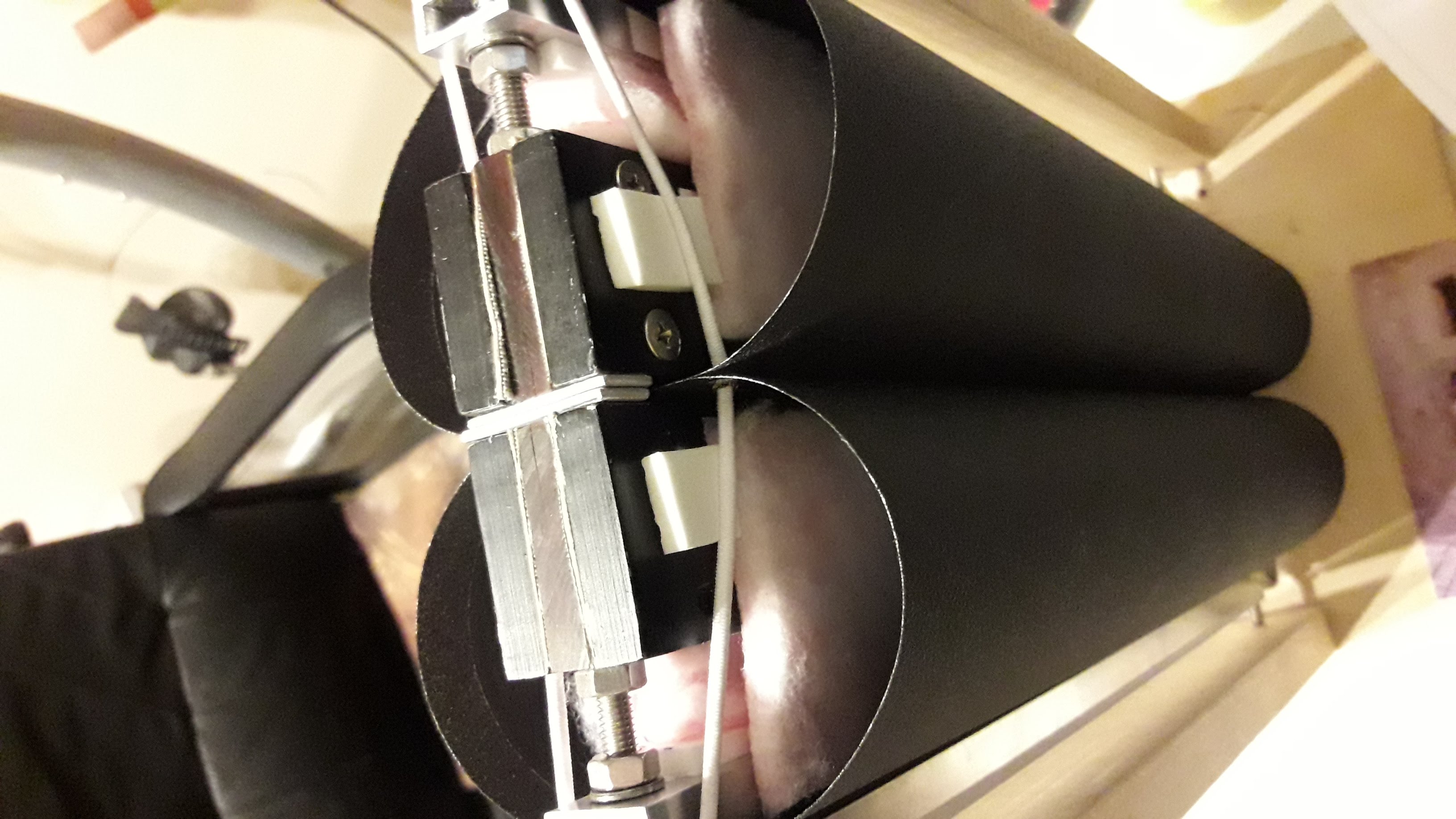

I do not think the long gum is better since it is supported quite close when it is working better. In the patent there is recommendation for lengths.
On picture you can see Canson paper with fiber glass tape and with foam supported gum.
Above 500 Hz is not a big problem in my case.
Little bit more than 1% THD
Under 500 Hz it was horrible, see attached graph.

I step forward with resonance and distortion problem.
Both of my prototype diaphragm (Canson paper and Xerox never tear) had similar behavior.
Resonate one low freq, and there is a big distortion on that frequency and a multiplication of it.
After try several things without real success I read again the patent US4903308 and implement solutions mentioned there.
The Canson paper distortion almost disappear and Xerox (more floppy material) improves a lot.
The phenomena and one solution is clearly written in the patent, and the described solutions works for me.
Wrine implement similar strips earlier.
I tried also with foam tape it was not working, fiber glass works.

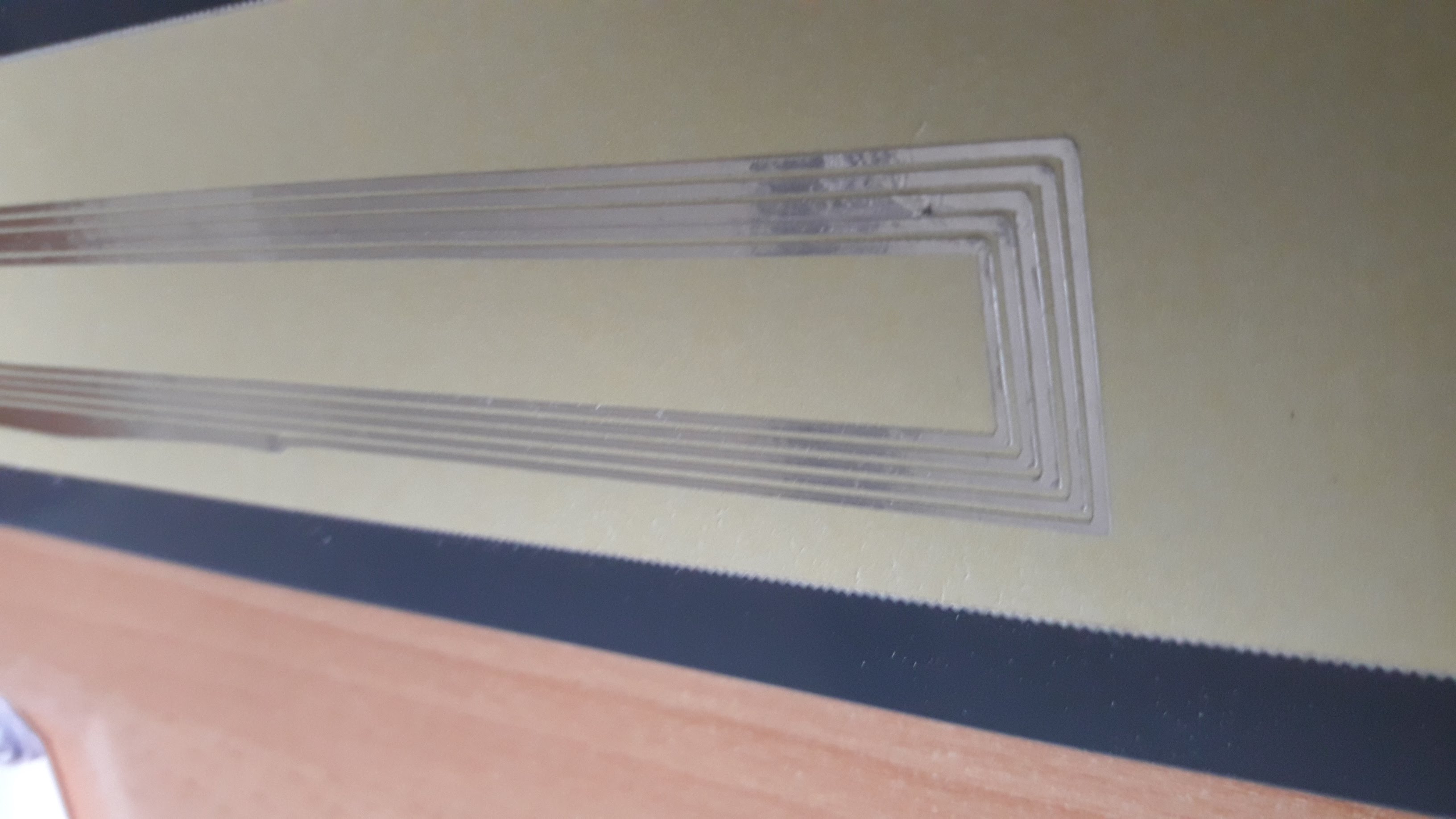

I get first trial of alu tape coils cut with vinyl knife on DIY cnc machine.
Unfortunately it is useless because only a small part is ok, at least something and I hope he can cut it perfectly.

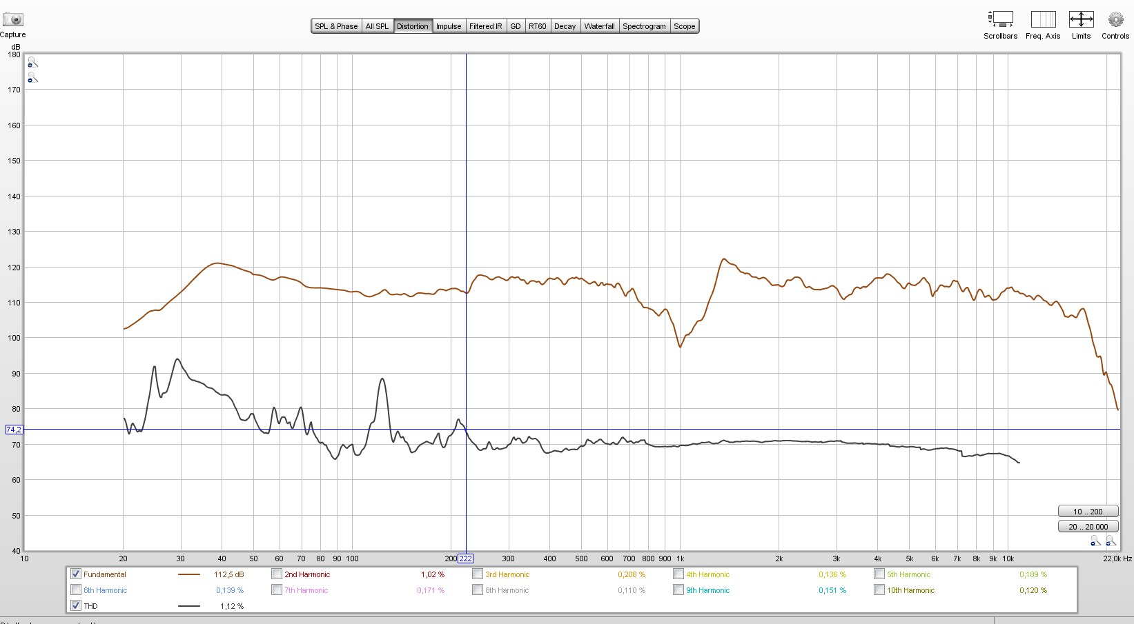

Made 3rd diaphragm and assembly today:
Canson 125g/m2 with 0.17 diameter copper wire coil.
I put 4 fiber glass tape stripes on each wing.
It is the 1st rubanoid where I can enjoy the sound what is coming out!
I will put more tape later try to dump the resonance at 120 Hz.
It goes up to 17 kHz. Distortion is not that bad this time.(see close field measurement)
I upload 2 videos, playing with my DIY closed box sub crossed at 80 Hz.
Without equalization.
I start to trust, it is not waste of time to play with it.
Video1
Video2

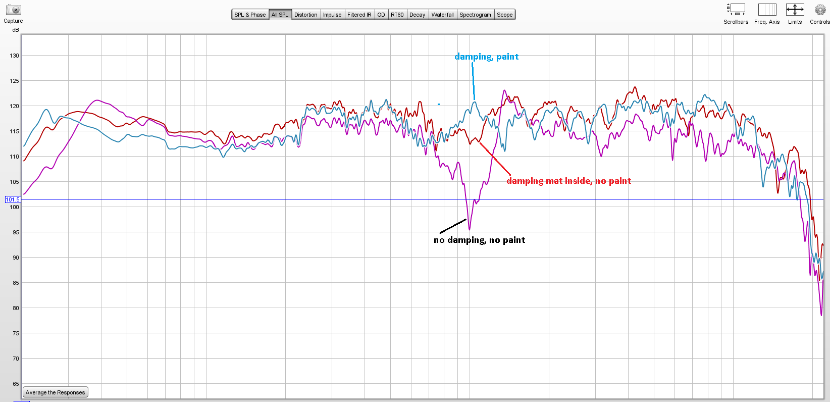

I play further with ruba.
1. Place damping inside (air filter cloth what I have home)
It has big effect around 1kHz (see close field measurements)

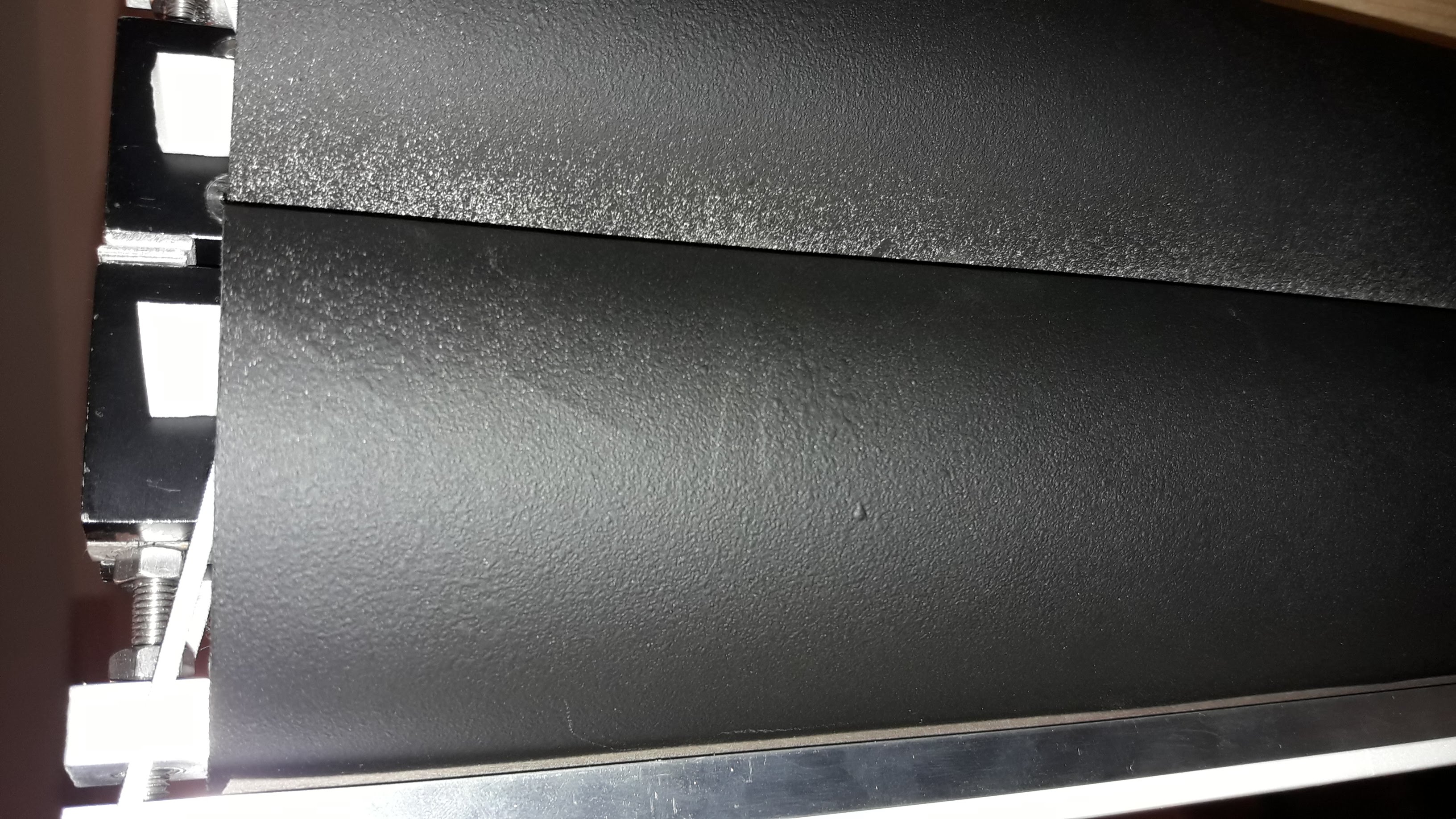

2.Try to paint the membrane, I was looking for "flexible" paint. I found in local shop Body 950 stone chipping protection for cars http://hbbody.com.gr/products/filesUploads/710_950 ANTICHIP_710_tds.pdf
The application of this material is far from perfect (ugly), because the diaphragm was already assembled and because I'm unexperienced in spray painting.
I was surprised how heavy it is, I almost double the diaphragm weight. (86 g)
I was expecting it kills the highs totally, but surprisingly the effect is not that much for highs.
It sounds less "paper", less shouting, subjectively.
Unfortunately I have no an-echoic chamber for measurement, and since it has dipole radiation the measurement strongly effected with room reflections. (I plan to make "an-echoic" measurements outside in my garden when the weather became better.)
I play with measurement in different positions, and seems as I have less resonation/distortion at lower freqs, I measures closer to theoretical "open baffle" freq response.
I was looking again to Mr. Linkwitz's site.
He was developing many dipole speaker systems.
Unfortunately I not heard any of the system, but there are too many review which tells his systems has extraordinary life-like sound.
Electro-acoustic models
What is the right baffle size, design for ruba?
Equalization to get proper low mid response?
Reactions: xsuper9988
Well hello Borzi, i'm glad that another person is on our tracks... and i'm glad that another person came to my conclusion as well. Now if you want to experiment more with laq, apply paper tape vertically on the midle of the cils, +max 2cm further from the axe of each cil (cilinder) to the inactive edge and try to spray laq as thin as you can. Then take the paper tape down, let it completely dry for 10-12 hours than listen and post your impressions again... Thats the spot that should be treated this way. My ideea with the laq is to improve the perceived hight freq responce so you should never have to use a tweeter and to savour those airy hights coming from that huge membrane even more. You should try the cuts, oh boy what a joy. 🙂
The cuts not only 'improve' the hights but also tames the shouts.
The ideea behind the cuts, as i see it, is that they lower the central portion overall mass, but they act as an open door for the sound comming from the core of the paper itself letting it to come out..
You cannot escape that huge dip that you have there (that is the spot wich shows that this transducer has a behaviour similar to a clasic fullrange speaker with wizer... You know what i mean!) you can only tame it abit to a degree, but be carefull because everything must be a compromise in this speaker.. If you use too thick elasticks, and tension the, too much, you will gain better centering and lower resonances, and will improve its lets call it "STOP effect" (in simphonic music in those passages where all the instruments stops at the same time instantaneusly, the speaker will be really fast at this chapter) but you attain fewer microdetails and restrained voices, and using too thin elastics and not well tensionned correctly the membrane will be woobeling around.. All these tiny aspects has to be fine tuned just right because, you can go into the wrong ballpark..
Also ataining bellow 1% distorsion figures, IF someone can achieve this thing in fullrange may lead to an ordinary speaker like sound... I have searched bellow 1% from 150hz to 24khz with all the tricks that i know applied, and didnt like the classic sound. The dispersion remained, but the rest not....
I'm really curious to measure my speakers this week. These where finelly tunned to what i liked and not dist figures.
Ps: just a hint for the usage of laq, is that you should apply it before making the coil itself, and the cuts, and after this do the coil, then bond, then cuts, then cil interior treatment, then the back of the coil treatment and so on. And the laq should be applyied with a animal thin hair brush, but very thin so that the membrane will not be penetrated by the laq. Its much uniform applied this way, much easier and effective. Congrats for the builds, i love them both, Olegs, and yours.

Between the foil (wich achieved the lowest dist from my point of view) and paper, i will choose paper at any hour to keep this speaker's distinct mid sound signature, airy hights, and disperion.. and Olegs and Wrines cottone paper is very appealing to me. Will be interesting to see silk or washy..
I liked rubas foil membrane only when i heard it playing as a tweeter. It is a nice improvement instead of a small ribbon with the impedance adapter trafo..
