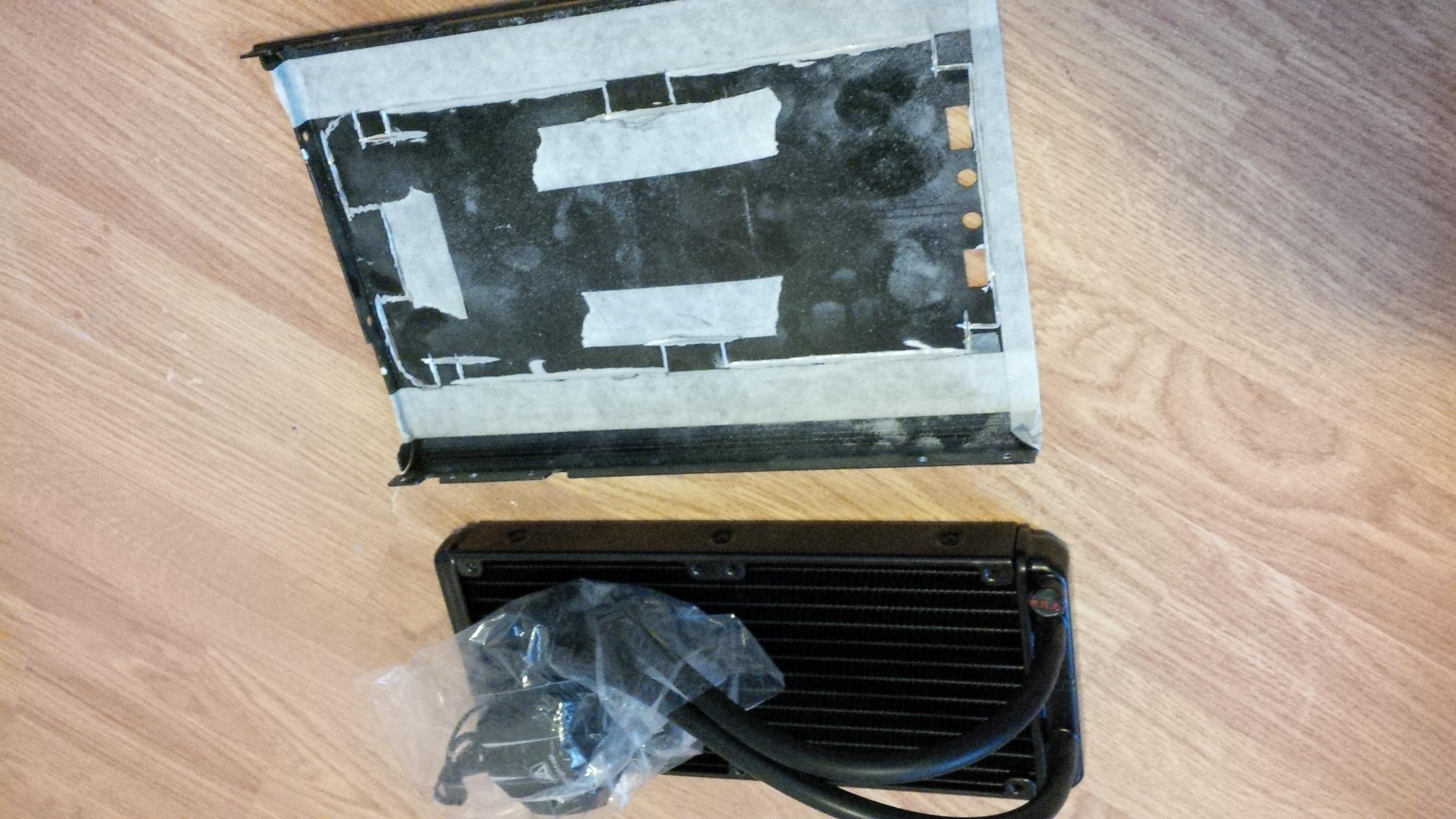

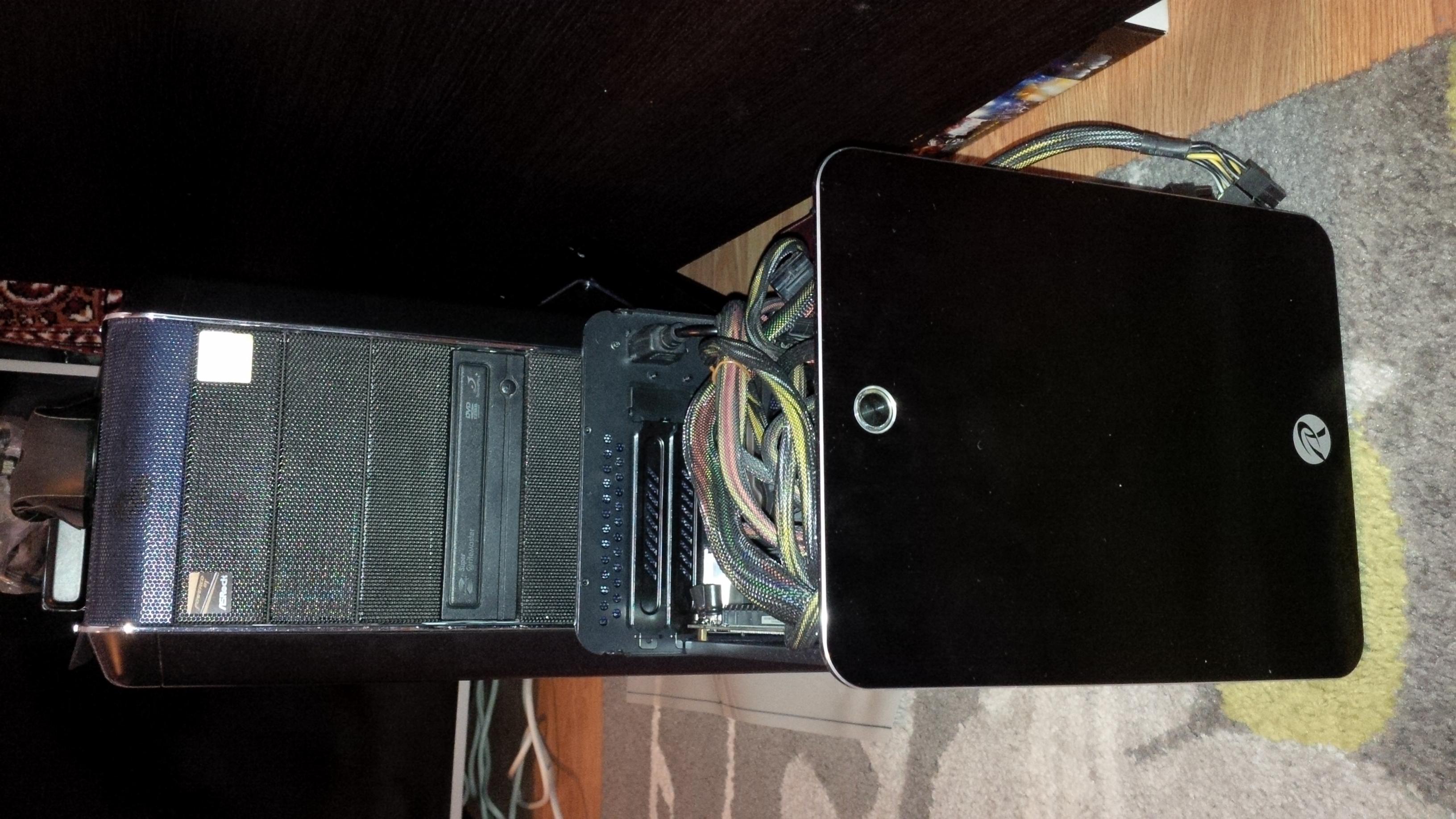

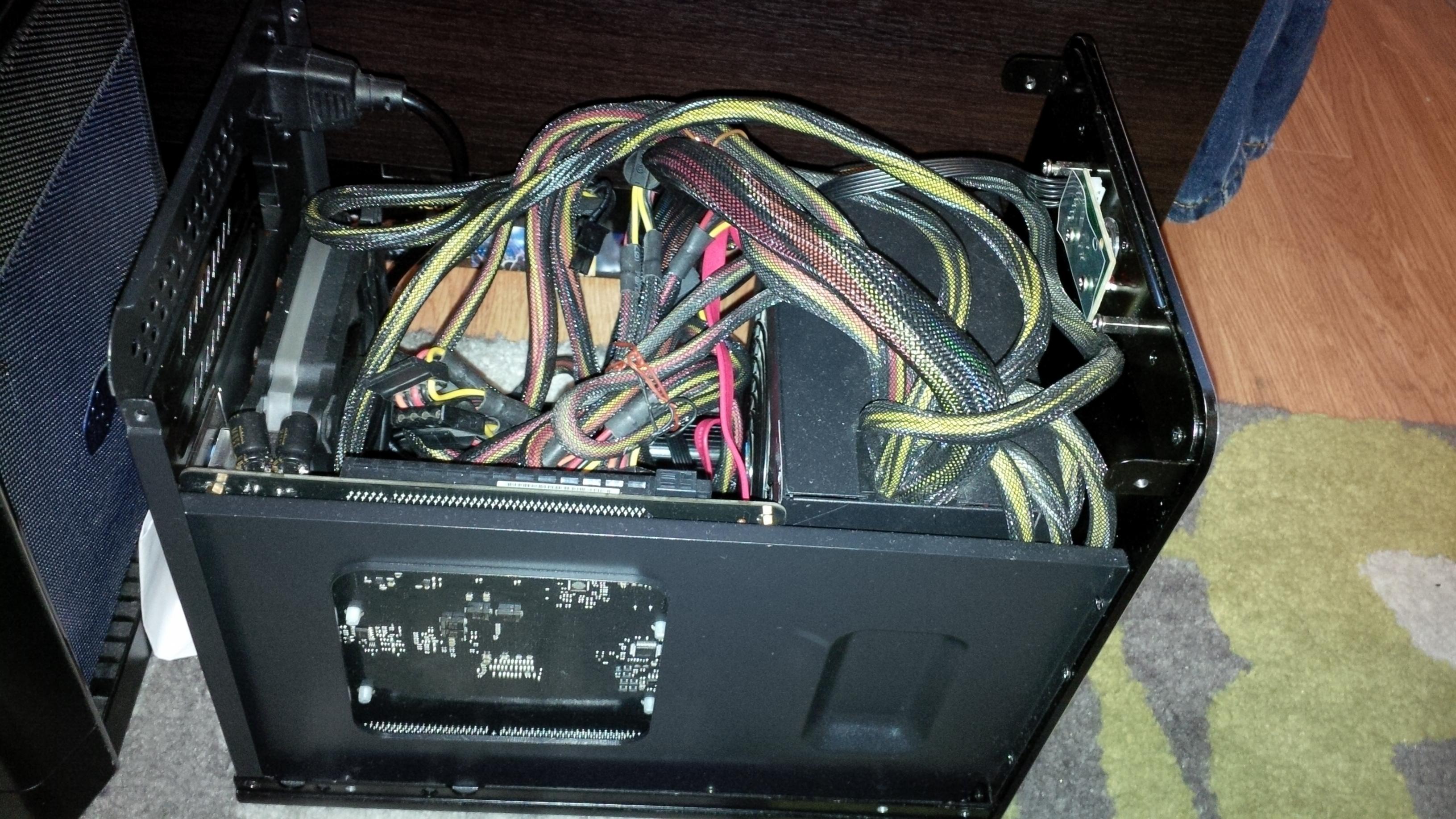

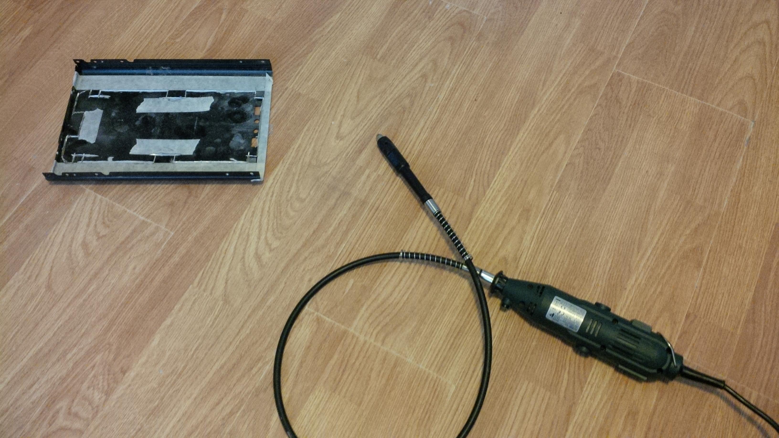

Big problems in small cases... I'm struggling to fit things inside this small brat. (rainjitter metis case)
