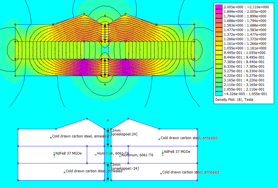

Post a drawing of the magnetsystem and I simulate it with FEMM.

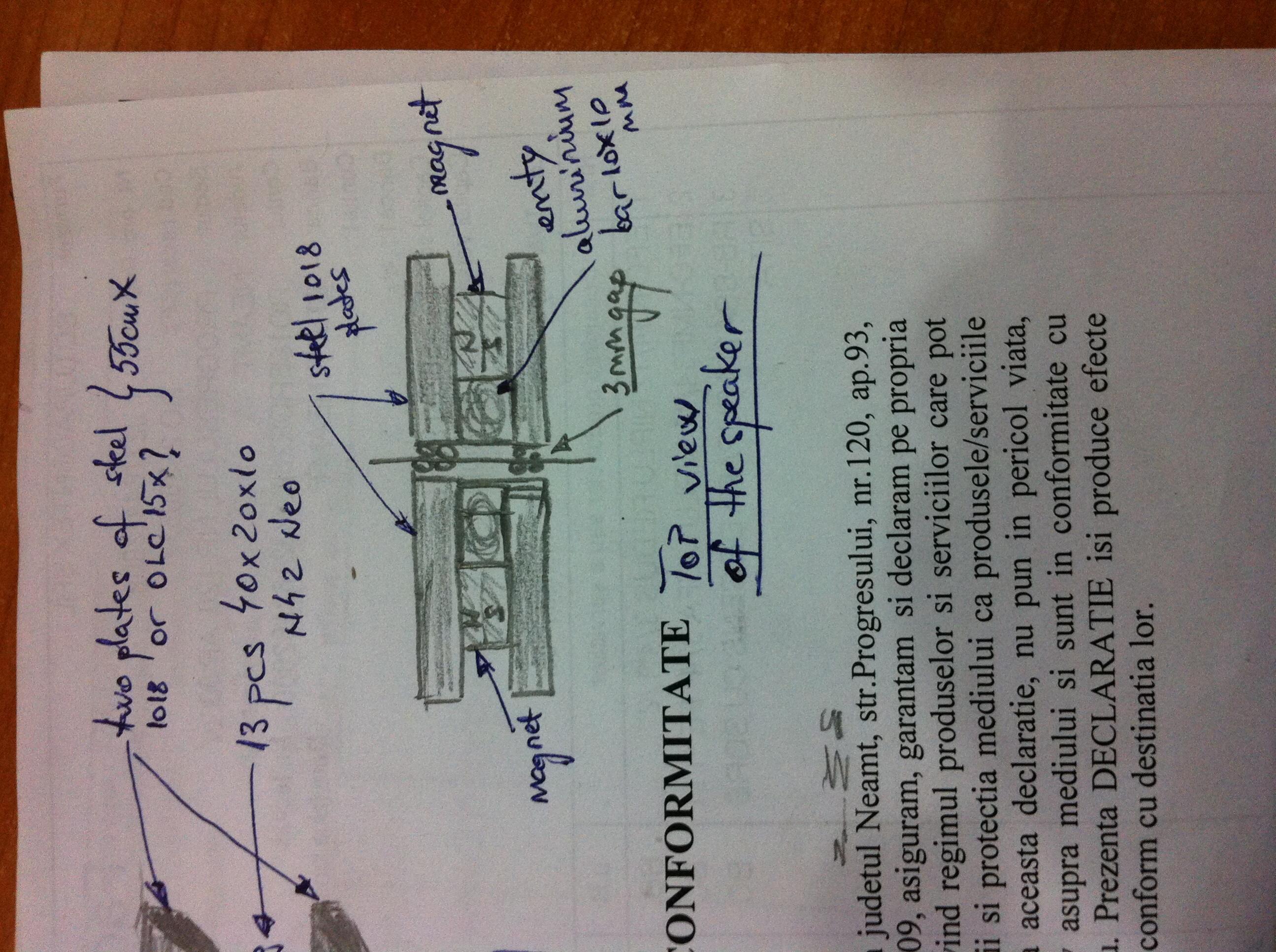

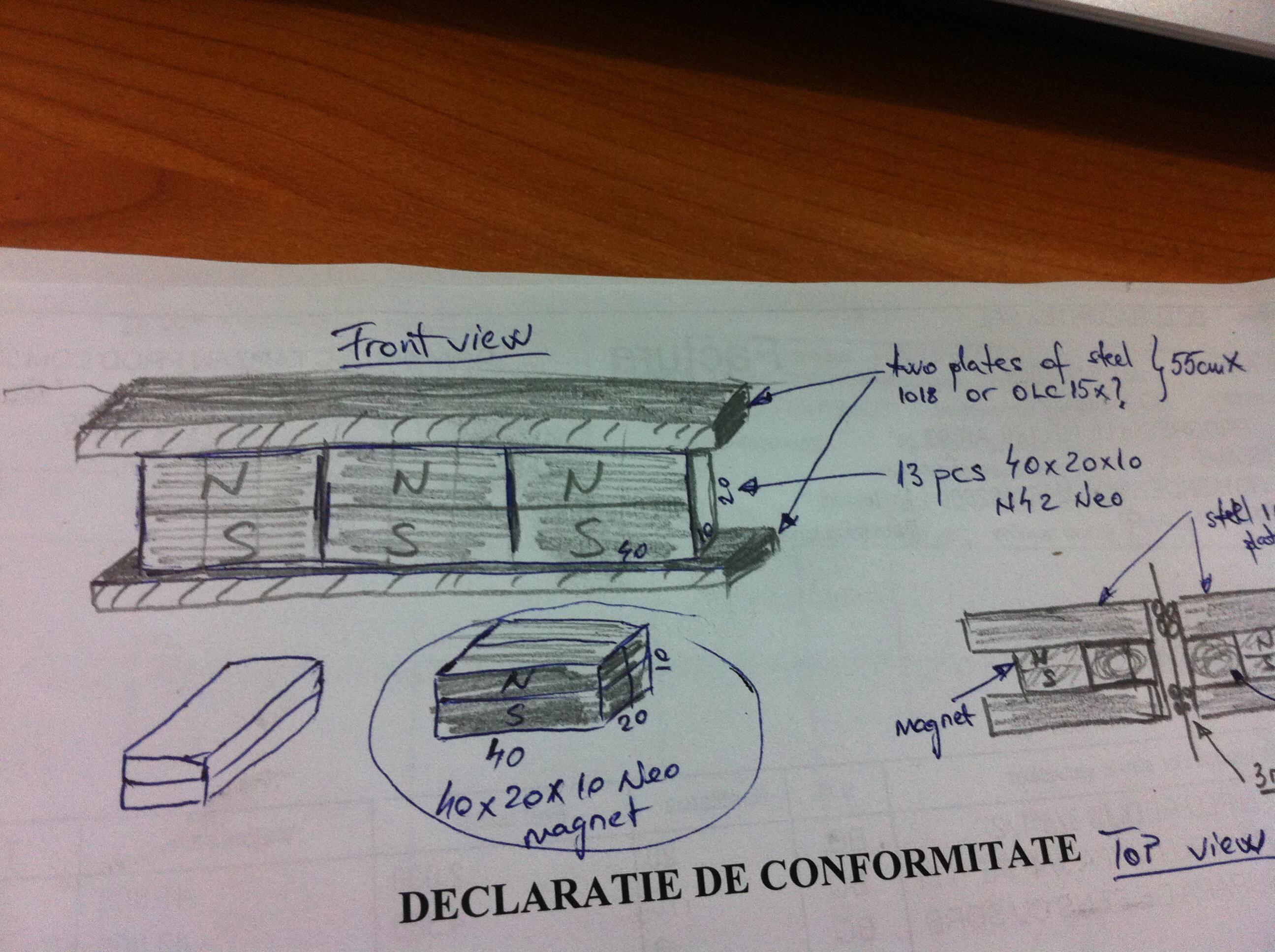

Hi Bernt,
I really appreciate you help.
Here you have a first picture.
Here is the assembly in a top view. I want to try a 3 mm gap. I am also curious wich steel is best ( and findable in Romania) for this aplication. In Romania i can only source carbon stell with "OLC" name, not AISI Steel 1018 like in America or A37 steel like in France.
I'll upload one by one because of the old phone from i'm typing right now.

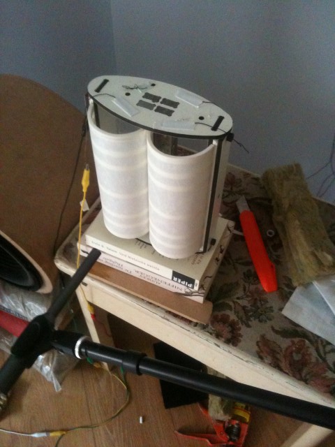

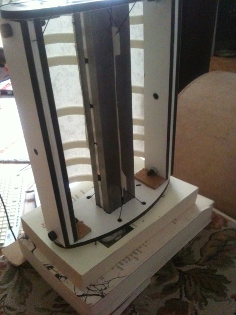

You can sometimes cleary hear them ,and the measurement software not even giving a huge hump, sometimes you dont hear them but when you measure theres huge distortion. think it has to do with 2e harmonics or 3th.
when i hear one i corrected it clearly, and when i see one in the measurement i then play a sinewave at this frequency with a scope(or rew) you can then see the ditortion on screen, just fidl around untill it drops.
as it is now you can live with the resonances since they are hardly there(anymore). it does depend on loudness. if i really put it super loud i bet distortion goes way way up. but ofc my setup does not have 105db efficiency so i really give them hell when i want to play loud.
its by far a flat frequency response, but getting closer and closer.
Pictures are from the nomex membrame, i already removed it since i somhow did not like it. i did ask the seller if he got any 2 and 3 mill nomex instead of the 5mill. and he had :) the 2 mill is like 45 grams m2, and should still be pretty durable.

Hi Sergiu.
Forgive me of any ignorance, but this configuration seems more like the one you might want to have for an AMT?
h4kxSIm_-d98O051idOm50ENA96QcnoaZ5j8kqKh8XQ=w763-h353-no
Again, I have probably misinterpreted your drawing, but with this configuration you´ll get no flux density where you intended to.
ef989AorsIDjeElo6uRv56qTvGfUzTEvIUHFnbC6l4g=w839-h309-no
6b7h6A2ZiXQ-Y_-qWzr4BnpKM5SgiViMxkwolRHNwtM=w1217-h715-no
NQwDJSNMt97HrTteN46HtuTNc2F8xwjX9KaQUGZIkvI=w1161-h679-no
If I'm wrong, I'd be happy to stand corrected!
Correct me if I'm wrong!
Although the aluminum prob act as a magnet short ring is demolishes you flus density. You gain only 0,2 -0,3 tesla compared. To my setup. Wich uses magnet 3 times less strong. I use 20x 10 mm steel using 40 is only usefull when you use magnets that are 40x40x10 or something , in my opinion drop the aluminum get thicker metal if needed to not go over 1,6 tesla. Since you gain hardly anything compared to my way cheaper magnets. ?
Try model steel that has the same width as the magnet and you will see. Making the gap hight smaller also gains way les flux then making the gap smaller. Benefit is you can get higher excursion as well.

Hi Solhaga,
What is the maximum flux in the iron?
I get the idea that it is far above 1,6 T.
Henjo
2,0 T for pure iron.
