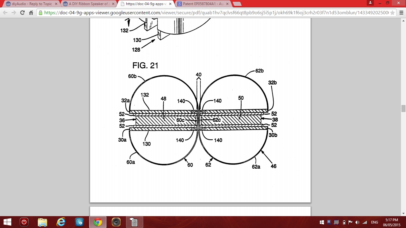

Hello Wrine,
I have readed the posts and your results with interest. Please take my advice into account. Please experiment the cuts on the membrane. The effect will be an extension in high frecvencies exactly as you wished.
Look:
" As further shown in FIG. 6, the diaphragm 46 is provided with a vertical row of hinge perforations 72 on each side of the coil 70. The perforations are preferably aligned with the folded tangs 66 and are positioned within about h inch of the coil 70 and hence within about h inch of the joined expanse portion. The tangs are integral extensions of the web formed by folding pre-slitted tab- like portions of the web. Positioning the perforations 72 close to the coil 70 effectively reduces the mass of the rigid center portion 64 of the diaphragm 46. The perforations 72 may be circular as shown or, alternatively, may be any other shape including oblong, square or elliptical and may alternatively be sheared line segments with no diaphragm material removed. FIG. 6 further shows the center portion 64 defining mass reduction holes 74, the advantages of which are discussed below with reference to FIG. 7. Each row of perforations acts like a hinge to permit a less constrained, more responsive movement of the central diaphragm expanse portion 64. The size of the perforations is not critical, only the proportion of material removed affects the key property of hinge-like flexibility at the edges of the center portion 64. Along the hinge center line of each row of hinge perforations 72, the sum of the linear dimensions of the perforations is preferably between about 10% and 50% of the full linear dimension of the web 60 along the same vertical line. With current materials used, the perforations define a pair of hinge lines at which the web material is preferably about 80% connected and 20% perforated. Thus, it is apparent that the web shown in FIG. 6 is less than 20% perforated and thus less than optimum.
The added hinge-like flexibility provided by the perforations 72, permits the efficiency of the transducer at very high frequencies to be substantially increased as the rigid central portion 64 of the diaphragm 46 is able to move more independently of the mass of the web curved portions 60a, 60b, 62a, 62b. In addition, the reduced mass resulting from the removal of the diaphragm material is the close vicinity of the central portion may also contribute to this effect. Experimental analysis has shown a 3 to 6 db increase in output over the 12 to 24 kHz high frequency range, with no sacrifice in efficiency at the low end of the transducer's output. Previous attempts to provide an improved high frequency efficiency, such as using a lighter and more flexible diaphragm material, have resulted in an undesirable drop off in low frequency performance. "
"The diaphragm 46 is preferably constructed of an aramid fiber paper sheet such as Nomex®, produced by duPont, but other flexible, lightweight, high-strength, environmentally stable materials may be used. The central portion 64 of the diaphragm 46 is suspended centrally within the magnet gap 40 by the flexible curved portions 60a, 60b, 62a, 62b. The end of each flexible curved portion is attached adhesively to a respective end portion 30a, 30b, 32a, 32b of each chassis plate 30, 32 so that each flexible portion forms a semi-circular shape, giving the diaphragm the general shape of a figure-eight when viewed from above or below. The curved portions of each web define curved surfaces which extend through respective central apertures 34 to meet at the expanse. The curved portions 60a, 60b, 62a, 62b primarily act as flexible suspension members and not as sound radiating surfaces. This is particularly true at high frequencies, at which only the portions of the diaphragm 46 closest to the center portion 64 are actively radiating sound. Thus, alternate suspension devices may be used without impairing the function of the invention, particularly at high frequencies. FIG. 5 shows the central portion 64 of the diaphragm 46 that resides within the magnetic gap 40. As will be discussed below with reference to FIG. 6, a set of tab portions or tangs 66 are partially cut from the diaphragm 46 and folded perpendicular to the central portion 64 of the diaphragm so that they extend in planes substantially coincident with the exterior surfaces of the pole plates 52, to which the free ends of the tangs 66 are adhesively attached. The central apertures 34 are large enough to expose a sufficiently large area of the exterior surfaces of the pole plates 52 to permit the tangs to be attached thereto. As a result, the central portion 64 is maintained in the central location between the magnets while being free to move laterally within its own plane by a sufficient amount to produce high audio frequencies" (see the attachement from bellow, FIG 21).
Cheers
Sergiu
thanks for allthe information, ive read this patent a week back, but its allot to swallow!
ive done some cuts, like this(around the coil and removed the mid portion) but result was minimal. i would love to do some new tests but not before i got another way of making the coil. since it was a pain in the ***** to make one and i am not content with them. ill be back on monday, and i think i will have something in the mail by then and can start trying to make new coils. only then i can play with the membrame. since when i make a membrame now and cut it up its toast and cant reuse the coil. if i got a flat coil, i could recycle them, and if not, it is at least faster and more consistend way of making a new one.
also i dont want to break any patent of them , i pretty sure i can figure it out without exactly copy them.
I will look into it when i got a good coil setup ! and move on from there. i can even imagine using thinner nomex in the first part of the cylinder then thicker stuff to do the spring. ill order some thinner nomex , since the only stuff i got here in large quantity is 0.25mm thick, i was thinking more in the line of 125 or less. and see what happens. its really stable stuff. as i showed in one of my video;'s trying to kcut it with a drag knife is hard not at all like paper. also you cant rip it at all! just no way of tearing this stuff 🙂

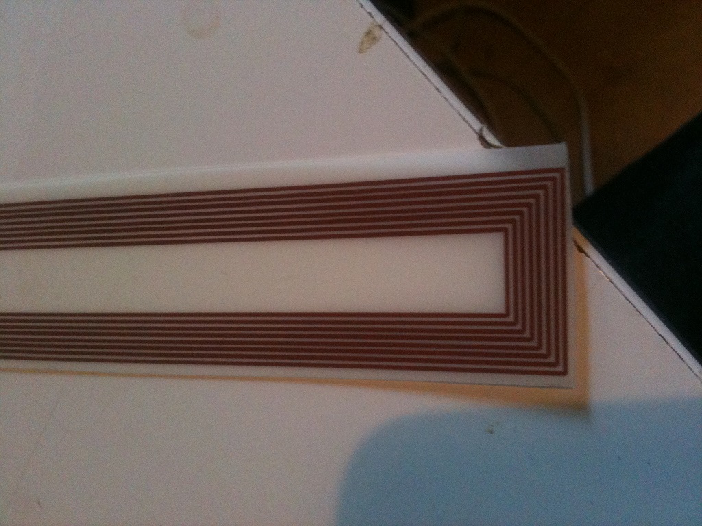

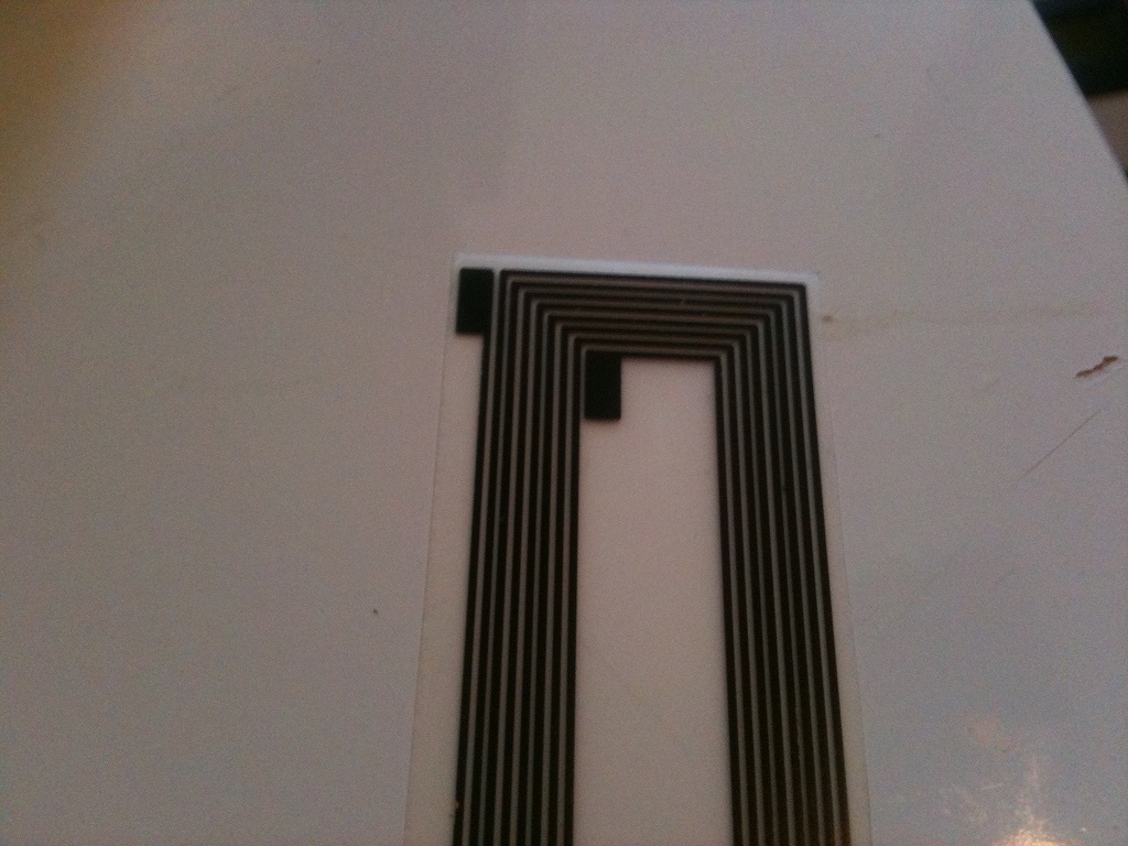

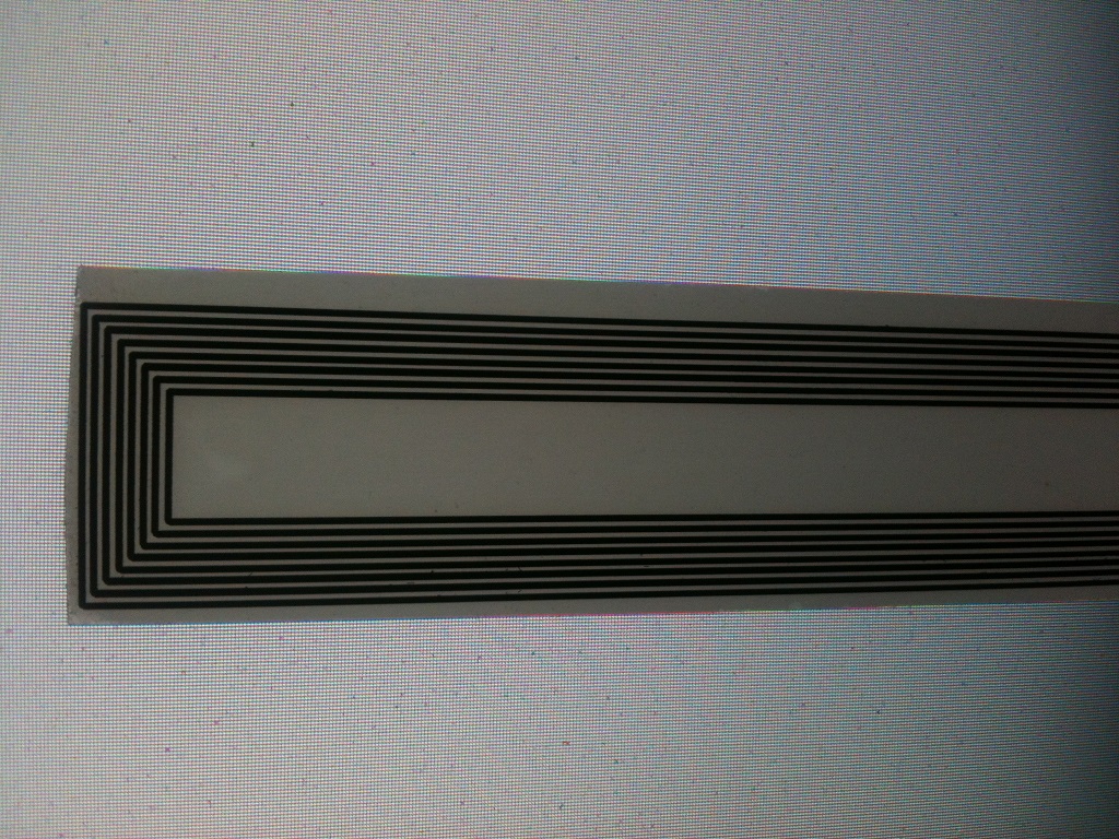

Hi Wrine. How's the progress? Have you done the new coils that you where speaking about?
yeah i got it 🙂 well tomorrow some work to do if i finish my normal work first, and got some time left 🙂
Well a fast test. there is room for smaller spacings. i worked pretty well. although i could not stick a piece of this stuff to a a4 paper and print it. it would always end up half way, with a paper error..... but if i cut a piece and put it in without any paper it does work. i did not remove the ink yet, but you can clearly see its pretty nice. i measured the first one that had some adhesive isues since i did not clean the copper propper 🙂 and it measured a bit higher then it should 2.9 Ohm instead of the calculated 2.3 i thought i could use 2 in series. but i think ill draw a new one with smaller spacing and slightly smaller traces. to get to 4 ohm.
i even glued it to a piece of 80 grams paper and see what happend. well sensitvity goes up could be because its only a 2.9 ohm load. The high frequencys still falls of but this time not at 13Khz but around 16.5Khz its sounded pretty good. i like the material the copper is on, its sturdy and still not to heavy. so i might take a look at some transperancies for an overhead projector. of around 0.1 mm thick. thats at least 2 times thinner then the Nomex and still can support itself without wrinkling.

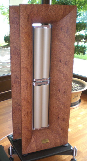

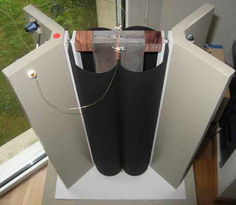

After i studyed again the patents i fugured out another interesting thing:
-the high frecvencies are all comming from the lateralls of the cilinders and from the center of the coil.
If we beam the sound, speacially hights with two V shape materials only on the laterall of the cilinders (like in the first picture from bellow, left syde) we actually beam only the "weaker" high frecvencies but what about the ones that are coming from the interior of the coil, in our case from the interior of the cilinders? I think that we also need V shape lateralls above and bellow the cilinders to beam the "strong" (more powerful) hights from the interior of the cilinders.
After surfing the web for more details about my theory i found that the clever guys from AudioNec allready figured this out. Look at the picture nr 2 from bellow (from the right) and you will see what i mean.
I'm not trying to reinvent the weel here, i want to point some subtle clever solutions that i digged on the web for the "hights problem" that you have Wrine.
