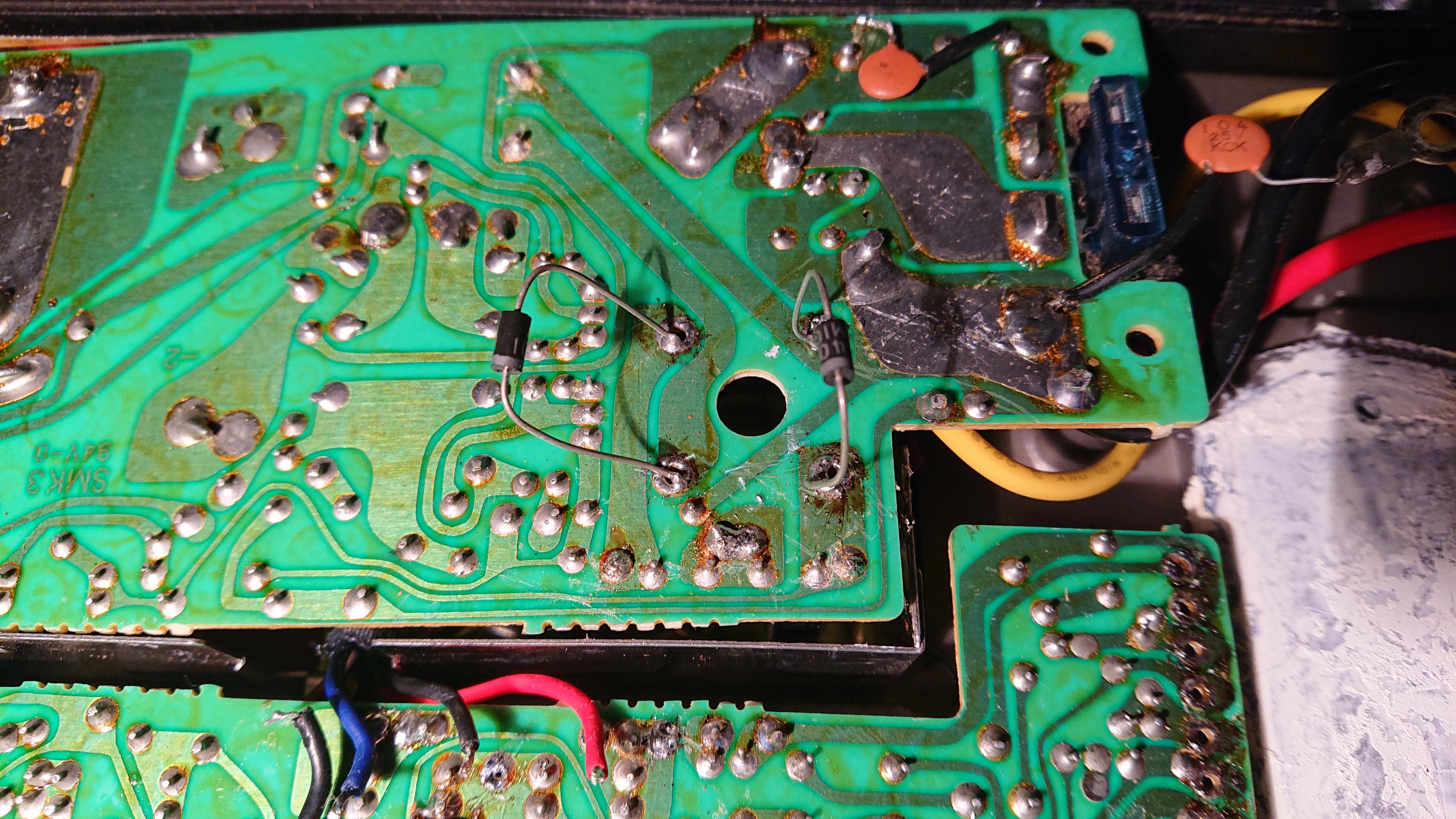

At this point, I simply want you to install a single 1N4001 as previously described.

One end on the AC and the other end (striped end) on the positive. Power up for just a few seconds to see if you get positive voltage on the rail cap.
Sorry for the delay, went camping. Ok performed the test as requested. Neg lead on cap side and pos lead on what we are calling the pos rail side (since the other side seems consistent neg rail voltage). Got +16v for a few seconds, then it dropped out. Removed power from the amp, then tested again. Same results. So I guess that tells us something as we are getting half wave at 16v+.

Connect another diode (leave the positive) from the negative rail cap to the other secondary winding. It will be reversed, compared to the positive (stripe away from the negative cap).

Im an idiot. I put the diode in backwards on the neg side. Redid the test, have full neg rail power on neg side. also, when testing with power removed, still shows almost normal neg rail voltage, but is dropping as I suspect meter is draining a cap. Pos side shows .6v+ and draining with power removed.
Desolder the 3 wires that connect the rail voltage to the PS board. Do you get a positive rail with those disconnected?
Ok, all three wires from PS board to audio board desoldered. Everything still left in previous state. Solid 33v+ on pos side. Less than 1v neg on neg side. both readings were consistent with no oscillation
Are you using the point indicated by the orange arrow for the reference (black meter probe)?

Maybe you forgot to upload a pic? In the bottom right hand corner of my pic, there are three joined traces. Right side is pos rail, next going to the left is where the two caps join and the black wire heads out to the audio board, and left side is is neg rail.
