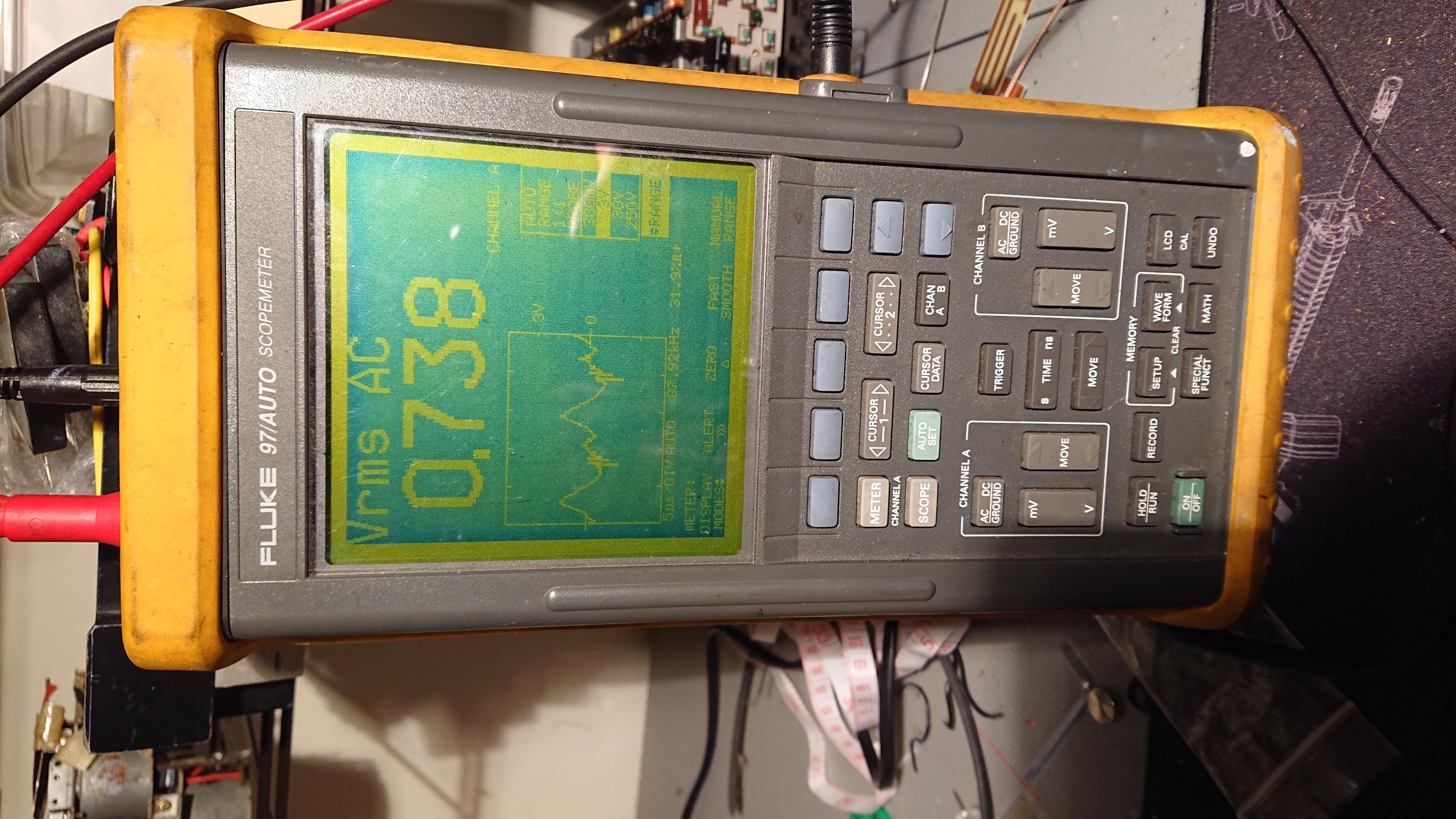

150ish mV AC which makes no sense at all to me. Its also fluctuating and the waveform is very erratic.
How does the waveform compare to the input on the other rectifier. They should have the same input from the transformer if the rectifiers are center-tapped types.
Use the secondary ground or the negative speaker terminals (assuming that the amp isn't bridgeable) for the scope reference.

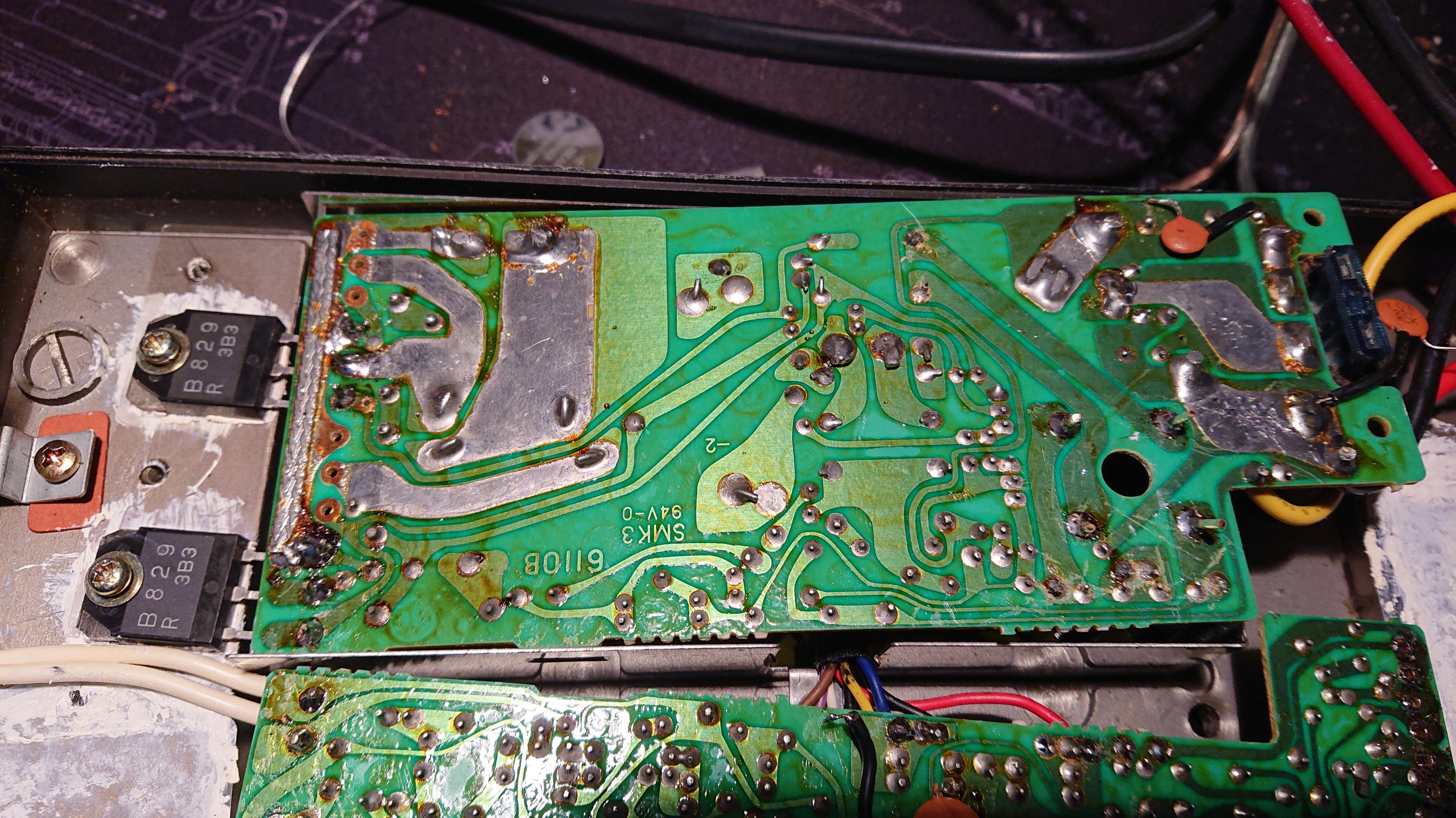

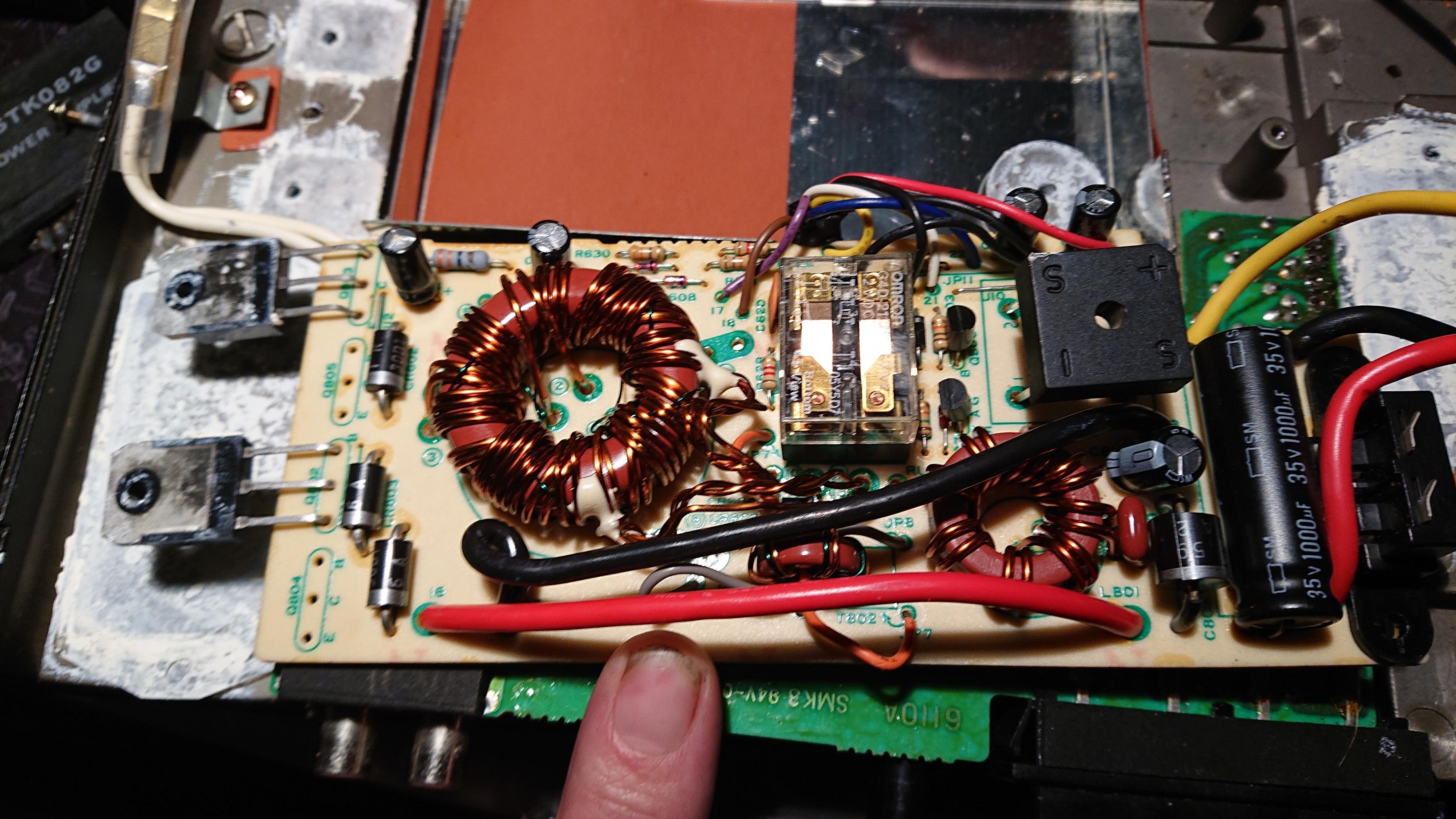

Here are a couple of pics. There is only one bridge rectifier on the amp. I am probably missing something here... Ive been measuring at the output from the bridge rectifier as shown that has two wires going from it to the audio board. here are a couple pics of either side of the power supply board. The blue and red wires are the ones I am presuming are the rail voltage outputs from the rectifier. I am not certain the function of the b829s at this point.
The 2SB829 transistors drive the primary windings of the power transformer.
Bridge rectifiers are rare nowadays. If it has negative rail but no positive rail on the terminals of the rectifier, it likely has failed internally. You can't use a standard bridge rectifier in the amp. You need a high speed rectifier. Standard bridge rectifiers will quickly overheat and fail at the higher frequencies and square wave of a switching power supply.
Sorry pics were being difficult to add. They should be up now. Ive tested the rectifier outside of the circuit and it tests fine.

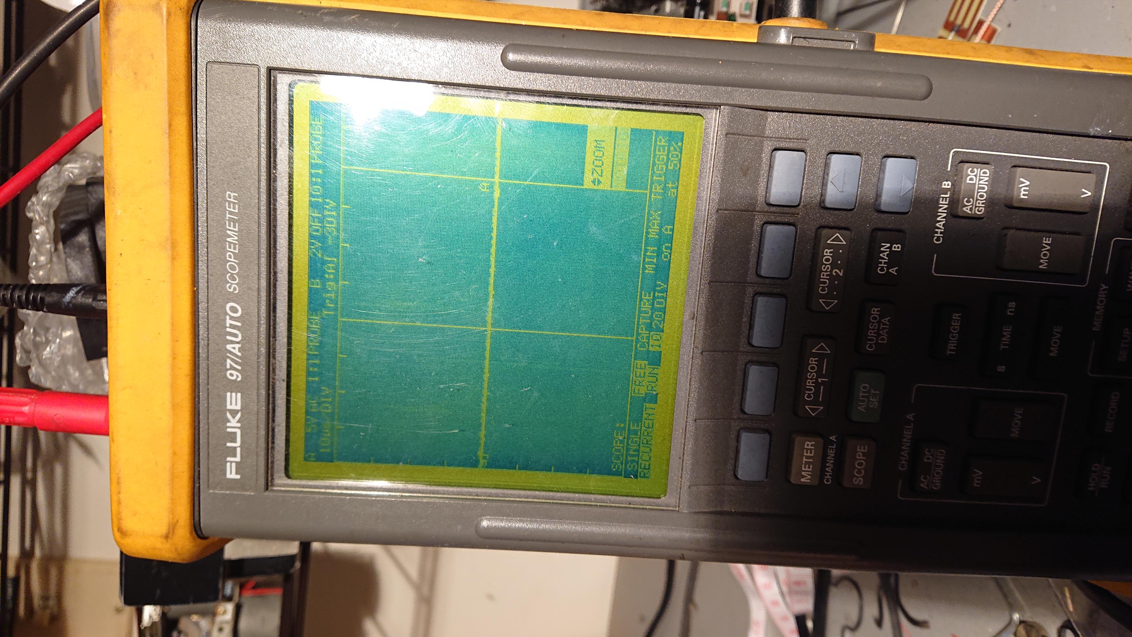

Set the scope to 10us and 5v/div and post the waveforms on the collectors of the 2 PS transistors.

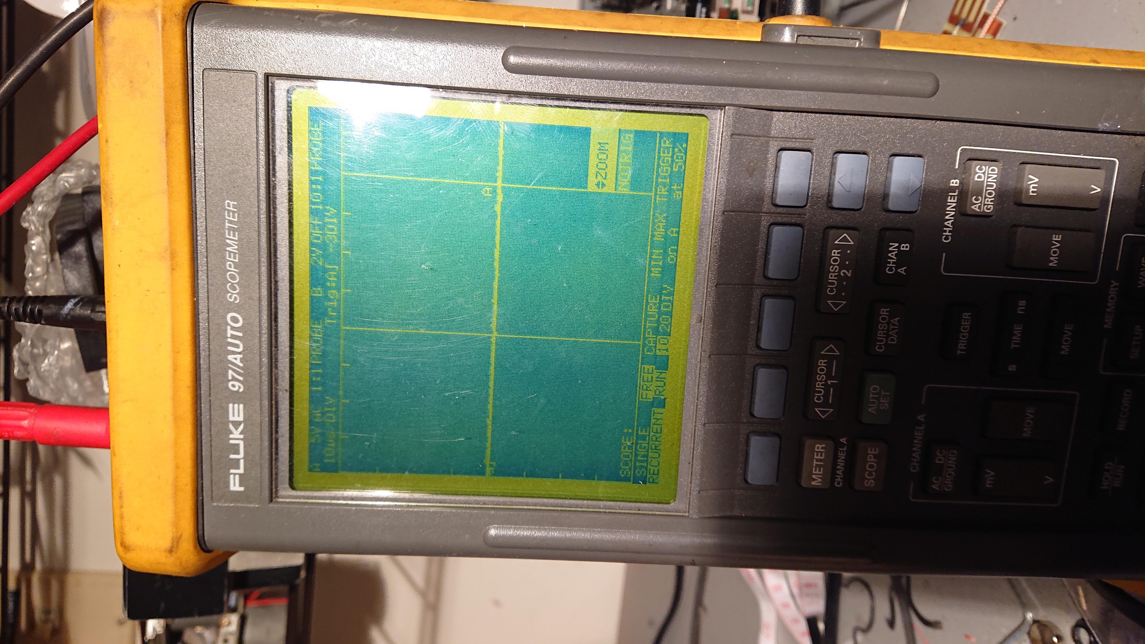

so there is this odd spike that happens every second or so. Both transistor collectors report this. Pics are from only one transistor. I think scope resolution might be a little low at those settings to see anything, unless that tells you something?
The power supply isn't operating. Are you sure that you have negative rail voltage?
The supply may simply be charging the capacitor on the pulses that you see but didn't capture.
Place a meter on the negative rail and see if it remains constant or changes slightly corresponding with the pulses.
Do the same with the positive rail.
