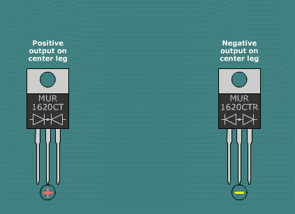

Both appear to be wrong. The pin configuration is likely right but these are for 50/60Hz. You need a high-speed rectifier. I know of none in this configuration. You can make one.

what sort of frequency should I look for when you mention "high speed"? I presume 600V 8A and xxx frequency? or maybe the current is off too if we assume the one that was in there in the first place is incorrect.

To answer your other question, you need a 100v or greater rectifier with a reverse recovery time (Trr) of about 35ns. If the threaded locations near the power supply transistors are unused, I'd recommend the MUR1620CT and the MUR1620CTR. You'll need other bits and pieces as well (to be covered later).

On the plate where the power supply transistors are mounted, there are 2 locations that are not used. Those locations have threaded holes. Do you see what I'm referring to?
The following image shows the rectifiers that you will mount in those locations.
Do you have insulators, shoulder washers, 3mm screws to mount them?
One transformer winding will go to terminal 1 of each rectifier. The other transformer winding will go to terminal 3 of each one.

For now, I simply want you to install one of the 1N4001 rectifiers to see if it will build positive rail voltage.

The ones in the image I do not have. I have the B289s and the 1n4001s. Obviously the package shape of the 1m4001s wont allow for any sort of screwing down for heat dissipation. I can steal the screws with washers and insulators from the other amp as its very much the same construction, just more bits.
I can put the 1n4001 diodes in the configuration of the image though if thats what you mean.
