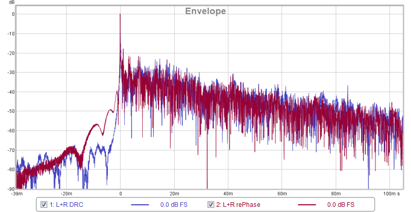

Here's the impulse/STEP in one plot:

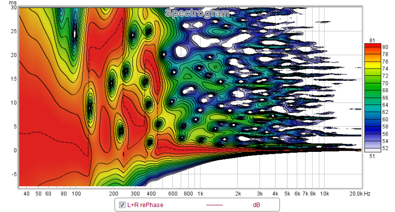

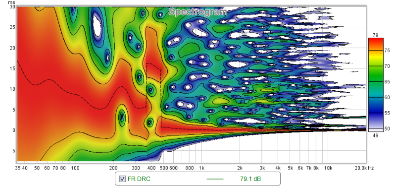

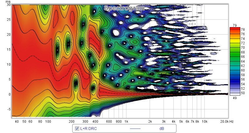

Yes, that was Kindhornman's point to a large extent I think. I hesitated to show how big my room problem is in the 100-600 range, but it is informative to do so. It shows up best on the new REW wavelet chart below, but can also be easily seen on the REW spectrograph as well. No signal EQ can do anything to help the direct sound nulls. The big questions are; is it better to Apply EQ get the SPL of some of the frequencies near the overall level of other frequencies even when it is arriving 20 ms late, or is it better to not EQ and have a large dip in the response at several of those mid frequencies? Possibly the answer is that; it depends on how the EQ is implemented (FIR vs IIR) and how much of the SPL dip is removed. This is my current interest - what EQ scheme to use and how much to apply.
w/DRC
w/Rephase
That is indeed kind of scary looking... but I'd say you are not the only one getting something like this in a real live room.

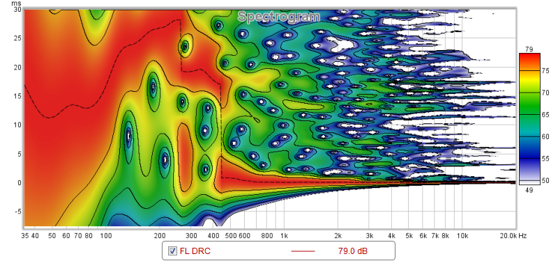

I prefer spectrogram with various sized windows for showing horizontal lines indicative of room reflections.
The above graph would indicate it's not a reflection from a wall but could still be floor or ceiling due to the moving mic while the notch pretty much stays at the same spot. Either that or a room mode. But it would be wise to know what the speaker does by itself. I'd experiment by lifting the speaker up and (temporary) moving it about in a measurement session if you can't/won't take it outside.

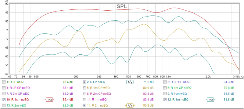

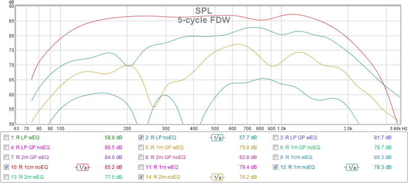

After much effort I had given up on this and just accepted that I couldn't identify the cause. It's been long enough and my memory is poor as to what all I investigated at the time. With your comments I am now motivated to try again. I just now reviewed some old work and also did some new measurements. Maybe with your help I can make some progress.
I confirmed some basics regarding the Right MW:
> The MW response is smooth through the operating range per 1cm mic distance (see attachment)
> This not a Floor/Ceiling bounce. LP Calc = 536/146 Actual = depends if FDW is applied. With a small number the null is very deep at 400 with no FDW there is a double dip at 380 and 486.
> The coffee table in the picture (Post 89) provides no significant impact to the result (not shown), i.e., removed, covered with pillow and blanket, or bare glass.
> Previously I added to the poly fill of the box 2 times to see if that would impact the results - no effect. It is now judge it is at a max density, i.e., probably beyond optimal.
Post 89 also has a photo to give some idea of the speaker/room reflection points.
The legend provides mic distances for the measurements. One chart is with 1/6 smoothing and other add FDW = 5 cycles
Any thought as to what can be done to identify the cause?

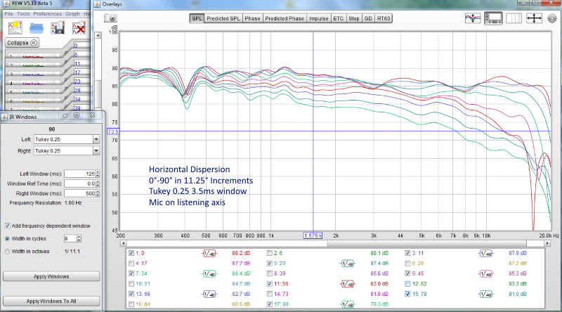

Tis chart was with mic at only 24" just to show the dispersion and that there were not any off angle problems as a result of poor timing of the 2k XO.
I just ignored the dip at 400Hz to be from another source. Possibly my PEQ or possibly floor/ceiling bounce. The geometry is completely different from the listening position situation so it would not share an common reflection problem.
Regarding floor bounce; the mic is at 24" distance and 34" high. The MW 30.5" high so the cancelation freq is 152Hz. The ceiling cancelation is 60Hz. My PEQ does not have an filter in this area so that is not the cause either. This is another puzzle for me. I don't see how the dip at the listening position and this dip could be related to each other, but I also don't understand the cause of either.

Those 2 charts are not the normal spectrograms, they are using REW's new Wavelet spectrogram. It's just out in beta release FDW was not applied. I looked at the right and left separately and while they are different than have similar problems. I usually 90% of my analysis is on separate speakers I only did L+R as the info in the thread did that. Attached is the DRC Left and Right channel Wavelets with 1/6 smoothing and a 30ms window.
Left
Right

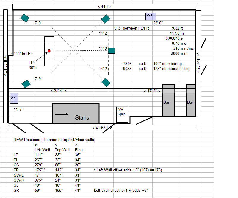

I augmented my sketch in Post 89 to show the speaker locations. The actual height to the Front L and R MW drivers is 30.5" (table shows 34", but that is the midpoint between MW and TW centers).

I noticed a typo on the FR 'X' dimension in Post 117. It should read 275" not 175". Just in case you are planning to do an analysis with the dimensions.
Don't forget things close to the microphone can reflect back to it... a dip at ~400 Hz cannot be that far away, either from the speaker or the mic. I don't think that will be a room mode. I'd still lift the speakers to see what happens, or the microphone to find the other dip that they seem to share. Seeing that the distance to floor is what they have in common... nothing else seems to be equal distance to both speakers.
If that first peak above -20 dB is at 2.5 ms I'd say that's the one bugging you at ~400 Hz. A bit hard to tell on this graph though. I suspect it's something close to the mic, not the speakers. The mic will be quite good at listening from behind. Are the chairs we see in your room picture there when the mic is placed during a measurement?

I wonder if the dip could possibly be related to the speaker stands. I have a very early spike in my listening position measurements that I have been thinking could be related to the stands since they are not yet mass loaded/damped.
