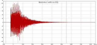

Define a "clean impulse measurement." Do you mean an accurate one (my assumption)?
Here is an impulse of one channel at my listening position before any processing was done. Since I have not (yet) implemented any time correction, I haven't bothered to make a corrected measurement.

I think that a sufficiently "clean" impulse response is one in which the impulse center is the first and loudest peak in the waveform. If this is the case, REW will automatically position the impulse center at t=0. Take a look at my IR (in post #2) before and after correction. I didn't choose the most visible of colors for my graphs, but it should help to make my point if you look closely.
The measurement you posted doesn't look anything like an IR of a speaker. How did you get that result?
Do your best to follow the guide and report back with your progress.
My impulse is from REW doing a swept sine wave at listening position one speaker 20 to 20 k with no EQ., I'm guessing it is a sloppy impulse response. Probably because I am in a large oddly shaped mostly reflective room.
Sent from my pc1162 using Tapatalk
I hope that none of my comments came across as rude; I just want to be sure that any measurements are accurate before going further. It doesn't matter how "clean" or "sloppy" an IR is, just that the measurement is performed correctly and that DRC can interpret it properly.
From what I see in your IR, DRC will need help interpreting the IR because it seems as though there are reflections that are louder than the actual impulse. Notice also that the signal begins before t=0 which means REW did not properly identify the impulse center. If you'd like, you can send me the file and I'll be happy to take a closer look for you.

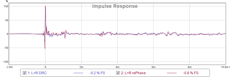

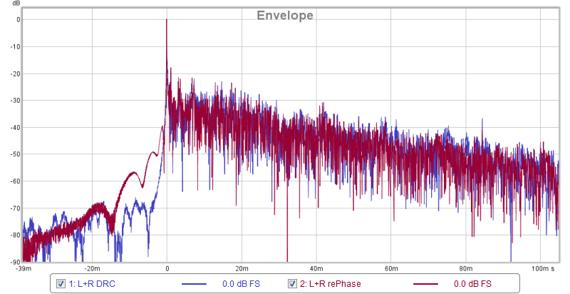

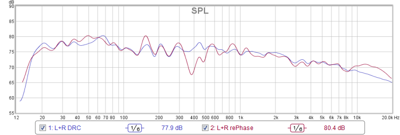

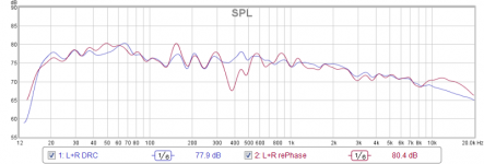

The following is of my current setup using PEQ with Phase correction on top Vs. the current PEQ with DRC on top. That is, my rePhase phase correction filter was replaced with the DRC filter. The objective here was just to get rational result. Now I can work toward finding settings that advance the sound quality. I have several ideas in mind.

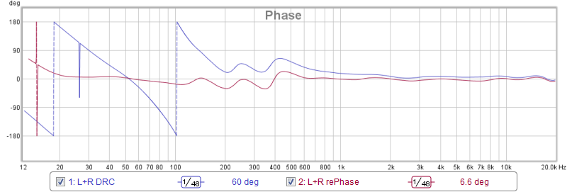

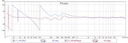

Good to see the comparison. I was expecting something like this. With RePhase you have corrected the phase way down to 20 Hz. DRC will not correct all the way down with a relative short window like in the 4 cycle template.
But DRC does have a slightly better FR response correction. Nice room by the way. What kind of room/speakers are we talking about?

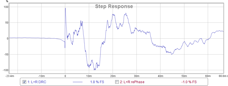

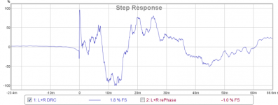

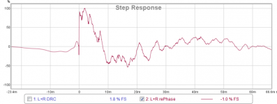

What are your initial thoughts about the perceived differences? Could you show the STEP as well from both RePhase and DRC?
This is a 5-cycle run using both a house curve and mic cal. My room/setup is actually very poor from 100-600Hz with lots of phase difference between L and R channels due to room effects. This causes L and R dips in this range to become much larger when using L+R mono signal. There is little that any EQ can do in this area as room acoustics prevail for the direct sound. These dips can only be reduced with significant boost such that the late arriving SPL (~20ms delay) is great enough that it fills the dip. The debate seems to be; "is it better sounding to allow the large dips or fill them with late arriving SPL?" That is part of my investigations. Currently I am at a partial fill and limit the PEQ boost to 5dB.

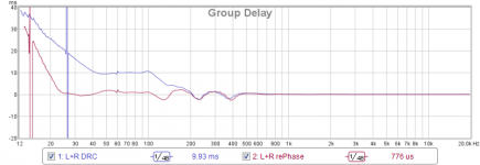

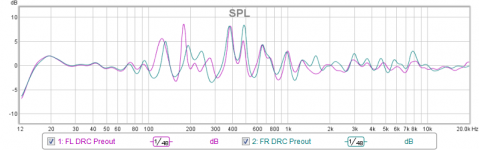

The SR charts are shown below. If you have any idea why the SR and GD of the DRC appears to be discontinuous let me know. The DRC filter appears to have actually delayed/shifted the bass by 10ms between 100>200Hz. Is it your experience with these particular settings? I would have preferred to see the GD rollup more smoothly starting at 200Hz. I think this would have improved the appearance of the SR.

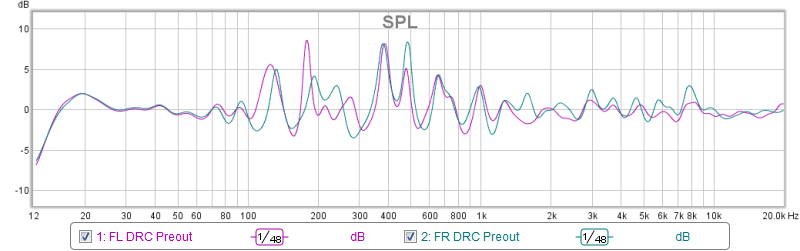

Also attached is the L and R preamp output measurement showing the impact of the DRC filter by itself.
My short comments regarding sound quality follow, but are not too meaningful as my hearing is substandard. Both setups are very good, but they do sound a little different to me. My first impression was that the DRC may have been a little better >1kHz. The reduction of the large dip around 400Hz may also have helped the tonal balance. The problem is that, I saw the measurements prior to the listening so that may have contributed to this impression. In any case these are very subtle differences for me.
Obviously, I need to eliminate (or at least limit my PEQ to overall shaping) and let DRC do the entire EQ. This will be a better comparison regarding music sound quality. I will do that at some point. It will probably not be a normal setup for me however since I also use the setup for 5.1 theater. That is the reason I am motivated to retain at least much of the current PEQ.
Just to be clear, I think DRC is a good freeware option for room EQ. It's likely to make very significant improvement in challanging rooms and add some modest improvement to good rooms.
