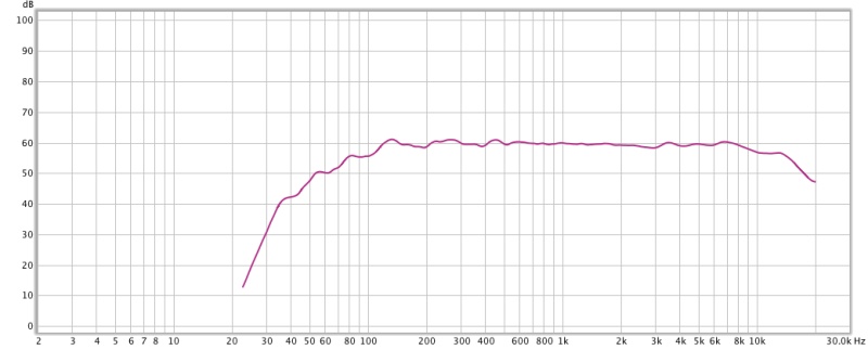

After setting PCOutfile to test.pcm (instead of rtc.pcm) in my template (removing the "#" in front of it) I successfully got output in the samples directory, a test.pcm file was created. I ran only a test script for my left channel to get it.
I could read that in REW. Looks like it had some work done on it though. Not a raw response of the windowed IR.
From Dennis Sbragion: rtc.pcm is the test convolution and should be used only to check the correction results.
Source here
Just tried to extract the rmppf.pcm output to REW and that looks like the windowed IR, without any work done. That's the one I think ra7 was looking for.
Edit: still not sure if this is a pure filtering of the impulse and nothing more. It looks better than I expected it to look.

I tried the REW psychoacoustic smoothing and it is giving me strange results. I see a comb filter response all the way from 20 kHz. Unless there is a strong early reflection, and by early I mean really early, I don't see how the response is correct. ERB and variable smoothing give more reliable results.
