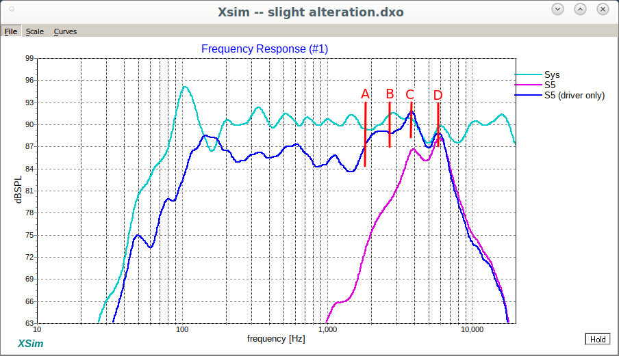

In theory (and this doesn't do much to predict how much of a problem this might or not be), I've marked some points on your 5" plot.Where would you prefer to see the crossover points,
It's preferable to cross not higher than A, but B might be acceptable. C is a compromise but could be done, and D is best reduced way down in level.

Allen , If I understand your assertion correctly, and I believe I do. Allowing the 5" to run out of puff without intervention, as my crossover does. I run the risk of the aforementioned issues..
Now the sticky bit, paradoxically Ill be blunt and come straight to point, . I need a better tweeter. The ones I'm using and where the only ones available and have a nasty dip at around 7k, and my crossover is using the 5" to mask it at the very extremes of its usable band. So there is nothing I can do with the crossover actual to fix that..Hence I need a better or at least more suitable tweeter that I may roll the 5" off sooner. If Im right in my interpretation, I assume you have many curves from many drivers to look at with ease. If you can possibly find the time to suggest a replacement for these cheap chinese ones, preferably available here in AUS. I will go that way..Its easy to swap out the baffle on the tweeter module because its the only one that's square..So physical size is not an issue..within reason off course..

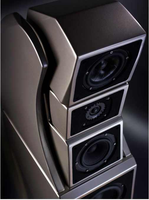

Or, do you break it into bands that have certain resonance damping properties, as I think I recall once reading about Wilson's philosophy, and could be one reason for them wanting separate boxes.
Maybe this could be about reducing the effect of intermodulation distortion in the drivers by breaking up the bands, which I suspect I've also read about Wilsons.

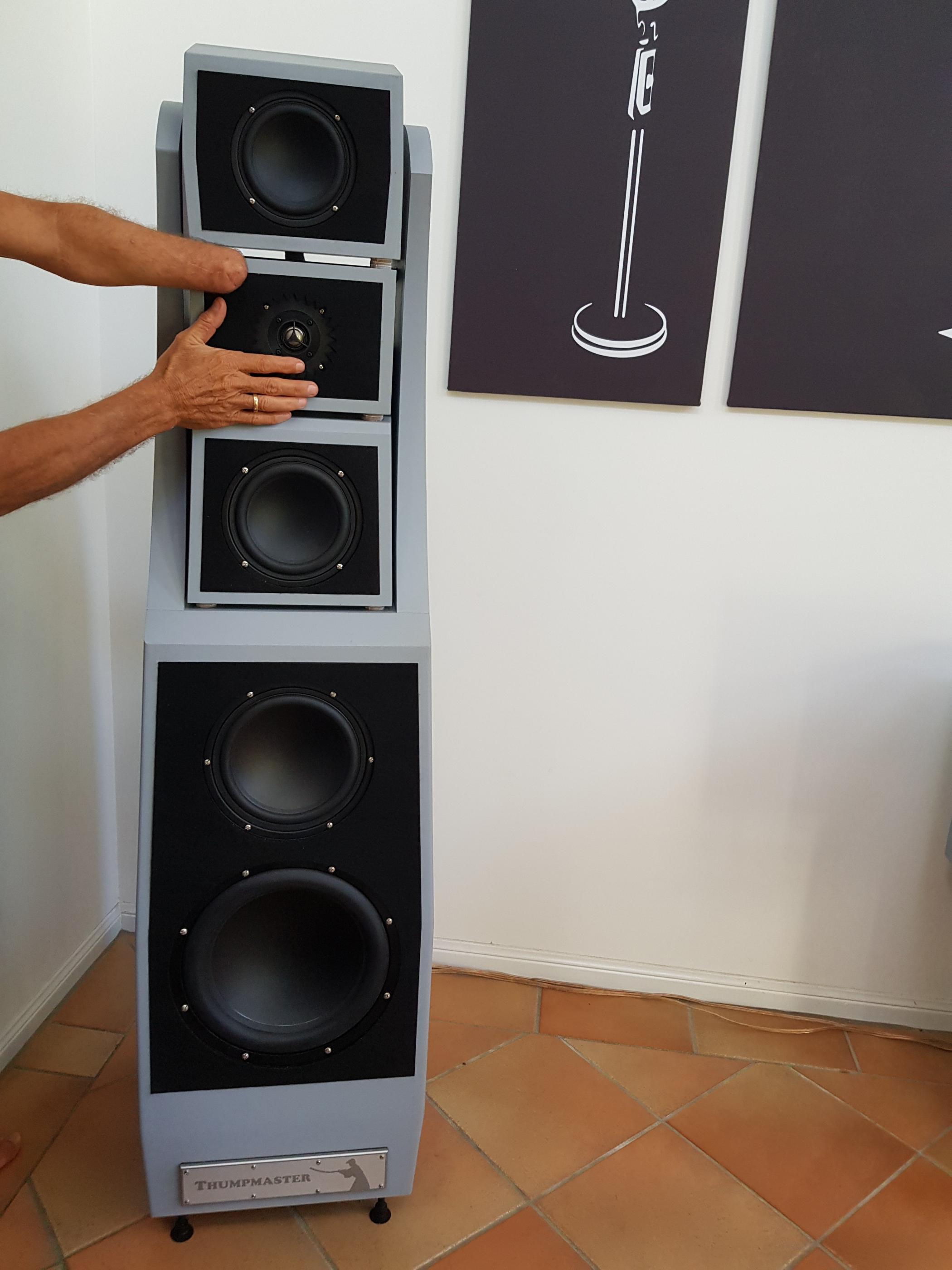

why cross the tweeter so high? dont cross over 4khz, 3khz ideally.
what's the point of the midbass driver almost being the same size of the dual mids? you use dual mids that could easily go down low enough to meet the woofer. makes no sense to me to add the upper midbass driver. just adds complication
if that was my speaker, id let go of the sub, and try to double the woofer. remove that upper midbass woofer and try to find a way to double up.
wait.. are they dual mids? is this system a 5.1 system or 4.1?

3kHz? In a system like this you'd want to crossover as low as the tweeter can cope with!

When I have talked about this 5 way being a difficult build with limited resources.....anything is possible.
As an amputee I hope this gives inspiration to others in a similar situation.

Technically neither, 2 Amps, 1 on the Bottom two, and another on the top 3. obviously this has inherent adjustment for personal taste, vis a vis comparative levels of bass vs mid/high. so best considered as a three way and a two way combined.
Subwoofer excluded from this explanation,of course..
