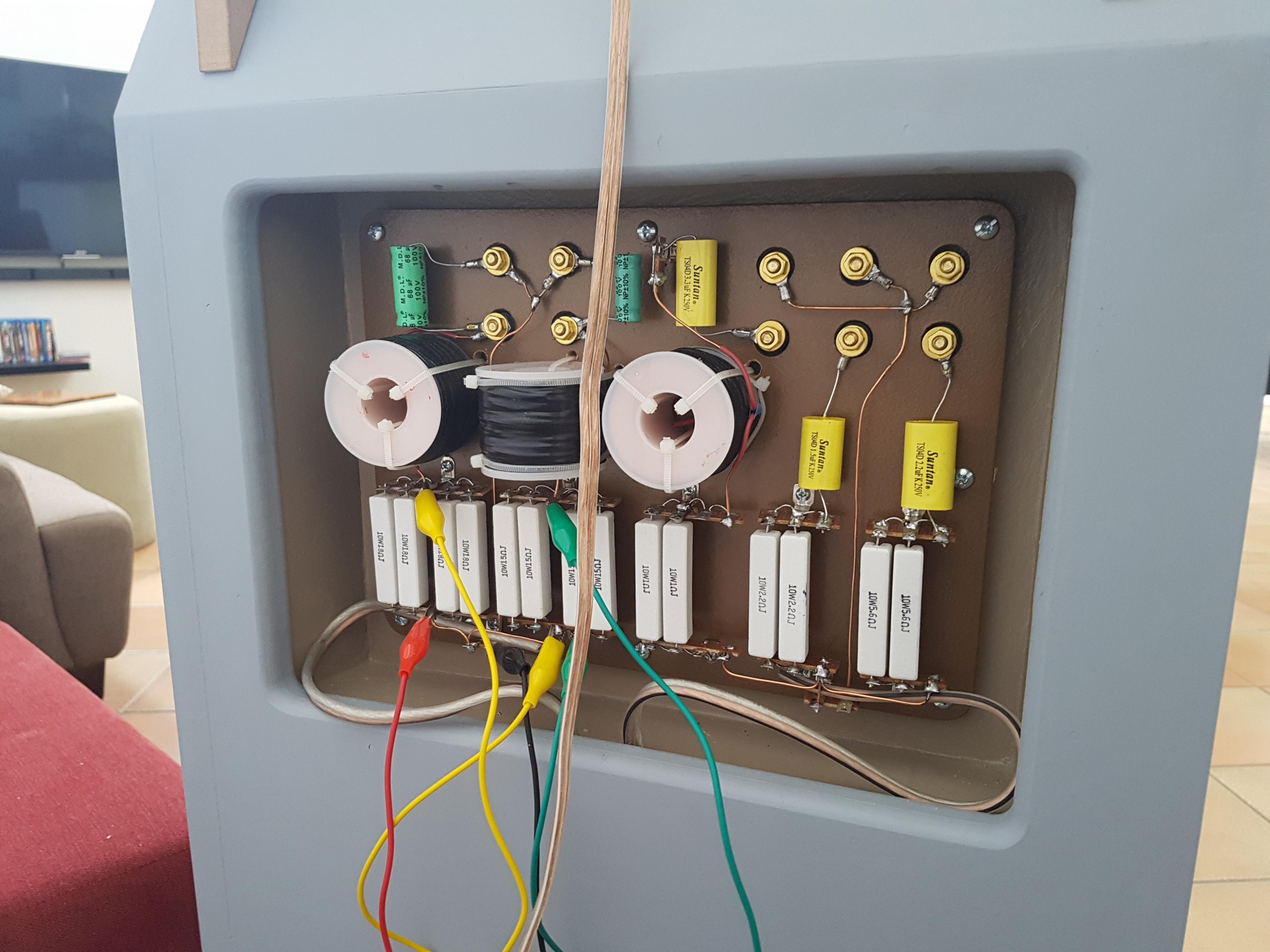

This is the x/over, as you can see in the image taken during construction, its a simplistic approach with the elements arranged vertically left to right ,bass, lo mid, mid, high mid, tweet. The drivers connected internally via the studs in the compartment, and the feeds in through airtight grommets in the bottom, the only component not on the board is the tweeters inductor, that resides in the tweeter module actual. The inverted drivers are inverted inside the cabinets, As mentioned earlier in the thread the resistors on bass and low mid were there to protect my previous feeble amp from the sub 4ohm load, now bypassed. I'm not spoilt for choice where I live so what could be sourced locally is what I used, the inductors are hand wound and there is no cross talk between them that I could hear using the dummy load and headphone approach. Whilst the crossovers work quite well I'm certain there is always room for improvement with invoking the rule of diminishing returns. Oh and the sub woofer is crossed at 80hz, all the drivers coils are aligned on "z", but that is adjustable mechanically for the mid, upper mid and tweet, these tweaks do make an audible difference but which of the endless combinations is correct is anyone's guess so ATM the are all just lined up on Z , roughly..If anyone would like to take the time to tweak the arrangement or point out an error I may have made, all files are attached.. Your thoughts and comments are as usual appreciated..
Edit-Oooops. I forgot to mention that the x/over is actually two, bass and low mid have their own feed in, as do mid, high mid and tweet..

Sir, did you take these measurements yourself or are they manufacturer curves, have they been altered, and do they include the effects of the inside or outside of their enclosures?
Hi Allen, they are the manufacturers curves, they were a pdf and I used FPGraphTracer to digitize them. I'm pretty sure I got them right, I used the info as a basis for my selection although the other choices were limited, no tests of the drivers inside or outside of their cabinets have yet been done, and the conditions of the manufacturers test, well.
... Did you spot an error, ?
