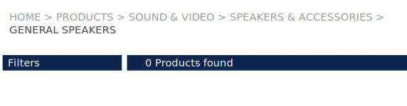

I went to try and redo them. Jaycar's site is messed up, they just remodelled it and it thinks they have no speakers.

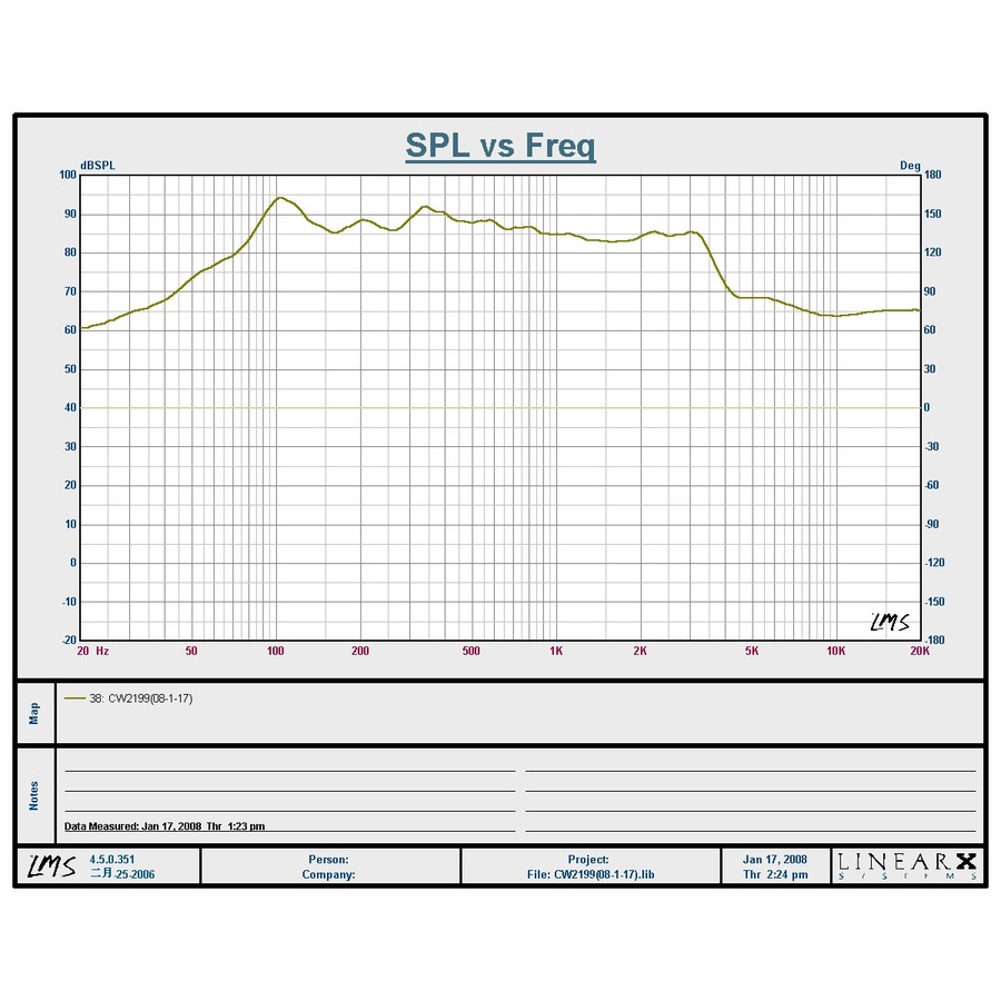

Naturally, the sim is one of the keys to refining it further, and I'm looking at Jaycar's plots right now. These were never their strong suit.
When I look at the plot of a system's woofer I expect to see/extrapolate a level reference looking at the 100Hz region. Not in this case.
Thanks Allen, the crossover points were chosen around any one drivers capability and the predicted reasonable response curve, there were other drivers available at the time that might have been a better choice, however similar appearance and construction swayed me the direction I went, if only for aesthetic reasons.. for example the 12" is a back mount, that was a little inconvenient, but you wouldn't know it looking at it in situ..If you believe moving the crossover points would be beneficial, I'm all ears.. The design makes the crossovers easy to alter..

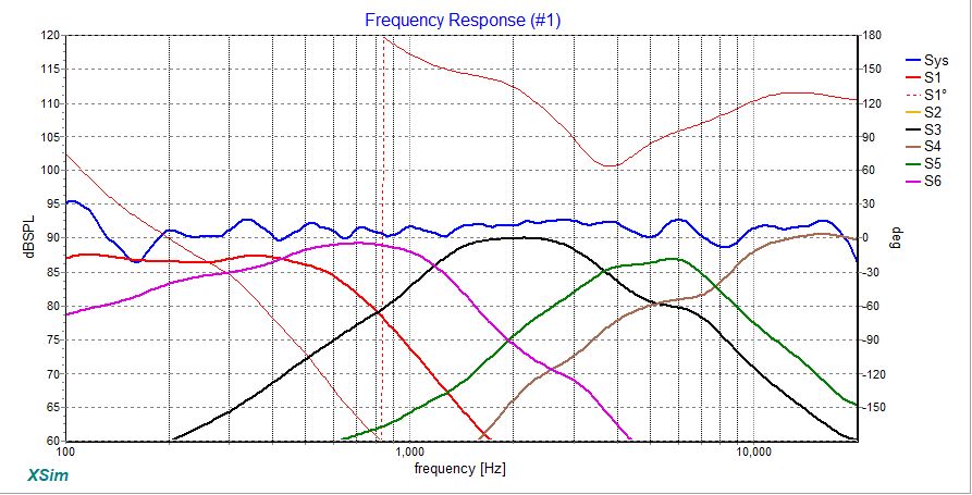

Sounds great. Here are the curves with phase. They seem to include some unwanted reflection information from testing, which might be best blocked out by sight if you can recognise it.
There was no tweeter impedance plot so I bundled the old one in the zip.
I have not simulated the baffles. Bit of a complex topic as well given their variety, the room and so forth. Expect a little variation in, just for example, each driver's chosen level with the current amount of data available.
Thanks for your trouble Allen, You had me going for a bit, the 6.5 was incorrect near 30db down, once I fixed that, the curve I have is very similar, Im going to have a play with your copies.. No smoothing on Sys..

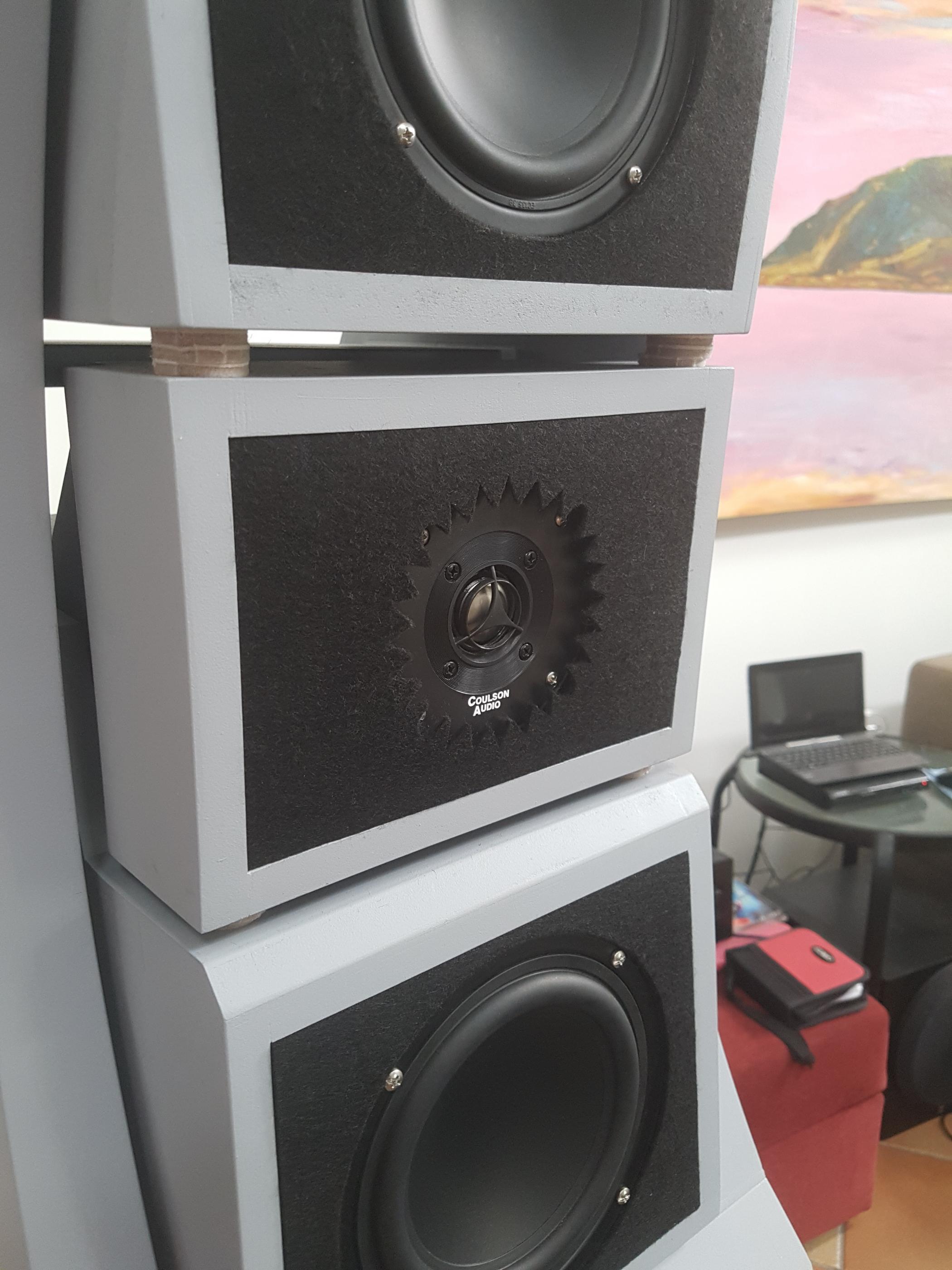

A question, Test mic, will a Umik do for me for my purposes, Ill have to buy offshore.. And Chris, reading through my own posts I may have come across as dismissive with relation to your comments, this was not my intent obviously, I have studied what you suggested..Attached is a picture of my attempts to mitigate reflections and baffle step issues with absolutely no science to back it up, Its wool felt, stands slightly proud of the edges.not my idea BTW..please note that the upper modules do not yet have radii, been fine sanded or prepped. MDF as many have noted here does weird stuff especially on the end grain over time, I live in the tropics with an ambient temp of between 20 and 40 C, and humidity that wets your socks when they are hanging on the washing line, so Its primer for at least a season or five until the biscuit board settles down.. 🙂
