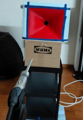

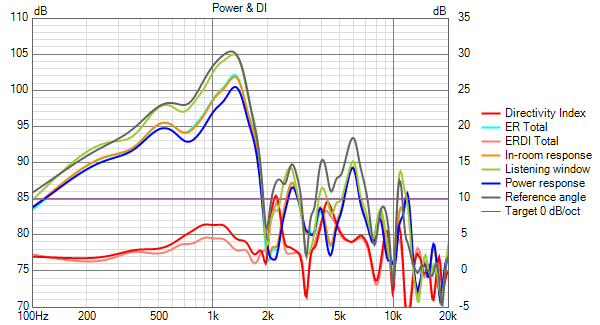

Prototype measurement time 😀
Here is the ugly cabinet made for the MEH using XPS foam and hot glue (I know that it will not win any prizes for looks or functionality.. That thing causes its own sweet resonances 😛 😀)

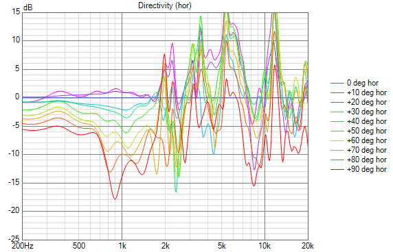

Measurements were made only out to 90 degrees. Measuremets were gated at 4ms..
Hence the masking of high Q resonances in the passband are also probably there..

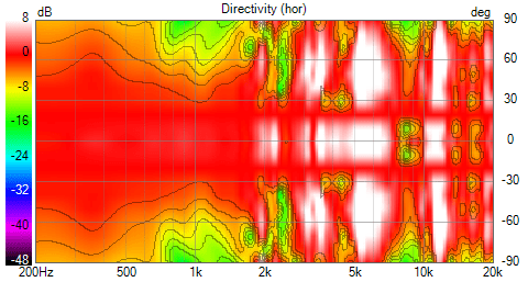

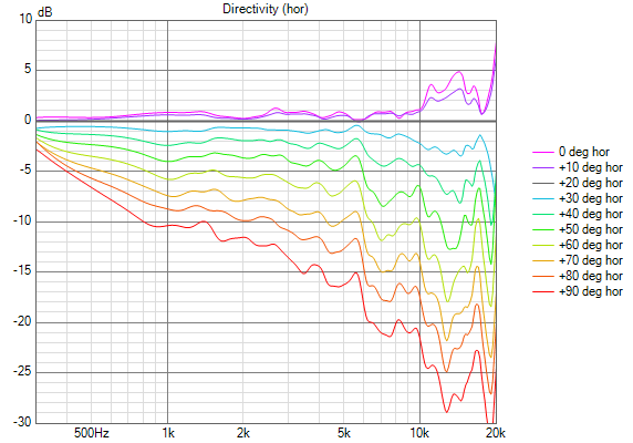

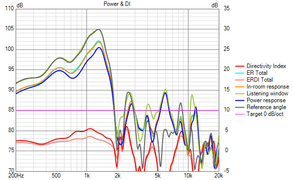

Anyway, here is how the highs on Rosso 65CDN-T look like (Normalized 20 degrees off axis)

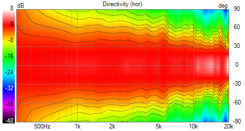

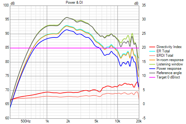

Now the mids (2xTC9FD in closed box of 10+ litres volume)

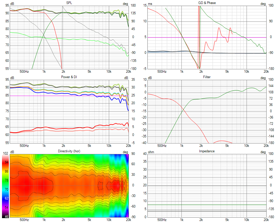

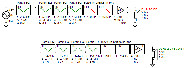

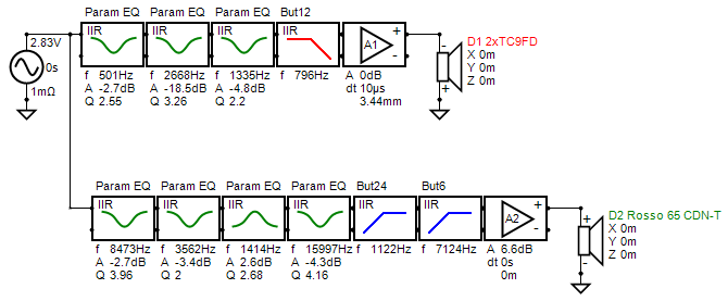

And here is a rough crossover that stitches together the two sets of drivers (Off course it can be done infinitely better 😀 )

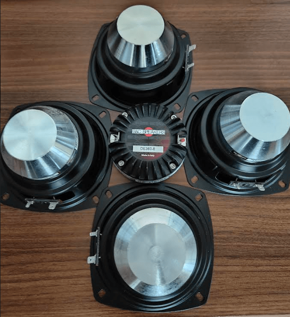

@meiro.. I will be using a 1inch driver (B&C DE360) and 4 x B&C 4NDF34 drivers per side in the final build/horn... Hence this choice of 1.5ish kHz crossover frequency.. 🙂
@mabat: Thanks.. 🙂
I am already encouraged by the relatively smooth directivity transition near the crossover area (except the mismatches caused by crossover).. The horn seems to be holding the directivity even through mids are coming from a different source than the exact throat.. 😀
At the moment, the centre of throat to mid port centre distance is 6cm, which which is less than 1/4th wavelength at crossover frequency of 1.32kHz (wavelength approx 25cm)..

I have tymphany DFM 2535, 2544, and BMS 4550 also competing for a position on the horn.. 😀 Will try them out if the B&C DE 360 is not ready for it.. Somehow I was too much attracted by the DE 360's break up free response upto 20kHz.. and I will never exceed 100dB SPL per side at home.. So...

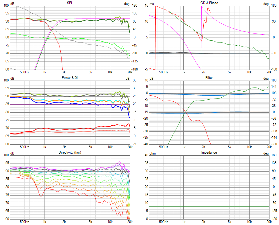

Just out of curiosity, I tried to do one more quick iteration of the crossover but results are mostly the same..
It seems like the acoustic low pass filtering of the mids sort of determines the crossover slopes between the mids and highs to a large extent.
Maybe there is some optimization possible there, also focussing on the out-of-band (for the mids) garbage supression for the mids.. That may help with a little bit smoother transition in directivity I guess, in the crossover region..

As of now, DSP and especially FIR filtering with steep slopes seems the better option..

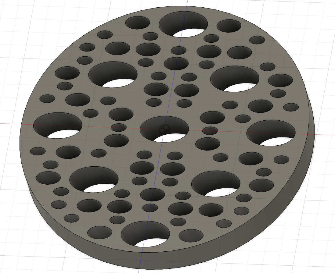

Given that the waveguide largely determines the overall directivity, I will work to see if I can do anything more in that area and start modifying it in fusion 360 for the new mids & CD and get to 3D printing it fast.. 😀
@fluid: I completely agree.. I have been noticing this with measurements of the EXAR 400 horn and the mk3b2 build as well.. 🙂 Another 0.5 to 1dB DI delta might occur in this case due to lack of vertical polars I think..
In fact, I probably want the DI more in the 8dB region above 1kHz and slowly coming down in value to cross over properly with the 15inch drivers, I think..
So far I have just been focussing on the blips in DI due to all sorts of things happening with the horn and MEH configuration etc without worrying about the absolute value of DI..

Can be a bit time consuming to set up the sketches, sketch holes swept cut at an angle

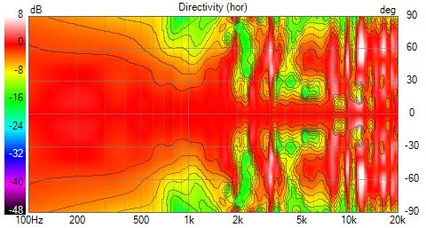

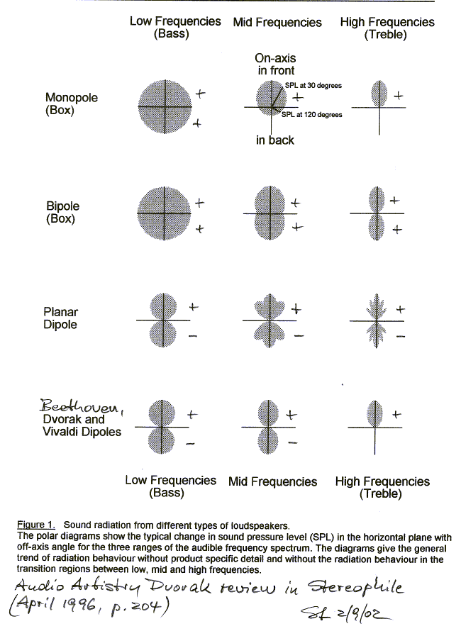

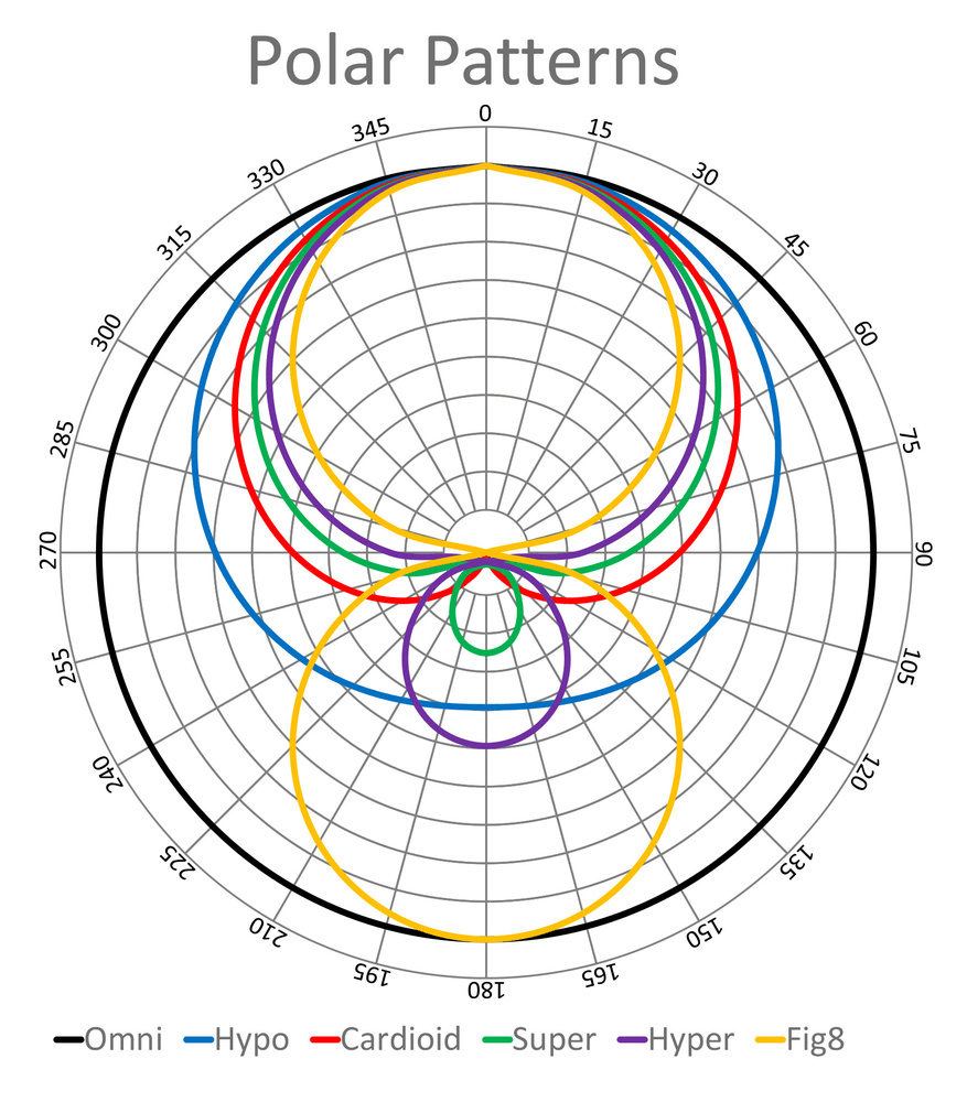

About cardioid, it has low DI up to 90deg. I can't remember how VCAD calculates DI, does it always use only frontal sector?
0-180 deg full spectrum pattern is what I am are mostly interested in and want to see. 1/2 oct smoothing is good, because general pattern is most important. Wiggles are interferences, important for the designer but not that much for listeners.
Here a pic from Linkwitz,based on real measured patterns but not spectral.
Reactions: vineethkumar01
From the help, no unless you tick half space in the DI options

I also probably need to have some standoff to reduce the volume under the mid cones as seen in this nice thread: https://www.diyaudio.com/community/threads/two-way-synergy-horn.367812/post-6567410
A plug over the cone to reduce the volume between cone and WG wall? I've fooled around in Vituix box sim a few times to speculate about the front chamber volume. By that I mean selecting band pass type 1 and dialing in front volume, port area, etc. It's quick for visualizing the resonance peak and air velocity through the port, but haven't followed up with Akabak yet to check against a simulation with all involved parts 3D modeled.
