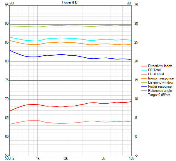

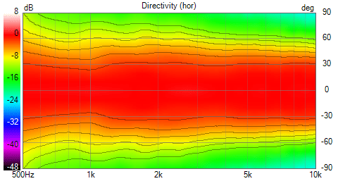

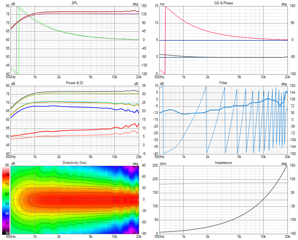

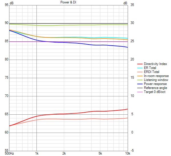

It is sort of fun to see how the response of SB Rosso 65CDN-T driver on an EXAR 400 horn looks like with FIR filtering (driver passband linearization + crossover) targeted at producing a flat 'ish' listening window response (with LR4 highpass at 600Hz).. 🙂
I just keep wondering.. How would it sound like if the pattern width was a tiny bit wider across the bandwidth.. 🙂

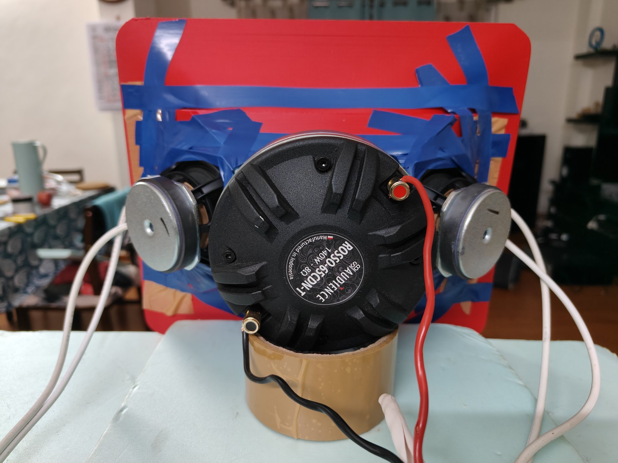

A quick and very dirty Tritonia-based MEH prototype and preliminary measurements 😀
This is not the actual Tritonia. It is a scaled down version with about 30ish cm width that Mabat had published on ATH thread. The original one is about 43cm in width. Since this is a prototype, I decided to go with this smaller one as it was relatively easier to 3D print
HF: SB audience Rosso 65 CDN-T
MF: 2 x Tymphany TC9FD8 in parallel (8x B&C 4NDF16 drivers already in hand.. 😉 )
Mids radiate out through elliptical-shaped ports into the horn. Total port area per side = approx. 1/12th of driver SD
Distance between centre of horn throat and centre of each ellipse = 6cm (approx)

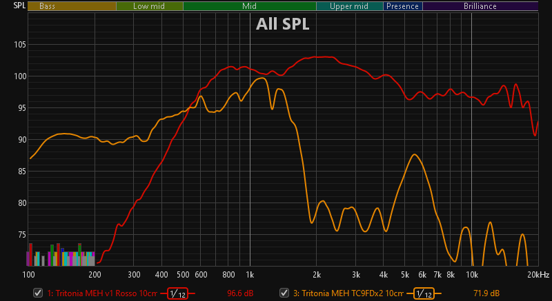

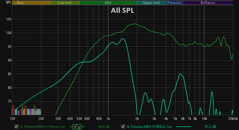

Right now the mids are open-back. Need to close it and test Next. But till then here are two sets of measurements of the Mids and CD taken separately from about 10cm from horn mouth and 1m away from horn mouth.
Measurements from 10cm away from horn mouth
Measurements from 1m away from horn mouth

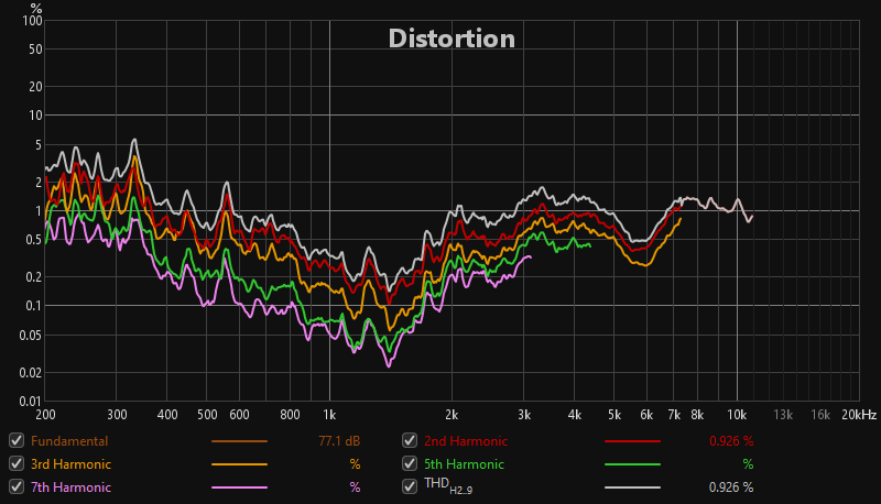

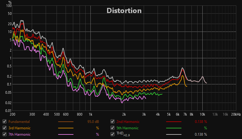

The below distortion results are unreliable but still here it is..
Rosso CD distortion from 1m away
Same for 2xTC9FD in parallel on the horn

I wanted to fix the mids and the ports on the top and bottom of the horn instead of on the sides.. I mistakenly put them on sides while designing and saw the mistake only after 3D printing.. Also, seems like i was half asleep while doing the design since the driver cutout and screw holes for mids were missed and eventually I had to tape everything together for this experiment.. 😀

Looks like the mids don't do much in this size of MEH
Don't forget you have front-rear cancellation going on that makes it look like there is little low end from the mids. 4 4NDF34's per side, sealed, should be good down to 100-150 Hz for home use. I'll bet that much of that "un-smoothness" you see on the mid response is due to reflections from that open back. they really want to be in a stuffed enclosure. Its really encouraging how high their response goes. It means you are free to choose a CD for its high end response, not one that supports a low XO.
Also that circa 5800 Hz peak coming through the mid ports is common phenomena in MEH and will need to be suppressed

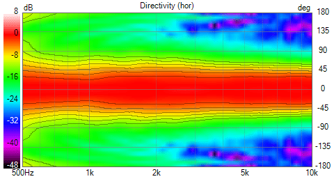

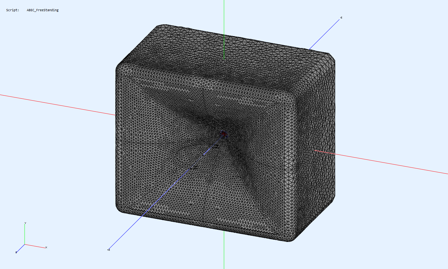

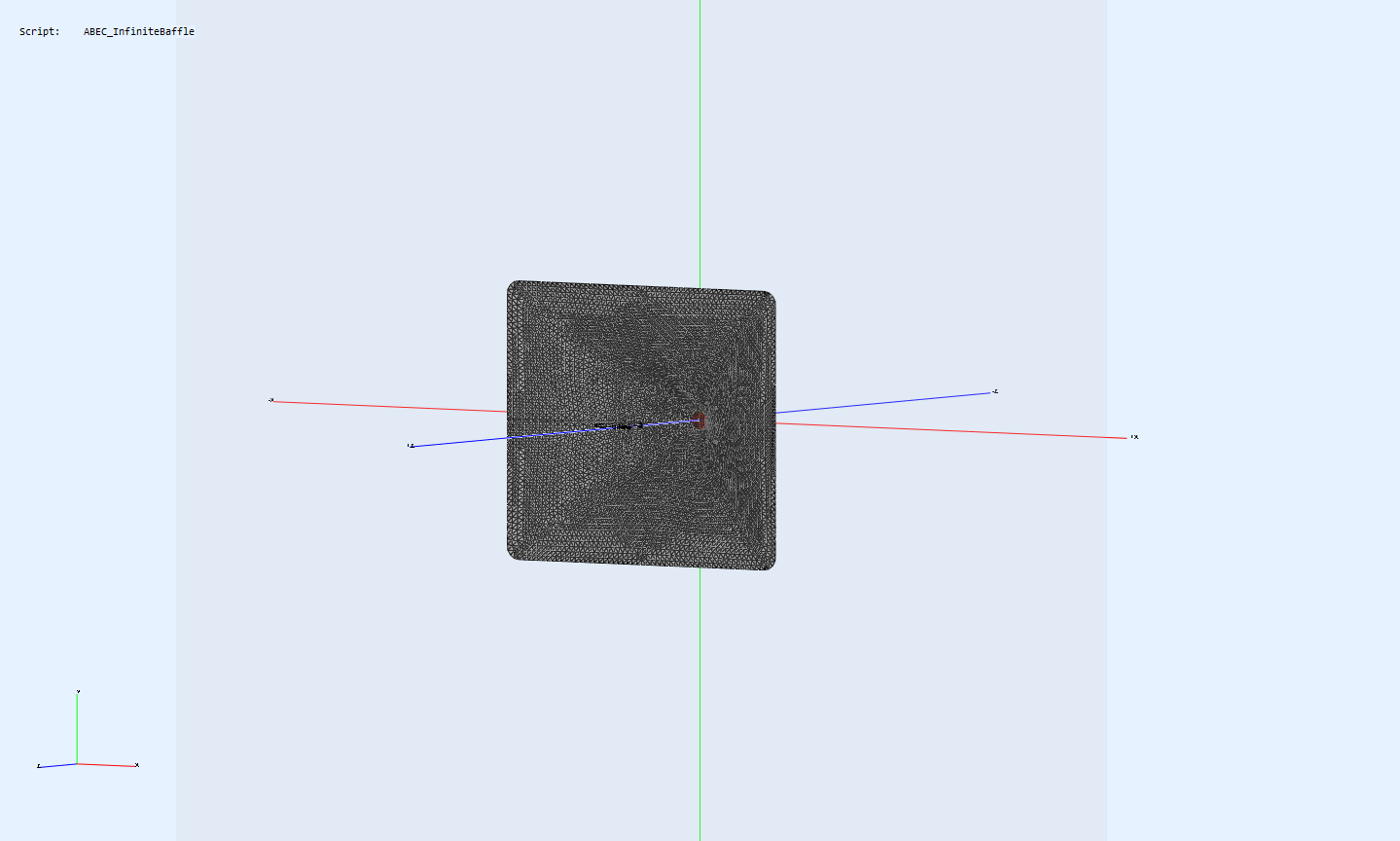

I tried out a slightly larger waveguide derived from Tritonia but with a 1-inch throat using ATH and ABEC
Here is a comparison of infinite baffle vs waveguide in a box with 18mm rounding at the edges
Device width x height = 448.00 x 386.00 mm (17.638 x 15.197")
Device length = 144.00 mm (5.669")
Infinite baffle sims

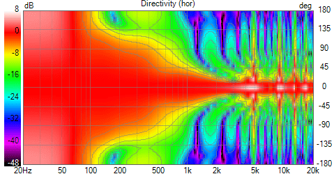

Normalized response curves from 0 to 90 degrees (Normalization using 10 degrees off-axis curve)
Waveguide in a box version

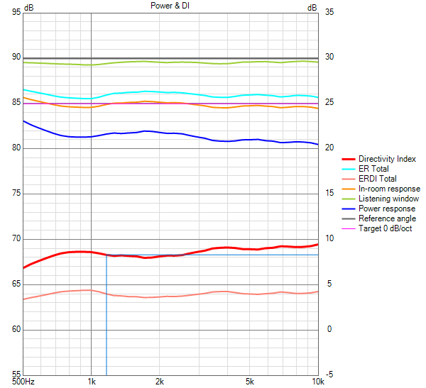

I am not sure about this.. It looks like the waveguide has a little too much directivity at 1kHz itself.
Even if I have cardioidish radiating mids crossing over around 1.5 kHz to the waveguide, its directivity of around 5-6dB might be less compared to that of the waveguide I think... 🤔

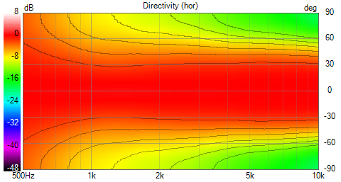

I posted the curves of the waveguide in box wrongly in above post..
Here are the correct curves
Maybe with this kind of directivity from the horn, I don't even need to have cardioidish radiating mids.. Just closed back mids in an MEH configuration crossed over to the woofers might be sufficient I guess..
The dual 15inch woofer module (ideal) directivity below
Maybe the wide-narrow-wide kind of nature of the polar pattern of the waveguide is an issue?
I am more surprised aboout the DI dip around 4k. Quickly run it on an infinite baffle to check if this issue persists without a box. There lies the real issue with the waveguide, in this avoidable discontinuity.
The other is not resulting from the waveguide alone. The 1k narrowing is usually related to horizontal edge diffraction. If you are going for a narrow pattern, and so it seems, learn from @limacon's, to my knowledge yet to be finished but well simulated and documented two way speaker: https://www.diyaudio.com/community/threads/ath4-waveguide-inspired-multi-way.384410/page-8
According to his testimony, which was given in another thread which I sadly forgot how to find it, to mitigate the narrowing of the pattern required carefully tailoring the enclosure shape and dimensions. This is thus an optimization of all diffraction happening on all edgeds and walls of the enclosure, in respect to the frequency region. Maybe he can give an idea what to look for. The other solution is obviously to go for a free-standing waveguide, and you have been there.
