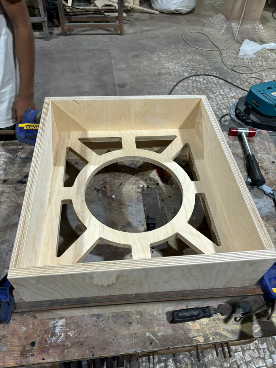

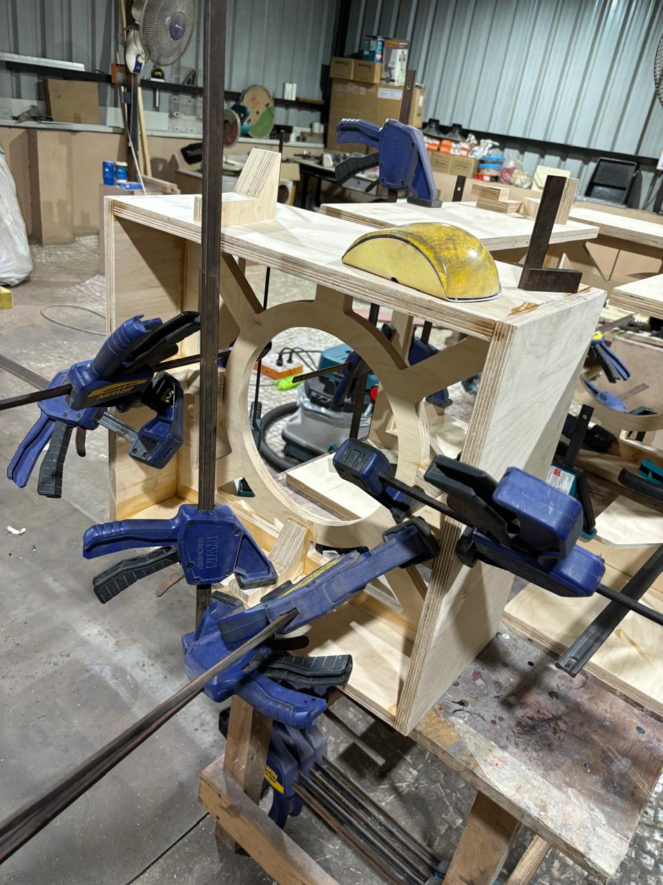

This box being made for the SB audience Nero SW800 woofers 🙂

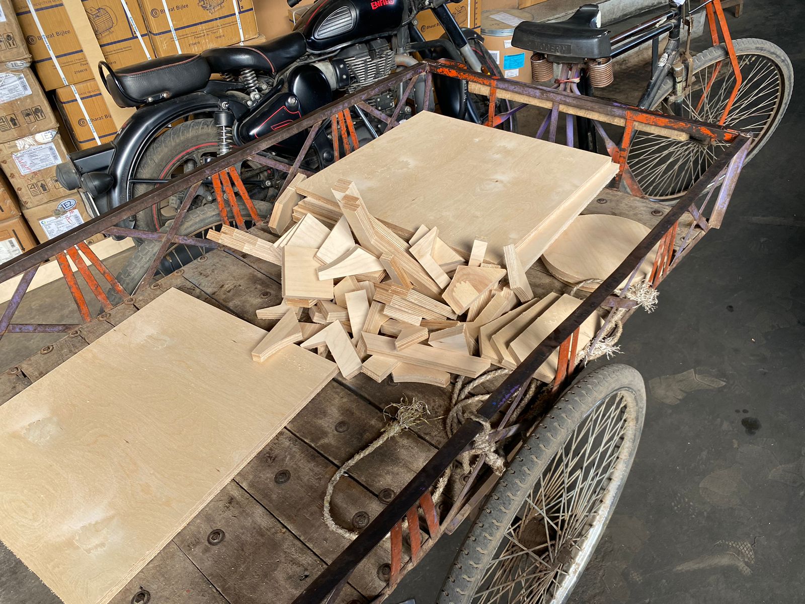

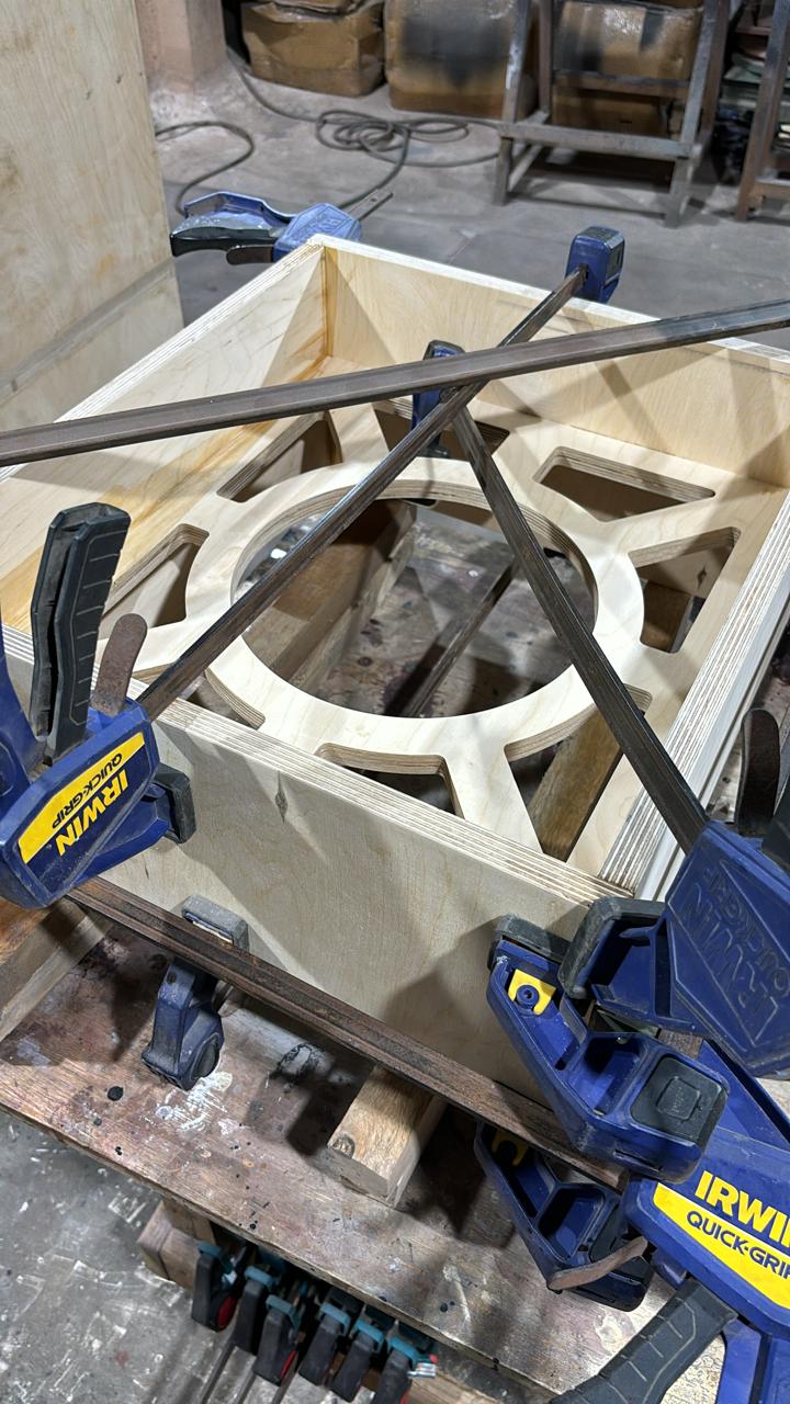

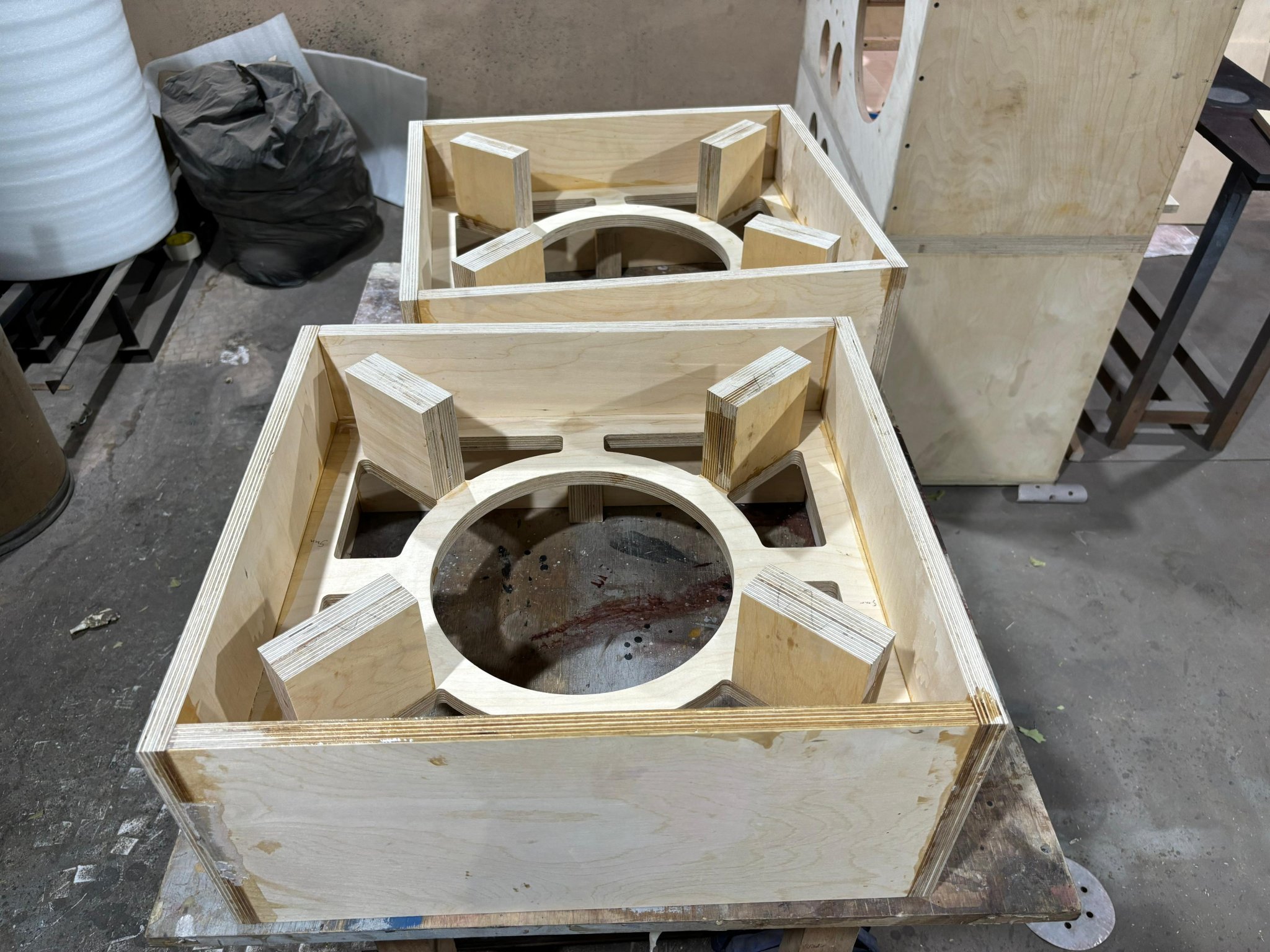

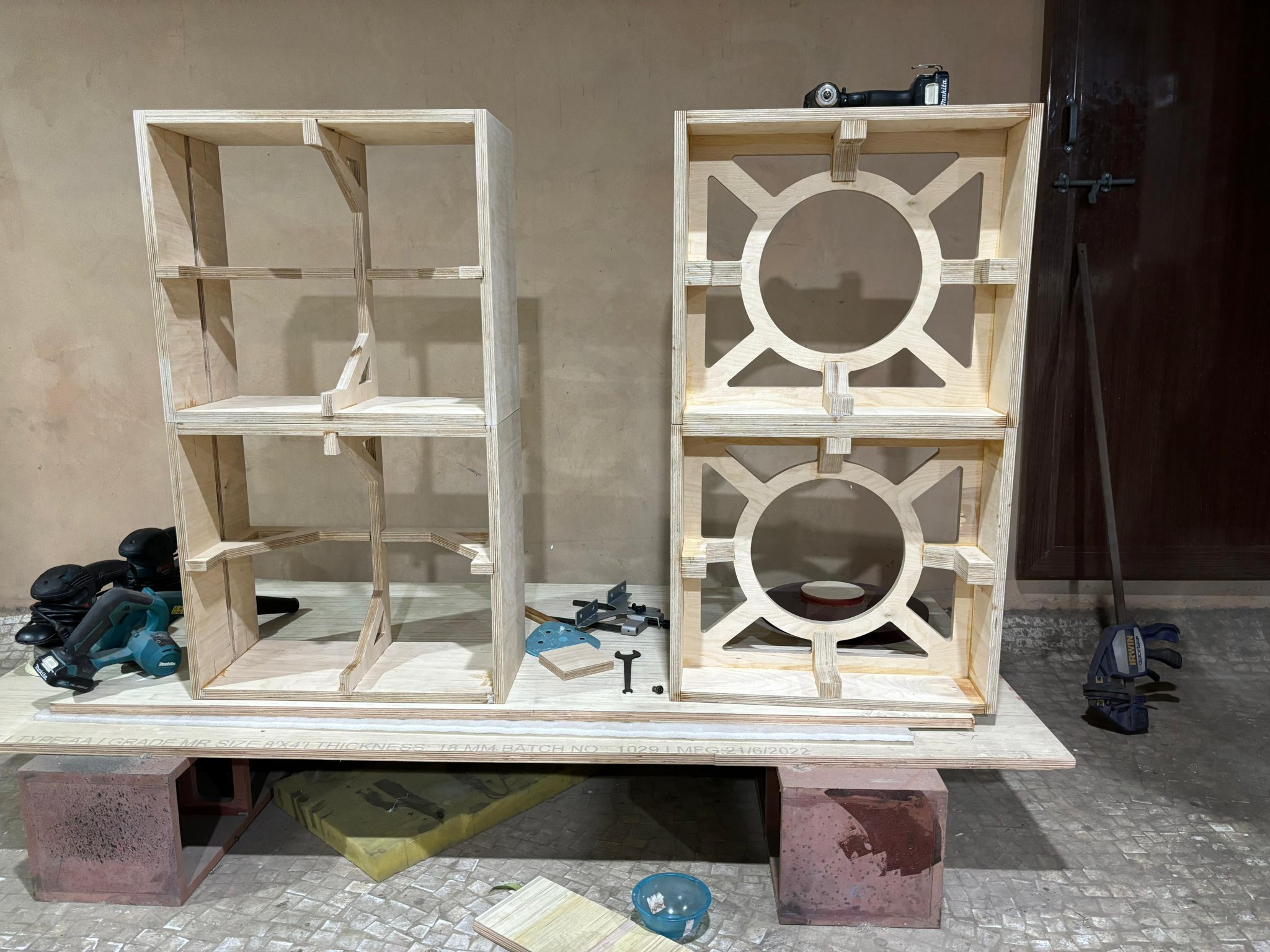

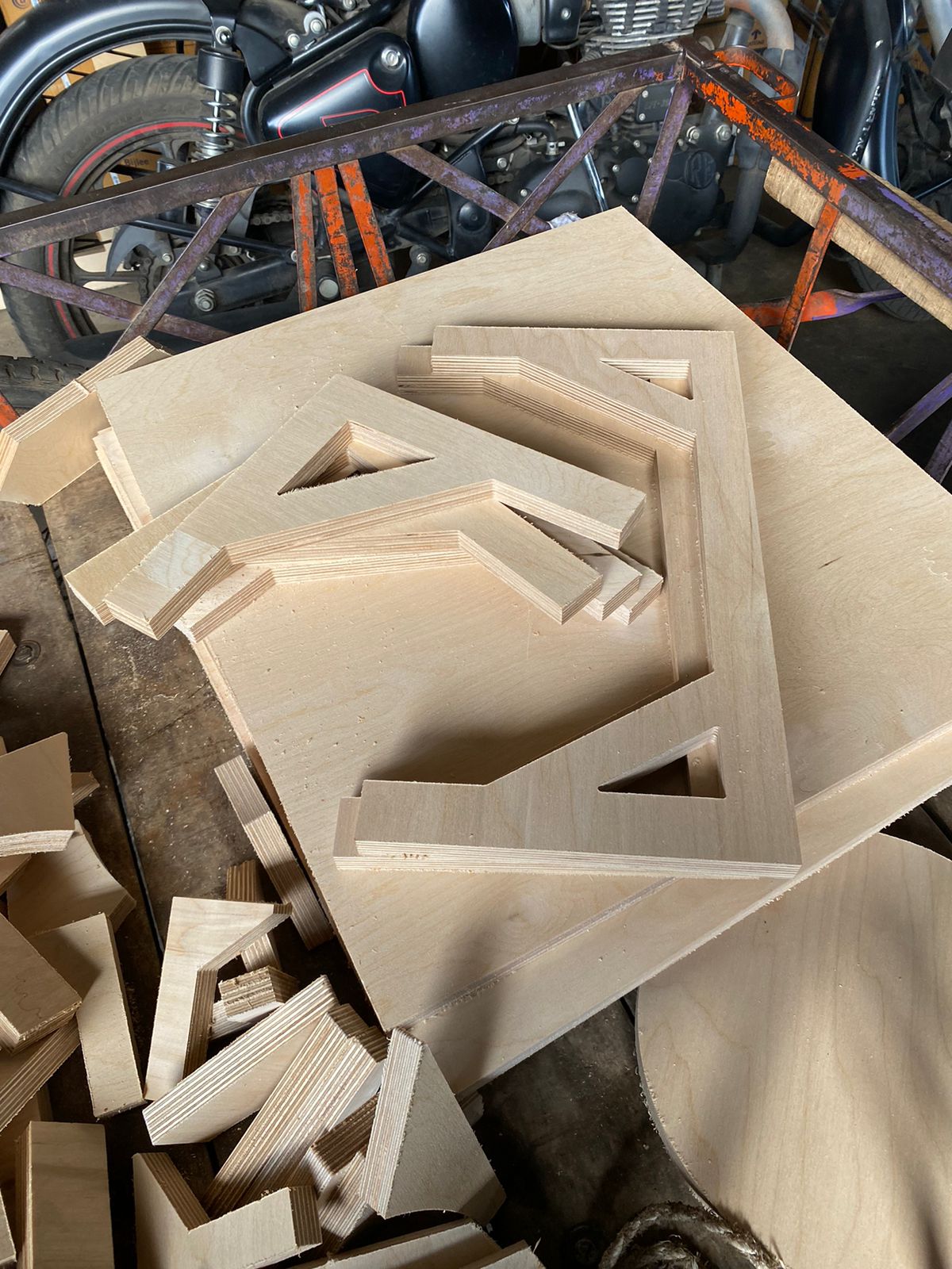

More progress on the two pairs of boxes.
One set for the 15PR400s, on the left side of below pic (more bracing to go into that). Another set for the NERO SW800s on the right side

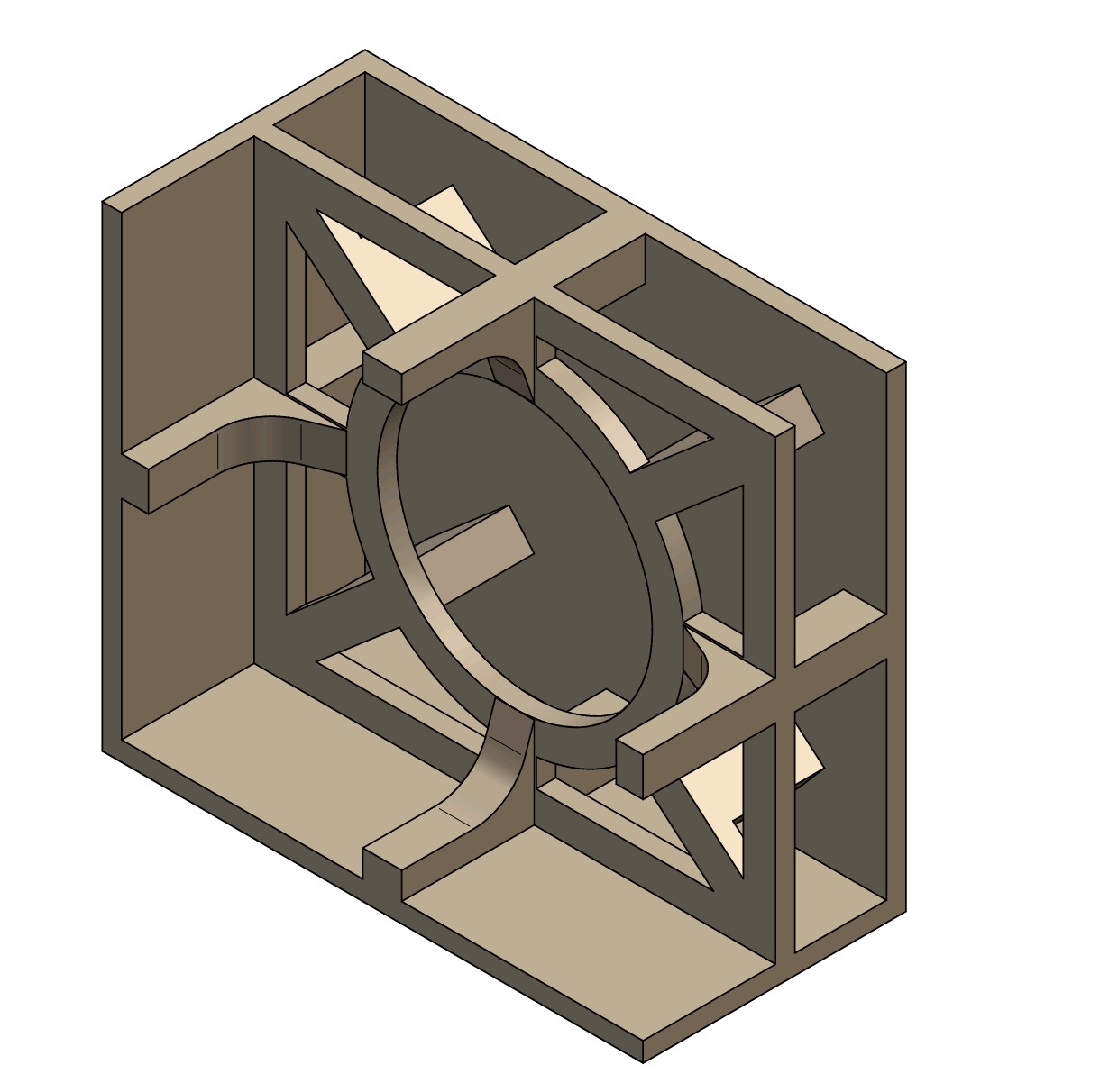

The NERO SW800 boxes (backside view) being built exactly as per the drawing in above post 🙂
Front view
double thick (36mm) birch plywood panels to go on the baffles and back side of each box
Front view

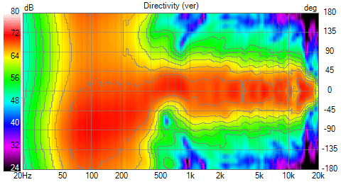

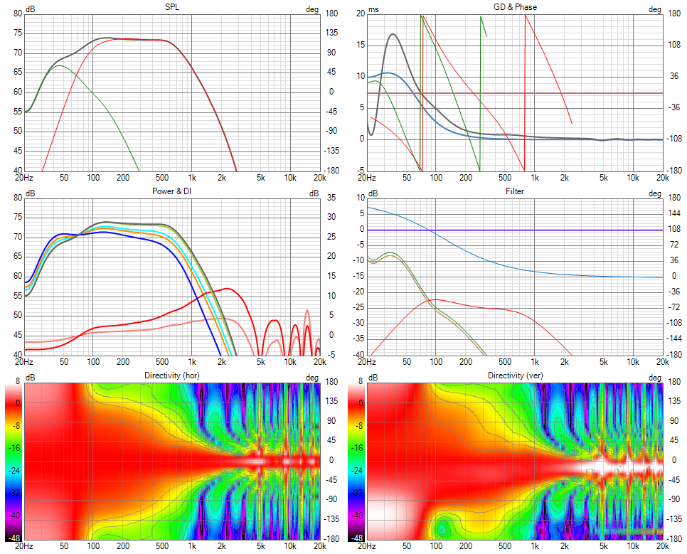

The plan is to have to 15 PR400 reach upto the CD-horn (SB audience Rosso 65CDN-T + EXAR 400) frequency range up top. Down in the lower frequencies around around 100Hz, it hands over to the NERO SW 800.
The whole bass-mid module including the two drivers is to be arranged in a Genelec W371A type controlled directivity configuration down to around 100Hz (at least initially, for experimentation). Based on how that experiment goes, the final system configuration will be fixed. 🙂
This is the kind of directivity I am looking for
Let's see where it all ends up.. 😀

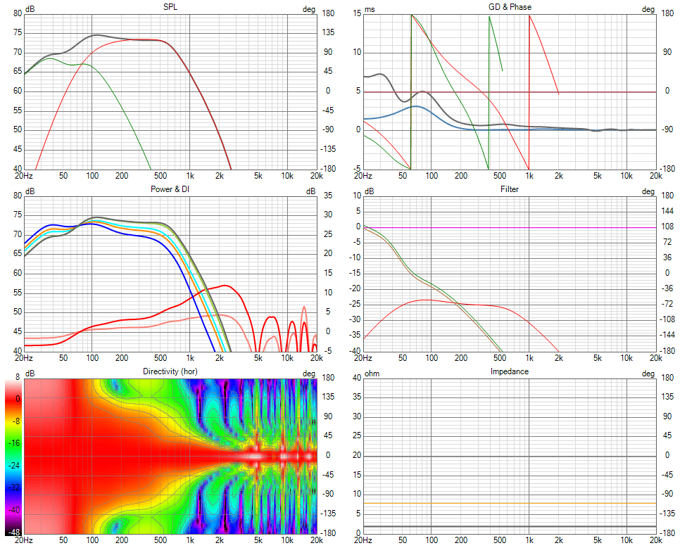

While I am waiting for the above-big boxes for the 15inch drivers, my ESI audio interface (which I used to implement DSP for my cardioid computer speakers) developed some issues.. So the speakers have not been playing for a while..

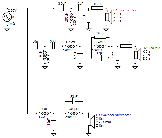

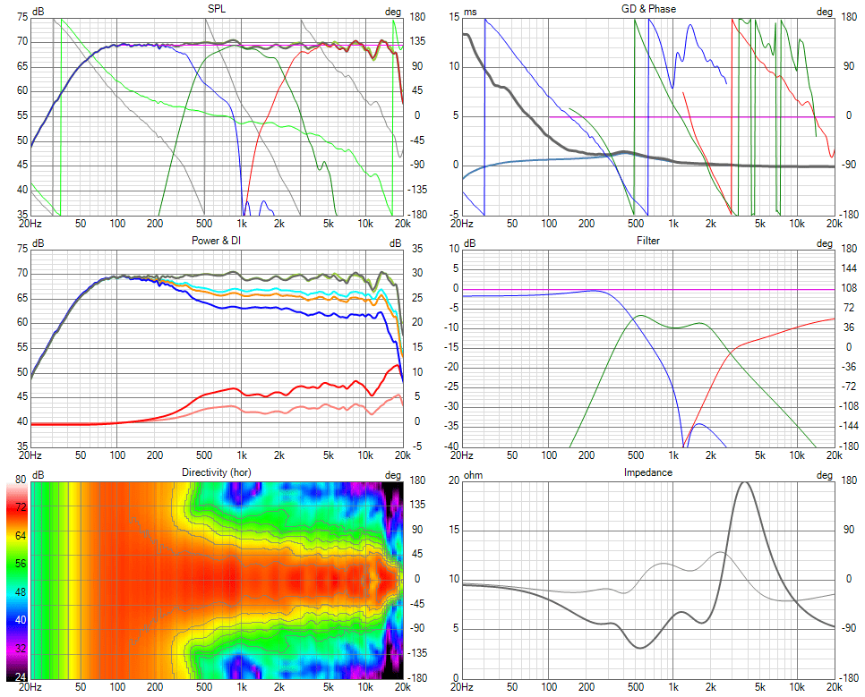

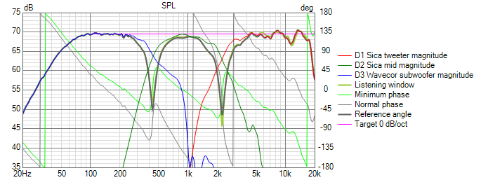

When I got some free time, I quickly simulated a full passive crossover for the cardioid speakers.. Here are the details.. 🙂
VituixCAD six pack
The impedance does dip to 3 ohms in the 500Ha region. I am hoping it might be ok.
Vertical polar
Quick reverse null test to see the extent of phase matching at crossover
VituixCAD six pack
Vertical polar

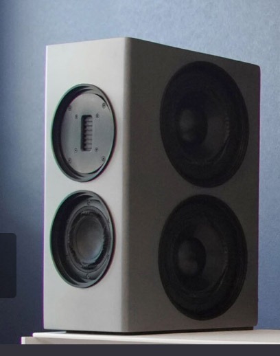

I recently saw the below speaker that uses a lot of Purifi drivers and their amps per speaker along with FIR DSP. Somehow a post I made here got deleted (accidentally by me?) or something..
Anyway here is the speaker.. It looks good except for the lack of some measurements..
https://www.monoandstereo.com/airplain-acoustics-super-phli-speakers/
... and for the very strange recessed mounting of drivers:It looks good except for the lack of some measurements..
https://airplain.ch/
Super Phili uses waveguide for amt and a mid four woofers from Purifi. DSP-controlled and with Weiss dac and Purifi Eigentakt amps- Should be good and capable of high spl. Esthetics is in the eyes of the beholder... Why are all 4 woofers on the same side?
https://airplain.ch/index.php/products-2/?lang=en
I don't follow Mono&Stereo, their reviews are just thin air to me...
